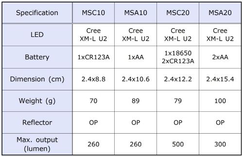

    Manufacturer Specification from C&P Corporation website :

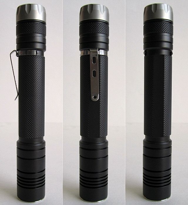

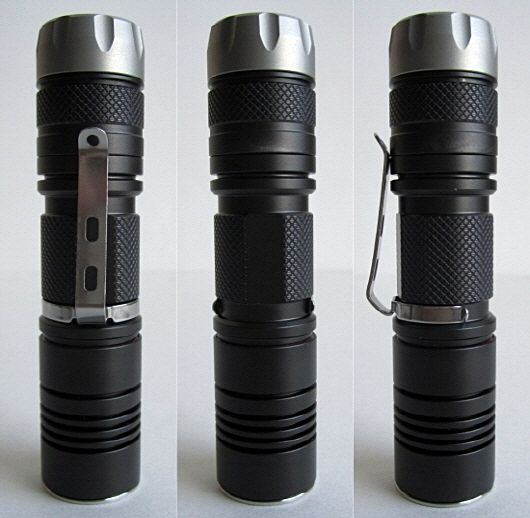

    The anodizing which seems hard(type III) is a matte black. There is no label on the light body, due to the test sample. The knurling is present over most of the battery tube except two sleeky flat sides. The tailcap is covered by a band of knurling. Note that only MSC10 has no sleeky flat sides and it is just pure cylindrical design concept.

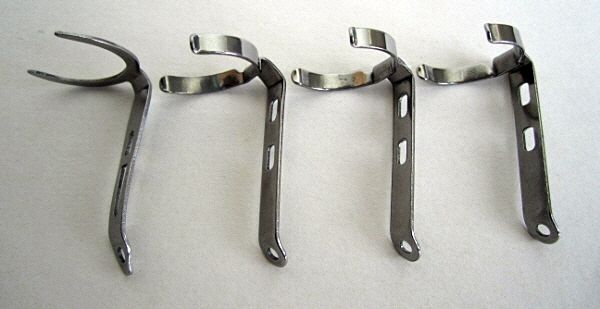

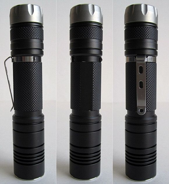

    The stainless steel clip-on pocket clip is basic, but seems to hold on well. The clip is tail-facing, and not reversible for MSC10 only. But the clip is head-facing, and reversible for other members. All clips seems to be sturdy and good quality.

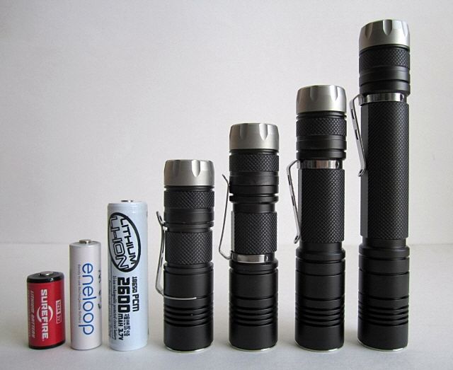

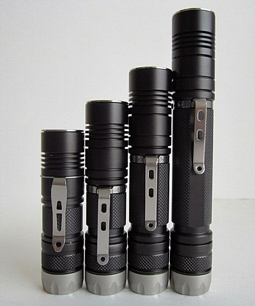

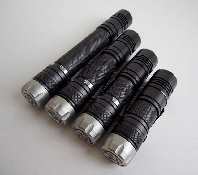

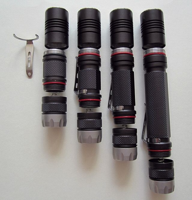

    From left to right : Surefire CR123A, Eneloop AA, VicLite 18650 (2600mAh), MSC10, MSA10, MSC20, MSA20. (You will see the rest of the review in the same order as above.)
    The light has 3 parts (i.e. head, battery tube, and tailcap).
    The stainless steel clip works as a good anti-roll device as well. As you can see, the MS series are among the most cylindrical of all the lights, The head & tail diameters are same, and the battery tube is only slightly thinner. Note that the heads, tailcaps and battery tubes are physically interchangeable among the four models. But I don't know which models use a same circuit from the rest.

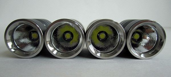

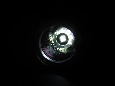

    The light has a flat and somewhat deep stainless steel bezel. There are three thin & deep cooling fins for heat dissipation on the head. The positive battery contact has a circular raised lip (or bump) which works as a mechanical (or physical) reverse polarity protection. But the SMC20 has no circular raised lip. - It probably seems to have a reverse polarity protection in its circuit. The light uses AR coating lens and the purple hue is reflected on it.

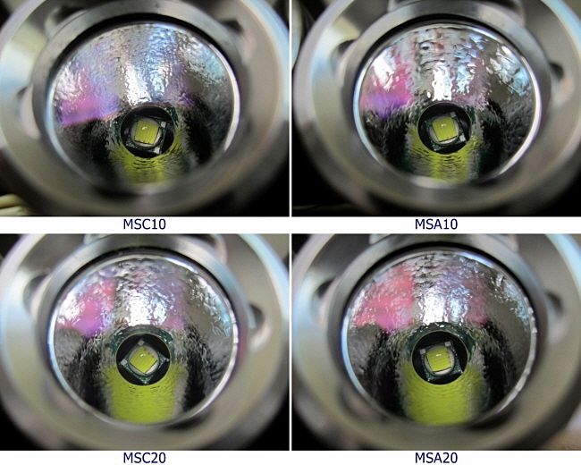

    The aluminum reflectors have a medium orange peel pattern, and are identical for all four members. They are well polished with no noticeable finishing flaws, and well-centered XM-L U2 LED sits at the bottom of the reflector cut.

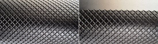

    Knurling on the battery tube is not aggressive, so overall grip is not reasonably good (i.e., less aggressive than most).

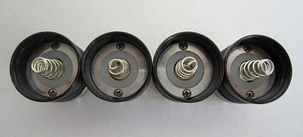

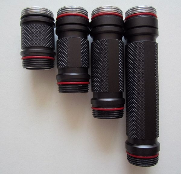

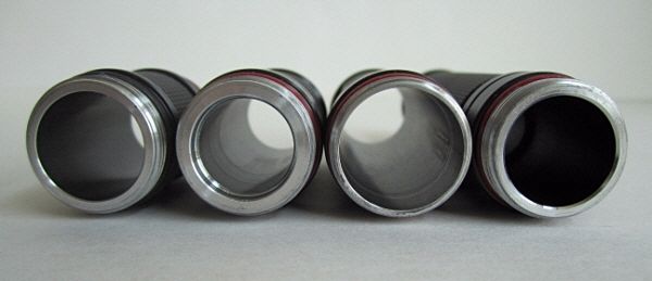

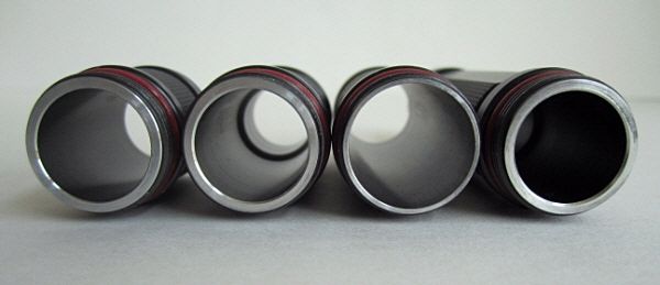

    The MSC10 has the most thickest wall of the battery tube, but the MSC20 is just the opposite. Battery tube of the SMC20 is wide enough to accommodate protected cells (i.e., it can take my wide & long high-capacity protected 18650 cells), and works fine.

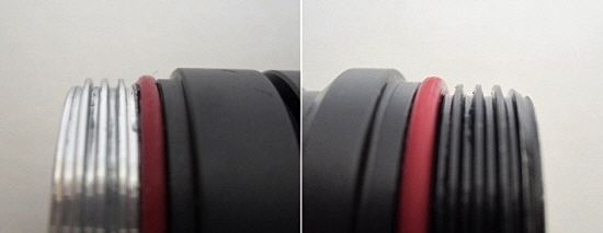

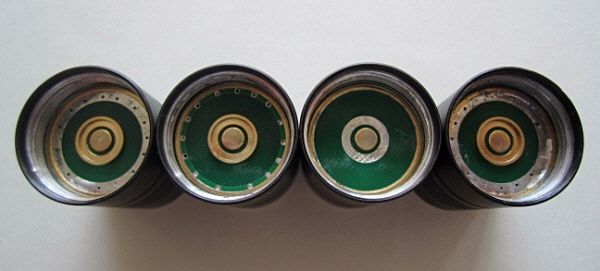

    Both front and back threads on the battery tube is symmetric, and look like trapezoidal-cut but nearly square-cut. Tail threads are anodized at the battery tube and tailcap region, allowing for tailcap lock-out. They are smooth with no cross-threading or squeaking on my samples.

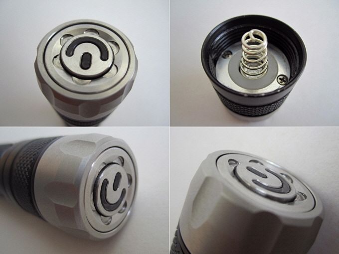

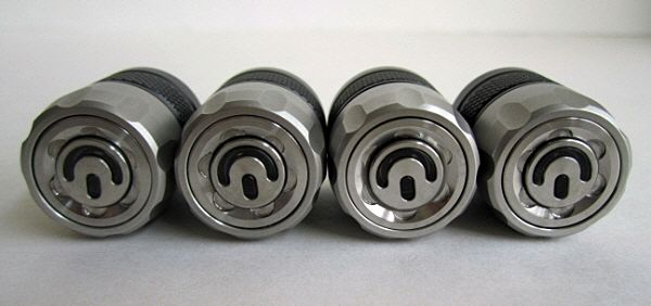

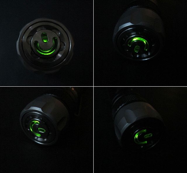

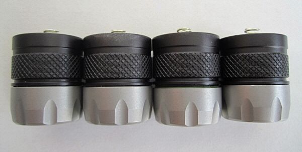

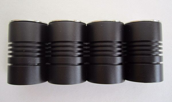

    The most distinctive part of MS series is the tailcap. It appears to be a bit similar to the Thrunite Scorpion V1, but the exterior views & the interface are not identical to those of the Scorpion V1. Tailcap exterior is composed of two parts - a black part (knurled region) and a grey magnetic control ring & PD switch which is recessed within the tail end. The magnetic control ring has a good feel to turn, and the PD switch has very short travel with moderate tension. It seems that the PD switch is not mechanical but electronic switch. The total traverse of the control ring is around 1/2.57 circumference (i.e. 140 degrees) of the light. There is a battery power indicator on the PD switch which shows the current battery state. If the battery power is sufficient, the LED turns green. The red LED means you need recharge or change the batteries. (Note the battery power indicator turns green or red when the PD switch is "Off" position only.)

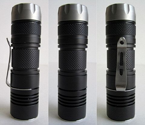

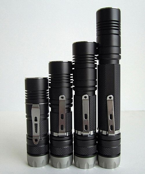

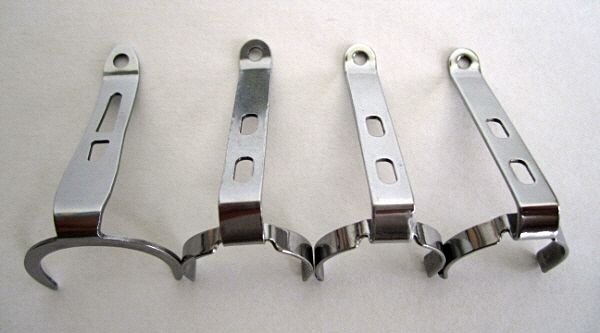

    The clip has no grip ring bundled with light. The clip is just the same in MSA10, MSC20, MSA20 except MSC10.
    The clip is reversible for MSA10, MSC20, and MSA20 except MSC10. (i.e., it can be positioned for bezel-up or bezel-down carry. But with this kind of the clip, there is a risk the light might catch on something and be pulled off.) All lights can tailstand stably. The overall build quality seems very high.

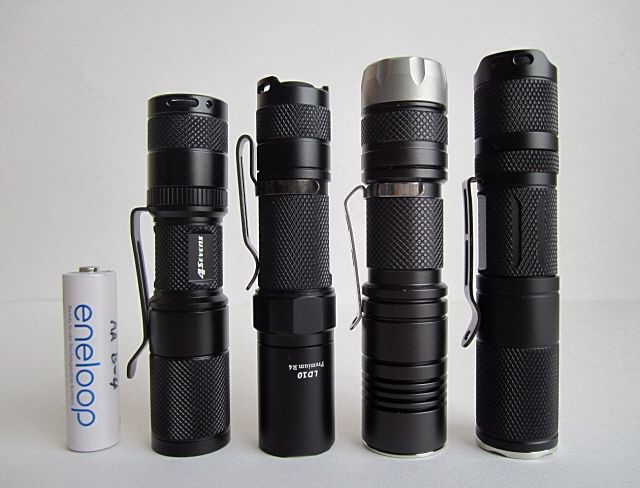

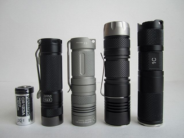

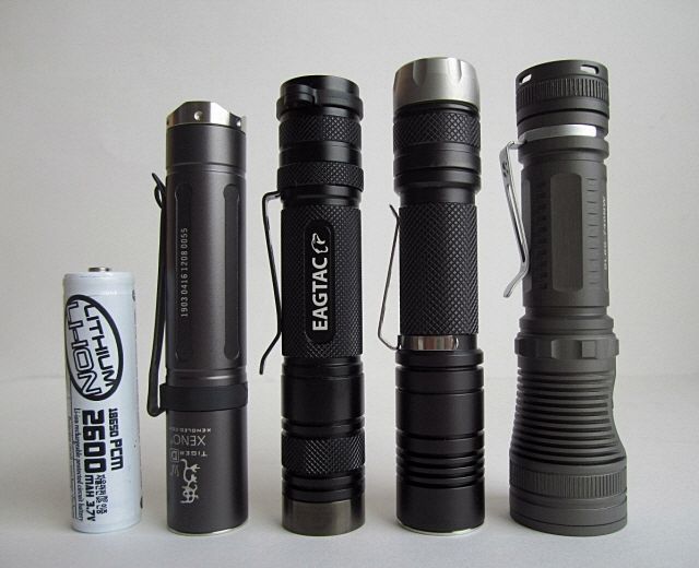

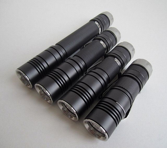

    From left to right : Panasonic CR123A, Eagletac D25C, Sunwayman M11R, Niteye MSC10, Thrunite 1C.
    From left to right : Eneloop AA, 4Sevens Quark AA, Fenix LD10, Niteye MSA10, Thrunite 1A.
    From left to right : VicLite 18650, Xeno S3A, Eagletac D25LC2, Niteye MSC20, Spark SL6S-740NW.
    From left to right : Eneloop AA, 4Sevens Quark 2AA, Olight T25, Niteye MSA20, Fenix E21.

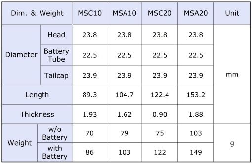

    Measured dimension & weight

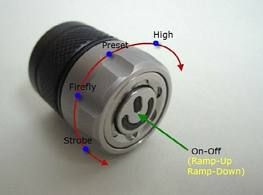

    You may use both your thumb and forefinger on either side of the control ring while holding the rest of the light with other fingers & palm to adjust the control ring. The gripability & twisting the control ring are reasonably good.
    On-Off & ramping are controlled by the PD switch – press and release to turn the light on or activate each output level. Turn the light off by pressing and releasing the PD switch again.
    Mode switching is controlled by the magnetic control ring.
    The control ring has 4 mode positions (or 4 detents). i.e., there are [Strobe] - [Off] - [Preset] - [High], arranged clockwise.
    [Correction 08.19.12] [Off] ---> [Firefly] [Correction 08.19.12]
    The Preset mode is a memorized custom output level, selected by the user. This mode has memory, and retains the last setting used. If you press and hold the PD switch when the control ring is at Preset position, the light will ramp up from the current set level to high. (Note the light does not ramp back down to low. It just stays at high level.) If you release, press and hold the PD switch again, the light will ramp back down to low. Also the light stays at low level. This ramping up or down continues until you let go of the PD switch, at which point the current output level is set and memorized unless you do start a new ramp.
    My MS samples all suffer from a brief "pre-flash" of momentary higher output when making initial contact of the battery with the tailcap and a second pre-flash when loosening the tailcap. It's not severe, but may be annoying for some users. I think this per-flash is not mostly unrelated to the PD switch.

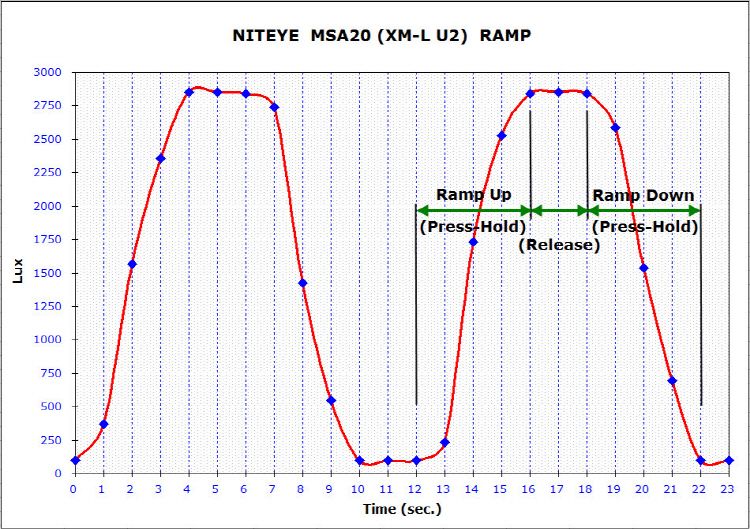

    Ramping time is just 4 seconds for each ramping up or down, and all samples are the same. The low output level of the ramp is brighter than firefly as expected.
    The ramping time is too quick to select the output level, so I'd like to suggest Niteye to increase the ramping time to 8~12 seconds on the production version.

    Due to the magnetic control ring interface, the MSA20 is drawing a small current when the light is fully connected. I measured this current as 0.33mA. Since the cells are arranged in 2S, for 2xEneloop AA (2000mAh) cells, that would translate into around 8 months before they would be fully drained. This is not bad, not a concern. But I would recommend you to store the light locked-out when not in use.

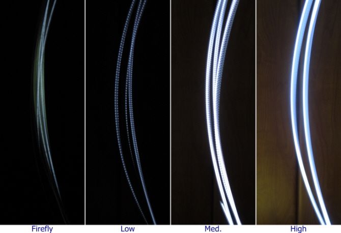

    PWM
    I can see flickering at the rest except Firefly & High output, but can't see it visually in practical use. I notice that there is no buzzing sound on any ouput levels.

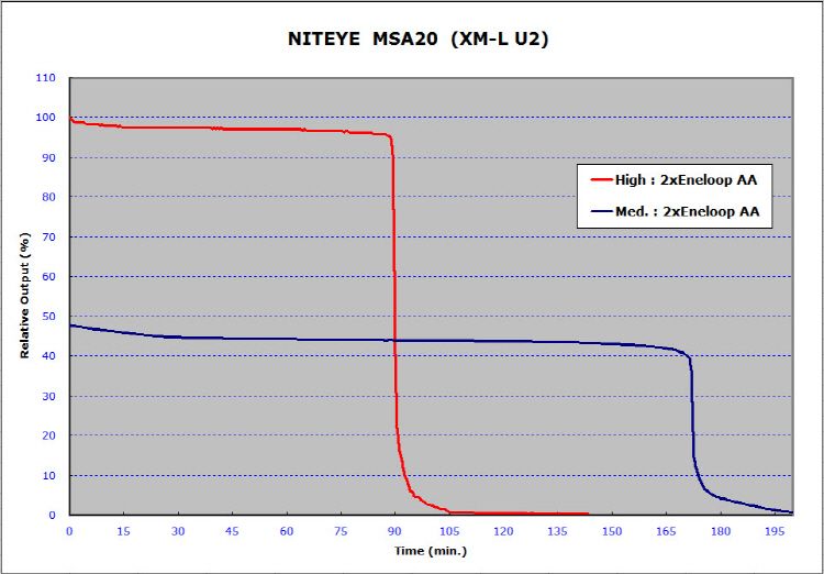

    Runtime
    I think the performance on 2xAA Eneloop seems good and reasonable as I expected. The runtime for 50% output of high & med. is appr. 90 mins and 172 mins respectively in my test. The runtime for 10% output of high & med. is appr. 92 mins and 179 mins respectively.

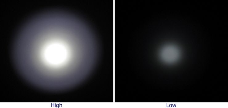

    Beamshot
    1. White door beamshot (about 50cm from the door)
    - ISO100, F/3.5, 1/100sec, Auto white balance
    - High
    - Low

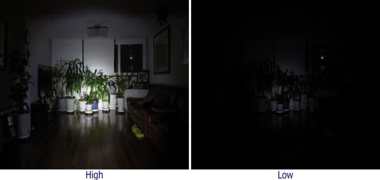

    2. Indoor beamshot (about 7m from the target)
    - ISO100, F/2.8, 1/2sec, Auto white balance
    - High
    - Low

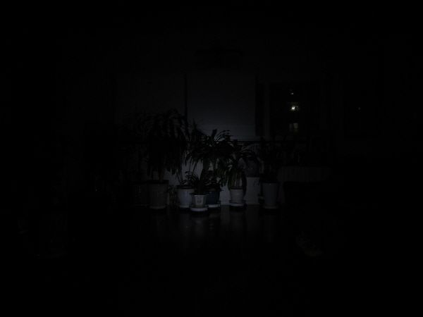

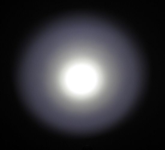

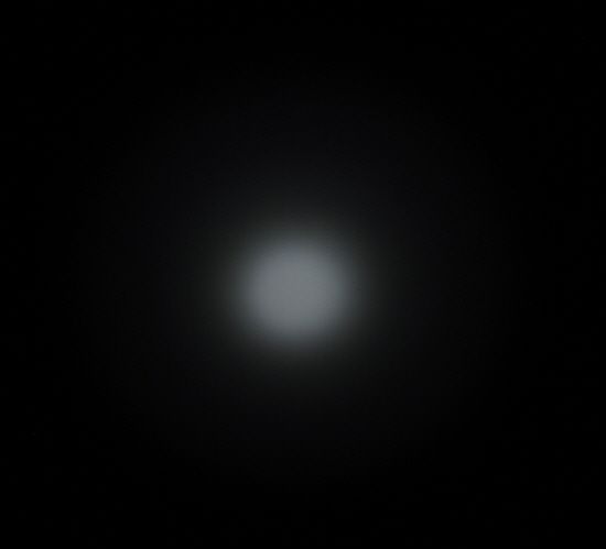

    3. Firefly beamshot
    - ISO100, F/2.8, 1/3sec, Auto white balance
    It doesn't seem like a firefly mode, looks like very low to my eye.

    It would have been useful to have the firefly mode on this light.
    Thanks again

    Thanks hakyru!
    I agree with everything you said. The firefly mode is quite a useful output, but there is no firefly on MS series production version.
    It seems the manufacturer initially didn't plan to make firefly mode available to the lights.
    As you mentioned above, MSC10 works about 2~3 seconds when the control ring is at Off position (i.e., XM-L U2 emittet on the head & battery indicator on the tailcap work just few seconds when you turn the light off by using the control ring). So "Firefly" should be modified to "Off" in UI of my above review.

    I'm confused candle lamp...in the last picture in your review, you show the head & emitter captioned: "It doesn't seem like a firefly mode, looks like very low to my eye".
    Yet in post #21 you seem to be refering the the emitter/led that shows battery status as the firefly mode? Are you stating that the battery status light goes off after turning the light off...or do you mean there is no true sub-lumen low capable at the head eg (moonlight mode)?...or both?
    In post #8 you replied that the indicator light remained on after the light is turned off (and could be used as a locator beacon), but as I now understand it, the production version does not? Is this correct?
    Jun 2010
    South Korea
    787
    Default Re: Niteye MS Series (MSC10, MSA10, MSC20, MSA20) Review
    It means a firefly mode is not a real firefly but lower low mode to me in brightness.
    When turning the light off, LED on the head & battery indicator on the tailcap are turned on at the same time, but go off in 2 seconds at the same time.
    (There is very low lumen at the head for 2 seconds only. Also battery indicator has very low brightenss at the tailcap for 2 seconds.)
    Yes, that's correct. The indicator light doesn't remian on the production version. (It does remain for 2 seconds.)
    Latest Reviews : Olight M10 Maverick

    Yes it would have been good to have lights in the rear for a locator but that's what trits are for no battery drain
    I like the magnetic ring on the end as in the past any magnetic ring lights I've had are enjoying to have to click tailcap button to turn on (over hand or two handed) then change hand position to control the output and take 10% cpf discount off makes it a good deal.

    +1 on ditching the strobe and adding another preset mode. I don't like nay-saying lights that weren't made for me, but this one was so close to what I was looking for I wanted to throw my thoughts out there.
    From the Thrunite scorpion I've really come to love control rings on the tail - hold it with one hand and flip the ring with your thumb for some of the fastest, simplest and POTENTIALLY logical /intuitive mode changes.
    However like the Thrunite this seems to place the strobe in an illogical place where it can easily be accidentally stumbled upon like a land mine while trying to keep your night vision.
    With control ring lights like the TN31 and scorpion it really is hard to NOT accidentally hit the strobe mode while carefully turning on the light in the dark and TRYING/HOPING you are in the lowest mode.
    Firefly/Low Preset/Mid Preset/Turbo seems so logical compared to Firefly/"Obnoxious useless strobe"/Low/Turbo...
    Jun 2010
    South Korea
    787
    Quote Originally Posted by rickypanecatyl View Post
    Strobe may have an advantage for those who need it. Personally, I rarely use that mode.
    I think the light can hit the unwanted strobe mode as you said, because all modes are controlled by the control ring on the production version.
    The light has no firefly mode any longer on the shipping version. i.e., there are [Strobe] - [ Off ] - [Preset] - [High], arranged clockwise.
    The PD switch is now a secondary switch for turning off Strobe or Preset or High. It's still used for preset ramping up-down.
    Note that the production version's preset output is low to high, but the "preset high" is not the same brightness as [High]. See below.
    So the preset output is useful to those who need the lower output than High mode.
