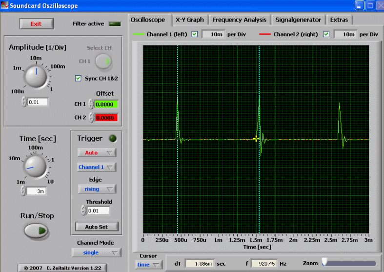

    PWM/Strobe
    Lo:
    Med:
    Hi:
    As on the XT11 uses PWM of just under 1 kHz. PWM is an apparently unavoidable by-product of having a tailcap control circuit combined with a head circuit. At least the frequency is high enough not to be visually distracting, like on some other lights.
    And like the XT11, that PWM signal is again present on the Hi mode. PWM is never as noticeable on Hi (as the light is "on" most of the cycle), but it does seem to be slightly more significant here on the XT30 than my either XT11 or RS11 lights.
    Again, like the XT11, the XT30 uses an oscillating strobe, switching between 5.7Hz and 14.2 Hz every ~1.5 secs.
