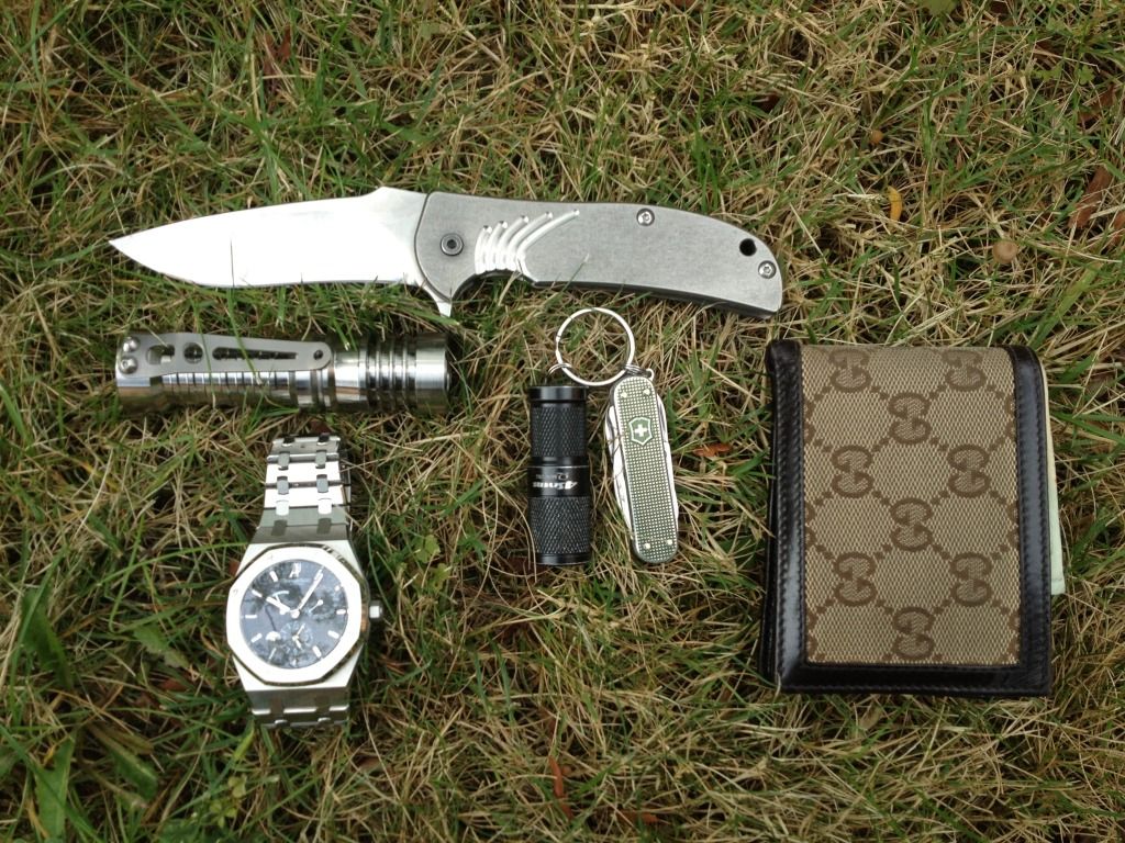

    Thank In advance for all your help, and here is a pick of my EDC, always makes a thread more fun.
