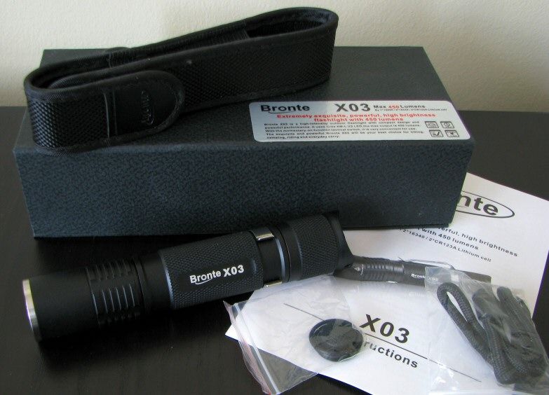

    My TU10-Ti sample came in hard cardboard box with magnetic closing flap. Along with the light, you get a manual, spare o-rings, decent wrist strap, and belt holster (with closing flap). There is no pocket clip with the TU10-Ti.
    My X03 came in similar packaging, although plainer with less customized decals on the box. Along with the light, you get a manual, spare o-rings and switch boot cover, very basic wrist strap, belt clip (attached to the light) and belt holster (with closing flap).
    With the exception of the more basic wrist strap on the X03, the included extras are not all that different between the models. The manuals have virtually identical instructions (in keeping with seemingly identical circuits).

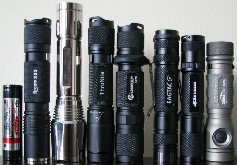

    From left to right: AW Protected 18650; Bronte X03, Tu10-Ti; Thrunite TN12; Luminto ED20; Eagletac G25C2; 4Sevens Quark 123-2-X; Zebralight SC600.

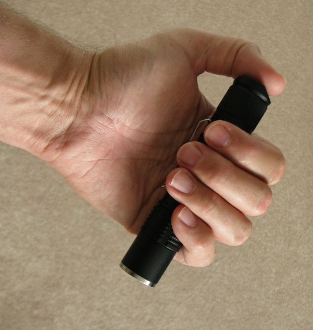

    As you would expect for a titanium light, the TU10-Ti is heavier than most of the competition.
    Fundamentally, most flashlights share a similar build (i.e., a head, a body/battery tube, and a tailcap). What distinguishes these two models is the choice of body material, overall size and styling.
    Most of this review will focus on the TU10-Ti, but for now, let's start with the simpler X03 build:

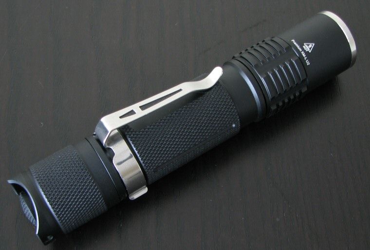

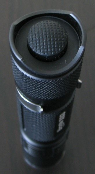

    Here on the X03, you get a traditional aluminum build, with matte black anodizing (no damage on my sample). Labels are bright white, sharp and clear against the black background. There is a generous amount of knurling, and it quite aggressive compared to most lights I come across.
    Light comes with a basic stainless steel pocket clip (clip-on style, but seems to hold firmly).

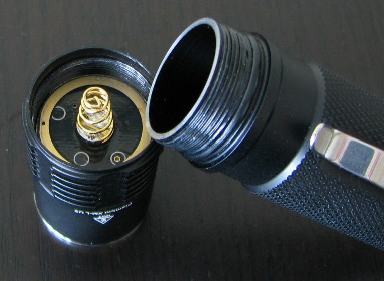

    There is a spring on the positive contact board in the head, so flat-top cells should work fine.
    Screw threads are square cut in the tail region of light, but are not anodized. However anodized threads are provided in the head region, so you can lock out the light by a head-twist. Note that the head threads are standard triangular cut (and rather fine at that). I would have preferred more substantial threads in the head region.
    Light uses forward clicky tail switch. Light can tailstand, but is a bit wobbly.
    Light has a flat stainless steel bezel ring in the head. The reflector is a reasonable depth for this size diameter light, with a well centered XM-L emitter on my sample. Reflector is textured (i.e., medium orange peel) to smooth out the beam.
    All-in-all, the X03 reminds me of a high-end budget build, or an entry-to-mid level brand-name build for this class light.

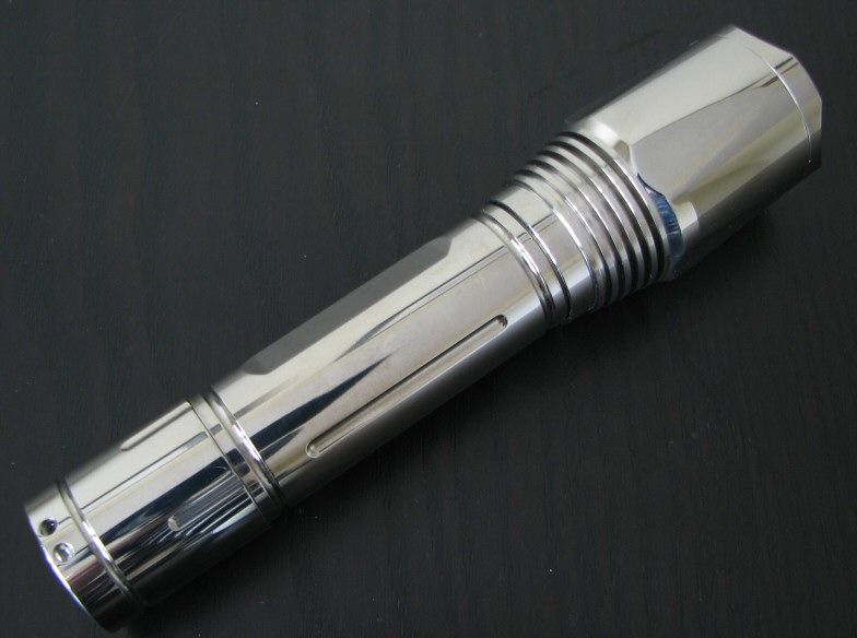

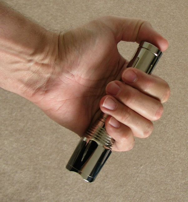

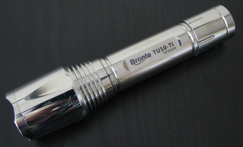

    The TU10-Ti is another beast all together. Featuring TC4 titanium alloy, the TU10-Ti has a distinctive look and feel.
    Weight has obviously increased, and the light has a substantial feel. There is relatively limited ridge detail, and body feel is fairly smooth (i.e., grip is reduced). I find fingerprints show up easily on the shiny finish (but are easily wiped off). Labels are subtle, in a darker finish.

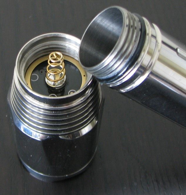

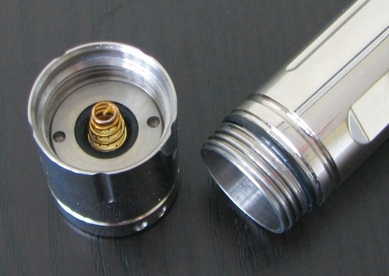

    As before, there is a spring on the positive contact board in the head, so flat-top cells should work fine.

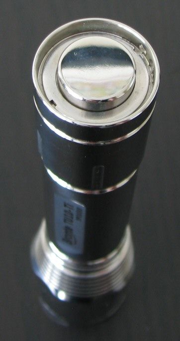

    Unlike the X03, I am happy to report screw threads are square cut at both ends of the battery tube. Threads seem of particularly good quality, with only a very limited amount of galling on my sample (common to titanium lights). Lockout has also been maintained at the head of the light (presumably by insulating the circuit board contact ring from the body, requiring a tight connection to the battery tube).
    Light uses a protruding forward clicky tail switch. As the switch cover is flat, the light can tailstand – but is very wobbly.
    One comment here – switch feel is surprisingly good. I've tested a number of lights with metal boot covers, and have always found them rather frustrating in use. You typically need to press them dead-center (or the light won't activate), and they often stick upon release (especially titanium ones – likely related to the galling issue). In contrast, my TU10-Ti sample works perfectly – a light press (even off-centered) is able to activate the light, and switch action is smooth.

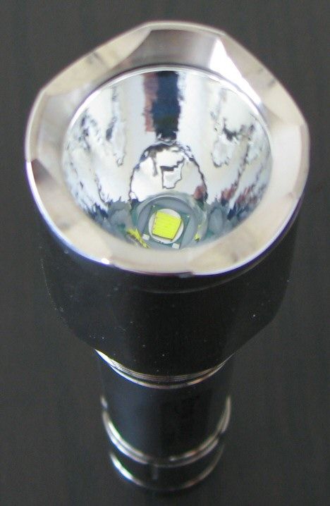

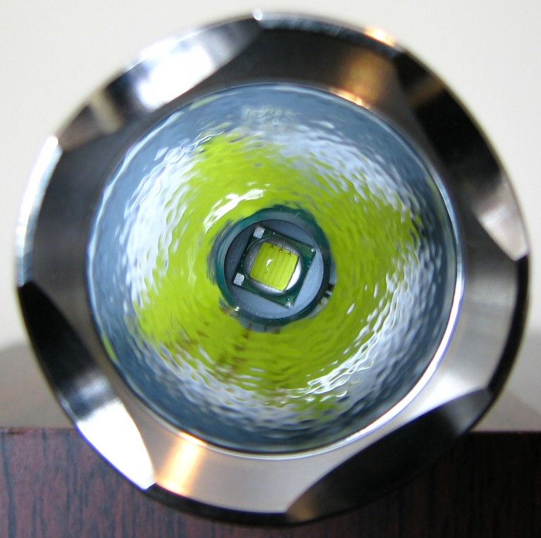

    Light uses a crenelated bezel, also of apparent titanium construction.
    The head is larger than the X03, with a wider and deeper reflector (textured MOP as before). Emitter is again well centered on my sample, and I would expect better throw than the X03. Scroll down for beamshots.
    This is my first all-titanium 1x18650-class light, but it appears to be of quality construction.

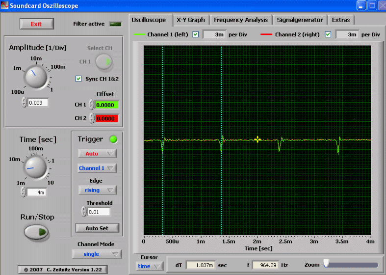

    PWM/Strobe
    TU10-Ti Lo:
    TU10-Ti Med:
    TU10-Ti Hi:
    The Tu10-Ti uses PWM of ~960 Hz. PWM signal is detectable on all levels, including Hi. However, just like my Klarus RS11, there is no obvious visual evidence of flicker on the Hi mode. This spike on the Hi mode oscilloscope trace may thus be some sort of circuit filtering.
    X03 Lo:
    The X03 uses a similar PWM at all levels, of ~970 Hz on my sample (representative Lo mode shown above). Otherwise, it appears identical to the TU10-Ti – including the spike on the Hi level. But as before, I am unable to see any visual evidence of PWM at this level (even when shinning on a fan).
    This is an interesting parallel to the Klarus RS11, and one I will come back to later in the review.
    Strobe is a fairly typical 8.9 Hz on both my TU10-Ti and X03.

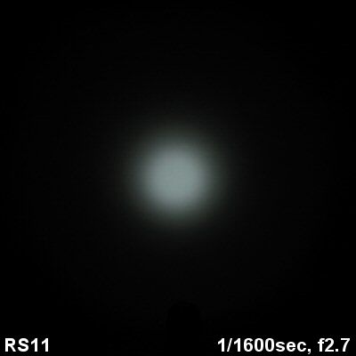

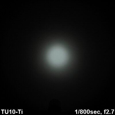

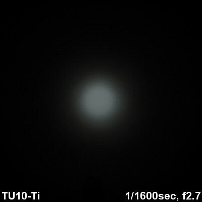

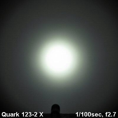

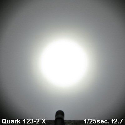

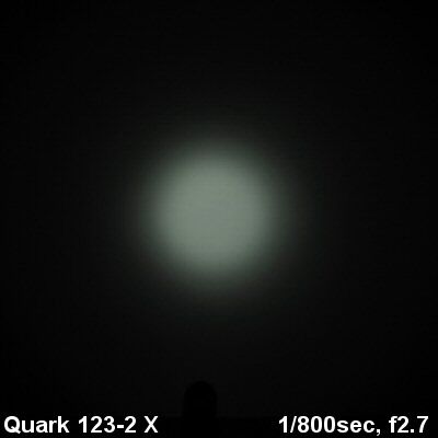

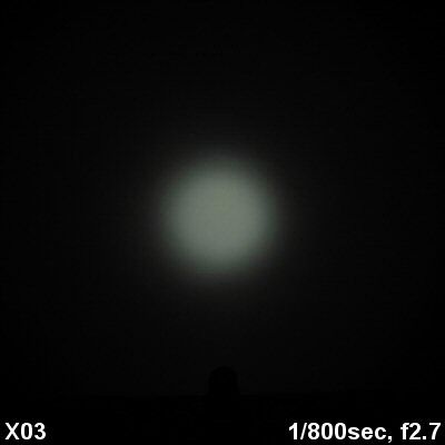

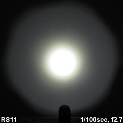

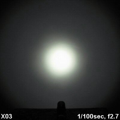

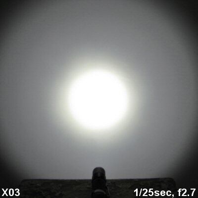

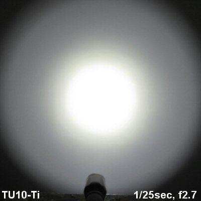

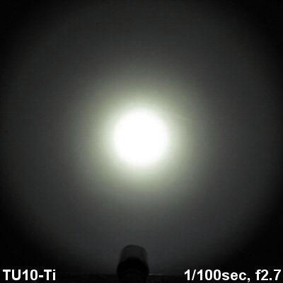

    Time for the white-wall beamshots. All lights are on Max output on an 1x 18650 AW protected cell. Lights are about ~0.75 meter from a white wall (with the camera ~1.25 meters back from the wall). Automatic white balance on the camera, to minimize tint differences.
    The beam pattern is very much what you would expect for heads/reflectors this size. The TU10-Ti is a bit throwier than the X03.
    First point to note is that overall output is virtually identical between my TU10-Ti and X03 samples, at all levels tested, on all battery types. The specs refer to the TU10-Ti as "500 lumens" (vs the X03's "450 lumens"), but it seems to me that both lights are properly ~450 estimated lumens.

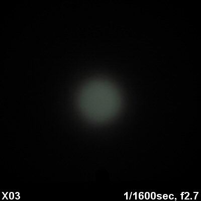

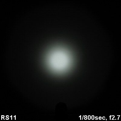

    Throw is increased on the TU10-Ti, as you would expect for the larger head and reflector.
    Overall, output and throw are quite consistent for other lights this size.

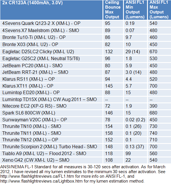

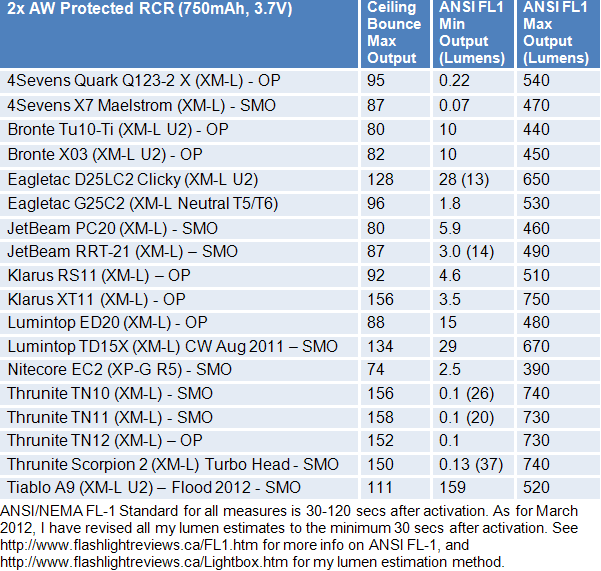

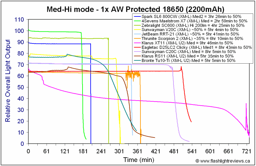

    Output/Runtime Comparison:
    First off, I didn't continue all the runtime testing on the X03 once I realized the performance was identical to the TU10-Ti (e.g., check out the Hi mode 1x18650 and 2xRCR). Again, for all intents and purposes, they appear to the have the exact same circuit.
    The runtime graphs may look a little obscured in the 1x18650 Hi mode run, but the similarity of the X03/TU10-Ti to the Klarus RS11 is unmistakable. Although the X03/TU10-Ti do not have a step-down mode, they have exact same pattern of fine oscillations over the initial course of the run, followed by a definite uptick and slow decline before falling out of regulation. You can see this even more clearly in the Med 18650 runtime graph. This "signature" is distinctive, and suggests to me they are using comparable circuitry to the Klarus RS11.
    The spacing of output levels is also similar to the RS11 (although not exact). But for all intents and purposes, you would be hard-pressed to notice much of a difference between the performance of these lights.
    This result is interesting, in light of the extremely similar oscilloscope traces for the X03/TU10-Ti and Klarus RS11.
