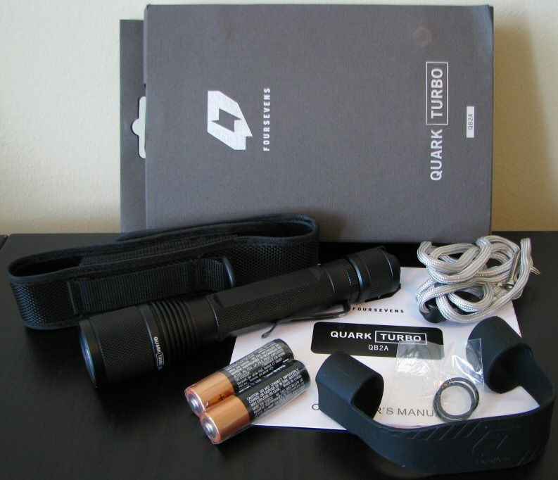

    Packaging for the Foursevens brand has also been updated from the earlier 4Sevens models. The lights now come in a thin gray cardboard box, similar to the original black-box Quark models (although the cardboard is much thinner and more easily damaged now).
    Inside the presentation-style box, you will find a clamshell plastic case with the light and all bundled extras. Both lights came with batteries (Foursevens-branded CR123A, or Duracell alkaline AA), good quality lanyard, split ring for keychain attachment, spare o-rings, decent quality holster with velcro closing flap, and appropriate size rubber hand-grip.

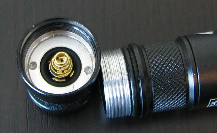

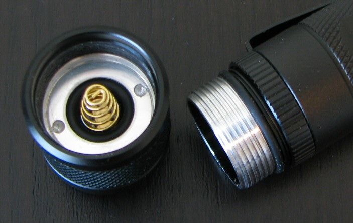

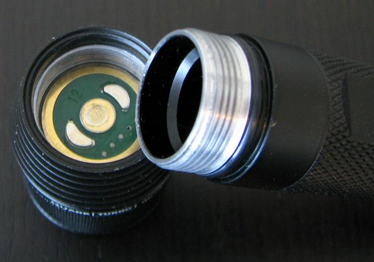

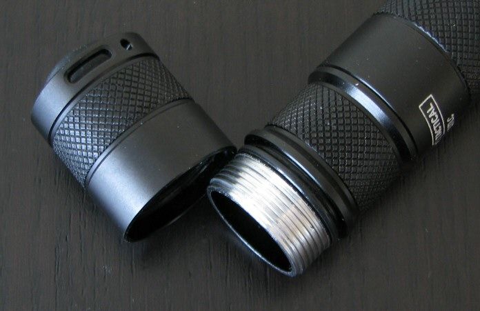

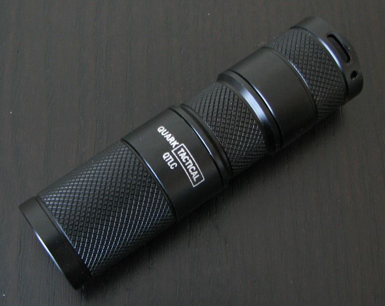

    Both lights have a glossy black finish (hard anodized), with no obvious chips or damage on my samples. Both lights have a generous amount of knurling to help with grip, and the knurling is of reasonable aggressiveness. Lettering is bright white and sharp against the black background.
    The QTLC looks a lot like the original Quark 123, but without the pocket clip. The QB2A has a removable pocket clip secured in place by its own cover/grip ring (i.e. unscrew the ring to remove the clip, screw back down to cover the gap where the clip attaches).

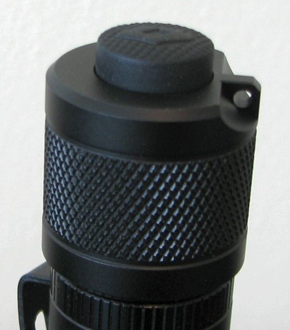

    The QTLC has holes on the side of the tailcap for a split-ring or lanyard attachment. The larger QB2A tailcap has a cut-out region of reasonable thickness. Both lights feature a protruding forward clicky switch (Foursevens "Tactical" interface, as explained below).
    Both lights use square-cut screw threads (or more accurately, trapezoidal), at both ends of the battery tubes. Threads are not anodized on the body, but the tailcaps have anodization to provide tail lock-out. This arrangement is less secure for lock-out than dual anodizing, but it does allow you to reverse the direction of the body tube (useful for models with a clip, like the QB2A).

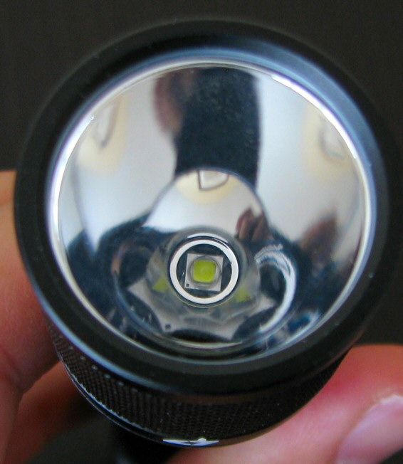

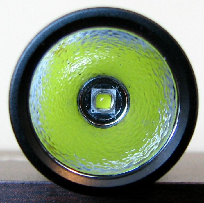

    Emitters/Reflectors:
    QTLC
    QB2A

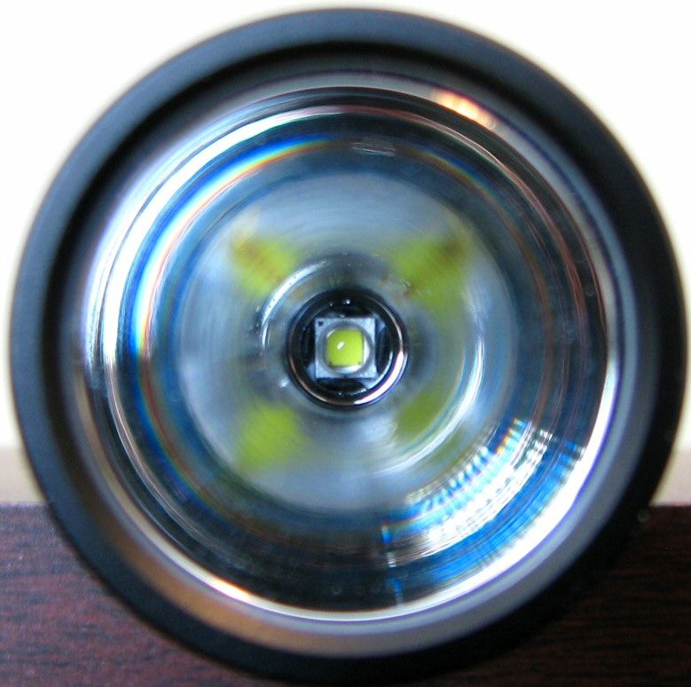

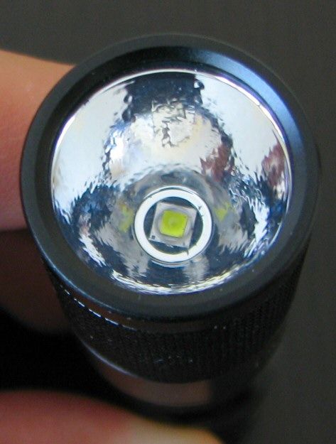

    The QTLC has a medium orange peel (i.e., textured) reflector. The QB2A has larger head with smooth deep reflector for maximum throw. Both lights had well-centered reflectors on my samples. Visually, the XP-G2 doesn't look very different from a typical XP-G – except for a silver circuit board mask instead of green. I doubt the reflectors have changed any from the earlier XP-G models.
    Note that the Cree specsheets report a lower emission angle for the XP-G2, down to 115 degrees (from 125 degrees on the XP-G). So there are likely to be some small beam pattern differences when used with the same reflector design.

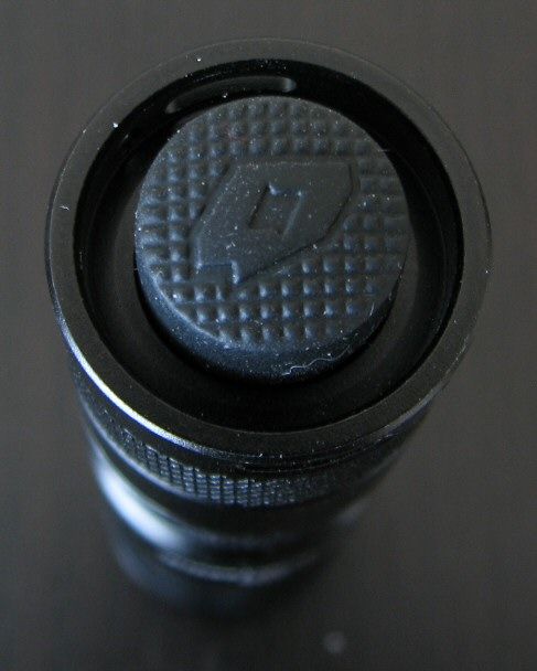

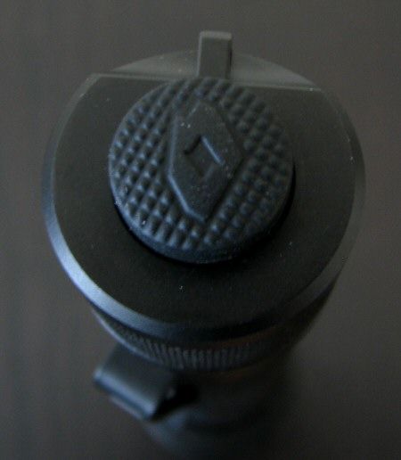

    Both lights use the standard Foursevens Tactical interface.
    Turn the lights on/off by the tailcap switch – lightly press for momentary on, click for locked-on.
    With the Tactical interface, you can configure the bezel loose/tight states to have one memorized level from the total mode set (i.e, head tight for one set mode, head loose for another). Available modes to select from when programming the states are Moonlight, Lo, Med, Hi, Turbo, SOS, Strobe, and Beacon mode, in sequence.
    To reprogram the each bezel state, you need to loosen-tighten the head 4 times quickly, ending in the state you want to re-program. After 3 secs, the light will flash 3 times, and you can now advance through all the possible modes by soft-pressing or clicking off-on at the tailswitch. To select the mode you want memorized, wait 10 secs with the light on in that mode. The light will flash rapidly, signifying memorization of the mode state. It is now safe to turn off - it won't change unless you go through the programming mode again.
    As always, please see my detailed examination of the build and user interface in my video overview:

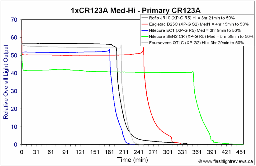

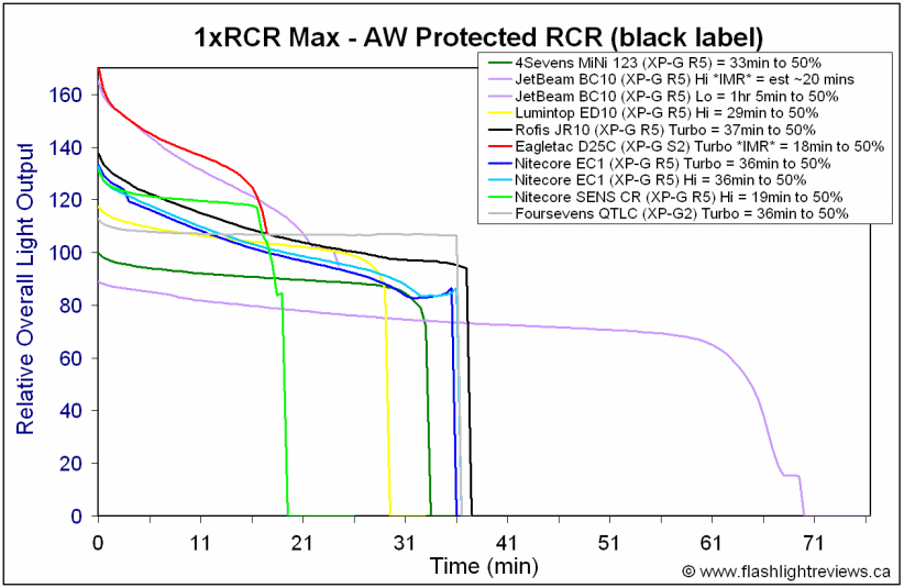

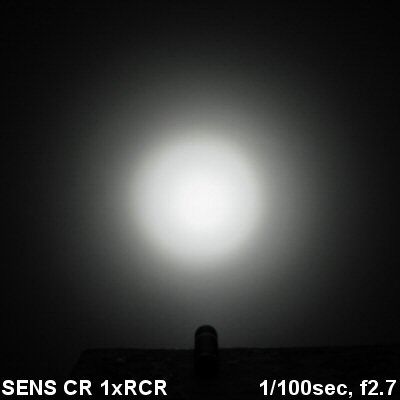

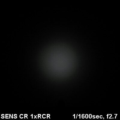

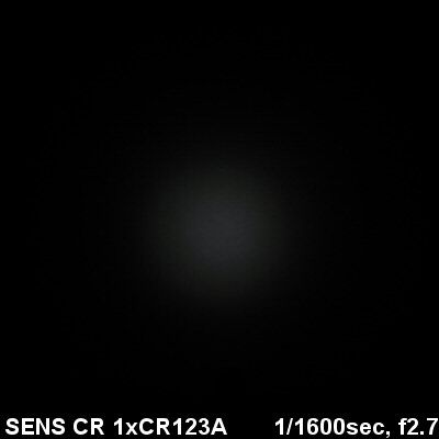

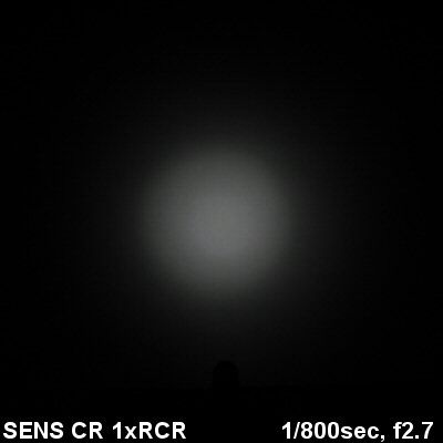

    All lights are on Turbo/Max on 1x AW protected RCR in the first set of panels, followed by 1xCR123A in the second. Lights are about ~0.75 meter from a white wall (with the camera ~1.25 meters back from the wall). Automatic white balance on the camera, to minimize tint differences.

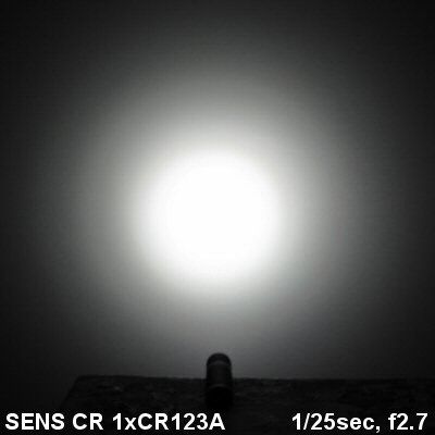

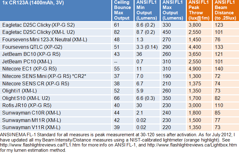

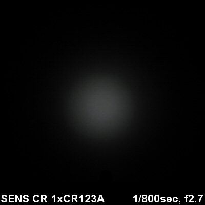

    And now on primary 3V 1xCR123A:

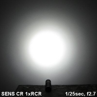

    Again, a fairly typical beam for this size light. Beam pattern doesn't seem very different from a standard XP-G-equipped light.
    Foursevens has done a good job keeping output consistent across primary CR123A and rechargeable Li-ion battery sources. However, as always, my estimated ANSI FL-1 lumens are higher than the Foursevens specs. But all my lights are tested in a consistent way, so the relative relationships in the tables still hold.

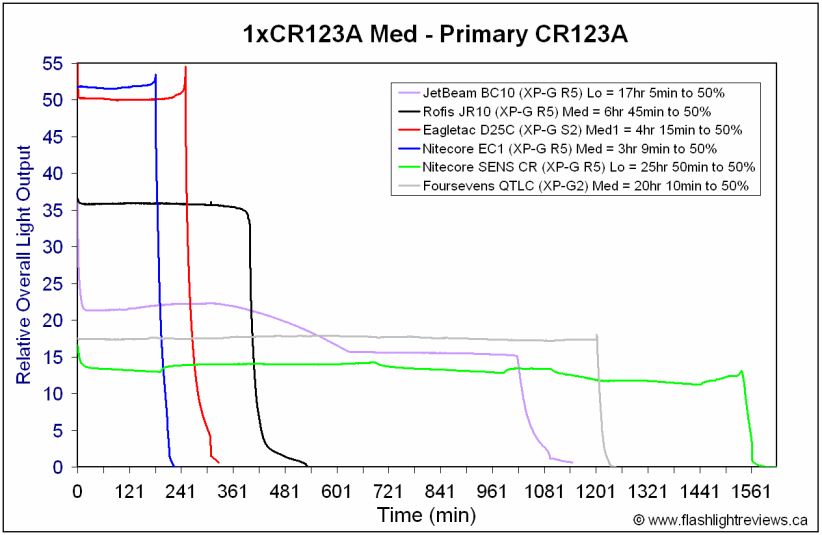

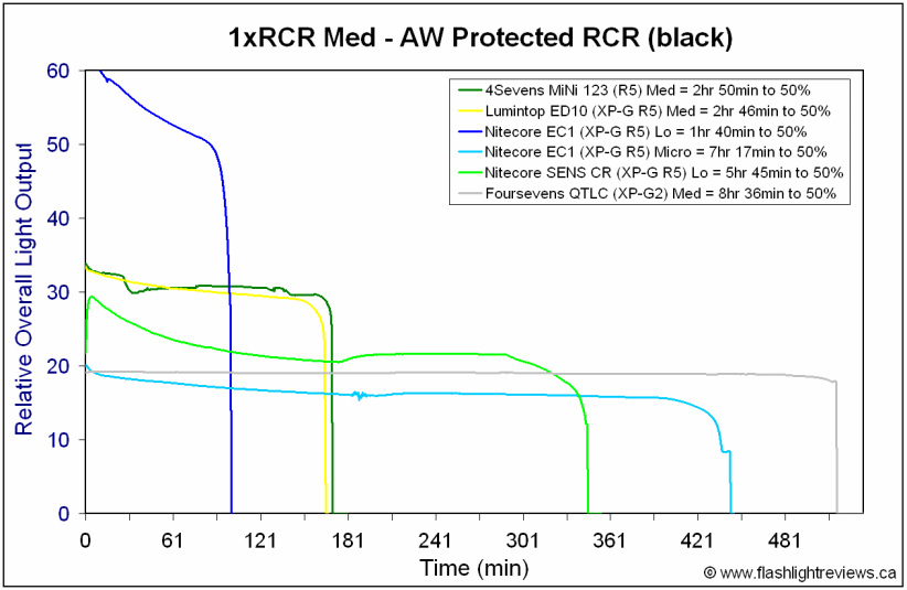

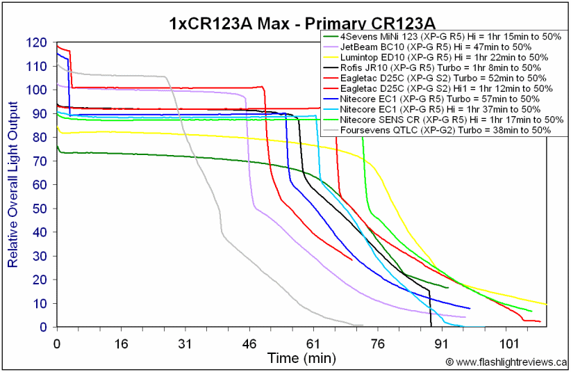

    Output/Runtime Comparison:
    The QTLC is a good performer for the class and output level, but the XP-G2 doesn't appear to offer any obvious advantage over competing XP-G R5/S2 equipped lights. More on this in my comments at the end.

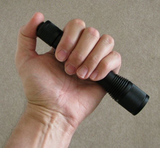

    QB2A Review
    From left to right: Duracell AA NiMH; Foursevens QB2A, Quark AA-2-X, Mini AA-2; Eagletac P20A2-II; Fenix LD20-R4; Nitecore EA2.
    Foursevens QB2A: Weight 102.9g, Length 158mm, Width (bezel) 30.0mm
    Eagletac D25A2: Weight: 54.8g, Length 148.5mm, Width (bezel): 21.0mm
    Foursevens QAA-2 X (Tactical tailcap): Weight: 60.1g, Length: 149.1mm, Width (bezel) 22.0mm
    Jetbeam PA20: Weight: 82.52g, Length: 160mm, Width (bezel) 22.6mm
    Jetbeam BA20: Weight: 70.2g, Length: 156.4mm, Width (bezel) 23.2mm
    Thrunite Neutron 2A: Weight: 76.4g, Length: 250mm, Width (bezel) 22.0mm

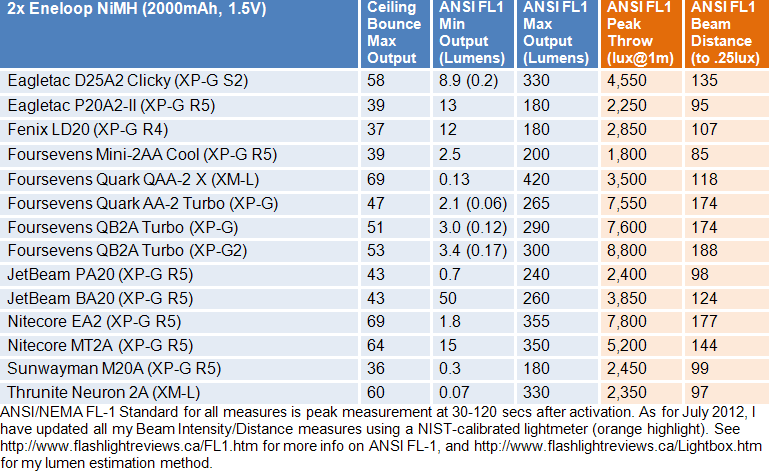

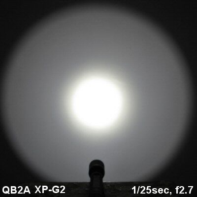

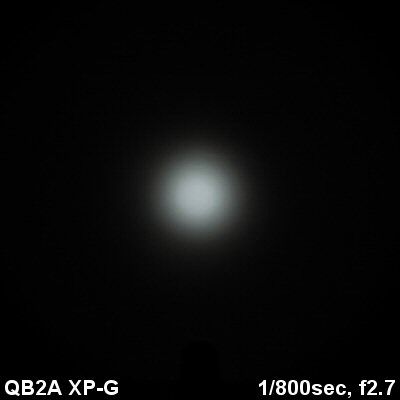

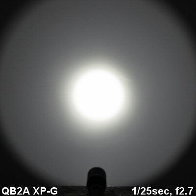

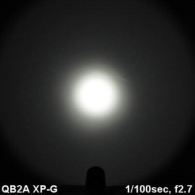

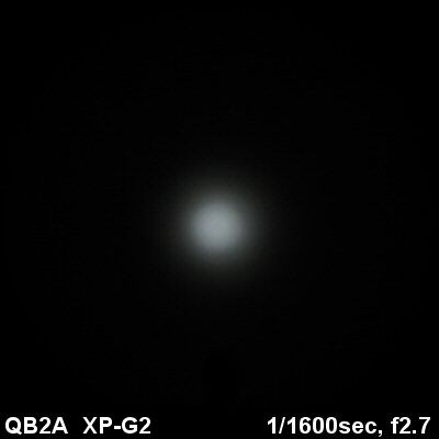

    All lights are on Max output on 2x Sanyo Eneloop AA NiMH. Lights are about ~0.75 meter from a white wall (with the camera ~1.25 meters back from the wall). Automatic white balance on the camera, to minimize tint differences.
    Note: I have included a recent XP-G-equipped QB2A in the comparisons below. It is specifically labelled "QB2A XP-G". The new XP-G2-equipped QB2A is labelled "QB2A XP-G2".
    The XP-G2 version of the QB2A appears to throw a slightly tighter hotspot (i.e., more narrowly focused). Hard to tell from a single sample of each, though. In any case, the QB2A is one of the best throwing 2xAA lights I've tested to date.
    UPDATE November 4, 2012: I've updated my summary table below with the results of an earlier stock Foursevens Quark AA-2 Turbo XP-G (identical to the QB2A XP-G model previously compared to here). See discussion at the end of the review.
    Again, my estimated ANSI FL-1 lumens are higher than the Foursevens specs. But all my lights are tested in a consistent way, so the relative relationships in the table still hold.

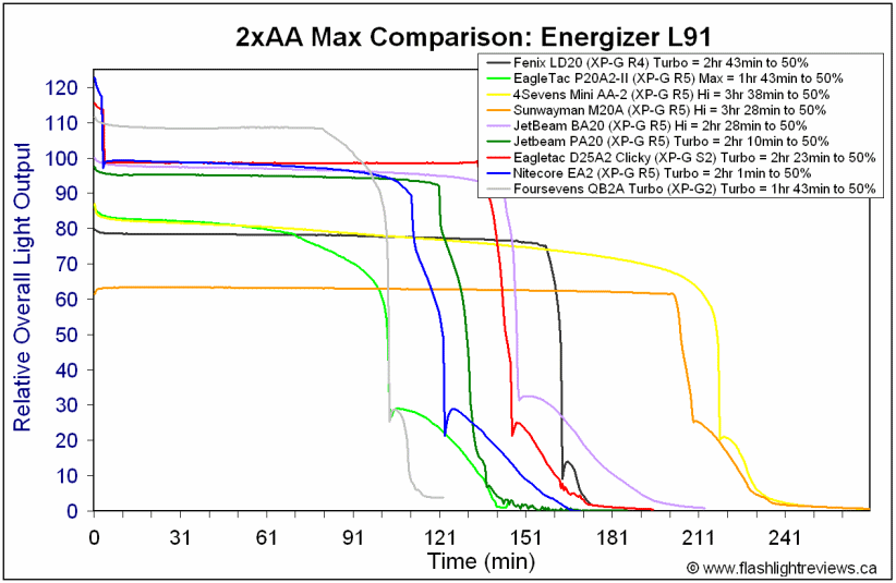

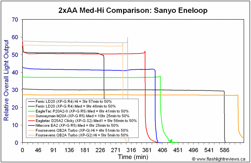

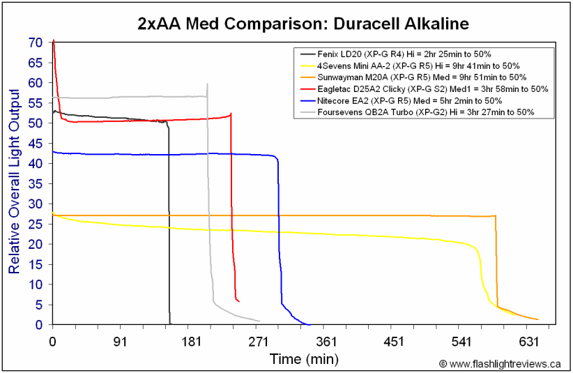

    The first thing you are likely to notice above is that the XP-G2 version of the QB2A is not that much brighter or longer-lasting than the preceding XP-G version of the QB2A.
    On Hi or Turbo, the XP-G2 version of the QB2A is only ~4-6% brighter than the QB2A XP-G version, across most of the runs. Overall runtime is pretty much the same as well, with only a ~1-3% gain for the XP-G2 version on the modes tested (which is well within normal variation for a given model/emitter). I will discuss this limited output increase further in my comments at the end of the review.
    Both my review samples show evidence the common "pre-flash" issue (i.e., when reset to a low output mode, the lights will sometimes come on with a brief high-intensity burst). This seems to occur mainly when you switch down to a lower output mode shortly after turning the light off in a higher mode. It is believed to be due some residual power remaining in the circuit for a short period of time after turning off (and has been around since the early days of the early Fenix, Olight and Foursevens models).
    The tailcaps feature screw thread anodizing, so a physical lock-out is possible. However, this may not be as robust as lights where both the body and tailcap threads are anodized (i.e. a scratch to the tailcap threads may invalidate the lock-out). The body tubes are reversible in on these lights (i.e., identical threading), so you can reverse the pocket clip (when present) by switching the orientation.
    Overall output with the new XP-G2 emitters does not appear to have increased much over typical XP-G emitters (see discussion below). But as usual with Foursevens, my estimated ANSI FL-1 lumens are higher than the reported output specs.

    I don't really understand why Cree are marketing the G2 this way. The 20% figure is very misleading.
    Well, I can understand why they have switched to the more stringent bining process (i.e., 350mA @85 degrees C is more representational of the real world than 25 degrees C was). But I agree that "up to 20%" figure is not very helpful.

    Thanks, glad to hear folks are finding them useful.
    As an aside, this is the first time I've reviewed a Quark "Turbo" model (i.e., the QB2A, which directly replaces the old Quark AA-2 Turbo). It definitely seems to be an excellent choice for those looking for max throw in the 2xAA format.
    6,936
    Default Re: Foursevens XP-G2 Review: QTLC (1xCR123A/RCR) & QB2A (2xAA) RUNTIMES, BEAMSHOTS, M
    I've updated this review with the results of an earlier stock Foursevens Quark AA-2 Turbo XP-G that I just picked up. Note that this light is identical to the QB2A XP-G model previously compared to here (i.e., it is just the older logo/labeling).
    Given the single bin step difference between my QB2A samples, I strongly suspected my QB2A XP-G was a S2 output bin (but have no way to verify). As you can see in the summary table, my QB2A XP-G was ~10% brighter overall than my Quark AA-2 Turbo XP-G. This would be consistent with a R5 output bin for the Quark AA-2 Turbo sample, and a S2 output bin for the QB2A, for example.
    It thus seems reasonable that you could expect one or two bin steps up with the QB2A XP-G compared to the earlier QB2A/Quark AA-2 Turbo XP-G models.

    Thank You selfbuilt for the great explanation of XP-G vs. XP-G2, especially with regard to how the bins relate to each other.
    My only experience so far with XP-G2 is a nailbender P60 dropin. I was very surprised with how well it throws for a standard P60 reflector, but to my eyes the hotspot was also larger than a typical XP-G P60. The XP-G2 hotspot was fatter than an XP-G, but still narrower than the XM-L. I'll give you that this is completely non scientific, but that is my first impression. I'll have to pay more attention to what you and others see because from what you have described here my dropin example is not exactly what I would expect to see.

    I'm not entirely sure how useful comparisons of xp-g2 lights against xp-g lights are considering that the output is entirely dependent on how much current the manufacturer is driving through the emitter, which is all over the board with the various lights out there. I would be interested in a comparison of the current draw of each from models producing roughly equivalent output, though

    Not a lot of info with the new emitters, but it should be fairly representative. The regular head should have basically the same driver as the Turbo, so I'd use that as a proxy, but there's a 1x14500 test on post 70.
