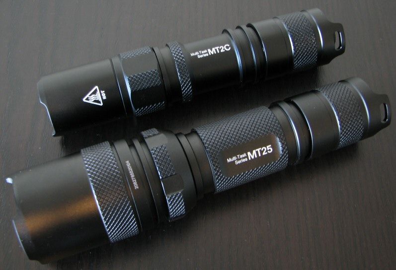

    This is my third (and final) review of the "Multi-Task" MT-series lights from Nitecore. In this review, I am comparing the performance of two of the 2xCR123A/RCR, 1x18650 models – the MT2C and MT25. Please see my recent MT1C/MT1A/MT2A and M40 reviews for more details on those models.

    MT2C
    • Output/Runtime: Turbo: 360 lumens (3 hours, 45 min), High: 180 lumens (5 hours), Mid: 70 lumens (15 hours), Low: 10 lumens (75 hours)
    • Peak beam distance: 155 m
    • Peak beam intensity: 6,000 cd
    • Use 1x18650 (Recommended), 2xCR123A (Recommended), or 2xRCR
    • Length x Head Diameter x Tail Diameter: 4.92" x 1" x 1" (125 mm x 25.4 mm x 25.4 mm)
    • Weight: 2.6 oz. (76 g)
    • MSRP: ~$48
    MT25
    • Output and runtime: Turbo: 390 lumens (2 hours), High: 180 lumens (5 hours), Mid: 70 lumens (15 hours), Low: 20 lumens (45 hours)
    • Peak beam distance: 228 m
    • Peak beam intensity: 13,000 cd
    • Length x Head Diameter x Tail Diameter: 5.59" x 1.33" x 1" (142 mm x 34 mm x 25.4 mm)
    • Weight: 4.39 oz. (124.5 g) Batteries not included
    • Additional accessory: holster
    • MSRP: ~$54

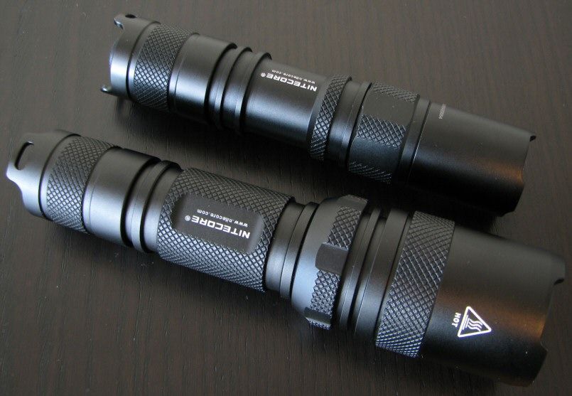

    And now a comparison on the MT2C and MT25:
    From left to right: CR123A; AW Protected 18650; Nitecore MT2C, MT25; Lumintop PS20, ED20; Nitecore EC2; Quark Q123-2; Nitecore IFE2; Jetbeam RRT-21.

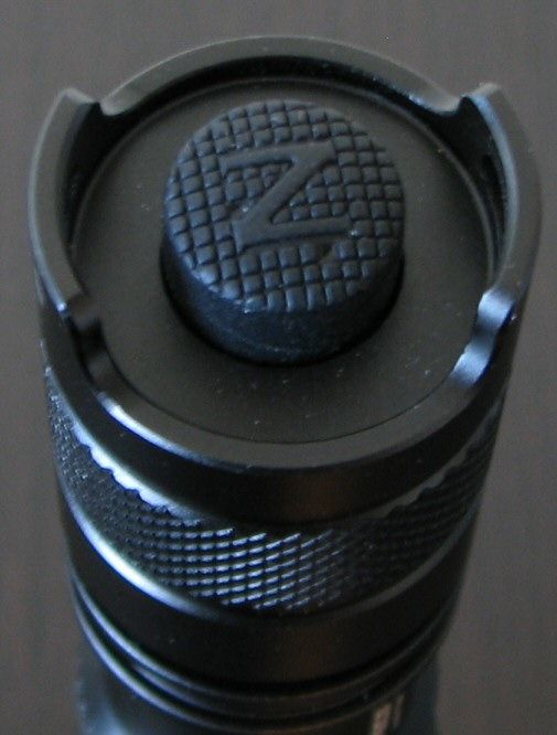

    Anodizing is a matte black, with no chips on my samples. Labels are bright white, clearly legible against the dark background. Both models have actual knurling across the tailcap and portions of the battery tube and head (the MT25 has considerably more than the MT2C). Knurling is actually of reasonable aggressiveness, and grip is improved compared to the Jetbeam Backup-series lights which these new Nitecores most closely resemble (i.e., BC- and BA-series lights).

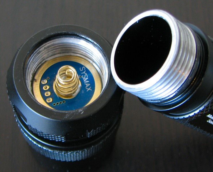

    On the MT2C, there is a reverse-polarity setup in the head, so flat-top cells will not work in these lights (i.e., need a small button top, the same as the MT1C/MT1A/MT2A). The MT25, however, has a spring on the contact board in the head, so flat top cells can be used. Both lights have body tubes wide enough to take high-capacity protected 18650 cells.

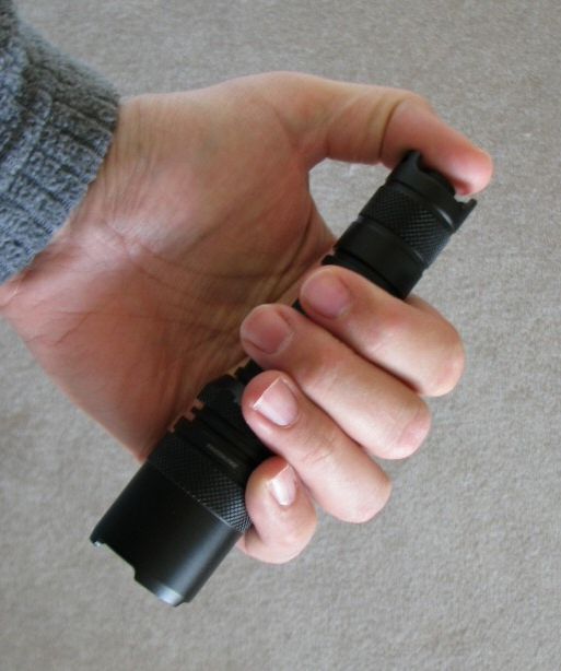

    Both lights come with the same removable pocket clip, which is of the standard clip-on variety (i.e., similar to the Jetbeam Performance and Backup series lights).
    Screw threads are standard triangular cut, and seem of good quality. They are also anodized for lock-out at the tailcap. Tailcaps size and threading are identical across the two models (i.e., are interchangeable). Tail switch is a forward clicky, with traditional feel. The Jetbeam Backup and Performance series lights often felt a bit "squishy" in comparison.
    Light can tailstand, but may be a bit wobbly (due to the partial raised areas for the lanyard attachment on the tailcap).
    MT2C:
    MT25:

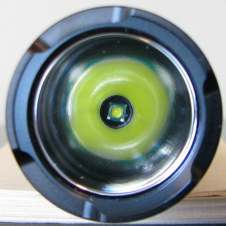

    The main difference between the lights is the larger head on the MT25. With this comes a larger and deeper reflector (both smooth finish). Here is a close-up of the MT25:
    Note that centering is not necessarily perfect on my MT-series samples, but the MT25 above was pretty good.

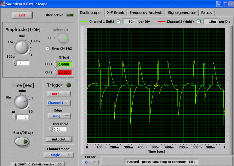

    PWM/Strobe
    Nitecore claims that the MT-series lights are current controlled, and I believe that is true. However, there is a re-occurring signal pattern on the Lo/Med/Hi levels (but not Turbo) for all members of this family. Here's a representative sample:
    MT2C Hi:
    MT25 Hi:
    Please note that this "zigzag" pattern is most definitely NOT pulse-width modulation (PWM). I have tested half-a-dozen MT-series lights right now, and my oscilloscope shows this consistent triangular circuit signal at somewhere between ~950-1050 Hz on the Lo/Med/Hi (but not Turbo) of each model.
    Rest assured, it is certainly not as visible as 1kHz PWM would be. I've noted in the past that visual flicker detection increases on PWM lights as you go to lower outputs (even when you keep the PWM freq constant). Part of this may simply be due to different flicker detection thresholds at different intensities, but I suspect it is due in part to the pulse-width changes in the PWM wave (i.e., the shorter "on" / longer "off" phase in the PWM signal at low intensities is more noticeable for some reason). In the case here, the zigzag signal is constant at all outputs (i.e., it is pulse-constant), with a consistent slope (i.e., it is waveform-constant). This appears to drastically reduce the "noticeability" of the signal compared to PWM.
    Also, I have noted that this signal intensity is quite variable across my MT-series samples (i.e., it is not a full on/off signal, and its amplitude varies considerably). Even with the MT1C on 1xRCR (my most prominent example), the signal is so weak that I cannot see any evidence of it visually on any mode, except when shining on a fan (and even then is fairly mild). It is certainly not visible in actual use (and as everyone here knows, I am particularly sensitive to PWM flicker ).
    Again, the point here is that the M-series is indeed current-controlled, and you are highly unlikely to be able to detect any sign of this reoccurring circuit signal.

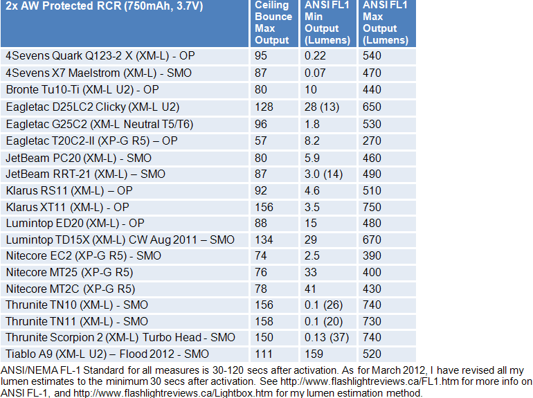

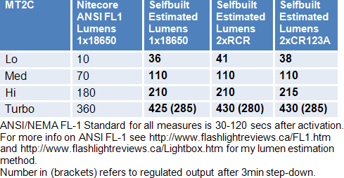

    My summary tables are reported in a manner consistent with the ANSI FL-1 standard for flashlight testing. Please see http://www.flashlightreviews.ca/FL1.htm for a discussion, and a description of all the terms used in these tables.
    Consistent with my other MT-series reviews, the Nitecore output and throw specs seem reasonably accurate, if a bit conservative.
    But as an initial observation, note that my MT2C was actually marginally brighter than the MT25 (the specs have it the other way around). I will discuss output a little further on, after I compare the runtimes (scroll down for my estimated lumen summary tables and discussion at the end of the review).
    In terms of throw, the MT25 clearly throws further, thanks to the larger head and reflector.

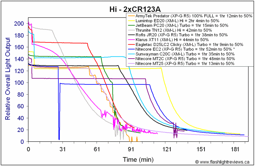

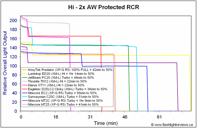

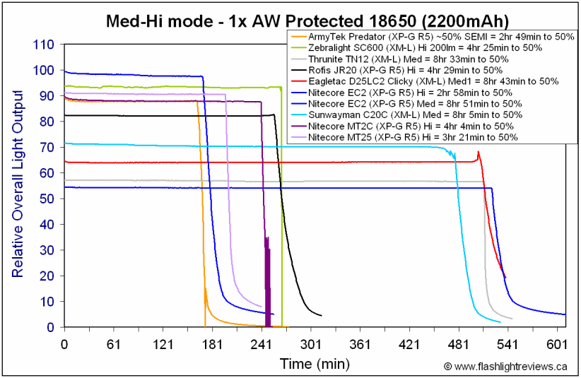

    Output/Runtime Comparison:
    First comment to make is that there is a very distinct difference in the step-down output levels of the MT2C and MT25 on Turbo. Although my MT2C is a bit brighter initially, it drops by approximately one third (~33%) after 3 mins. In contrast, the MT25 only drops by ~10% after 3mins. As a result, the MT25 stays brighter longer – but the MT2C has longer overall runtime. This effect was consistent across all battery types tested.
    Otherwise, output/runtime performance is what I would expect for a good current-controlled light, comparing very well to other XP-G R5-equipped lights. Overall runtime specs from Nitecore seem good, considering the higher stated battery capacities used in their testing (and ANSI FL-1 standard of time to 10%).

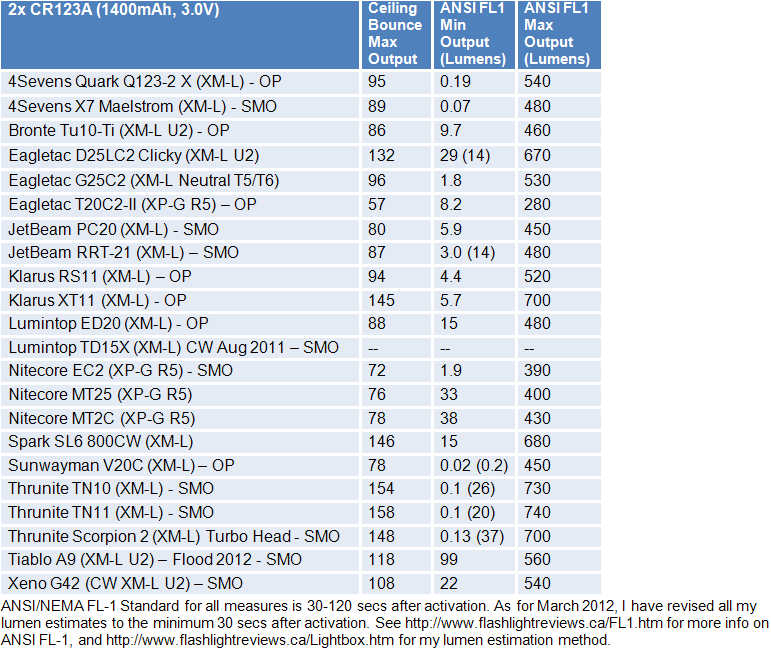

    General Output Comparison:
    To better allow you compare output at all levels on all lights, below are detailed tables for each model, on all supported battery types. I have indicated the manufacturer's specs for the identified cell type.
    Once again, in general terms, Nitecore seems to be fairly accurate in their reporting of relative output spacing.
    Note however the difference in relative output after step-down occurs on Turbo on the two lights. This is why the MT2C has much longer runtime specs than the MT25, despite having initially similar output. When you take into consideration the lower output of the MT2C after step-down, the extended runtime makes sense (and is consistent with my runtime findings above).

    Because of the relatively deep and smooth reflectors, you may notice some centre beam artifacts on these lights (i.e., relative dark spot/band in the centre of the hotspot). This is variable on my samples, but is not uncommon on XP-G lights with these types of reflectors.
    Although initial output on Turbo is comparable between the lights, the MT2C steps down by ~33% after 3mins for extended runtime, while the MT25 only steps down by ~10%.

    The 3hr 45min spec (on Turbo) is a bit optimistic in my view (i.e., I got an hour less on 2200mAh 18650). But in any case, that is based on continuous runtime. If you turned it off and on, the total runtime would be shorter. The reason for this is that the light runs brighter for the first 3 mins before stepping down. If you turn off/on repeatedly, you will drain the battery faster due to all those re-started higher initial levels. See my runtime graphs for more info.
