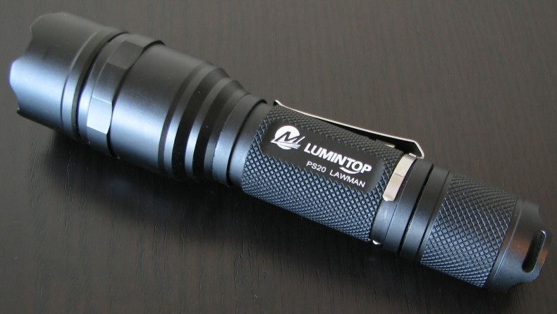

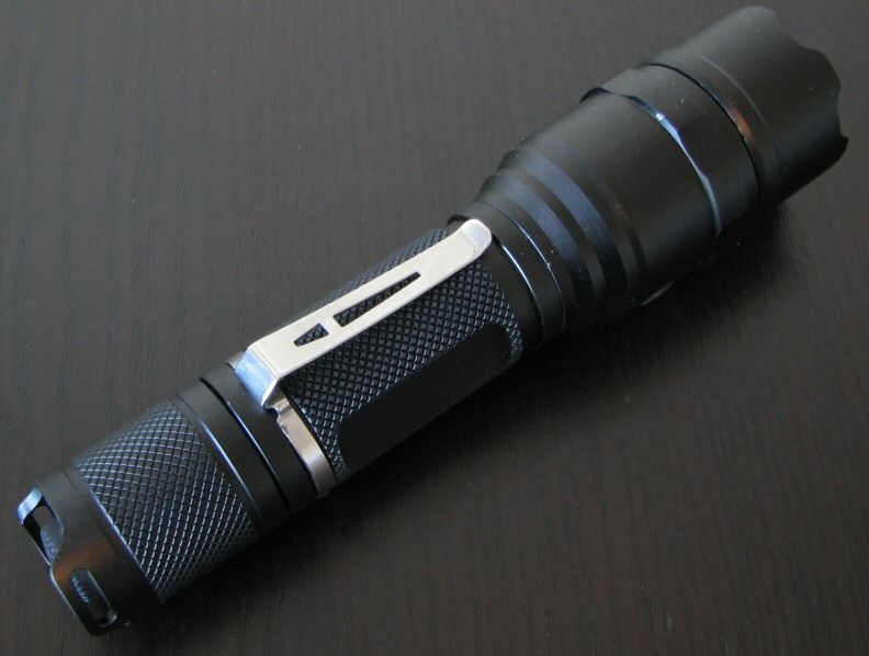

    Anodizing is a matte black, with no chips on my samples. Labels are bright white, clearly legible against the dark background. There is knurling across the tailcap and battery tube and head, of reasonable aggressiveness. Grip seems good.
    Distinctive to this model is the dual-switch design, with the secondary switch in the head (with a small "S" label). Interesting note – the tailcap is NOT a physical clicky switch, but an electronic one. Both switches have a fairly typical electronic feel. See my User Interface discussion below for more info on how this all works.
    Also an interesting feature – the light can work with a battery in either polarity orientation. This is certainly novel – no risk of damaging the light.

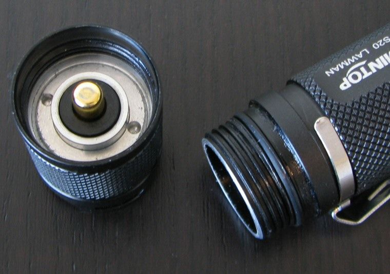

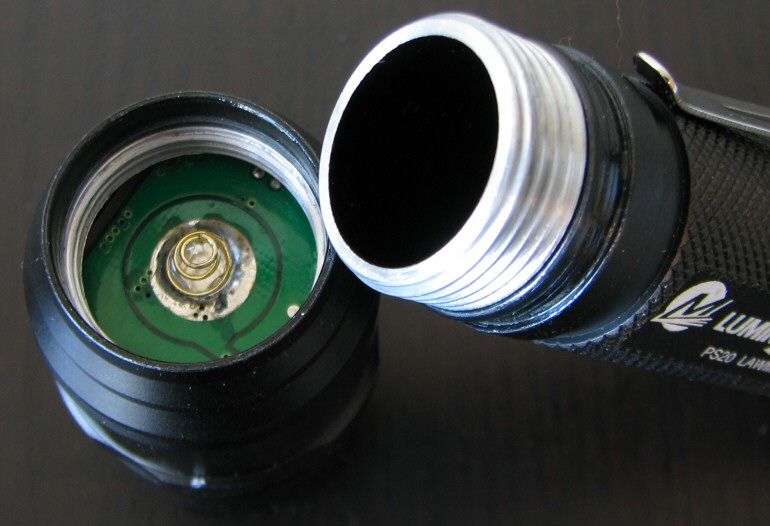

    There is a spring on the contact board in the head, so flat top cells can be used. The body tube is wide enough to take high-capacity protected 18650 cells.
    The light come with a fairly typical removable pocket clip. Nothing fancy here.
    Screw threads are standard triangular cut, and seem of good quality. They are also anodized for lock-out at the tailcap.
    Light can tailstand stably.

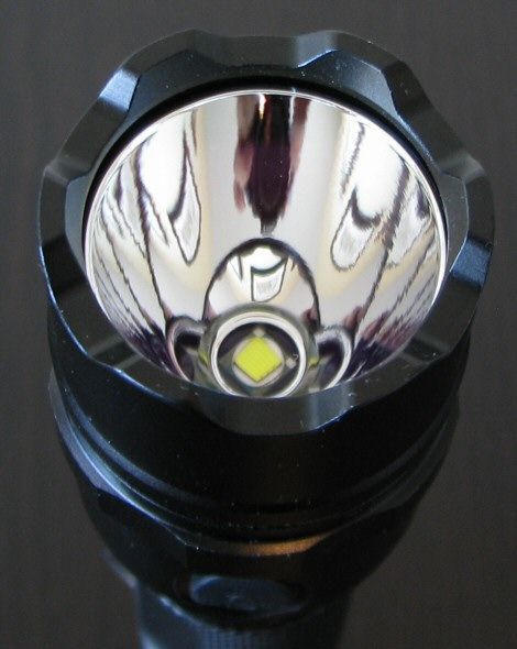

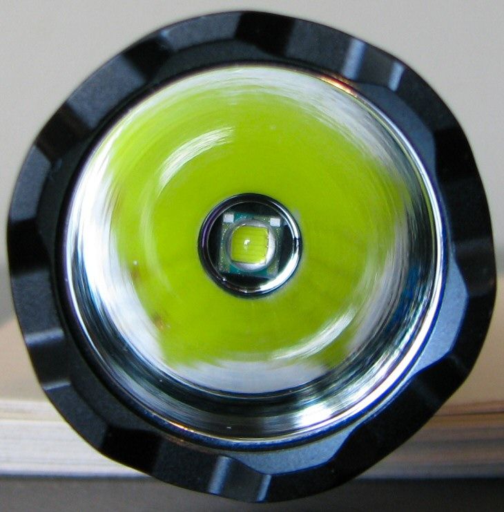

    Light came with a cool white emitter on my sample, reasonably well centered. Reflector was smooth finish, and fairly deep.

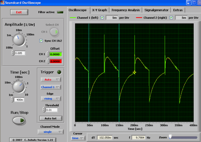

    PWM/Strobe/Standby
    I am unable to detect any signs of PWM on either Lo or Hi using my standard soundcard oscilloscope. Either the light is current-controlled, or it uses PWM at too high a frequency for me to detect. Either way, there is no sign of flicker visually.
    Strobe is fairly standard ~10 Hz.

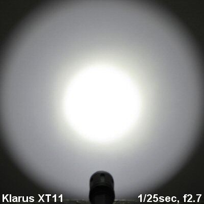

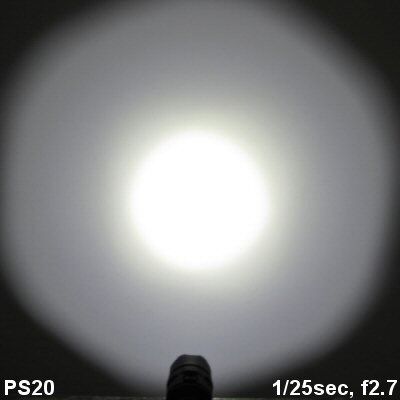

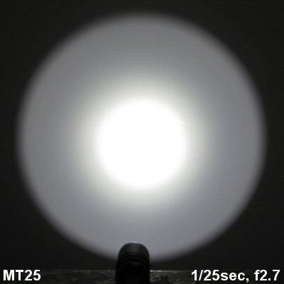

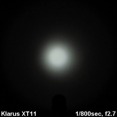

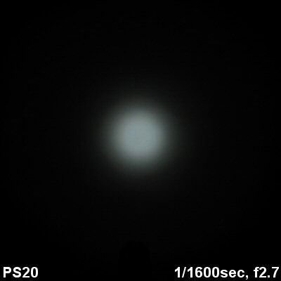

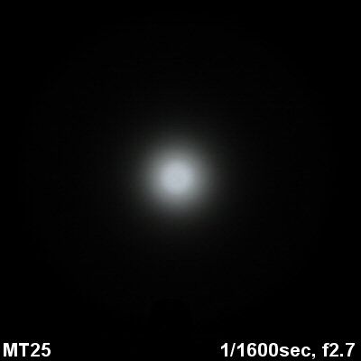

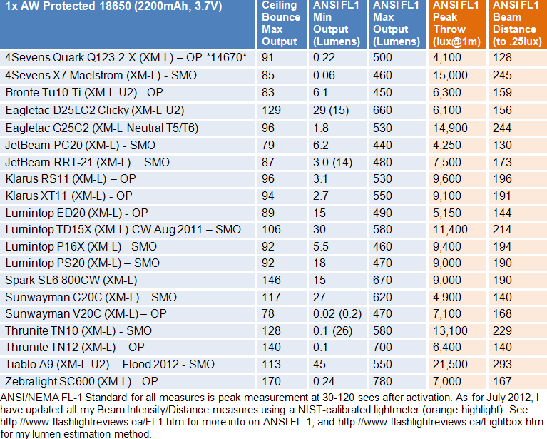

    All lights are on Max output on 1x AW protected 18650 (2200mAh). Lights are about ~0.75 meter from a white wall (with the camera ~1.25 meters back from the wall). Automatic white balance on the camera, to minimize tint differences.
    My summary tables are reported in a manner consistent with the ANSI FL-1 standard for flashlight testing. Please see http://www.flashlightreviews.ca/FL1.htm for a discussion, and a description of all the terms used in these tables.

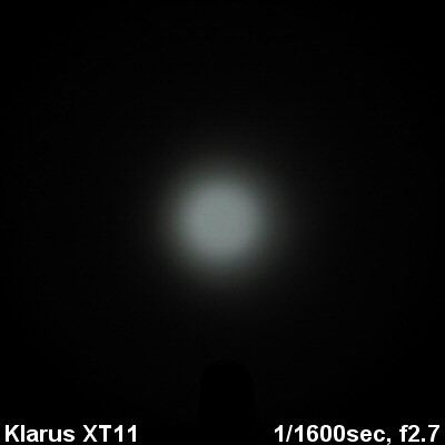

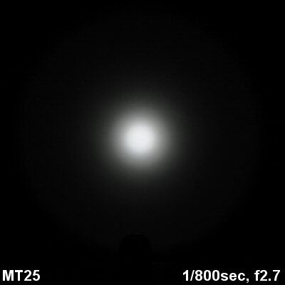

    Throw is reasonably good for the class – very similar to the Klarus light in this size.
    The overall output level on Hi is reasonable, although I would have personally preferred a Med mode somewhere between the Lo and Hi levels.
    The PS20 is very consistent in output on all battery types tested (1x18650, 2xCR123A and 2xRCR).

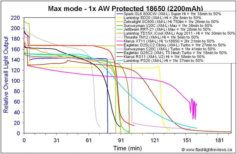

    Output/Runtime Comparison:
    The PS20 on Hi is very much in keeping with other lights of this class. Note the presence of the T6 output bin here (most of the other XM-L lights in my graphs are U2 output bin). Regulation pattern is very flat on all cells.

    On my sample, there was a messy soldering job for the spring on the postive contact board in the head.

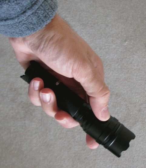

    In terms of build, the PS20 "Lawman" looks very much in keeping with others of this class (particularly so for dual-switch models). It feels solid and robust in the hand, with a fairly typical look and feel. Overall grip is good, although the knurling could be more aggressive.

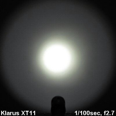

    I find that Klarus light XT11 and RS11 will drop to about 70% after 3 minutes, may I know what is the lumens and beam distance of it after 3 minutes?
    Default Re: Lumintop PS20 Dual-Switch (XM-L, 1x18650, 2xRCR/CR123A) Review: RUNTIMES, VIDEO +
    Quote Originally Posted by yizhiren View Post
    Yes, that's about right. In my testing, both the Klarus RS11 and XT11 (on 1x18650) drop to ~370 lumens after 3 mins (which is ~30% drop or so). I haven't measured beam distance at this level but you could estimate pretty well by the lumen drop (i.e., should be pretty proportional).
    The Lumintop PS20 has perfectly flat regulation, with no step-down.
