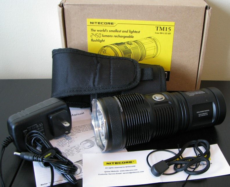

    Packaging is a cardboard box with built-in packaging foam. Inside you will find the light, belt holster, extra o-ring, simple wrist lanyard (with threading wire), manual and AC charging cable. My sample came with the standard North American 110V AC charging plug.

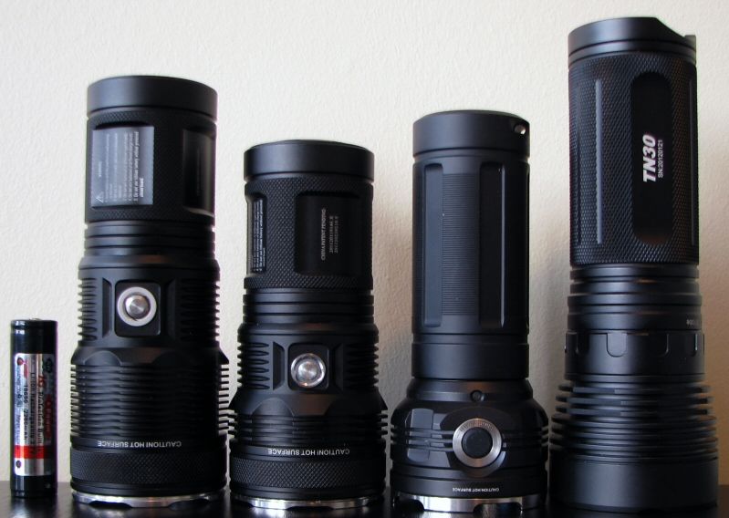

    From left to right: AW Protected 18650; Nitecore TM15, TM11; Sunwayman T60CS; Thrunite TN30.
    All dimensions are directly measured, and given with no batteries installed:
    Nitecore TM15: Weight: 450.6g (634g with 4x18650). Length 158mm, Width (bezel): 59.5mm
    Nitecore TM11: Weight: 342.6g (526g with 8xCR123A), Length 135.3mm, Width (bezel): 59.5mm
    Sunwayman T60CS: Weight: 338.9g (est 477g with 3x18650), Length: 145.0mm, Width (bezel): 60.0mm
    Thrunite TN30: Weight: 468.2g (est 620g with 3x18650), Length: 179mm, Width (bezel): 64.3mm, Width (tailcap): 49.0mm
    Xtar S1 Production: Weight: 876.0g (est. 1028g with 3x18650 protected), Length: 240mm, Width (bezel): 83.4mm
    Olight SR51: Weight: 405g, Length: 190mm, Width (bezel) 62.0mm

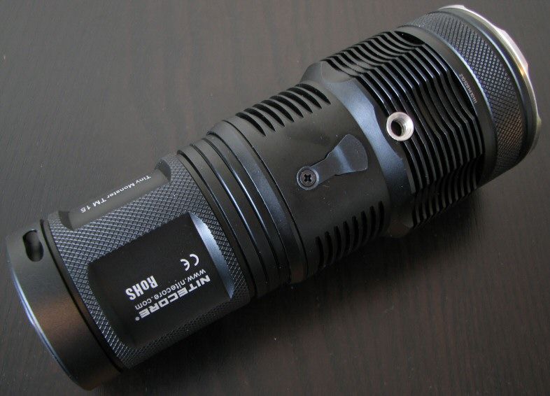

    The TM15 is definitely a longer light than the TM11, but otherwise looks very similar in build. In fact, the battery handle appears to be virtually identical – the difference is all in the head.

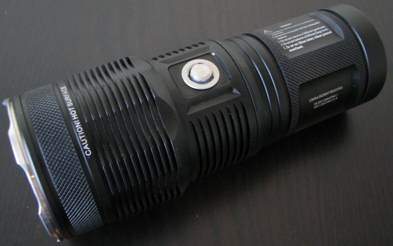

    As with the TM11, anodizing is a flat black, and seems in excellent shape on my sample. There is some knurling on the head and body, of reasonable aggressiveness. Overall grip is certainly decent, despite the cylindrical shape.
    Body labels are rather extensive as before – in additional to the usual maker and model information, you also have a 5-point series of warnings about the light (in a very tiny, but legible, font). The light can tailstand.
    Battery handle is quite compact, and easily houses 4x18650 or 8xCR123A/RCR. The battery compartments are molded right into the aluminum, with a common negative terminal contact plate. You don't need to fill all the wells for the light to work, but should expect lower runtime (and Turbo mode is not recommended on anything but the full complement of cells). Again, scroll down for more info.
    As before, screw threads are anodized for lock-out.

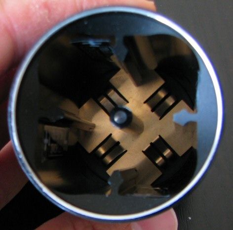

    Inside the head, there are two raised contact rings for the positive and negative current paths. These appear the same as the TM11, and are quite solid (likely gold-plated brass?).

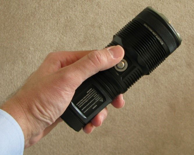

    The switch design has changed a little bit from the TM11. It is still a two-stage (two-pressure) electronic switch, but the button projects out a little further now. The ring around the switch now uses a blue LED instead of red to signal the state of the light (i.e., battery status, voltage, and standby modes). Scroll down for an explanation of the interface.

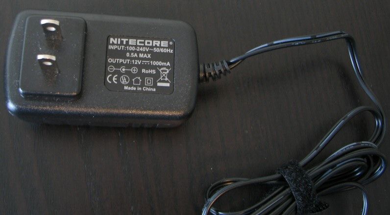

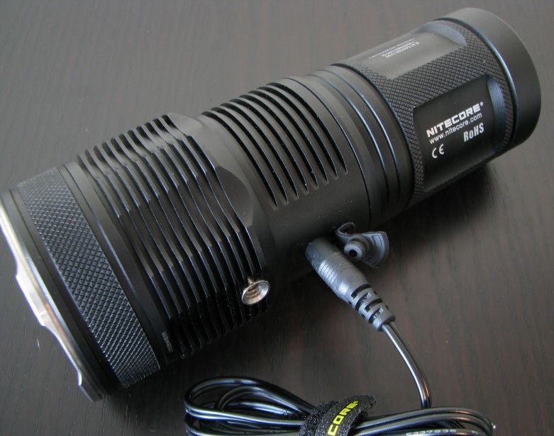

    The TM15 has an AC charging cable that connects on the back of the head. The connection point has a small rubber cover, held down with a screw. Not sure how durable or water resistant this will be long-term. Note the charging solution is to be used ONLY with 18650 cells.
    Nitecore estimates it will take about 7 hours to full charge the cells this way, which seems a reasonable estimate (i.e., it took just over 6 hours for my relatively low capacity 2200mAh 18650 cells). My somewhat used cells all came out ~4.14-4.15V in my testing, which is a nice conservative level (i.e., just ~0.01-0.02V less than my Pila charger on these same cells).
    There is also a tripod attachment mount nearby, with uses the standard tripod screw diameter (presumably 1/4-20 UNC). Note that I found some of inexpensive tripod mounts were a bit loose when screwing into the TM15 (e.g., gorilla-pods), but seemed stable enough in the end. Professional tripods mounts fit stably and securely. The mount seems a little far forward on the light, given that a lot of the weight is in the battery handle.

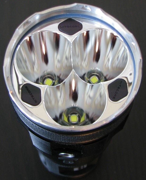

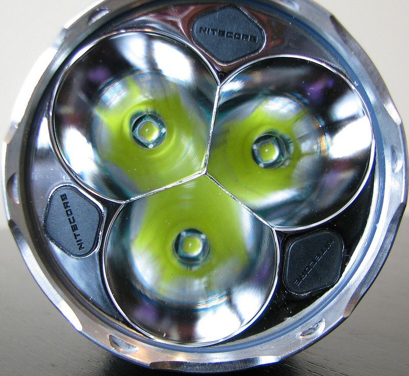

    TM15 has the same size bezel opening as before, and comes with a stainless steel bezel ring, slightly scalloped. The screw-on bezel diffuser from the Eagletac M2- and M3- series lights works as before.

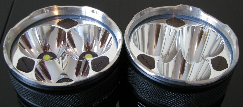

    The TM15 uses 3x cool white XM-L emitters as before. However, the TM15 has much deeper reflector wells than the TM11, as illustrated below:
    TM11 on the left, TM15 on the right:

    The charger plugs in under the rubber cover on the back of the head. The blue indicator light comes on during charging, flashing twice a second. Once the charge is complete, the indicator shows solid blue. My sample charged to a reasonably full level.

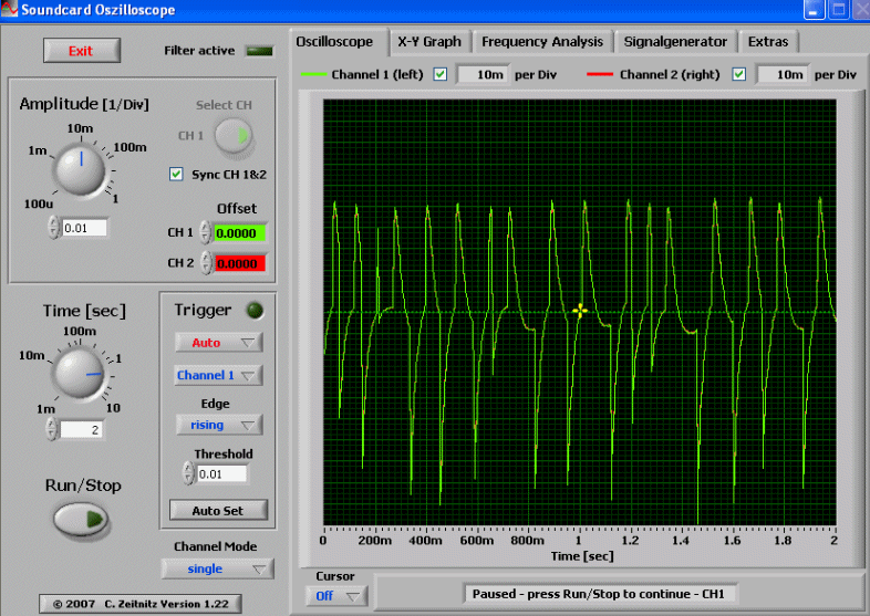

    PWM/Strobe
    There is no sign of PWM on any level – I believe the light is current-controlled, as expected.
    As you can see above, the TM15 has a true variable frequency strobe. In my testing, the time between pulses varied from ~75 to ~200 msecs (or 5 to 13 Hz).

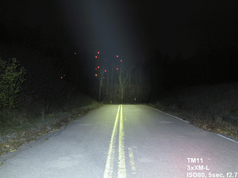

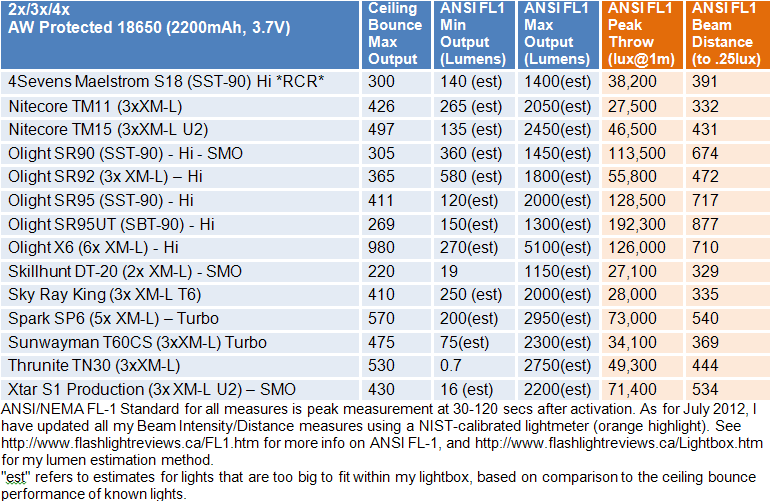

    And now, what you have all been waiting for. All lights are on their respective max rechargeable battery sources (i.e., 18650s), about ~0.75 meter from a white wall (with the camera ~1.25 meters back from the wall). Automatic white balance on the camera, to minimize tint differences.
    The TM15 clearly has a much narrower spillbeam than the TM11, due to the deeper reflectors. In fact, both overall output and throw have increased on the TM15, compared to the earlier TM11.
    Despite how it may look above, there is no artifact near the hotspot on my TM15 (rather, that faint line seems to be a mark on my white wall ).
    In my experience, these sorts of deep well 3xXM-L lights tend to have a lot of "daisy flower" artifact effects in the spillbeam. But the TM15's reflector design is remarkably good – I see very little evidence of artifacts in this case. Much better than most lights in this class.
    To show the spill a little better, here are some side shots on my famed "integrating carpet".
    Again, the TM15 is far more focused for throw than most other 3xXM-L lights.
    For outdoor beamshots, these are done in the style of my earlier 100-yard round-up review. Please see that thread for a discussion of the topography (i.e. the road dips in the distance, to better show you the corona in the mid-ground). Please ignore the red-tint in the lower-right corner these shots (I was wearing a brighter-than-usual red headlamp during this excursion ). Zoomed-in pics of the hotspots are also included.
    Here is how the TM15 compares directly to the TM11:
    I know it can be a bit hard to compare, given the slight variation in angling of the lights and the tint differences. But as you can probably tell, the TM15 is a greater thrower than the TM11. The TM15 is generally comparable in throw to the Thrunite TN30.

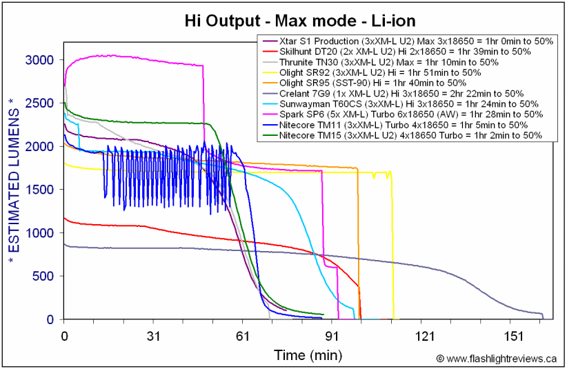

    Turbo output is quite high – similar to my other recent 3xXM-L lights (i.e., the Sunwayman T60CS and Thrunite TN30). Throw is higher on my sample than the Nitecore specs indicate.
    Here is how the TM15 compares to the TM11 in terms of relative level spacing.
    Nitecore's lumen specs seem to be pretty accurate.

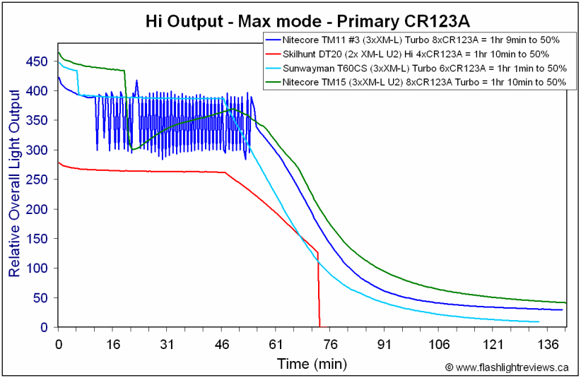

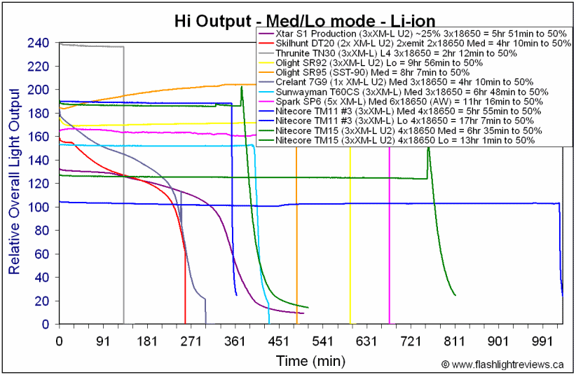

    Output/Runtime Comparison:
    Note: All my 18650 runtimes are done using AW protected 2200mAh.
    The TM15 shows excellent efficiency for this class, in keeping with the current-controlled circuit. Output is flat-regulated at all levels, very similar to the TM11.
    There was a step-down from Turbo to Hi on 8xCR123A after ~20 mins runtime. I suspect this was the thermal sensor kicking in to limit output. Note that primary CR123As tend to get a lot hotter than 18650 under high drive currents, which may be why I didn't observe any step-down effects on the 18650 runs (all runs above done under a cooling fan, as always).
    As you will recall from my earlier TM11 review, there was some variability initially in the thermal sensitivity of the step-down control circuit of that model, even on 18650 (i.e. that light always stepped down eventually, even with cooling). I'm guessing the larger head of the TM15 has also allowed from improved heatsinking.

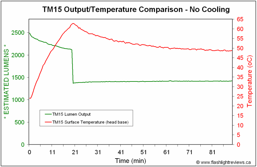

    Since most of you are not likely to be running your lights under a cooling fan, I did an analysis of what happens if you run the light without any cooling whatsoever, on 4x18650. I also attached a thermal probe on the surface of the head of the light, just above the switch.
    As you can see above, the rise in temperature triggered a step-down from Turbo to Hi on 18650 after about ~20 mins of runtime. The surface of the light was definitely quite warm by this period, but cooled down quickly once the output stepped down.
    With 4x18650, the output remained stably at this Hi level for the rest of the run. This is in contrast to the gradual partial recovery of output on 8xCR123A as the temperature dropped, but that may reflect differences in the internal resistance of the different chemistries. I am happy to report there is no sign of the rapid cycling in output I observed on the early TM11 samples.
    In case you are curious, here is how the TM15 compares to other lights in estimated lumens:

    The raised switch - and increased sensitivity - may result in greater accidental activations on the TM15, compared to the earlier TM11. I do find the new sensitivity easier to use in practice, though.

    You're right:
    TM15: 634g with 4x18650).
    TM11: 476g with 8xCR123A
    158g (5.57oz
    4x18650: 186.4g (3100mah Redilast)
    8xcr123: 132.8g (Duracell)
    53.6g
    TM11: 344.8g without batteries (slightly more than Selfbuilt's figure)
    +186.4g
    530.2g Total with 4x1850 3100's
    TM11: 530g with 4x18650
    104g (3.7oz)
    So, with 4x18650's in each light, the TM15 is 104g/3.7oz heavier than the TM11. This is still a noticeable but not unduly burdensome difference. (Selfbuilt's 2200 Mah 18650s will be lighter than the 3100s, but I don't have any 2200's available
    for weighing)
    Brightnorm
    6,936
    Default Re: Nitecore TM15 (3xXM-L U2, 4x18650, 8xCR123A/RCR) Review: RUNTIME, BEAMSHOTS, VIDE
    Quote Originally Posted by brightnorm View Post
    104g (3.7oz)
    Pretty close - I just went and measured to confirm, and my TM11 comes up as 526g with 4x18650 AW 2200mAh installed. As you would expect - the TM15 base unit is 108g heavier than the TM11. I've updated the review with the weight, to allow you to directly compare to other lights measured with the same AW 2200mAh cells.
    BTW, does the charging port and circuitry add length to the light?
    Presumably that is part of it - but Nitecore has taken advantage of the opportunity to extend the reflector depth. It seems a reasonable size, all things considered.
    Quote Originally Posted by sidecross View Post
    I did contact Nitecore about the cover for the charging port and they replied: "As to the charging cover, is it necessary to prepare a spare
    one? For example, I don't see mobile phones prepare spare covers.
    I have two TM11's Version 3 and I have one of the TM15 too.
    This is a good step in this light's development and NITECORE wrote they plan on continuing making the TM11.
    The TM15 neutral I have comes with a spare rubber cover.
    On a side note, the button now is much more sensitive than the TM11 meaning accidental presses are easy with the holster or in general. Do you see the same thing on the copy supplied to you Selfbuilt?
    Excellent review. Selfbuilt! Thanks a lot for your time & effort as always.
    It's certain that TM15 is upgraded light of the TM11. The light shows a better regulation stably in temperature.
    By the way, I'd like to know the test room temperature, the point on the light where the thermal probe were set in pace in detail, and whether you open the window during the test or not.
    (Maybe I escaped your note! )

    Do the LEDs in your unit glow in pitch dark with the light off and on standby? Some reports of this, and my TM 15 does it. The glow is even across all three LEDs, no flicker.
    Interested in NiteCore's response to this; unsure if it is a bug.
    nitecore has already said that its a bug
    Room temp was about 21 degrees C, the surface probe read 24 degrees C at start. Probe placement was just above the switch, but below the fins (i.e., the same as my TM11 review). There is no open window, and my lightbox is in a cramped corner of my room (i.e., no airflow without a fan).
    Quote Originally Posted by CouldUseALight View Post
    Do the LEDs in your unit glow in pitch dark with the light off and on standby? Some reports of this, and my TM 15 does it. The glow is even across all three LEDs, no flicker. Interested in NiteCore's response to this; unsure if it is a bug.
    No signs of that on mine. I would definitely consider that a bug, and would request a RMA if mine did it.
    Hello Bwolcott,
    We don't think it can be regarded as a bug.
    After receiving feedback, we checked our stock immediately and found it true that there is a small quantity of TM15 have the glow situation. From then on, we strengthened our QC in this aspect. At the same time our Research and Inspection departments immediately looked into the situation, and found that the glow result from one component, as some units from that batch of component is not funtioning stably. But it would not influence the performence and duration of TM15.
    We are sorry to cause inconvinience to those customers who got a glow light, and would be very pleased to make replacement to them if they need. For more information about TM15, customers can write to our service email box, and we will reply in a prompt way. service@nitecore.com
    Here we would like to say "thank you" to all the buddies showing their supports and attention on NITECORE, and wish you all can continuously keep your attention on NITECORE flashlights.
    Skelt11,
    No worries. Please contact our local dealer for a new replacement.
    And we promise that, the glow will not influence the performence and duration of TM15.
    Have a nice day!
    NITECORE service

    Quote Originally Posted by Sysmax Ind. View Post
    That sounds great, thanks! There is no hurry, is there? According to the NITECORE Warranty Terms, users who got a glow light have 18 months time to send in the light under a warranty claim and ask for a replacement, am i right?
    (Btw, sorry for giving you a hard time.. but you're on the line here so. )
