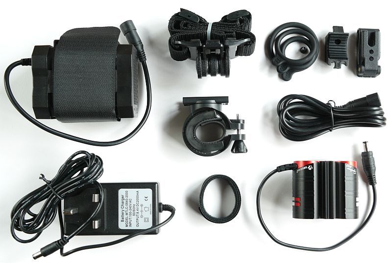

    The Spiker 1207 includes a well-appointed kit, and this is obvious from first opening the storage case.
    Laid out the kit of parts consists of the Spiker 1207 light unit, battery pack, mains charger, handlebar clamp-mount, handlebar block and band mount, head/helmet mount, cap/clip mount, cable tidy strap, extension cord and instructions.

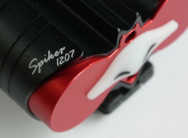

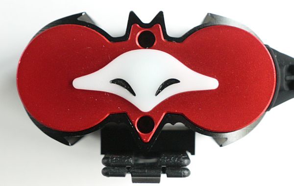

    The Spiker 1207 has taken the basic form required by a twin LED casing and tweaked it to add a little styling. Although not officially affiliated with the inspiration of its final shape the light does stand out with its recognisable silhouette.
    The back of the light unit has an elongated rubber switch pad with an ‘alien’ look to it, sitting on top of the two tone anodising of the main casing.

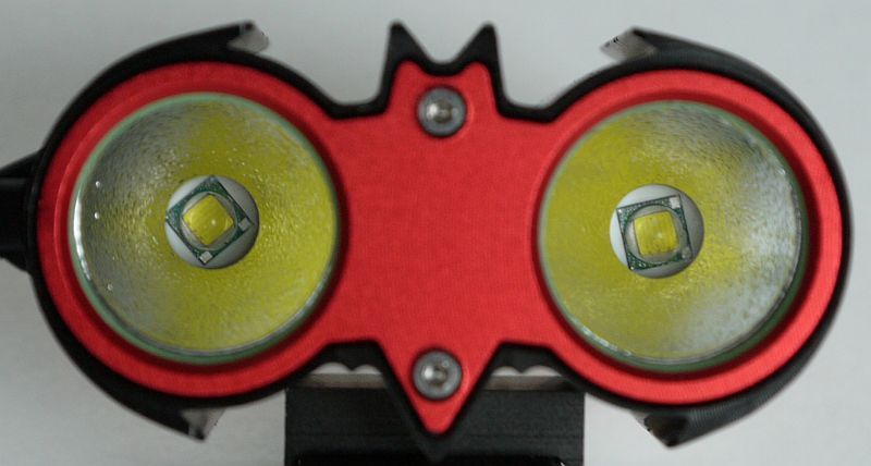

    Looking into the relatively shallow depths of the textured reflectors, you can see the two XM-L LEDs.
    The glass lenses have glow in the dark o-rings and are secured by the front plate held in place by two hex bolts

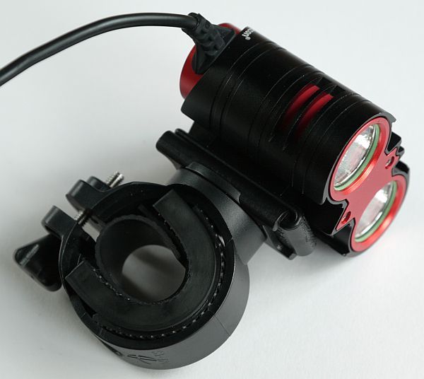

    Turning the light unit over shows the standard clip which locks into the handlebar clamp mount. This is attached with a single M4 screw which allows the user to remove this clip and replace it with the block-n-band mount or the adjustable cap clip.
    Here the light is clipped into the clamp mount

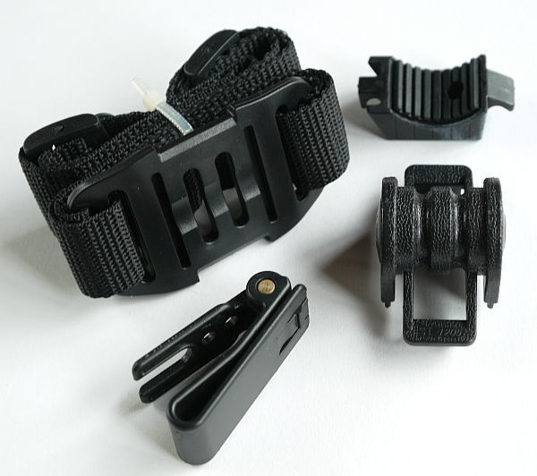

    The other mounting options (starting top left and going clockwise) are the head/helmet band, block mount, the mounting bar that clips onto the head band and the adjustable cap clip (allowing the light to fit onto the peak of a baseball cap).

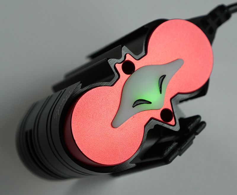

    The switch is illuminated to indicate the battery is connected and the state of charge. The green illumination shows the battery pack has a good level of charge.

    The illuminated switch also serves to provide information to the user about the state of charge:
    -When you first attach the fully charged battery the switch will light up green.
    -Switching on the light leaves the green light showing as long as the battery has plenty of charge.
    -Once the charge level of the battery drops, the switch illumination changes to blue.
    -As the battery level drops further, the main beam flashes three times and the switch illumination turns to red.
    -With continued use, as the battery level drops further still, the main beam will flash three times and the switch starts to flash the red light.
    -Once the lowest charge level indication is reached, the main beam will maintain its output until the battery is fully depleted and then it will cut off to protect the battery pack from over discharge.

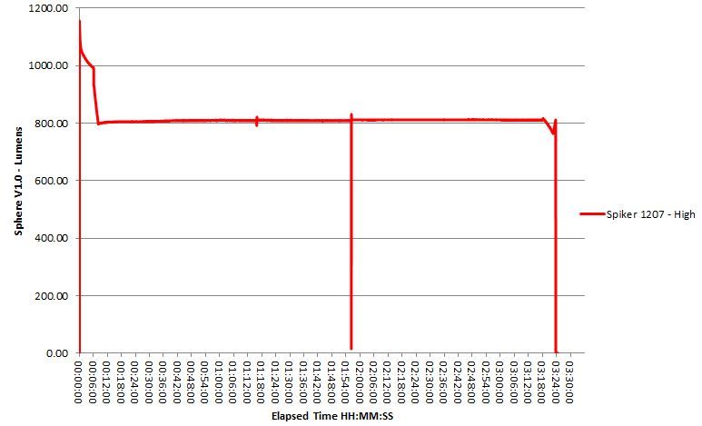

    Starting with a freshly charged battery pack, the Spiker 1207 has the following runtime graph on maximum output.
    The initial 1000 lumen output (as achieved according to ANSI standards) drops to solid and steady 800 lumens for the rest of the runtime. The couple of glitches in the trace are the warning flashes described in the user interface section.
    The fully charged battery pack will give you around 3 hours and 20 minutes at 800 lumens output.

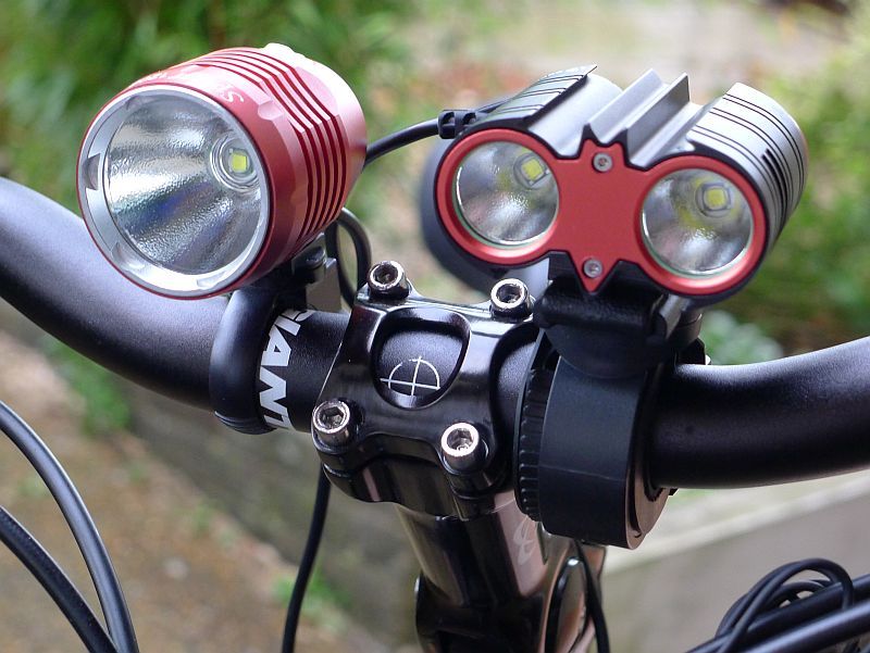

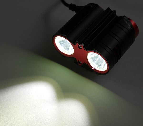

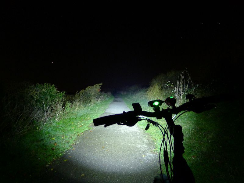

    To show the quality of the Spiker 1207 beam I’d like to start with a beamshot of the Spiker 1206. The 1206 has a beam which is typical of most single XM-L bicycle lights. This beam has good throw and reasonable spill light. (The Spiker 1206 has a unique automatic output level, something like automatic car headlights and will be reviewed seperately)
    Now the Spiker 1207’s beam, taken with the same exposure settings as the previous shot. There is more outer spill light near the front tyre, but the outstanding feature of this beam is the fantastically smooth spread of light across the entire beam, and yet there is plenty of power to light up the trail well into the distance.

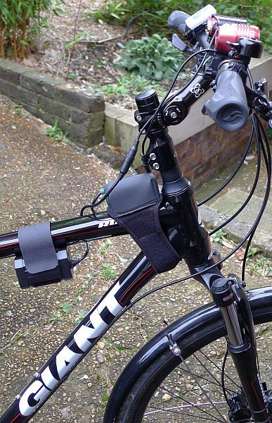

    Shown mounted side by side with the Spiker 1206. The 1207’s mount has just enough rubber spacers to grip a standard 25mm handlebar and has plenty of capacity for oversized bars as well
    The clamp mount’s screw needed to be tightened more than shown here to not move on bumpy trails, and on really bumpy sections this mount did rattle a little bit due to the slide on clip having some flexibility, however it did stay put. The block-n-band type of mount may be quieter, but the clamp mount stays put and allows for directional adjustment of the beam.
    The battery pack supplied with this review sample has now been updated following my feedback to Xeccon during testing. As supplied the pack did not have enough of the EVA foam to pad it at all from the cross-bar meaning it would rattle and slide about during the ride. I used some draft excluder strip to improve this, and Xeccon have now added more EVA foam to the pack.
    As an alternative, Xeccon have told me that they can offer customers the neoprene battery holder as supplied with the Spiker 1206 instead of the plastic case version of the battery depending on your preference. This is shown here near the steering tube.

    Night time riding on completely unlit trails with this light has been a pleasure. The spread of light makes it easy to see well ahead and makes negotiating bends easier than with many other handlebar mounted lights, whose smaller hotspots lead to blind spots on the trail.
