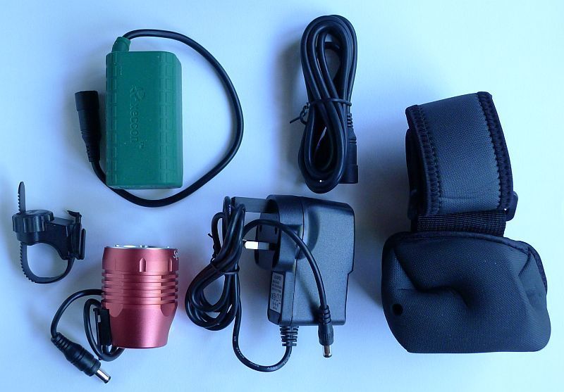

    The top layer contains the main light unit and battery pack
    The bottom layer has the charger, extension cable, handlebar clamp and neoprene battery case
    Laid out the kit of parts consists of the Spiker 1206 light unit, battery pack, mains charger, handlebar mount, extension cord and neoprene battery case/holder.

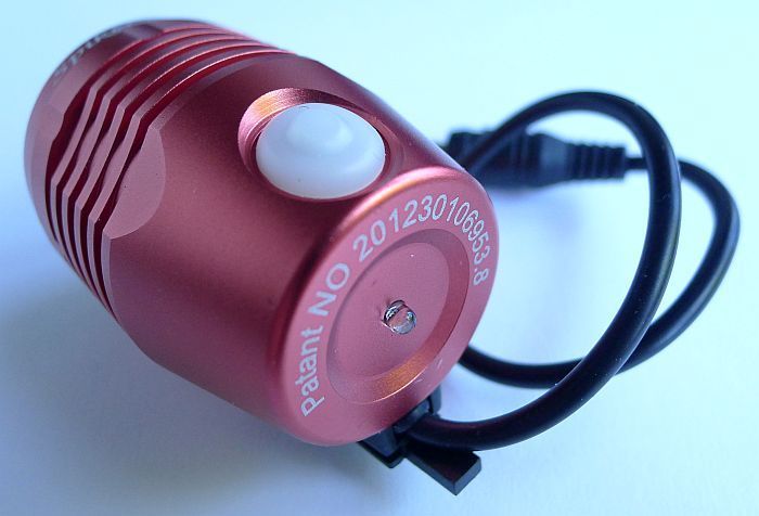

    The first difference of note on the Spiker 1206 is the position of the power switch. This has been moved from the rear of the unit and moved to the top.
    This change of position makes for very easy access to the button for mode changes, however the other notable addition is a feature which makes access to the power/mode switch less important.
    In place of the normal position for the power switch there is now is a light sensor which is used to control the automatic output mode.

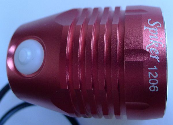

    View of the top of the light with the power/mode switch and cooling fins.

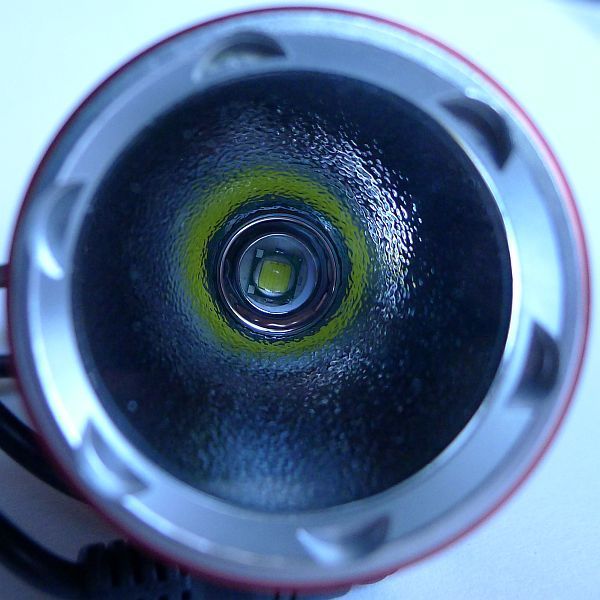

    Looking into the reflector at the textured reflector and XM-L emitter.

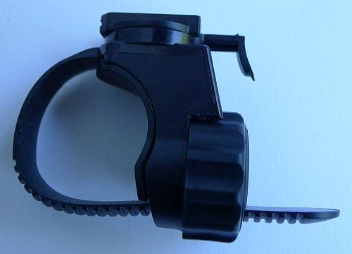

    The quick release handlebar mount allows the light to unclip for security, however the removal of the clamp itself is not that quick as the threaded strap need to be completely unthreaded to release it from the bar
    The light unit and mount combined

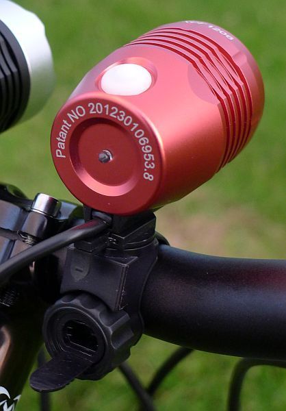

    Shown mounted side by side with the Xeccon S14. The 1206’s mount grips a standard 25mm handlebar very well. It needed part of the mount to be removed to allow the plastic nut to be fully removed. Only then could the threaded strap be removed and placed around the bar, However once this was done, the mount worked very well.
    Initially it was nearly impossible to slide the light into the mount, but after a little easing with a file, the light slides securely into the mount. Xeccon have made changes to the mounting system for the 1206 so if you buy one it may be different to the one pictured in this review.
    There has been no movement of the mount even on bumpy trails.
