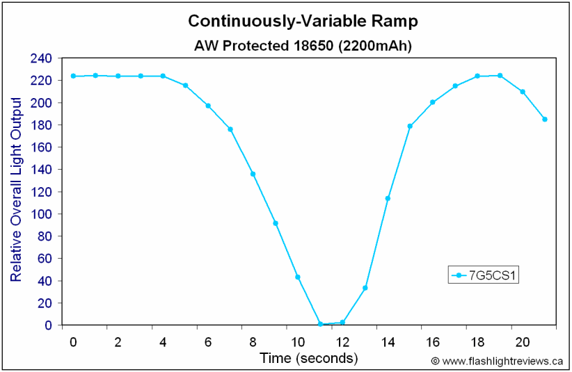

    Pressing and holding the side switch from On begins a continuously-variable ramp in output. Initially, the light ramps down from Max to Min, and then reverses back to Max, in a repeating loop. Here's how it looks over ~21 secs or so:
    Basically, nothing happens for the first ~4 secs once you hold down the switch from On. Then it ramps down rapidly over ~6 secs. It holds the lowest level for about a second or so, and then ramps back up in the same ~6sec timeframe. The light flashes 3 times when the max level is reached, and then starts ramping back down after a brief pause. Total time to ramp down and back up is ~18-19 secs.
    Note that the ramping phases are not "visually-linear" in the sense that it is generally known here. Although ~6 secs is reasonable ramp time, the light steps down from Max relatively slowly over the first few seconds, and then more quickly over the last 1-2 secs (and the same in reverse going back up).
    Also, there is a somewhat limited number of discrete output levels along the ramp, compared to most lights (i.e. you can see the light noticeably step down in increments, especially at the start of the decline in output).
    There is mode memory for the set level from the continuously variable ramp – as long as you don't turn the light off at the tailcap. If you only cycle through levels by using the side switch, the light will continue to come back to your temporarily memorized set level. This means you change the default Max or Lo mode temporarily – the light reverts to the standard levels for these upon rear switch reactivation.

    FYI, I've just revised the ramp graph in the review - the figure legend time axis was off. Here is the corrected graph, showing the rull ramp from max to min and back to max:
