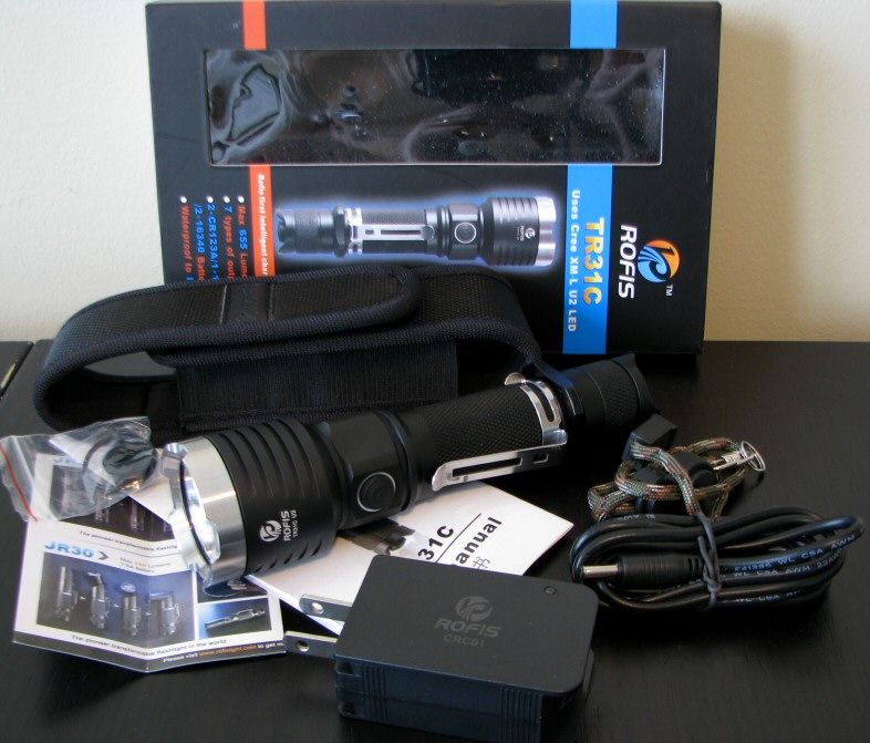

    The TR31C comes in a decent kit, with a good number of extras. Inside the hard cardboard box you will find the light (with removable metal grip ring and pocket clip attached) in packaging foam. Also included is a manual, product insert, decent quality holster, charging cable, USB-AC adapter, wrist lanyard, spare boot cover and extra o-rings.

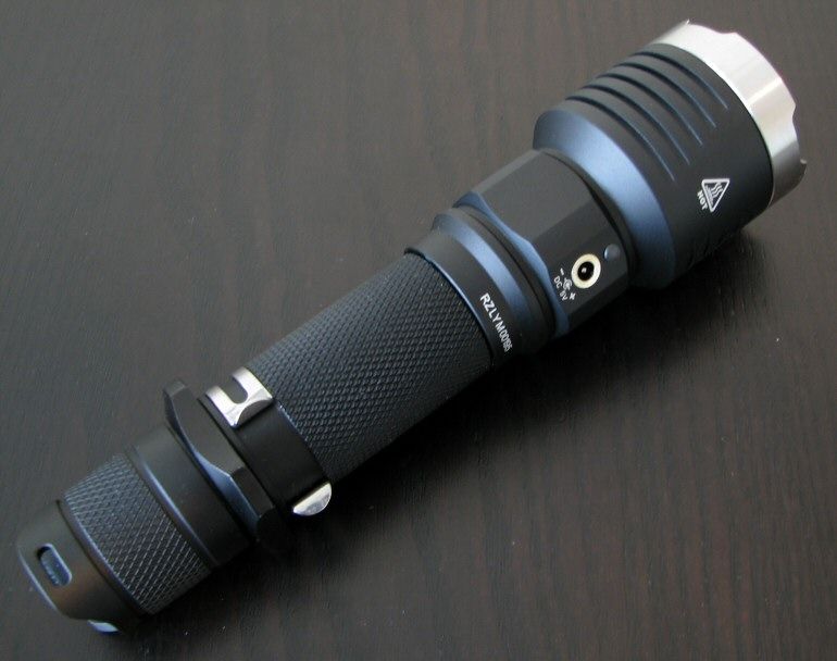

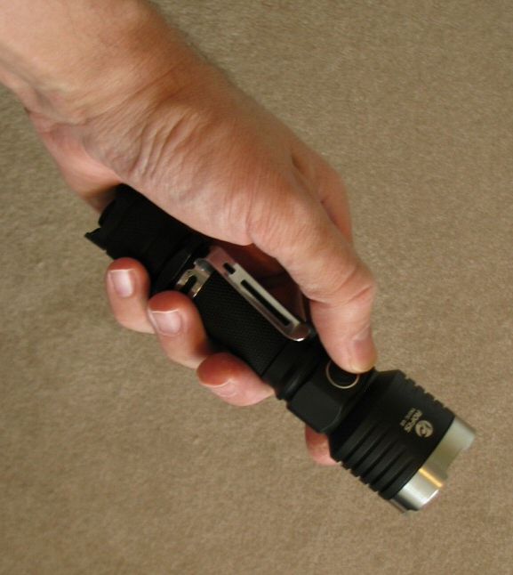

    Light is a bit heavier than most in this class, and has a good solid feel.
    Anodizing is a matte black, with no chips on my samples. Labels are bright white, very sharp and clear against the dark background. A serial number is included. There is a significant amount of knurling across the tailcap and battery tube, of good aggressiveness. Grip is definitely good. Overall weight is substantial for the class.

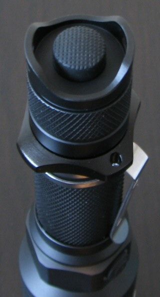

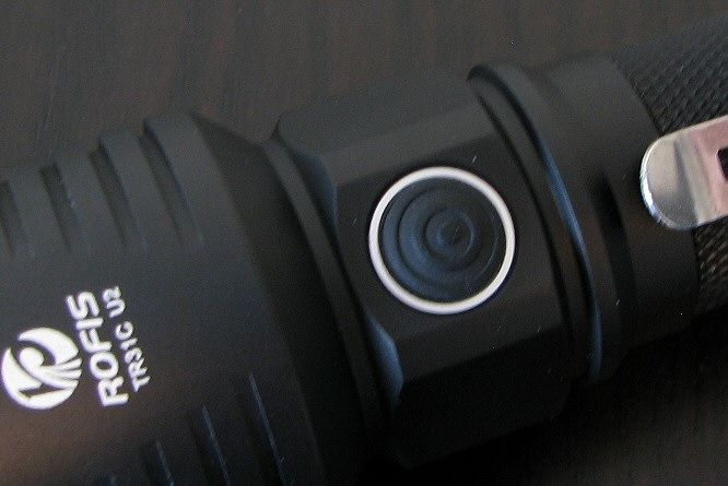

    In addition to the tailcap forward clicky switch, there is a secondary mode-changing electronic switch in the head. Switch feels are about typical for both, certainly on the firm side.

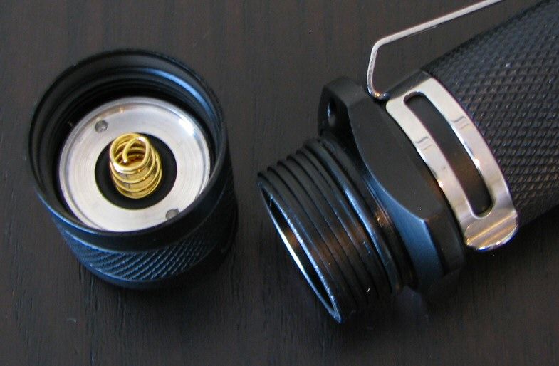

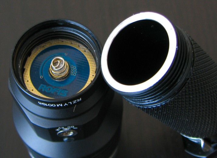

    There is a spring on the positive contact point in the head, which flat top cells can be used (confirmed on my sample). The body tube is wide enough to take high-capacity protected 18650 cells.
    Screw threads are standard triangular cut, and seem of good quality. They are also anodized for lock-out at the tailcap and the head.
    Light can tailstand, but is a bit wobbly on my sample.
    The TR31C comes with stainless steel bezel ring, which is slightly crenaled.

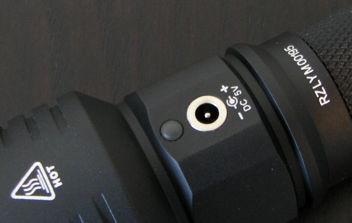

    The charging dock uses a standard 12V DC pin-style connector (USB charging cable and USB-AC adapter included). Normally, I would be worried about waterproofness with this sort of design (i.e., there is no rubber plug on my sample). However, one of the Rofis dealers did a waterproof test, and the light performed fine (the video is on YouTube).

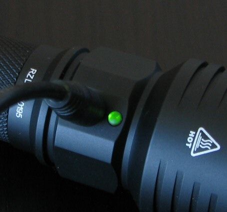

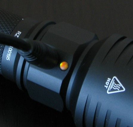

    There is a LED indicator on the light, which tells you the charging status when the charger is attached.
    Incorrectly inserted battery, or tailcap switch not clicked on (i.e., not charging):
    Charging:
    Fully charged:
    Rofis documentation claims that the charger can charge up to a current of 850mA with the included USB-AC adapter (which has a printed rating of up to 1000mA), but only 500mA when connected to a USB port. Note that standard USB 2.0 specs limit you to 500mA charging current.
    From my limited testing, when connected directly to a USB port the charging rate was ~6.5 hours for my 2200mAh 18650 cells. That is consistent with other USB-based 18650 charger lights I've tested. When plugged in to AC power using the supplied adapter, my 2200mAh cells were fully charged within 3 hours. So it looks like Rofis' charging specs are fairly accurate.
    Note however that there was one quirk - the charging light wouldn't go green on my TR31C sample at the end of the charge. Instead, it ended with the orange LED indicator (which also tells you the light is not currently charging). Not sure why, but at least charging was terminated once this level was reached. Resting voltage for the cells was a fairly consistent ~4.19-4.20V, which is appropriate.

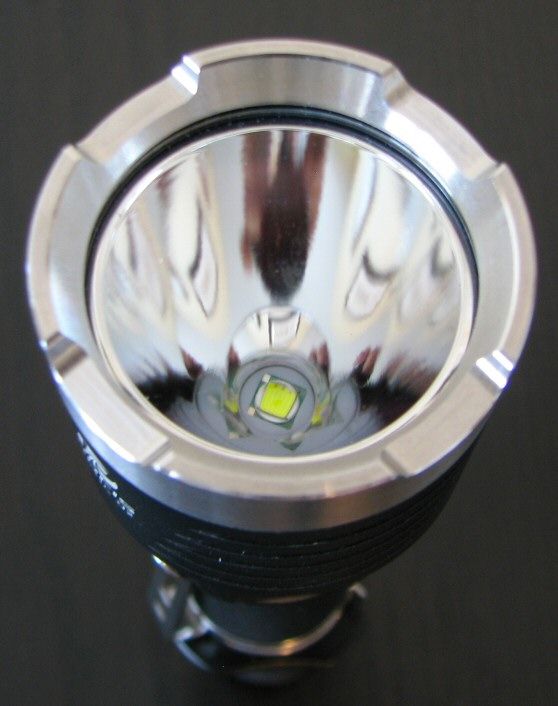

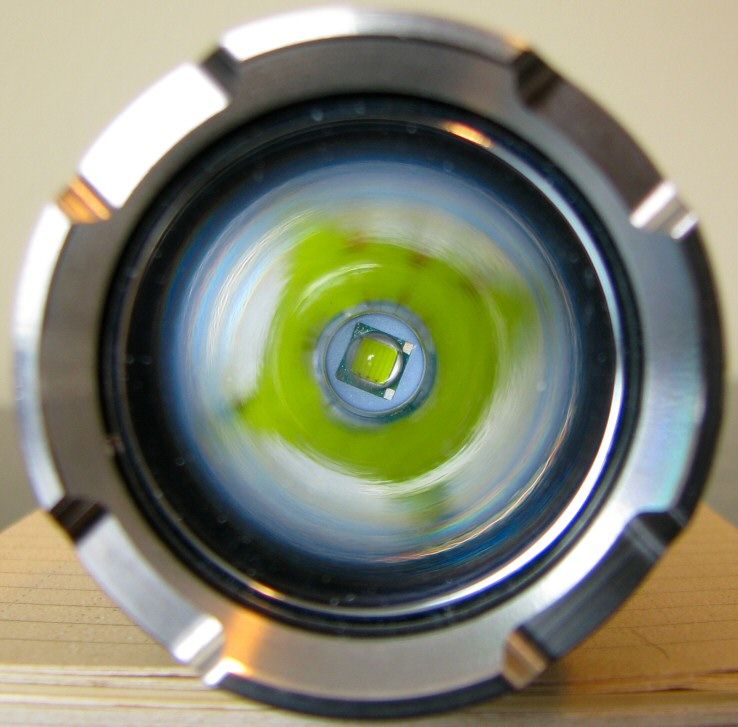

    The TR31C has a fairly deep and smooth reflector, which should provide good throw.

    Mode switching is controlled by the secondary electronic switch in the head. Press and release (i.e., click) to change modes, in the following sequence Lo > Med > Hi > Turbo, in repeating order. The light will memorize the last mode used, and return to it upon re-activation (turn off/on by the tailcap switch).
    To access the blinking modes, press and hold the side switch for about 1 sec. You now have Strobe > SOS > Beacon modes, in repeating order (change between them with a single click). Note there is no memory feature for the blinking modes – the light will always come on in the last memorized General constant output mode.

    For charging a 18650 battery inside the light, you plug the 12 VDC connector into the port at the base of the head of the light. The light will initially come on in max output for ~1sec, and then shut off. The LED charge indicator will turn orange, indicating the light is not currently charging. To start a charge cycle, click the tailcap switch on. The light will not actually come on during charging, but the charge indicator will show green (for fully charged) or red (for currently charging).
    Once the battery is fully charged, the indicator is supposed to turn green and terminate the charge. On my sample however, it turned orange (but still seemed to terminate the charge).
    As an aside, I am not able to detect an open voltage at the charging port on the TR31C. This is reassuring, as it means you won't accidentally short a cell inside the light during normal use.

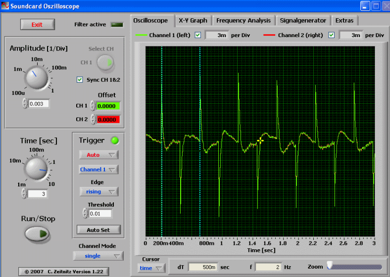

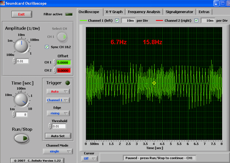

    PWM/Strobe
    I am unable to detect any signs of PWM on any output using my standard soundcard oscilloscope. I believe the light is current-controlled.
    Fast strobe is an alternating strobe, switching between 15.5 Hz and 6.7 Hz every 2 secs. Certainly very disorienting.
    The TR31 also has a slow beacon mode, at 2 Hz. This is much more my speed.
    There is also an SOS mode (not shown). These are again similar to my Rofis JR30.

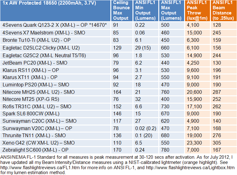

    All lights are on Max output on 1x AW protected 18650 (2200mAh). Lights are about ~0.75 meter from a white wall (with the camera ~1.25 meters back from the wall). Automatic white balance on the camera, to minimize tint differences.

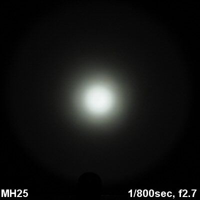

    The TR31 has a very reasonable beam for this class and size light. Note by the way that there is no artifact in the corona – that slight horizontal line you might see above is simply a scratch on the wall paint.

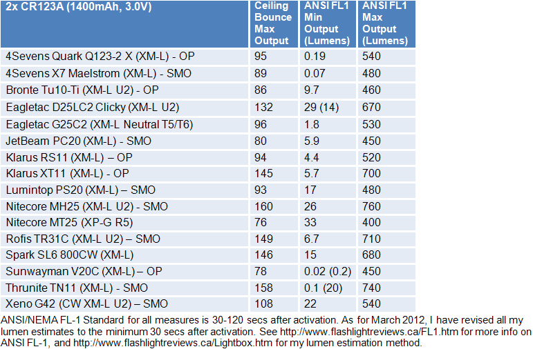

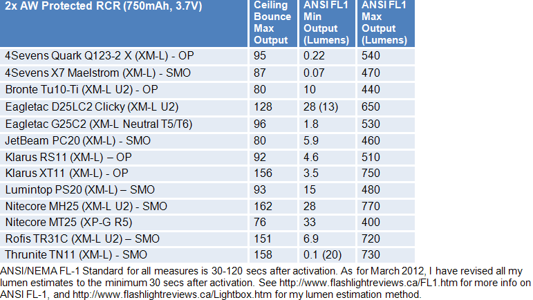

    My summary tables are reported in a manner consistent with the ANSI FL-1 standard for flashlight testing. Please see http://www.flashlightreviews.ca/FL1.htm for a discussion, and a description of all the terms used in these tables.
    Again, as already observed, throw is reasonably good for the class. My beam intensity and distance measures are bang-on with the published Rofis specs for this light.

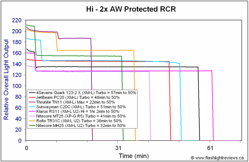

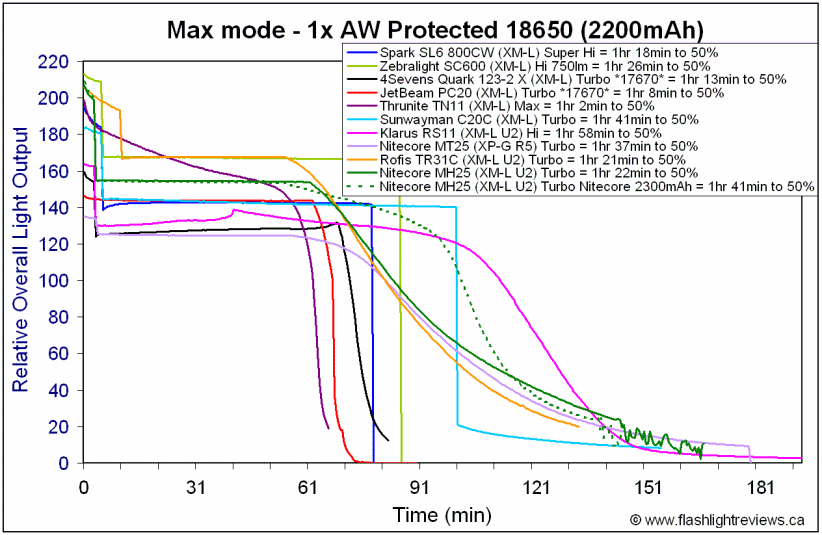

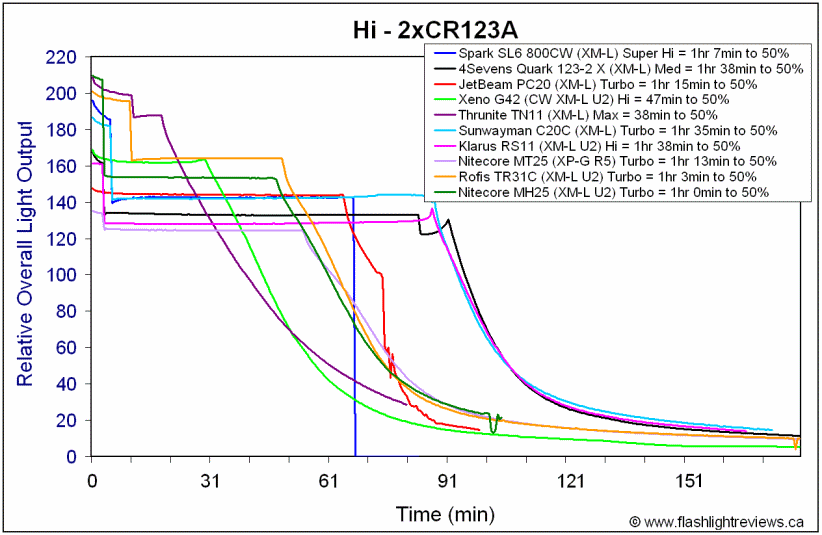

    Output is also fairly consistent – although the max output seems slightly higher initially in my testing than the published specs indicate.

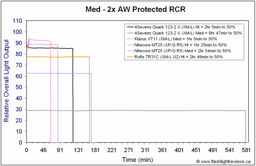

    Output/Runtime Comparison:
    Again, runtime performance seems very consistent with the reported Rofis specs (note that I use the lower capacity 2200mAh 18650 cells in my testing).
    On max, on all batteries, the TR31C has a timed step-down in output of ~20% after 10 mins of continuous runtime.
    Runtime performance was typically excellent across the levels and batteries I tested, consistent with a good current-controlled circuit.

    Beam pattern is very good for a light this size, with significant throw and reasonable spill.
