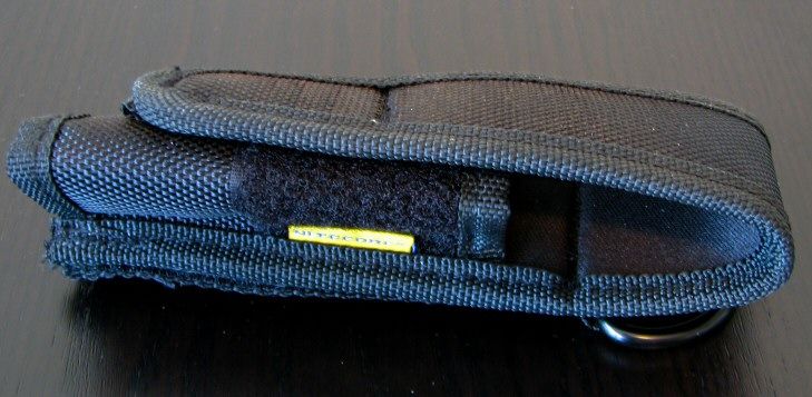

    All the MH-series lights come in basic display packaging, similar to MT-series I recently reviewed. Extras are generally comparable, and include a basic wrist lanyard, extra o-rings and boot cover, removable pocket clip, basic belt holster with Velcro closing flap, manual and warranty card. New for the MH-series are an included Li-ion battery (1xRCR on the MH1C and 1x18650 on the MH25) and a standard USB charging cable (with a micro USB connector for the light).
    I will give detailed specs on each light a little later in the review, but for now here are some build overview specs for each sample:

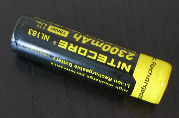

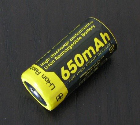

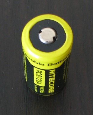

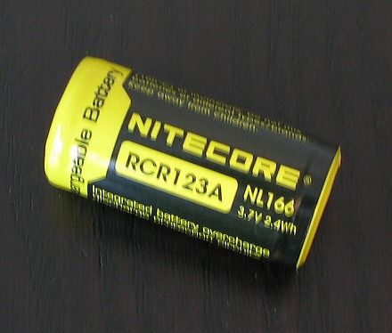

    The bundled batteries are labelled as Nitecore's own brand, with a fairly typical 650mA rating for the RCR, and 2300mAh for the 18650.

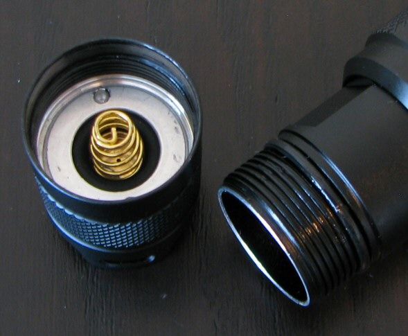

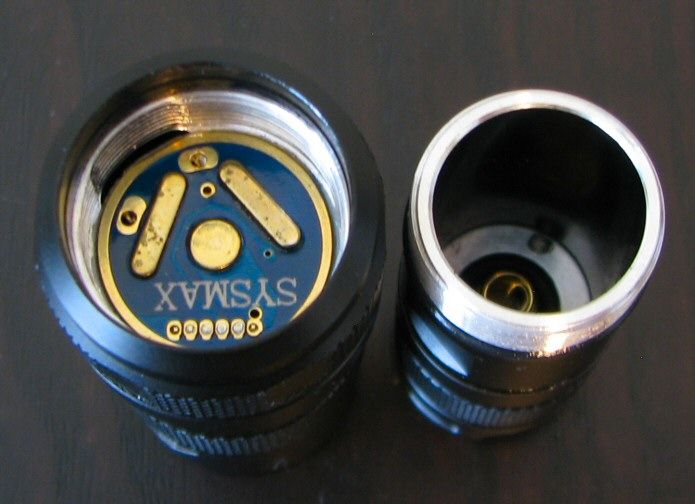

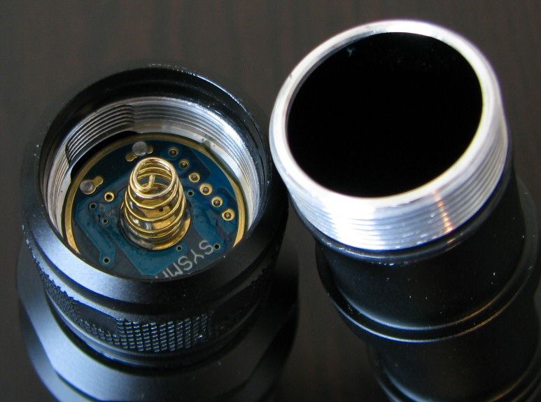

    On the MH1C, there is a reverse-polarity setup in the head, so flat-top cells will not work. The MH25, however, has a spring on the contact board in the head, so flat top cells can be used. Both lights have body tubes wide enough to take high-capacity protected 18650 cells.

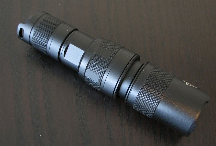

    Both lights come with the same removable pocket clip, which is of the standard clip-on variety (i.e., similar to the MT-series lights).

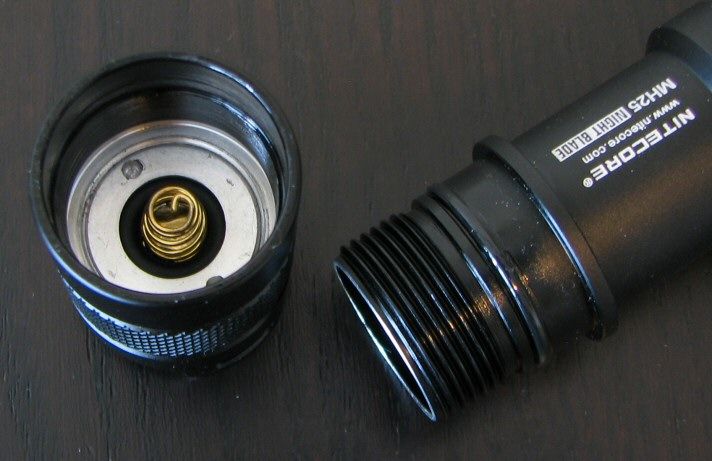

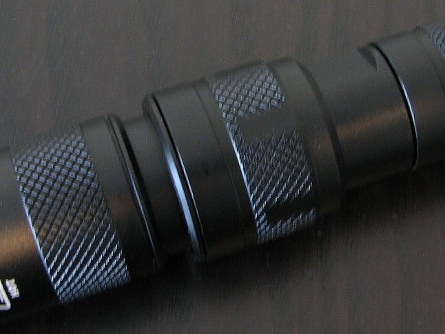

    Screw threads are standard triangular cut, and seem of good quality. They are also anodized at the tail for lock-out. Tailcaps size and threading are identical across the MT- and MH-series models of comparable size. Tail switch is a forward clicky, with traditional feel.
    Lights can tailstand, but may be a bit wobbly (due to the partial raised areas for the lanyard attachment on the tailcap).

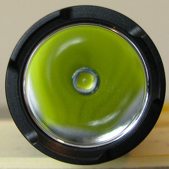

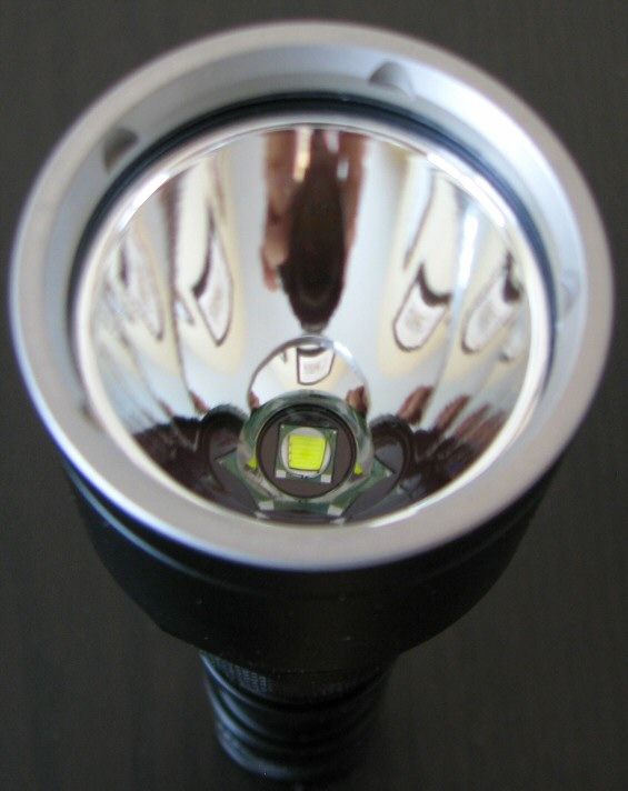

    Reflectors and heads are typically a bit larger than the equivalent MT-series models, likely due to the larger XM-L emitter used here (i.e., a larger reflector is required to produce equivalent throw). Reflectors remain smooth finish, and fairly deep (i.e., optimized for throw).
    Note that centering is not necessarily perfect on my MH-series samples, but the slight variances didn't affect the beams noticeably.

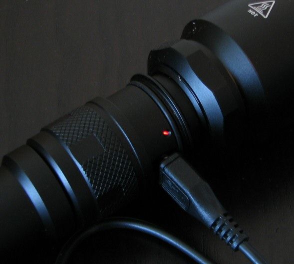

    And now what differs the most from the MT-series – the charging dock and cover on the MH-series. The MH-series lights are all longer than their MT-series equivalents, and have a large ring that covers the micro-USB charging port. To access the port, you need to unscrew this ring until the port is revealed.
    I recommend you hold onto the head as you unscrew the ring cover – otherwise, you may wind up unscrewing the body tube from the head or tailcap.
    MH1C Strobe:
    MH25 Strobe:
    There is a red LED indicator near the port, which tells you the charging status when the charger is attached (see User Interface discussion below for more info).
    Note that there is an o-ring near the head of this region, for waterproofness. It feels like there is a second o-ring at the lower portion of this region, but I cannot tell visually as the ring does not fully unscrew off the head.

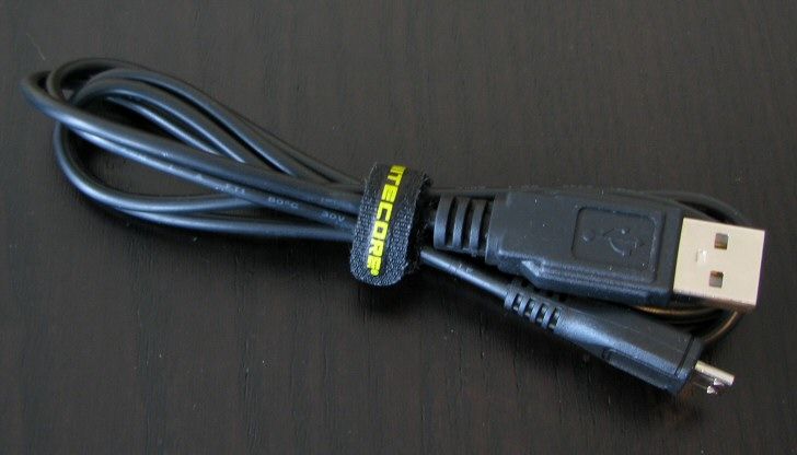

    The charging dock uses a standard micro USB connector. Note that standard USB 2.0 specs limit you to 500mA charging current. In my testing of the MH25, it took ~7 hours to fully charge a depleted Nitecore 2300mAh 18650 cell (included). This is consistent with other USB-based 18650 charger lights I've tested. Resting voltage for was a fairly consistent ~4.18V, which is appropriate.
    On the MH1C, Nitecore reports that it should take about 2 hours to fully charge the supplied RCR cell (which suggests they use a lower current charging rate than the USB max). I can confirm that my sample took just under two hours to complete a charge. However, the resting voltage of the cell was only ~4.11V, which is a little low. Still, I would rather have my cells slightly undercharged than overcharged – it's a lot better for the long-term life of the cell.

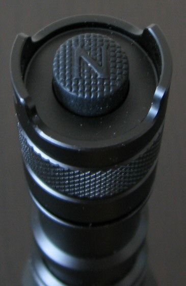

    User interface is identical to the MT-series. Turn the light on by pressing the tailcap clicky (press for momentary on, click for locked on).
    With the head tight, you get Turbo output. With the head loosened, you get the programmed user-selected state. You select the output mode for this state by soft-pressing the clicky switch from off (or clicking off-on from on). The sequence on is: Hi > Med > Lo > SOS > Strobe, in a repeating loop.
    The light has mode memory, and saves the last setting used in the head-loosened state. Note that Hi on the user-selected head-loose state is lower than Turbo on the head-tight state (i.e., there are four defined output constant modes).

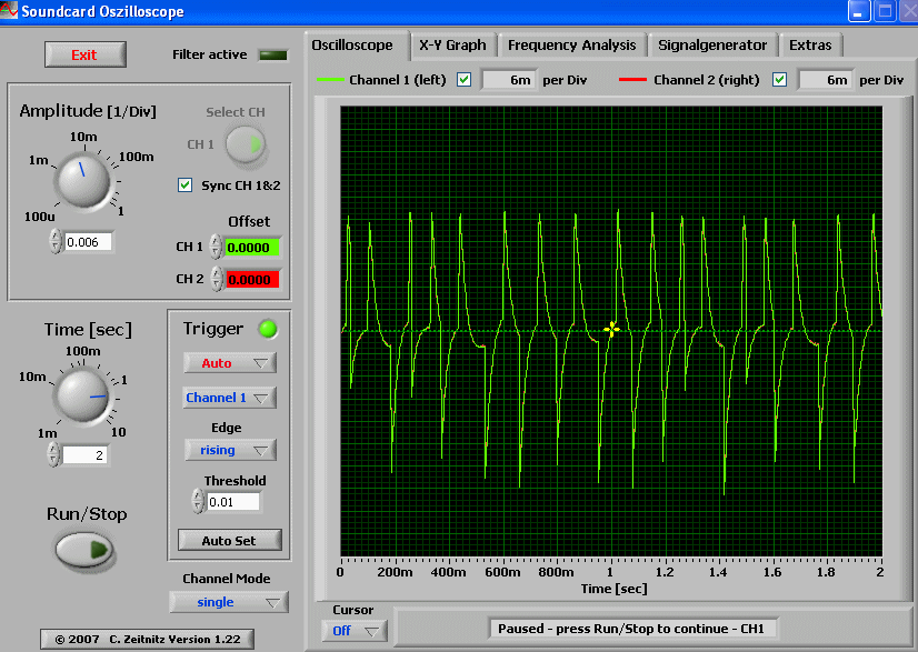

    PWM/Strobe
    Nitecore claims that the MH-series lights are current controlled, and I believe that is true. There is no sign of PWM on my samples.
    MH1C:
    MH25:
    The MH1C has a traditional but fast strobe – at a consistent 20 Hz. In contrast, the MH25 has a truly variable frequency strobe, apparently switching anywhere between ~5-13Hz between each pulse.
    Note that I had noticed three distinct strobe types in my MT-series reviews, including the truly variable strobe of the MH25. However, some of the MT-series lights showed an oscillating strobe (i.e., switching between two defined frequencies) - either after every second pulse or after 2 secs of continuous strobing at a given frequency. Given two different strobe modes seen on my MH1C and MH25, I wouldn't be surprised to expect variation between the other individual members of the MH-series lights as well.

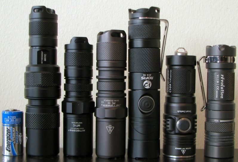

    From left to right: CR123A; Nitecore MH1C, MT1C; Jetbeam PC10; Rofis JR10; Sunwayman C10R, V11R.
    Nitecore MH1C: Weight: 63,4g, Length: 109.6mm, Width (bezel): 25.5mm
    Nitecore MT1C: Weight: 42.4g, Length: 88.7mm, Width (bezel): 22.7mm
    Nitecore EC1: Weight 43.0g, Length: 68.6mm, Width (bezel): 26.1mm
    Rofis JR10: Weight 75.0g, Length (max): 110.6mm (angled): 92.9mm, Width (bezel): 24.8mm
    Jetbeam PC10: Weight: 50.5g, Length: 93.6mm, Width (bezel): 22.6mm
    Jetbeam BC10: Weight: 46.6g, Length: 90.3mm, Width (bezel): 23.2mm
    Lumintop ED10: Weight: 21.5g, Length: 70.4mm, Width (bezel): 20.7mm
    Thrunite Neutron 1C: Weight: 45.2g, Length: 91.5mm, Width (bezel) 22.0mm
    The MH1C is longer than typical, due to charging port in the head.

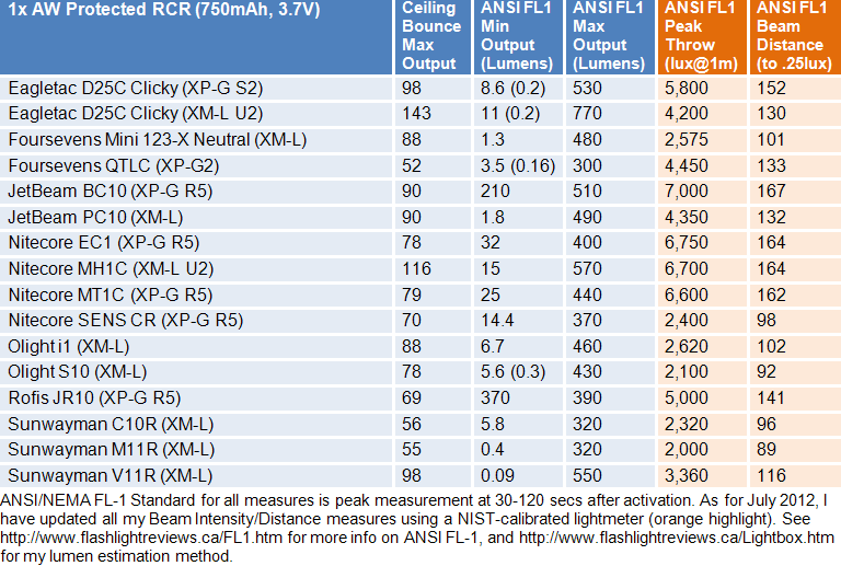

    My summary tables are reported in a manner consistent with the ANSI FL-1 standard for flashlight testing. Please see http://www.flashlightreviews.ca/FL1.htm for a discussion, and a description of all the terms used in these tables.
    Nitecore's output specs seem pretty consistent with my estimated lumen values. However, their beam distance measures seem a lot lower than what I directly measured on my sample.

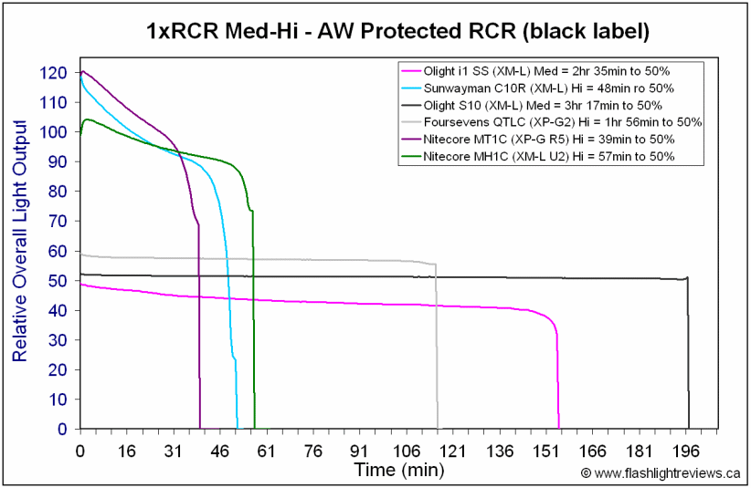

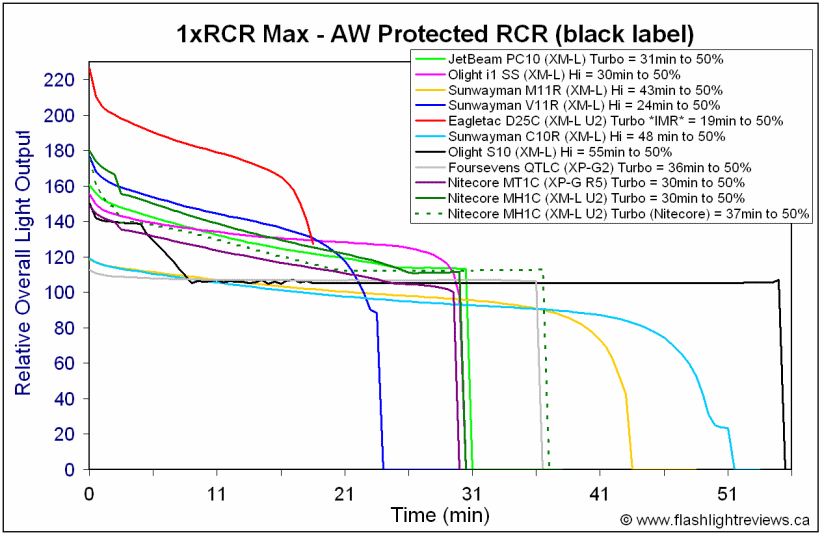

    Output/Runtime Comparison:
    Note: the dotted line refers to the included Nitecore-branded RCR. The solid line is my standard testing AW RCR.
    Runtimes on RCR seem pretty consistent with Nitecore's ANSI FL-1 specs.
    Something interesting here – the included Nitecore RCR cell was not able to keep the initial high output on Turbo for as long as my AW RCR cell. This is an extremely high drive level initially, so it's not surprising that some cells wouldn't be able to last as long as others.

    While Nitecore did integrate the charging port quite handsomely into the light I have always been wary of the extra failing points they (charging ports) add to the light.
    6,936
    Default Re: Nitecore MH1C (1xCR123A/RCR) MH25 (1x18650) XM-L Rechargeable: RUNTIME, BEAMS, VI
    Quote Originally Posted by Mags View Post
    Interesting aesthetic comment ... someone on my YouTube page commented that they thought the port cover was hideous.
    Personally, I think it integrates quite well into the larger MH25 design - but it does stand out a little too much on the smaller MH1C for my tastes.

    I was wondering about the same, but what would realistically be likely to fail?
    Mechanically it looks like a solid solution on the MH series, O-rings to keep it sealed when not connected to the charger. (Proven, solid, easy to maintain and replace o-rings). The micro-B USB connector and li-ion charging components are proven as one of the most used solutions in the electronics industry today (Second only to the original USB Type A connector which is still going strong close to 20 years after it was designed). There are hundreds of millions of li-ion powered phones, tablets, and other gadgets beeing charged every day via a micro-B USB, those are mainstream gadgets with an extremely low rate of failure. I think Nitecore did a very smart move adopting this system.
    If the internal charger circuit in the light fails, the light should still work, unless it sits inline with the LED driver electronics (Unlikely, but cannot verify without seeing the schematics), the light will run just fine on any AA so there's an additional level of redundancy with the light regulator accepting a wide range of voltages.

    Hi, just got MH1C for a few days and run test on turbo mode with dinosaur 700mAh cell. The light run perfectly but i'm curious why the light not step down after 3 min. It run on turbo mode all the time for 35 min.
    My room temp is 23C.

    Quote Originally Posted by Cybernetic View Post
    It may just not have been obvious that it stepped down. The step occurs over quite a few seconds, so you msy not see it visually. A light meter would show it.
    I Understand, and thanks for your reply.
