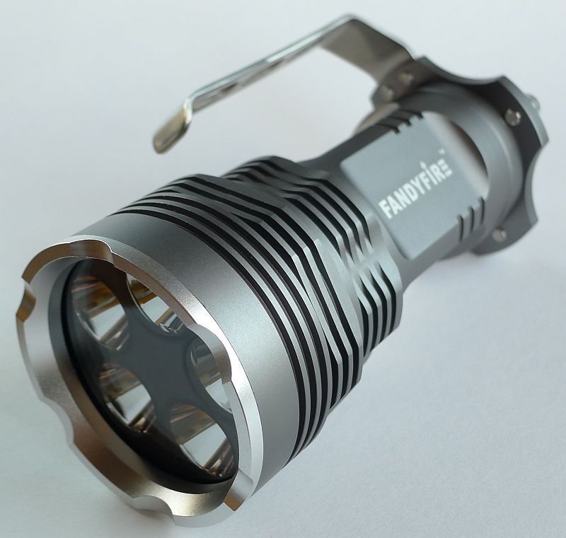

    The 4 x 18650 format is quite common now, and the Raging has a handle to make handling the light easier than gripping the body.
    Lifting the Raging out of the box and the overall construction feels solid with plenty of metal to help keep those 5 XM-Ls cool. The thinness of the metal used to make the handle is the only slight disappointment.

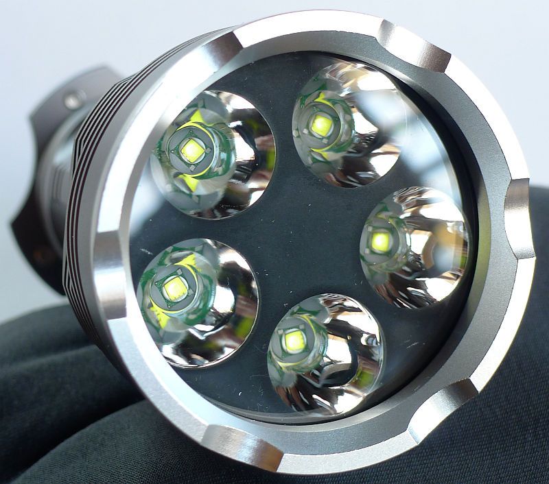

    I like the different look of the five distinct reflectors and black background separating them. This is a different approach to the compound reflectors more commonly seen in multi emitter lights.

    The business end with the five distinct emitters with dedicated reflectors. The black ‘fill’ piece acts to locate the reflectors.
    Looking straight into the array of reflectors and they appear yellow as the emitter surface is evenly reflected. The reflectors are well finished and you can just make out the lines in the emitter surface in the reflections.
    The battery tube has a square section echoing the square battery 1S4P layout.

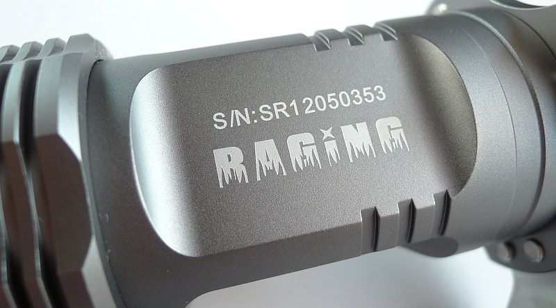

    The graphics are printed onto rather than etched into the surface.

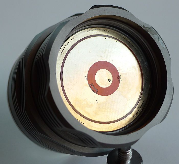

    The contacts in the head for the positive battery terminals and the negative contact ring for the body. The only flaw in the finish is a bit of epoxy resin left on the head (visible at 1-2 o’clock in the photo). Removing this would most likely result in damage to the anodising so I’ve left it. Once the body is fitted this is barely noticeable.
    The negative terminals are springs

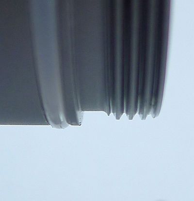

    The threads are well formed and anodised. As supplied the threads and o-ring were dry.

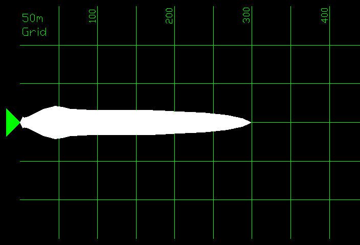

    NEW for Winter 2012 ANSI standards include maximum beam range. This is the distance at which the intensity of light from an emitter falls to 0.25lux (roughly the same as the lux from a full moon). This standard refers only to the peak beam range (a one dimensional quantity), so I am expanding on this and applying the same methodology across the entire width of the beam. From this data it is possible to plot a two-dimensional ‘beam range profile’ diagram which represents the shape of the illuminated area.
    In order to accurately capture this information a test rig was constructed which allows a lux meter to be positioned 1m from the lens and a series of readings to be taken at various angles out from the centre line of the beam. As the rig defines a quadrant of a circle with a radius of 1m, all the readings are taken 1m from the lens, so measuring the true spherical light intensity. The rig was designed to minimise its influence on the readings with baffles added to shield the lux meter from possible reflections off the support members.
    The distance of 1m was chosen as at this distance 1lux = 1 candela and the maximum beam range is then calculated as the SQRT(Candela/0.25) for each angle of emission.
    In this plot, the calculated ANSI beam ranges are plotted as if viewed from above (for some lights there may also be a side view produced) using a CAD package to give the precise 'shape' of the beam.
    Starting with the 5m range grid you get an idea of the broad spread of light pushing forward into the distance.
    Then zooming out to the 50m range grid showing the extent of the beam’s range. Even with the broad beam and wide hotspot, the ANSI beam range still reaches 300m.

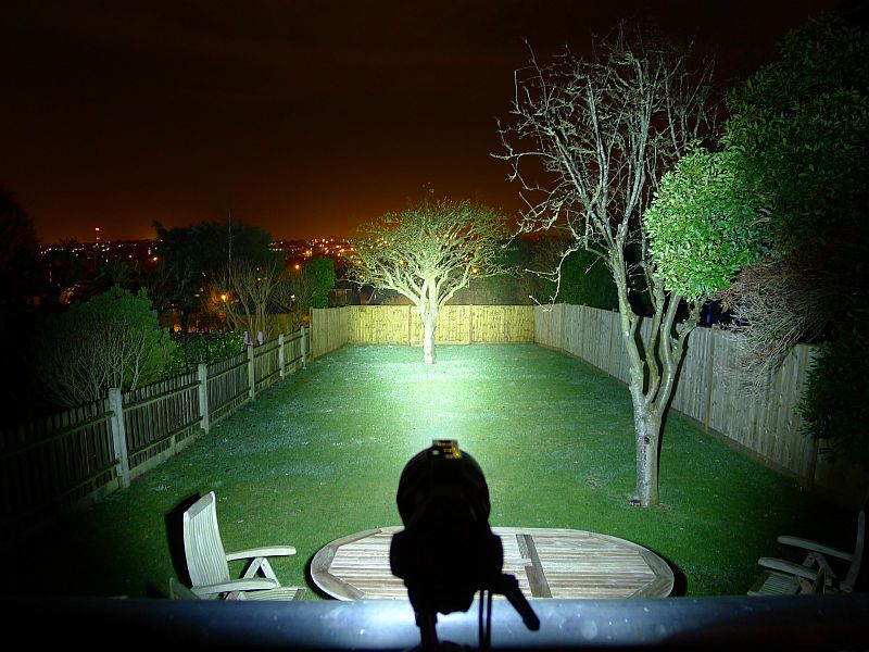

    The beam
    The indoor beam shot shows the wide beam with round large hotspot and the relative lack of multi-emitter artefacts at the outer edges of the spill.
    Now going outdoors, to put things in perspective, this is the TK41 (my frequently used reference light due to its well-known excellent performance).
    And on the same exposure setting the Raging!
    Including a handle in the design of the Raging makes a real difference to regular use of this light. The handle makes it easy and comfortable and even large hands don’t feel cramped.

    I REALLY like your beam profile chart...How do I get one of those?

    The beam profile chart - I've described the way I create them in the review. It is actually a lot of work overall and I've done it for all of my current set of review samples. Once I've finished and posted all of the current crop I wanted to ask for some feedback as to if it is worth doing in future. The profile give the entire beam range shape (not just the peak beam range) - how useful is this?
