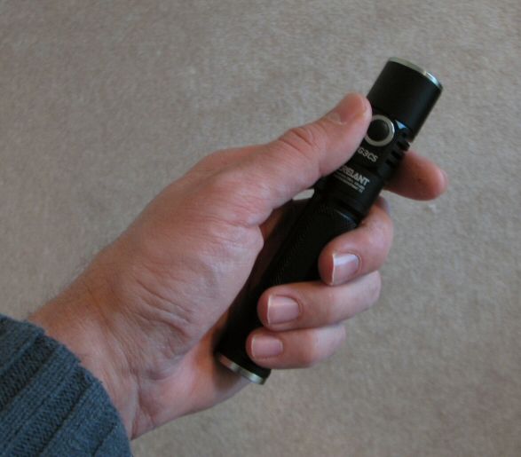

    The 7G3CS is reasonable for a slim-lined light, although it is a little longer due to secondary mode switch. The 7G3CS is definitely at the larger end of both length and weight, in keeping with its relative "thrower" status.
    7G3CS:

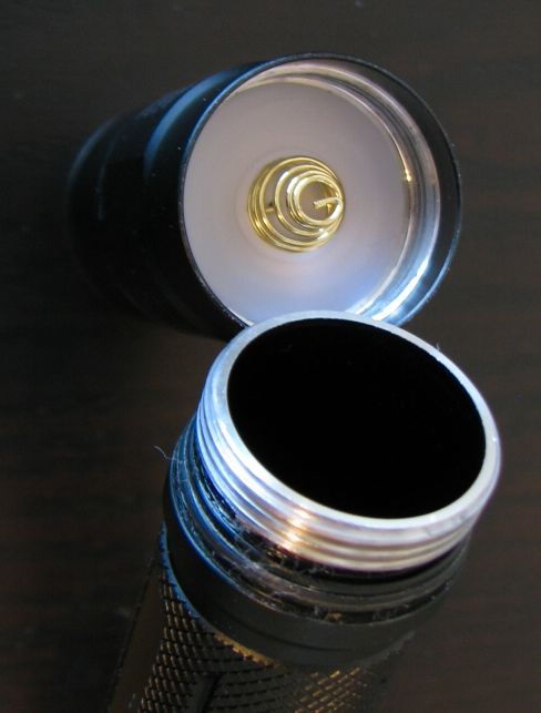

    The 7G3CS is a fairly minimalist build, with an integrated tailcap (i.e., light only opens at the head). Anodizing is a matte black, with no damage or nicks on my sample. Labels are bright white and clear, well centered, and include a serial number. The knurling on the battery tube is of mild aggressiveness, but the cut-out regions are fairly sharp. Grip as ok, but could be higher.
    There is a spring in the head, so all flat-top high capacity cells should fit and work fine in the light.
    The 7G3CS comes with flat-ended stainless steel bezel and tail rings. The light can thus headstand and tailstand (i.e., the tailcap is recessed enough to allow tailstanding).
    Screw threads are traditional triangular-cut, but seem of good quality. They are not anodized at the battery tube/head interface, so I am afraid no lock out is possible. Note that I found the head a bit stiff to tighten, especially over the area where the o-ring is present. Oddly, there is anodizing on the screw threads below the bezel (where it serves no purpose).
    As with the 7G5CS, the 7G3CS uses a forward clicky switch in the tail to control on/off. There is a secondary electronic switch in the head to control output modes. Scroll down for a discussion of the common user interface.

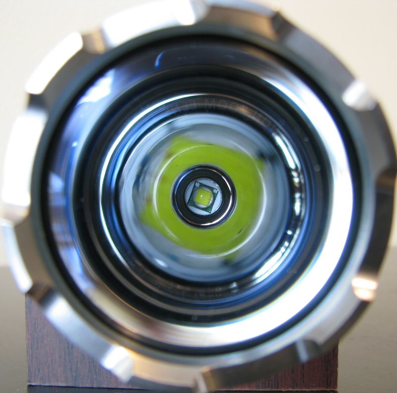

    The 7G3CS uses the new U3 output bin of the Cree Cool White XM-L emitter. The 7G3CS comes with a relatively deep reflector for the class, lightly textured. Don't expect the light to be a thrower, but it should do better than most other slim lights with a shallow reflector.

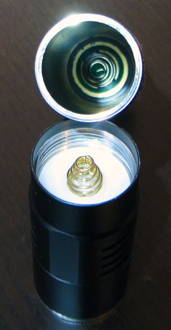

    7G6CS:

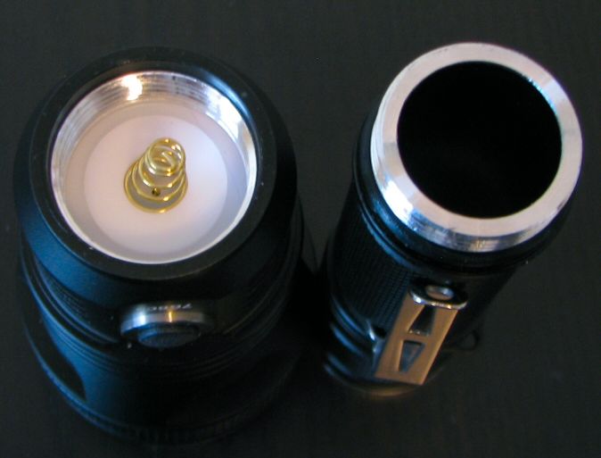

    The 7G6CS has a more traditional build, with a larger head. Anodizing is a similar matte black, with no damage or nicks. Labels are bright white and clear, again well centered, with a serial number. The knurling on the battery tube is similarly mild, but grip is enhanced thanks to the other build elements.
    There is also a spring in the head, so all flat-top high capacity cells should fit and work fine in the light.
    The 7G6CS comes a flat stainless tail ring, allowing tailstanding. The bezel has a slightly scalloped stainless steel ring.
    Screw threads are again good quality triangular-cut, nice and deep. They are also now anodized at the tail, so lock out is possible again.
    As with the 7G5CS, the 7G3CS uses a forward clicky switch in the tail to control on/off, with a secondary electronic switch in the head to control output modes. Scroll down for a discussion of the common user interface.
    The 7G6CS comes with a much wider reflector than the 7G3CS, fairly deep for maximum throw (with a smooth finish). I would expect this light to throw very well for the class. The 7G6CS also uses the same U3 output bin of the Cree Cool White XM-L emitter.

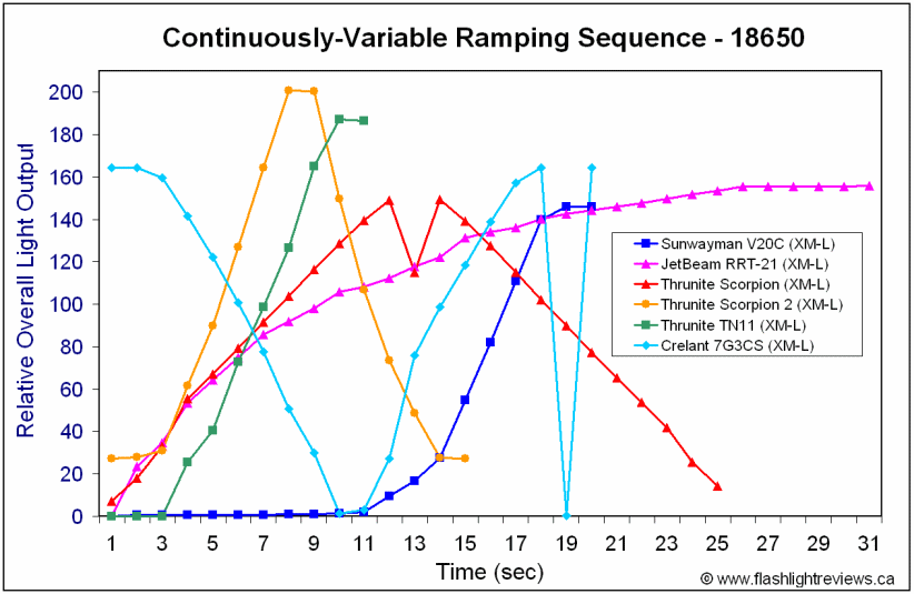

    Pressing and holding the side switch from On begins a continuously-variable ramp in output. Initially, the light ramps down from Max to Min, and then reverses back to Max, in a repeating loop.
    Here's how it looks compared to other lights:
    There is a slight pause when first holding down the switch. Then the light ramps down over ~8 secs. It holds the lowest level for about a second or so, and then ramps back up in the same ~8 sec timeframe. The light flashes 3 times when the max level is reached, and then starts ramping back down after a brief pause.
    Unlike the 7G5CS, I didn't notice obviously discrete output levels along the ramp (i.e., it seems pretty continuous on the 7G3CS/7G6CS).
    There is mode memory for the set level from the continuously variable ramp – as long as you don't turn the light off at the tailcap. If you only cycle through levels by using the side switch, the light will continue to come back to your temporarily memorized set level. This means you change the default Max or Lo mode temporarily – the light reverts to the standard levels for these upon rear switch reactivation.

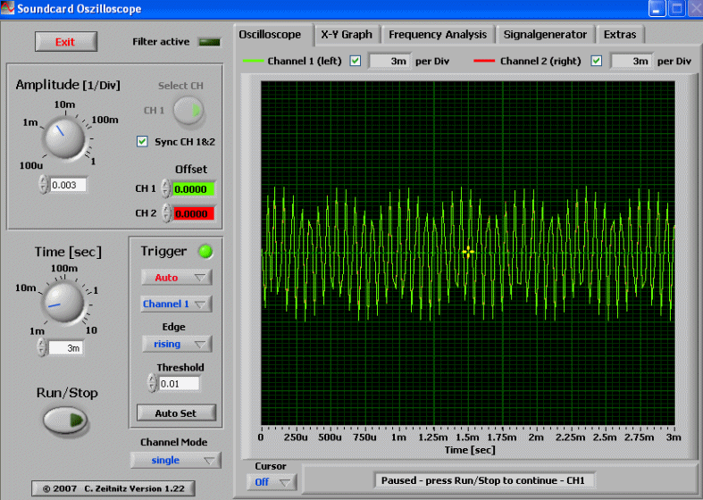

    PWM/Strobe
    There is no sign of PWM on the 7G3CS or 7G6CS.
    However, there is a re-occurring signal at a high frequency:
    As with the 7G5CS, I detected a 15.45 kHz noise pattern at all levels, including Max. But not to worry - this signal is not PWM, and it is not visually detectable.
    The 7G3CS and 7G6CS have a common, and typical, "tactical" strobe mode of 9.8 Hz.

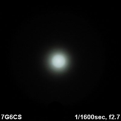

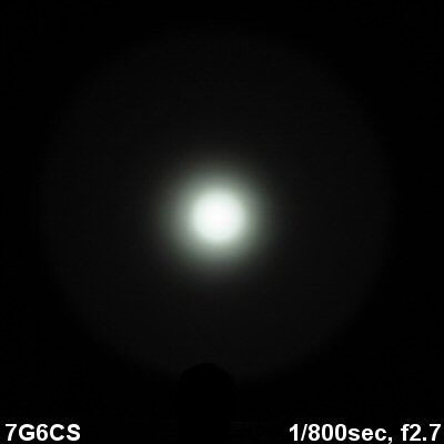

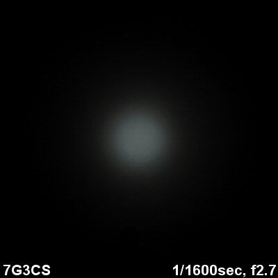

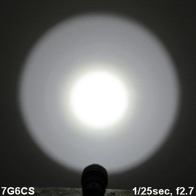

    And now, what you have all been waiting for. All lights are on 1xAW protected 18650, about ~0.75 meter from a white wall (with the camera ~1.25 meters back from the wall). Automatic white balance on the camera, to minimize tint differences.

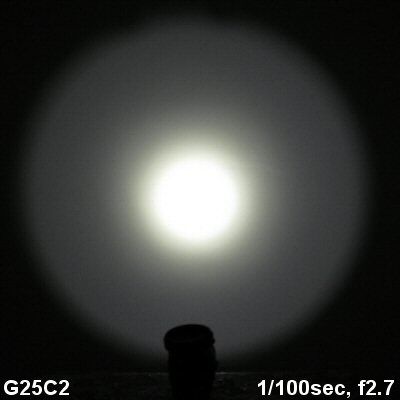

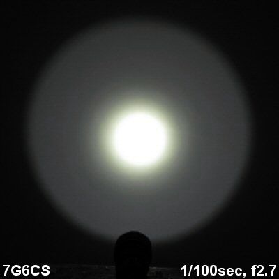

    7G3CS Comparison:
    Due to the fairly deep (and narrow) reflector, the 7G3CS does not have a very wide spillbeam compare to other slim-lined lights.
    7G6Cs Comparison:
    As expected, the 7G6CS is heavily focused for throw. Note that the above are all on 1x18650 ... see my detailed testing results below for a discussion of various battery sources.

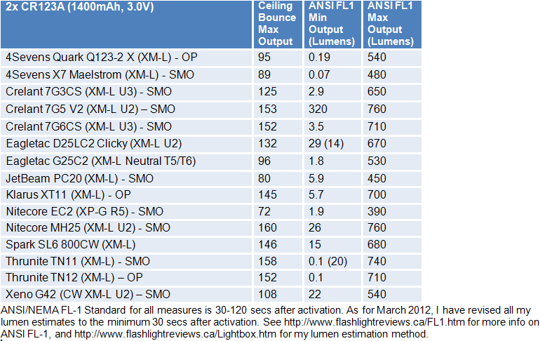

    In terms of output, direct comparison is a bit complicated. While the specs report higher Max output for the 7G6CS over the 7G3VS, on 1x18650 they actually have about the same output. Note that my lightbox tends to under-report heavy throwers somewhat – in practice, I believe the two lights are really putting out the same mid-500ish lumens.
    To see the higher output on the 7G6CS, you have to run the light on 2x battery sources. Again, my lightbox values may be a little low for this throwy light, so the reported 750 lumen spec could be accurate. But note that the 7G3CS is also a bit brighter on 2x sources (though not as bright as the 7G6CS). There is clearly some difference in the circuits used on these two models, but Max output differences may not be as great as the specs suggest.
    Note also that both lights are both brighter on 2x3.7V Li-ion than they are on 2x3V CR123A. I do not know if RCR is supported or not though - the specs don't mention it, although the circuit voltage range implies that they should work. See my runtimes below for a discussion of the 2xRCR results.
    Given all this, it's a bit hard to know what to do with beam intensity. The first observation here is that the 7G6CS ANSI FL-1 beam specs actually seem accurate for Beam Intensity on 1x18650 (i.e., 28,500 cd is believable). But given the higher output on 2x batteries (where the output measures seem to be taken), I would expect even greater throw in that case. It's almost as if the reported Beam Intensity measure is based on 1x18650 (28,500 cd), but the Beam Distance measure is based on 2xCR123A (i.e., 400m).

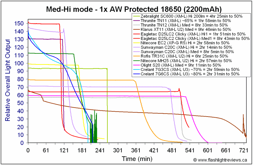

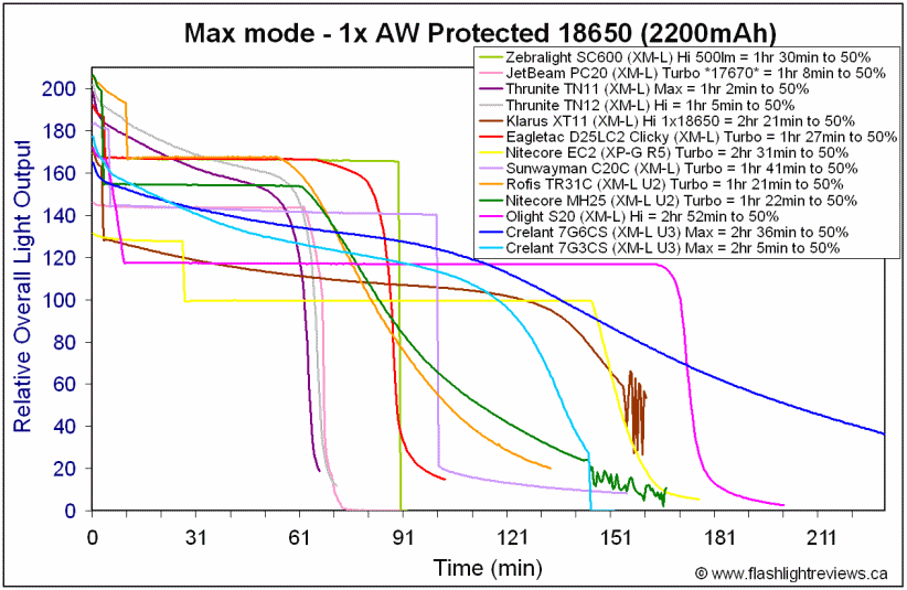

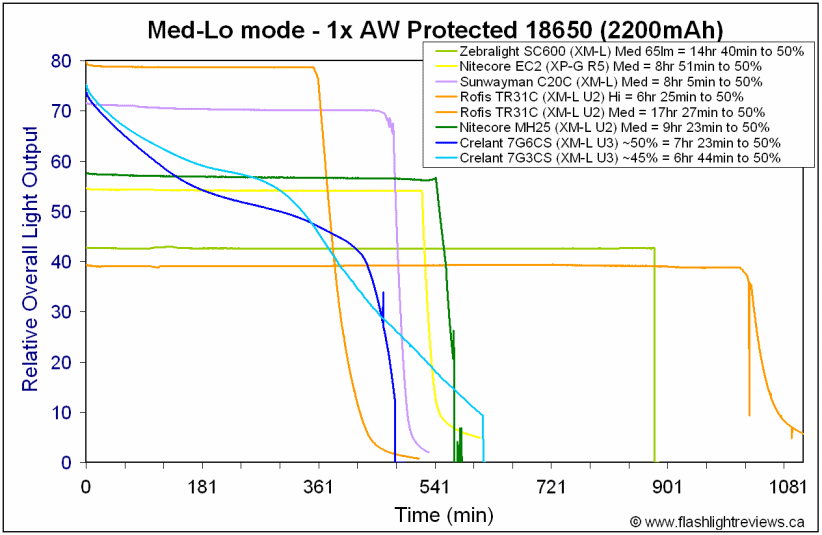

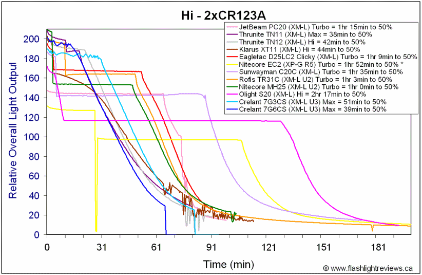

    Output/Runtime Comparison:
    (note: again, I do not know if 2xRCR are officially supported or not - please do not take my runtime tests as any sort of implicit evidence of manufacturer support).
    On the 1x18650, there isn't much to distinguish these two lights – they have essentially comparable output/runtime curves at all levels tested. Note that the lights are only semi-regulated at best (i.e., looks a lot like direct drive, at all levels). Performance is reasonable for continuously-variable lights, but the 7G3CS and 7G6CS are not as long lasting as the defined-level current-controlled lights.
    I've only test Max modes on 2xCR123A, but overall performance is again what I would expect for this class. Note the higher output and lower runtime on the 7G6CS.
    Given the high discharge rates on Max on 2xRCR, I do not recommend you run these lights on Max on this battery source. Especially for the 7G6CS, where the ~19mins runtime leads me to suspect the cells are being discharged at at least a 3C rate (which is too high standard ICR chemistry Li-ion cells). But otherwise, both lights seem to function fine on 2xRCR in my limited testing.
    One interesting point – on both 18650 and CR123A, at all levels, the lights reach an abrupt shut-off at ~10-15% initial output. This has nothing to do with the battery's protection circuit – it appears to be a basic feature of the lights' control circuits. As such, you could probably use unprotected cells in these lights.
    In terms of runtime, the 148 min spec for the 7G3CS on max seems reasonable for 18650 cells (recall that ANSI FL-1 runtimes are time to 10% output). My 7G6CS sample has similar output (and even long-lasting runtime) on 1x18650, so I'm not sure where their 95 min runtime spec comes from.

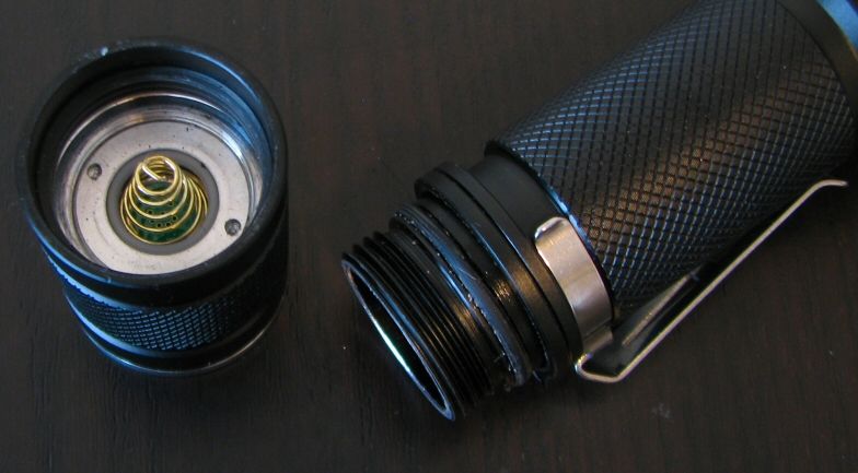

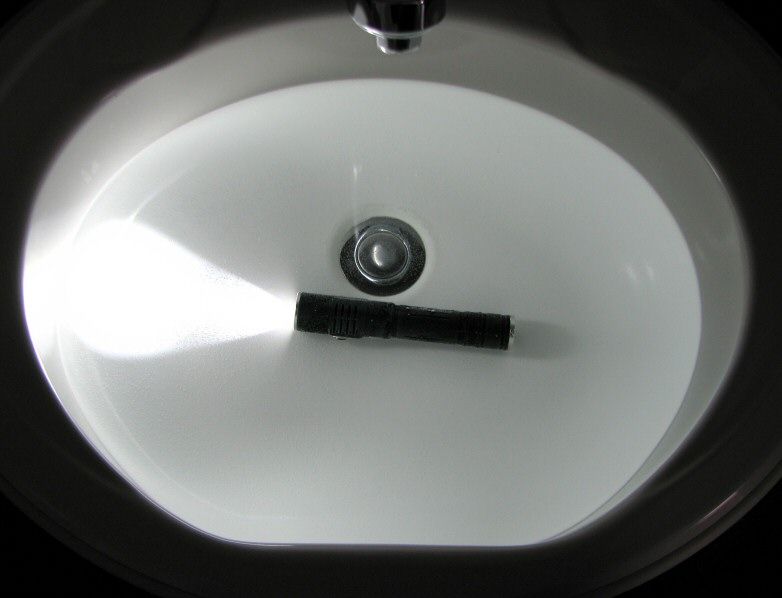

    6,936
    Default Re: Crelant 7G3CS & 7G6CS (XM-L U3, 1x18650/2xCR123A) Review: RUNTIMES, VIDEO, BEAMSH
    Quote Originally Posted by Mags View Post
    Great review Selfbuilt, mine is on it's way. Have you tested waterproof-ness? I am always wary of side-switch lights...

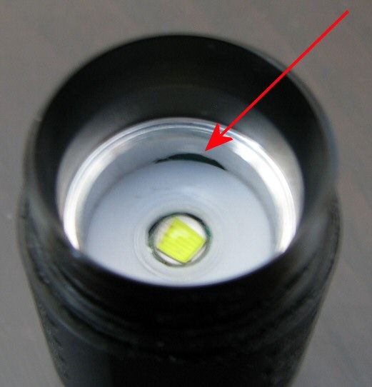

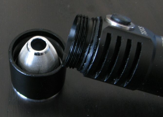

    I just ran the 7G3CS at the bottom of sink for over an hour. Here's how it looked at the end of the run (turned on in Lo before placing in the water).
    The light was still running fine, with no obvious external signs of water entry. Similarly, the battery compartment was bone dry, after removing the light and patting down the exterior.
    However, I did find water entry into the head, when I unscrewed the front part of the light. There are functioning o-rings at the bezel and the base of head (below the screw threads), and both seemed in good shape with no evidence of damage. Further, the water was contained within the area external to the reflector (i.e. around the white centering disc and outside of the reflector). As a result, the most likely source for the water entry was the secondary switch itself. As you can see in the picture below, there is a cut-out area of the pill housing corresponding to the top of the switch:
    The amount of water present was not huge, and the light was still operating. As a result, the light may very well still meet the ANSI FL-1 "water resistant" pass level (which allows some water ingress, with the light functioning normally), but likely not the "water proof" or "submersible" pass levels (which requires no water ingress into unsealed electronics or light source). However, it's also possible that the light could still meet IPX-8, depending on how it was interpreted.
    To explain that, first let me point out that my simple test above does NOT qualify to ANSI FL-1 testing standards (for one thing, the light should be off in testing, and at proper depths). My test here was a quick-and-dirty one, with the light in the On state (as would be likely during use). Also, to be clear, ANSI FL-1 testing levels for water proofness are more stringent than the comparable IPX-levels they are based on. In general terms, ANSI FL-1 "water resistant" is based on IPX-4, "water proof" on IPX-7, and "submersible" on IPX-8.
    However, by strict definition, IPX-8 allows water entry, but "only in such a manner that it produces no harmful effects" for a light tested at >1m depth (duration and depth set by the manufacturer). ANSI FL-1 "submersible" takes IPX-8 a step further, and specifies 4 hour duration (again at depth set by manufacturer, but >1m), and allows "no ingress of water in any functional area that contains unprotected electrical components or light sources". By the ANSI FL-1 "water proof" or "submersible" pass levels, the 7G3CS would almost certainly fail (but I didn't test it specifically to ANSI FL-1 standards). However, the IPX-8 standard alone is a bit ambiguous, so it's hard to know (again, depends on how you interpret "no harmful effects").
    This is part of the reason why I don't typically do water resistance tests. Most manufacturers claim "IPX-8" ratings, without giving the actual depth and duration measures that the rating requires them to specify (which thus renders the value of the rating meaningless, in my view). They also do not clarify if they are using the more stringent ANSI FL-1 "submersible" IPX-8 standard with no water ingress, or the looser general IPX-8 of "no harmful effect" of water ingress.
    What this all means for end users in this case is that I would recommend that you do not go swimming with these lights. But they should be fine to resist the occassional dunk or splash, which is all I would consider ANY light good for unless it met the more stringent ANSI FL-1 "water proof" or "submersible" pass levels and testing.

    Thanks for that Selfbuilt, I didnt know there was such a difference between IPX and ANSI ratings. I guess the test you did would apply to the switch on the 7G6CS as well?
    6,936
    I would guess it would be comparable, but can't really tell (i.e., the switch area is fully contained within the pill). So even if water came in, it could remain trapped inside the pill and I wouldn't see it.
    Ultimately, the IPX ratings are a fairly general high-level set of categories. They are open to broad interpretation, in order to be flexible for what exactly you are testing (and they expect the manufacturer to provide the needed details on the stringency level for a given rating). A manufacturer could certainly interpret IPX-8 the same way as as ANSI FL-1 has ... but they don't necessarily need to. Ultimately, ANSI FL-1 is just a very specific testing regimen for flashlights specifically, with a lot more explicitly spelt out. As with all standards, it is not necessarily good or bad to do it a certain way - it's just a way to be as consistent as possible.

    I just opened two of the 7G3 models. My nuetral white back up does not have the plastic insiulator and the emitter and board are visible. A second one had the plastic insulator with no gap between the plastic and the board. Evidently there is some minokr variation in the construction. It has been daining heavily here in Houston and last night I used my lights in the rain to work a traffic accident. After mode than 20 minutes in a downpour it was bone dry inside. Overall performance in real world hard use has been very good.

    Quote Originally Posted by madecov View Post
    Thanks for the report madecov. Yes, I would expect the light to handle 20 mins of rain just fine (my light was still running after an hour's immersion, after all).
    To be clear, my waterproofing comments above are not specific for this model - it's a general issue that the vast majority of lights likely won't meet the ANSI FL-1 "sumersible" pass level for IPX-8 (although they may meet a looser intepretation of IPX-8). I have no reason to think the 7G3CS does any measurably worse than any other light, since I don't rountinely test for this (and it would be hard to know if water got into the pill anyway, for most lights ).
    End of the day, I don't expect people would have any greater issue with these lights than any others (certainly among those with side switches).

    Did you check the o-rings before the test? As a diver who occasionally takes pictures underwater I don't trust any high-use o-ring (tank, camera housing, flash battery compartment, dive light, etc.) straight from the store. I remove the o-ring and apply silicone grease with my fingers so I can feel for any grit, metal shavings, etc., then re-install.

    Yes, that's exactly why I lubed the two o-rings in the head immediately before this test. I didn't lube the bezel o-ring though, so I can't rule that one out.

    Well, the rain I was not just a light sprinkle. This was a full blown local flooding downpour. I had not lubed the O ring around the bezel but did lube the others. While my lights do get hard use on dutty they are not abused.

    Great review but I wish you had tried it with 2 RCR123 batteries.
    6,936
    Quote Originally Posted by ZRXBILL View Post
    I may still add those to the reivew, if I can find the time.
    I am coming across an increasing number of lights where the specs *appear* to support 2xRCR, but the manufacturer makes no explicit mention of support for 2xRCR. This puts me in a bit of a bind - I've had issues in the past where I've done runtime charts of non-supported batteries in the review, and people come back to me later complaining they thought they were officially supported (because I had tested them and presented data). It's a catch-22 - I don't want to give a misleading impression of what's supported by my testing, but I do want to provide provide impartial and independent results of the way people may use the light. The 2xRCR space is particularly problematic because of all the sometimes ambiguous ratings (i.e., not-supported vs not-mentioned vs supported-but-not-recommended, etc.).
    But I'll see if I can at least do a max mode run here ...
    Nov 2009
    Oklahoma
    296
    That's why I was wishing you had done it because I noticed that RCR123s were not mentioned but they do state 2.7-8.5 voltage so I assumed they would work ok.
    6,936
    Yeah, I'll run them tomorrow and update the review (with the proviso that I am not recommending their use, just testing to see if they work).
    Here you go, for 2xRCR on these lights. Note again, I do not have any direct knowledge of whether or not these are "supported" - I am just testing to see what the output and runtime is like on Max.
    Output has definitely increased from 2xCR123A, for both lights (which were in turn higher than 1x18650). Of note, even the Min modes have increased (scroll back up to the main review for comparison tables and runtimes for all three possible battery configurations).
    Given the high discharge rates on Max, I do not recommend you run these lights on Max on 2xRCR. Especially for the 7G6CS, where the ~19mins runtime leads me to suspect the cells are being discharged at at least a 3C rate (which is too high standard ICR cells). But otheriwise, both lights seem to function fine on 2xRCR in my limited testing.
