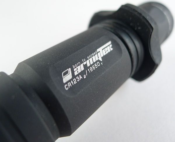

    The side of the battery tube has two flat areas with the logo and model.

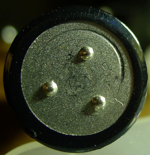

    Due to the terminal design, the Predator can use button or flat top cells. However I did come across one issue when trying to use AW’s 3100mAh cells.
    AW’s 3100mAh cells have three raised dots on the negative terminal. When screwing the tail-cap on, the metal cap on the Predator’s negative terminal spring, catches on these dots and gets dragged sideways. As you can see here, the battery terminal has a groove scored into it when this happened.
    Inside the tail-cap there is similar damage where the negative terminal cap dug in. When this happened the tail-cap switch was bypassed and the light came on without the switch being pressed.
    This only happened due to the raised dots. The AWs are the only cells I have with this design feature, but unfortunately it means you cannot use them with the Predator.
    Due to this, all testing was carried out with Fenix ARB-L2 18650 cells and CR123 primary cells.

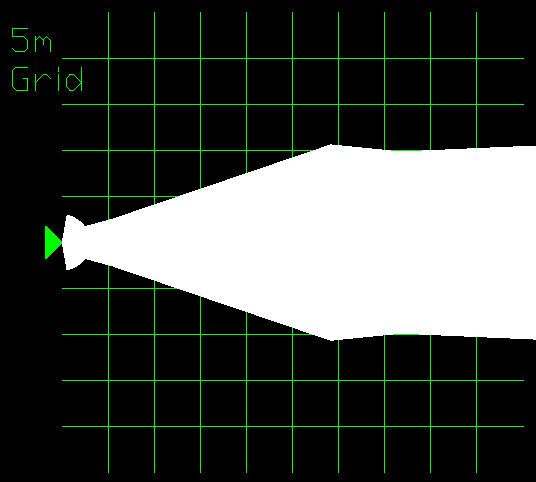

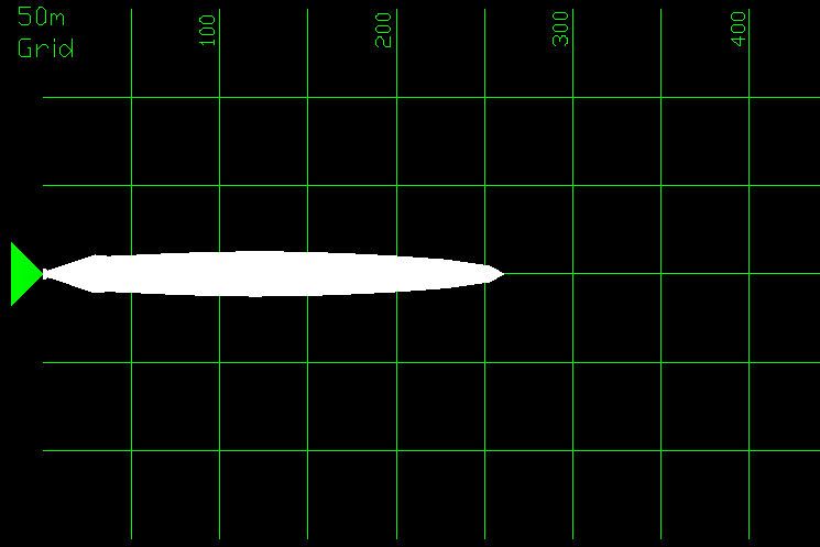

    NEW for Winter 2012 ANSI standards include maximum beam range. This is the distance at which the intensity of light from an emitter falls to 0.25lux (roughly the same as the lux from a full moon). This standard refers only to the peak beam range (a one dimensional quantity), so I am expanding on this and applying the same methodology across the entire width of the beam. From this data it is possible to plot a two-dimensional ‘beam range profile’ diagram which represents the shape of the illuminated area.
    In order to accurately capture this information a test rig was constructed which allows a lux meter to be positioned 1m from the lens and a series of readings to be taken at various angles out from the centre line of the beam. As the rig defines a quadrant of a circle with a radius of 1m, all the readings are taken 1m from the lens, so measuring the true spherical light intensity. The rig was designed to minimise its influence on the readings with baffles added to shield the lux meter from possible reflections off the support members.
    The distance of 1m was chosen as at this distance 1lux = 1 candela and the maximum beam range is then calculated as the SQRT(Candela/0.25) for each angle of emission.
    In this plot, the calculated ANSI beam ranges are plotted as if viewed from above (for some lights there may also be a side view produced) using a CAD package to give the precise 'shape' of the beam.
    Starting with the 5m range grid, the G2’s beam profile.

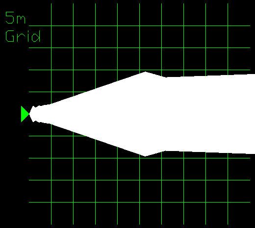

    And the Predator X’s on the 5m range grid. Although the spill of the G2 is specified as 5º hotspot and 24º spill and the Predator X with 8º hotspot and 55º spill, although the Predator X does have a stronger spill, the difference is not as obvious as it is in the beamshots.
    However zooming out to the 50m grid shows a bigger difference with the G2 being a strong thrower.
    And the Predator X having a generally wider beam up to 150m (with the broader spill using up the extra output of the Predator X).

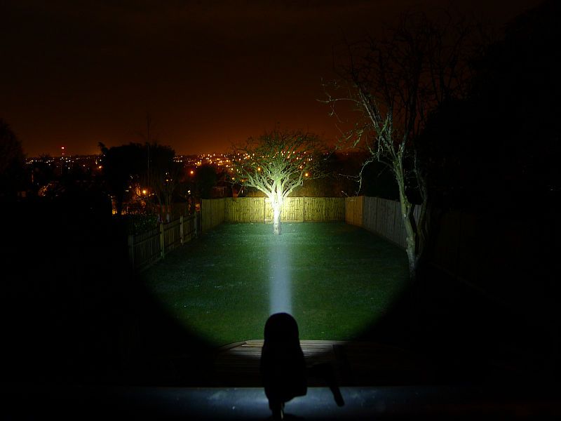

    The G2 version’s beam is very smooth with a very even and round hotspot
    Underexposing the beam shot shows the very bright and round small hotspot
    The outdoor beam shot confirms how good the throw of the Predator G2 is.

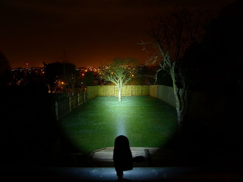

    The Predator X’s beam has a much brighter spill and much wider hotspot.
    The difference between the Predator X and G2 version being even more obvious outdoors (same exposure setting as the G2)

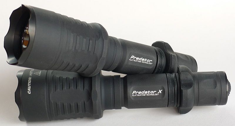

    For an idea of the size of the Predator V2.0 compared to other 1x18650/2xCR123 lights, here they are shown with (from the left to right) the FOURSEVENS Maelstrom X7, Fenix TK15 and Fenix TK22. It is the size of the excellent quality reflector that makes the Predator slightly longer and it is this reflector that gives the Predator such a great beam.

    My 1 dimensional mind was curious what was the lux @ 1m for the G2?
    Hove, UK
    2,468
    Default Re: ArmyTek Predator G2 V2.0 and Predator X V2.0 dual Review
    Quote Originally Posted by rickypanecatyl View Post
    Great review - thanks!!
    Peak reading for the G2 was 29300lux @1m giving an ANSI beam range of 342m
    Peak reading for the X was 17000lux @1m giving an ANSI beam range of 261m

    Thank you for presenting this review. I too have been waiting a long time for this type of comparison as I have been contemplating the purchase of these lights.
    I see the packaging description show the tint bin on the XP-G2 R5 1C which should be a cool white.
    In your beam shots, is it me or does the beam color seem sort of green? Or maybe you have green interior walls? ON your stair rails, the color looks more normal.
    Or is it perhaps in real life use, it's not that green and perhaps more closer to a neutral white color?

    You are right regarding the walls. Unfortunately I don't have a suitable location to really show the tint. In the indoor shots the woodwork (stairs and skirting) are white and the walls are Farrow and Ball 'String' so make the colour look warmer than it is. The woodwork gives better idea of tint.
    The beam is Cool White.
    Thanks for the feedback! Those are some good #'s... a little more throw than a Deree DBS R2, twice the lumens and slighly smaller!
