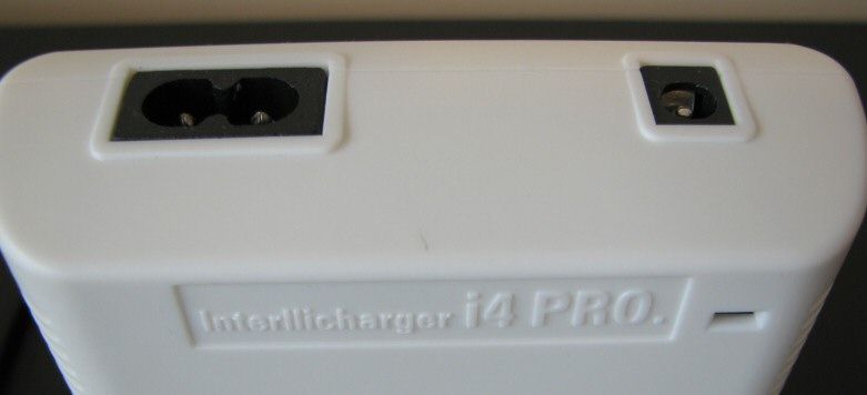

    As an aside, I'm sorry to say Jetbeam has apparently misspelled the unit's name as "Interllicharger" on both the packaging and unit itself.

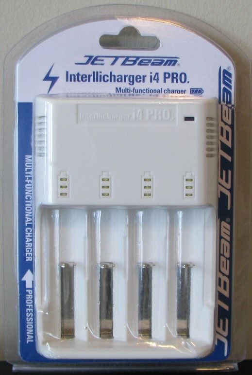

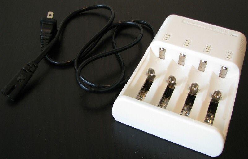

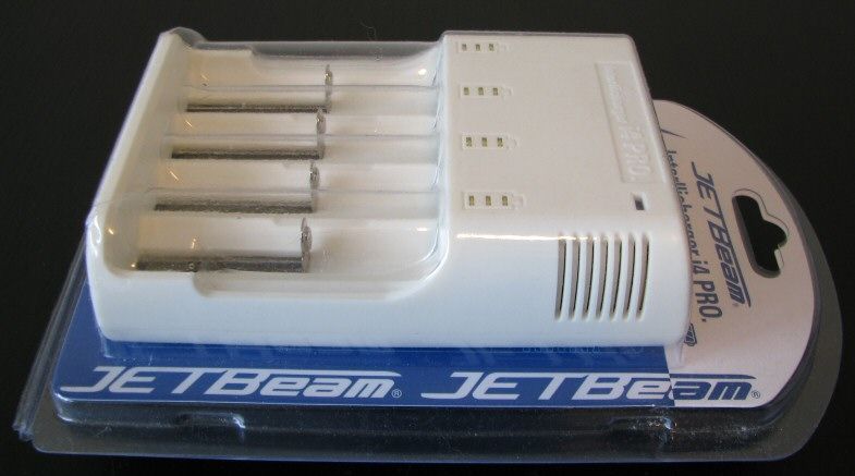

    As with my Nitecore i4 V2, the Jetbeam i4 RPO comes with just a standard 110 AC power adapter (North American-style plug, in my case). The unit supports 100 – 240V AC, 50/60Hz, so those outside of North America can use it fine (with the appropriate terminal plug). A 12V DC car adapter is available separately, as before.

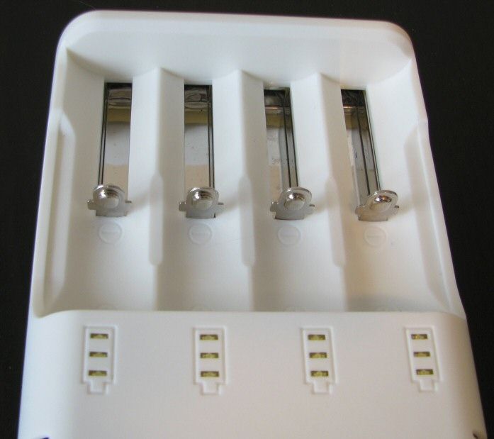

    Stylistically, the unit is now white instead of black, with more rounded edges. But there are two obvious physical changes that are significant – and welcomed, in my view.

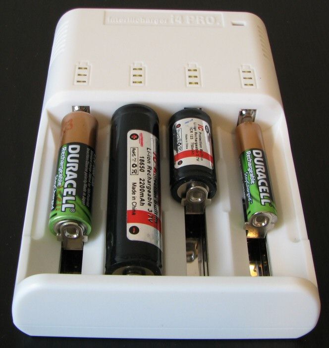

    The first is the battery channel springs now seem to sit in a metal rail. Spring action is definitely improved on the i4 PRO compared to the earlier i4 V2s I've handled – nice and smooth now, with no need to add extra lubricant any more.

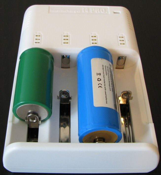

    The second change may seem minor – the cut-outs on the sides of the charging bay are now deeper near the top of the unit.
    This means that you can now fit oversized cells (like the green NiMH C-cell shown above) comfortably in slots 1 and 4. Previously, on the i4 V2, I found these could only fit well in slots 2 & 3, which meant you could only charge one at a time. By allowing the greater space at the edges, you can easily charge two such cells at once.

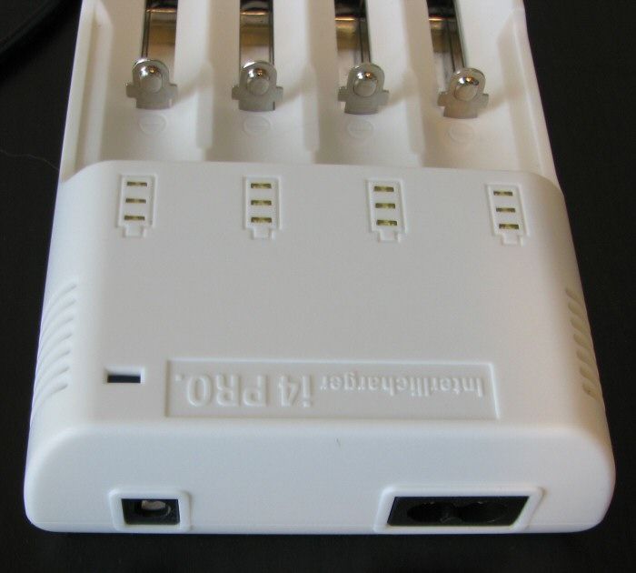

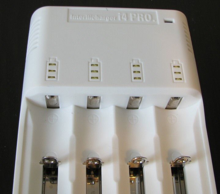

    There are some label changes, but these are unfortunaltely not for the better. Much like the "interllicharger" labeling issue, there has also been some sort of mangling of the charge and current specs on the back of the unit. As was clearly labelled on the original Nitecore i4 V2, the current levels (350mA x4 and the 750mA x2) are independent of the voltage support for 1.4V and 4.2V cells. For the i4 PRO, it looks like someone confused these as being linked in some way by "criss-crossing" the entries without clear dividers. And in any case, the currents are both listed wrong now on the i4 PRO - it is still 375mA x4 (not 500mA), and 750mA x2 (not x4), as you will see in my testing results below.
    Here is a quick video overview of the physical build of the new i4 PRO charger, and how it compares to the original:

    As before, there are three yellow lights located over each charging bay, and a blue power indicator at the top right hand side of the unit (lights up when AC/DC power is supplied). Previously, on the i4 V2, one flashing yellow LED indicator on the bottom meant the unit was charging, and the battery was less than 1/3 full. One solid on the bottom and one flashing LED in the middle meant the unit was charging and the battery was more than 1/3rd full, but less than 2/3rd full. Two solid and one flashing LED meant the unit was charging, and the battery was more than 2/3rd full. Three solid LEDs meant the battery was fully charged and the unit had stopped charging.
    On the new i4 PRO, the bottom LED is always lit, and the unit cycles through the second and third LEDs to indicate the battery is charging (i.e., they flash on/off, in sequence). Once the battery is 2/3rds full, the bottom two LEDs remain constantly on, and only the third LED flashes. When fully charged, all three LEDs remain solidly on.

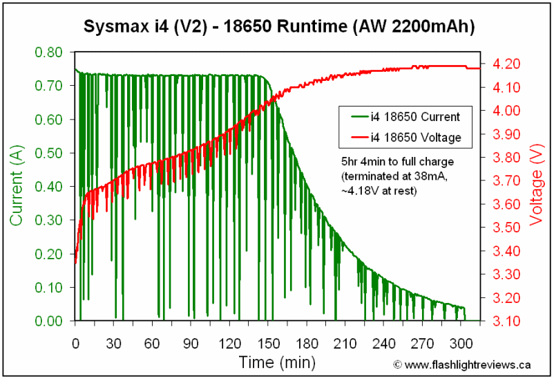

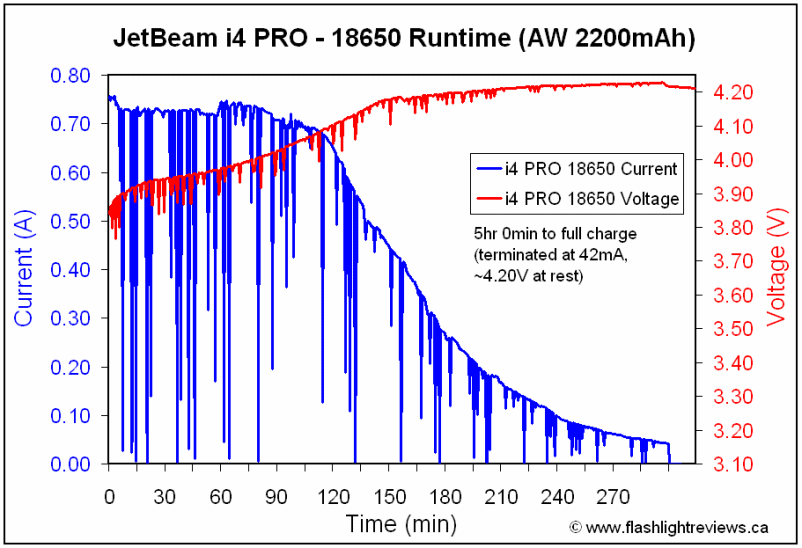

    To examine the performance of the charger, I have directly monitored charging current and voltage with a data-logging DMM (on separate runs). For these tests, I have used my standard AW protected 18650 (2200mAh) and RCR (750mAh) cells, and Sanyo Eneloop AA NiMH. The cells used here have all had a good number of cycles on them, but are still in reasonable condition. To deplete the cells, I used my regular test bed of a fully-regulated JetBeam Jet-III ST, Jet-II or Jet-I Pro (all IBS models) on Max output – and wait until the cell’s protection circuit gets tripped. The cell is then immediately loaded into the charger for testing and recording (depleted resting voltage typically <3.4V).
    Let's start with something simple: 1x18650 and 1xRCR:
    The i4 PRO charging algorithm looks pretty much the same on 1x18650 as the i4 V2 (keeping in mind this is a different cell being tested). While not a completely proper CC/CV (i.e., it doesn't keep the CV phase voltage entirely constant), it at least approximates it well. The initial charging current remains at 750mA, as before.
    Again, we see a similar pattern on the i4 PRO as the i4 V2 for 1xRCR. The unit does not keep the initial full 750mA CC phase for long, and drops in current fairly soon. Although it seems to stay at a higher current longer on my i4 PRO, that may have more to do with the batteries used than the circuit (i.e., this is a different RCR from the earlier i4 V2 review, but of comparable age and usage).
    The low ~40 mA termination level on Li-ion is very respectable, and means that lower capacity Li-ions can probably be safely charged in the light (e.g. RCR, 14500, 10440, etc.).
    In both the 18650 and RCR tests, my cells show a resting voltage of ~4.19-4.20V, which is good. Note that my testing cells were well used, so it's possible newer cells might terminate slightly higher.
    Note also that although my DMM drops to zero, i4 PRO does not completely terminate when the three yellow LEDs go solid. Although my DMM dropped to zero on my 10A port, when I switched over and re-ran the termination charge on my DMM’s mA/uA port, I measured a low 114 uA current. But this is low enough to be irrelevant. Note that this is also the same as my i4 V2 (which was measured at ~110uA).
    As a side note, I wish the manual would stop referring to this as a "trickle charge." A true "trickle charge" usually involves a regular pulse of mA current, to maintain the fully charged state. This is not a good thing for Li-ions – most "trickle chargers" are set too high, and over the long-term, will slowly cook your batteries (i.e. it gradually over-charges the cell, as long as it sits in the charger). The constant low uA current here is negligible, and will not lead to "trickle-charger" style over-charging. For all intents and purposes, the i4 is close enough to full termination.
    As an aside, the frequent "dips" in the i4 PRO and i4 V2 graphs above have to do with how the chargers operate – they actually stop charging once every two seconds to check to see if anything has been inserted into the paired charging bay. I don't have an oscilloscope to show you the exact pattern, but I can estimate from my sampling measures that it takes just under a third of a second to check. This is enough to drop the current/voltage reading in the traces above. My sampling rate is once every 30 secs, hence the why you don't see a continuous "wall of noise", but just sporadic dips (i.e. there is a ~15% chance my DMM will be taking a reading during a charging pause).

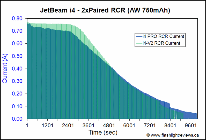

    For comparing what happens in paired bays, I had to load things a little differently – for the i4 PRO, the cells are in bays #1 and #2, for the i4 V2 they are in #2 and #4.

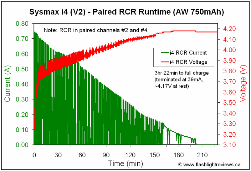

    Overall, there is not a big difference - except it again seems like my i4 PRO holds the CC phase longer when two RCR cells are being charged (compared to either the i4 V2, or the 1xRCR charging situation). Again, this may simly have to do with the fact that different cells were tested on the i4 V2 review (of equivalent age and use pattern to ones tested here though). I don't consider this very significant - effectively, the two chargers perform pretty much equivalently. You just need to remember that the specific bay pairings have changed.
    Because the chargers alternate the current between the paired bays (i.e. only charges for one second out of every two seconds, with a ~1/3 sec pause to check the bay status), it takes longer to charge the cells. This means I would continue to expect 10+ hours to charge two 18650 cells in paired bays.
    UPDATE JANUARY 8, 2013: FYI, I've justed tested the i4 PRO and i4 V2 with the same RCR cells, and it doesn't look like there's any real difference between the chargers. Here's a chart showing the same RCR cell (with a matched pair) in both chargers, in direct overlay (i4 V2 in green, i4 PRO in blue). I've increase the sample frequency to 1sec for each run, to allow you to better compare.
    The i4 V2 kept the charge level slightly more stable for longer, and the i4 PRO ran a little longer at the end. But for all intents and purposes, you could consider these charging algorithms as identical - what you are looking is probably just natural variation from sample unit to another.

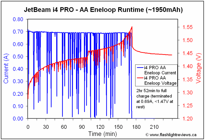

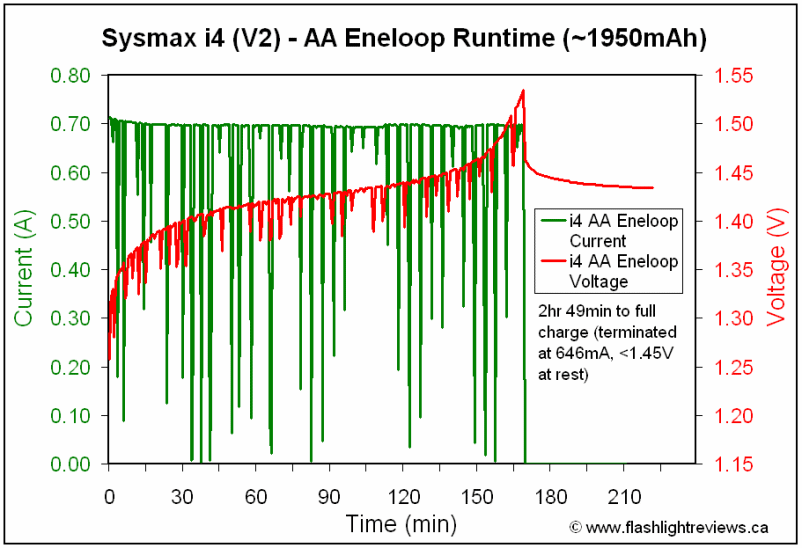

    So how does NiMH look?
    And once again, nothing really seems to have changed. As before, the i4 PRO charger ran at a CC cycle of just over ~700mA in my testing.
    Note that unlike Li-ion, NiMH chargers don't work by a CC/CV method. Instead, they typically terminate when the battery reaches a particular voltage level, based on a characteristic increase in the positive slope of voltage versus time (i.e., dV/dT). As you can see in my runtime traces, there is a very pronounced uptick in voltage just before the run terminates. I haven't tested other NiMH chargers, so I don't know what to expect for proper dV/dT termination, but the commentary on my i4 V2 review suggests this isn't it. But like the Li-ion algorithm, it seems a reasonable facsimile.
    Oh, and as before, you can charge both NiMH and Li-ions at the same time, even in paired bays. There was some issues in doing this on the original i4 V1 (which was recalled), but there's no problem in doing it here or on the i4 V2.

    but i am not going to buy a charger which says "Interllicharger".
    that's too annoying ymmv.

    Amazing how this made it to market without anyone going "Interllicharger, what?". Apart from that I'm quite happy with my i4 v2 (non-PRO). :P

    Inspiring great confidence that they cant spell thier own product , any better than I could :-)
    and . . . does this mean that the clone of it could be recognised by it being spelled correctaly ?
    Here's a chart showing the same RCR cell (with a matched pair) in both chargers, in direct overlay (i4 V2 in green, i4 PRO in blue). I've increase the sample frequence to 1sec for each run, to allow you to better compare.

    I wonder whether spelling "Interllicharger" was unintentional or whether it was intentional due to Sysmax/Nitecore owning rights on Intellicharger name?
    Jetbeam in their announcements regarding separation with Sysmax/Nitecore said that Nitecore, without Jetbeams permission, had registered Jetbeams intellectual property under Nitecore trademark.
    So, perhaps they didnt want to lose potential customers with giving their charger completely new name, so they picked up the same name but to avoid legal problems they went for misspelled name !

    can this charger fit 3400mah protected 18650s? 2900mah protected 18650s were hard enough in the old i4. and how come on ebay everyone listing this charger says its 110v - 220v and here you say its 240v
    6,936
    Default Re: Jetbeam i4 PRO Intellicharger Review: Current/Voltage Comparisons for Li-ion & Ni
    Quote Originally Posted by jay_rush View Post
    I don't have any 3400mA cells to test. But the cell bay hiehgt tolerances of my i4 PRO are slightly greater than my i4 V2 (maybe up to ~1mm extra for height).
    As for the voltage range, "100-240V" is what the manufacturer website specifies, as well as the dealer site who provided the unit for review. In manufacturer specs section of my reviews, I always list what the manufacturer actually reports. In this case, I note the back of the unit specifies "110-220V" input, which may explain why eBay vendors are using that. Note that the output specs on the back of the unit are wrong on my sample.
    Either way, the point to the above is that the unit is indeed meant to operate on 110V or 220V systems - they have just expanded the official range on the specs. I suspect this is because there are places in the world that are actually more like ~230V.
    Yes, I charged several Orbtronics 3400 mAh protected 18650 batteries with no problems at all. Actually, the longest 18650 battery I have is a BriteStrike 2400 mAh 18650 battery that came with a BriteStrike flashlight/charger combo. That battery barely fits in some of my chargers and almost had to be forced into one of them. Even that batterry fits nicely in the Jetbeam Intellicharger i4 Pro.
