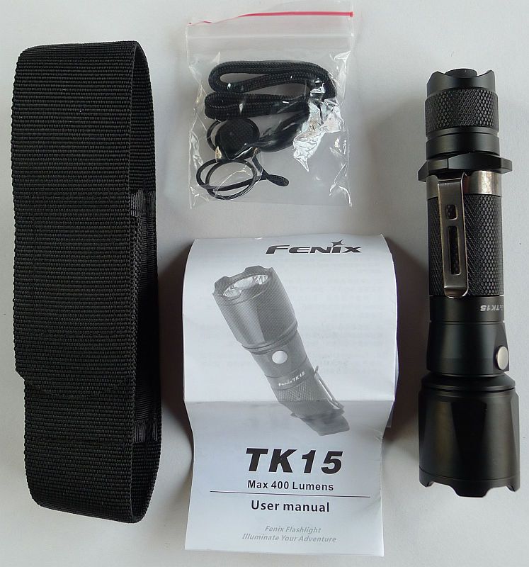

    The TK15 S2 arrives in the typical Fenix packaging, a very good standard of presentation.
    Included are the TK15 S2 with pocket clip and tactical grip ring fitted, nylon holster, instructions, lanyard, two spare o-rings and a spare rubber switch boot.

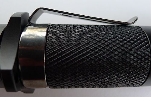

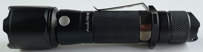

    As it comes out of the box, the TK15 S2 has the pocket clip and tactical grip ring fitted.
    The clip is well finished with no sharp edges so it won’t be cutting up your pocket (though the knurling might wear the fabric a bit)

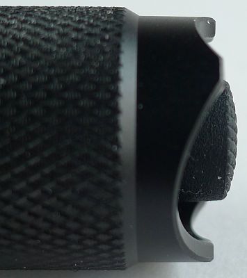

    The tail cap switch has crenulations.
    But these are not tall enough to allow for tail standing as the button protrudes.

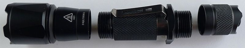

    Both the head and tail-cap unscrew, showing the quality threads and single o-ring at each end of the battery tube.
    The negative terminal in the tail-cap is a spring.
    The trademark trapezoid threads used in most Fenix lights are cut precisely and fully anodised.
    In the head, the positive contact is also a spring, providing excellent shock protection and ensures reliable terminal contact for the battery.

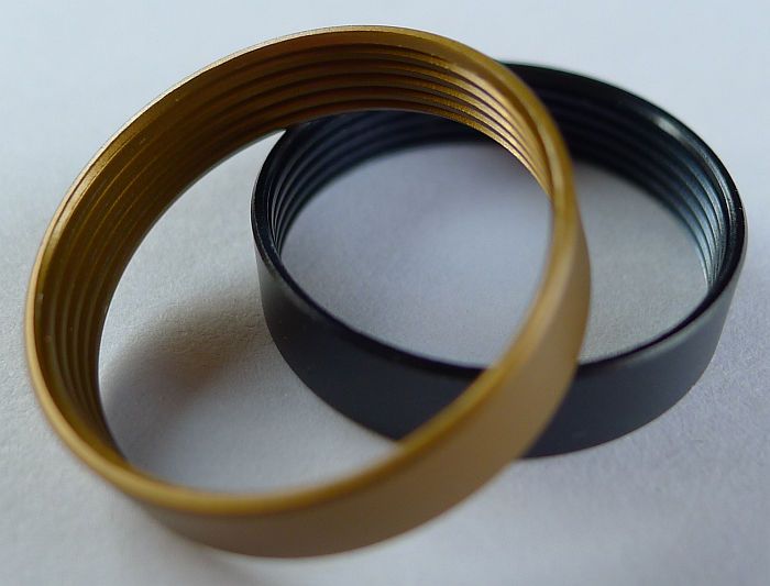

    To cover the exposed threads when the grip ring is removed, there are two colours of optional thread covers available.

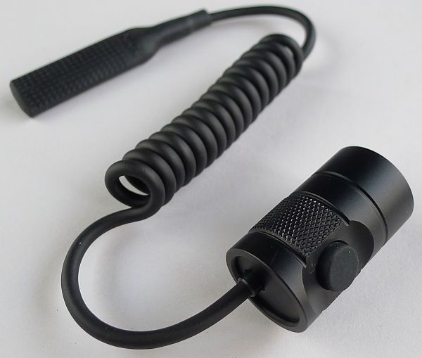

    To go with the use as a gun mounted light, Fenix make one of the best remote switches I’ve used. The AR102 replacement tail cap switch has not only the robust remote pressure pad switch, but also a clicky switch built in, so you still maintain the ability to latch the output on without having to press the remote switch. This dual function means you don’t have to choose between only momentary pressure switch operation and continuous output, the AR102 gives you both.

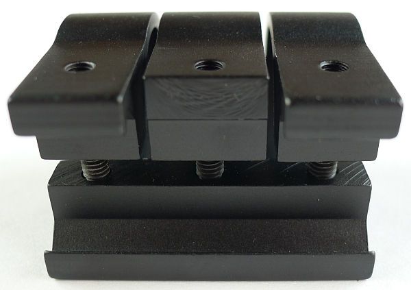

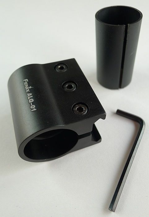

    The Fenix gun mount fits a picatinny rail (or weaver), and includes a sleeve to allow it to mount 25.4mm tubes and slightly smaller ones using the sleeve.
    The design has three ‘fingers’ which are independently adjustable. The middle one grips the light, and the two outer ones clamp onto the rail.

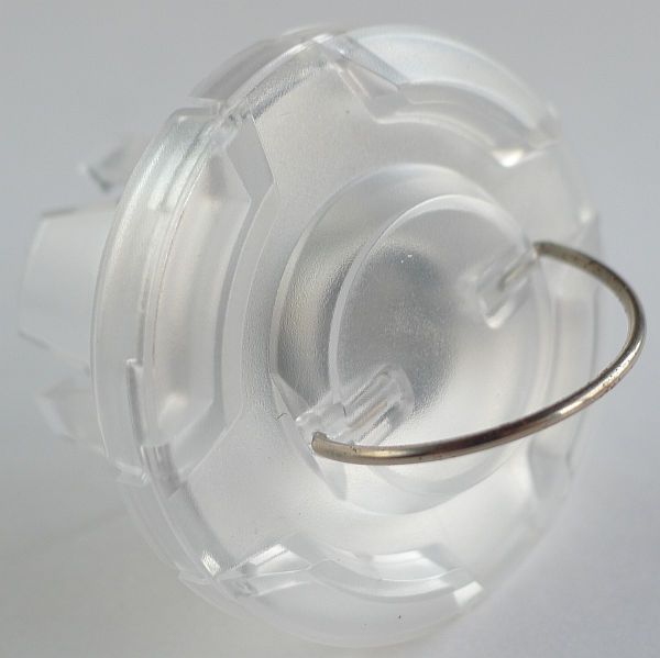

    If you would also like a lantern you can hang inside a tent or other working/living space, the TK15 S2 has a lantern adapter. This has a shaped reflector to spread out the normally focussed beam and send it into the 360º diffuser.
    This has a hanging loop.
    The lantern adaptor has fingers which lock into the groove round the TK15 S2’s head and give a very firm grip.

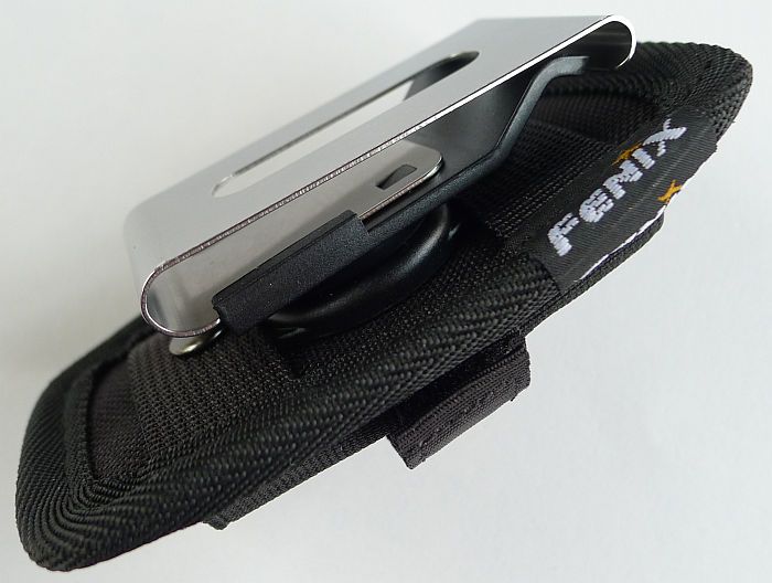

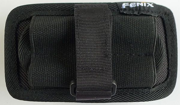

    The last accessory in this group is an interesting belt holder. I refrain form using the word holster and this holder is designed to hold the light firmly so it doesn’t fall out. The AB02 has a stainless steel belt clip, and once attached, the holder rotates in 45º increments to allow you to angle the light where you want it.
    There is an elasticated tube into which the light body slips and a tightening strap to secure it.

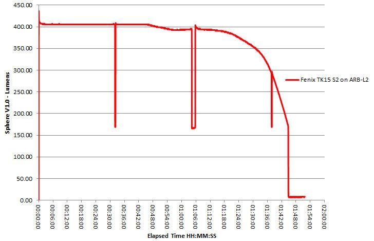

    The runtime graph was intended to capture the maximum output. This meant having to babysit the test as every 32 minutes it switches down to High and needs to be nudged back up to Turbo. After doing this, the following output trace is the result.
    After the initial drop, it stabilises at 412lm and maintains this with great consistency until after 48 minutes when this level of output cannot be maintained by the 18650 cell.
