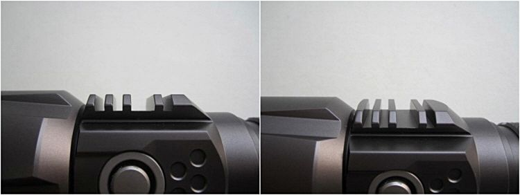

    • Integrated dual Picatinny connectors / rails provide a huge variety of mounting options

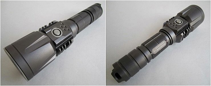

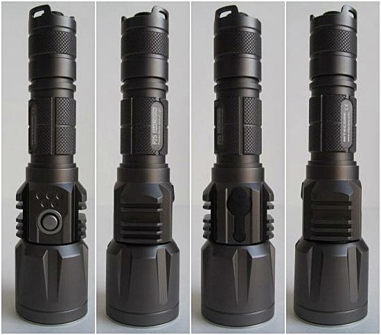

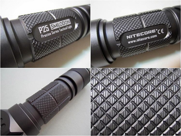

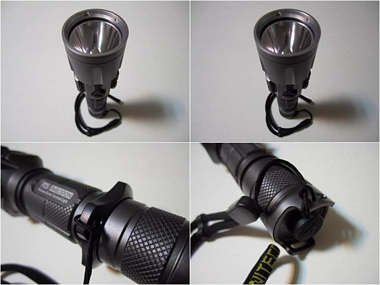

    The hard (type III) anodizing is a matt gray and consistent throughout with no chips on its surface. Anodizing is very good on my sample. All labels are sharp, clear, and bright white against the background. Knurling is present over battery tube and there is a band of knurling on tailcap. The P25 does seem much more tough appearance than others.

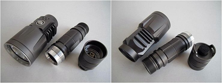

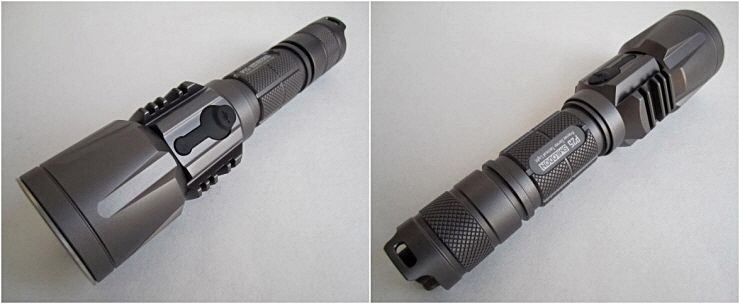

    The light has 3 parts (i.e. head, battery tube, and tailcap).

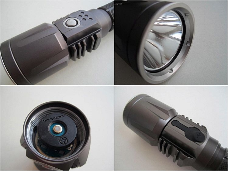

    The light has a flat stainless steel bezel ring. The head has nice looking scallops machined around the front area, and these also serve as an anti-roll feature. There are cooling fins for heat dissipation on the head. There is a spring loaded positive contact point in the head, but note that neither true flat-top 18650 cells nor large button-top 18650 cells will work in the light, due to a raised plastic ring around the positive contact point in the head. The light has mechanical reverse polarity protection to protect from improper battery installation. Only small button-top 18650 cells will work. I had to use a small magnet for my flat-top or large button-top 18650 cells to work. But cell height wasn't an issue (i.e., all my longer button-top cells worked fine).

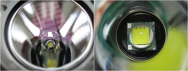

    The light uses AR coating lens and the purple hue is reflected on it. The aluminum reflector has a smooth pattern. Surface finish on the reflector was perfect from visual inspection, with very fine radial machining lines running down the reflector cup, and well-centered XM-L U2 LED sits at the bottom of the reflector cup. I think the P25 uses quite the same sized stainless steel bezel ring and reflector as MH25.

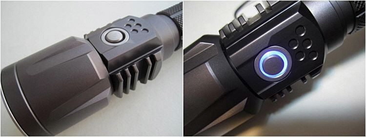

    The distinctive aspects of the light are a two-stage (two-pressure) side button switch and a built-in micro USB charging port for 18650. The side button switch projects out a little further and the ring around the switch uses a blue LED to signal the state of the light (i.e., battery power status, voltage, and standby mode). [New 13.01.18] At first I thought I might have had trouble with two-stage switch when wearing the gloves. Even though wearing thin leather gloves or thick sking gloves, I had no trouble with that switch.[New 13.01.18] The charging port is on the opposite side of the side button switch in the head, and it is protected from water and dust by a small rubber cover. I'm not sure how durable or water resistant it will be long term.

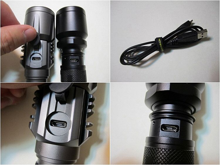

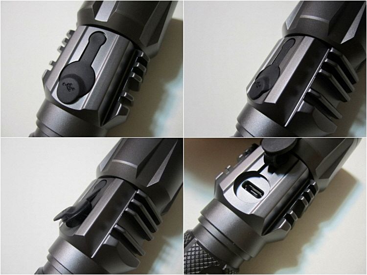

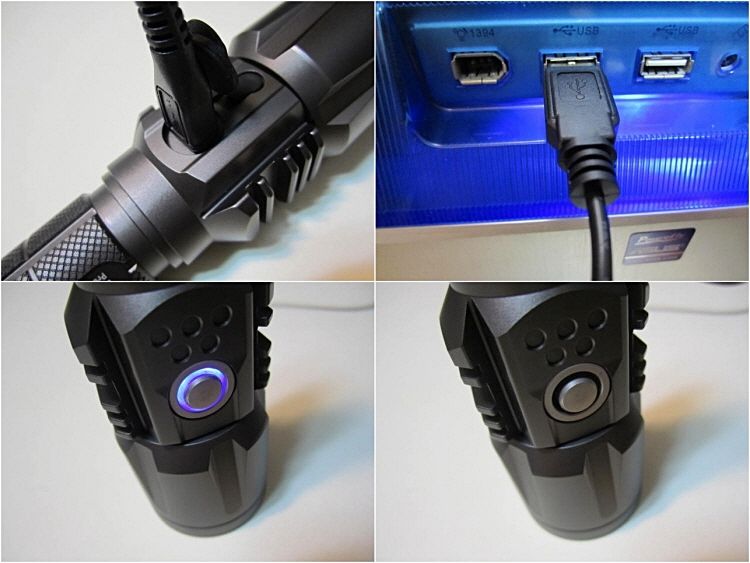

    The charging port of the P25 is quite the same as MH25. So P25 can use the same USB cable came with the MH25. The charging device came with the MH25 is a simple 1m USB charging cable with connector and standard USB plug.
    The USB cable attaches to the computer to charge 18650 cell in the light. Note the charging solution is to be used only with 18650 cell. The light needs to be turned on by clicking the tail switch on in order to enter charging mode. Nitecore informed me that the initial charging current is 400~500mAh. The light uses CC/CV charging and termination current is 10% of the charging current. You can charge an unprotected or protected 18650 cell, but (R)CR123A's are forbidden. The wall adapter or car power adapter is optional purchase.
    The blue color indicator shows you three charging status. It will blink twice every second under normal charging conditions. If there is problem during the charging process (i.e., in case battery installed incorrectly or tail switch not pressed or tailcap not screwed), the indicator will blink rapidly. When charging is complete, the indicator will show solid blue.
    The user manual estimates it will take about 6 hours to full charge the depleted cells this way. The charger terminated at a reasonable voltage on my sample (i.e., about 4.17V in my testing).

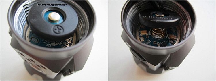

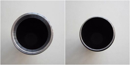

    The battery tube has a cylindrical tube design and accommodates both 2x(R)CR123A's and 18650 cells easily. Nitecore informed me the working voltage of the light is 3.3~8.4V. I measured the current with 1x18650 at tailcap on Turbo & High output as around 2.53A & 1.50A respectively. So using 2xRCR123A's on those higher outputs seems to be unreasonable, due to the high discharge ratio of the cells. The battery tube has notch on the both ends where the removable clip seems to be attached.

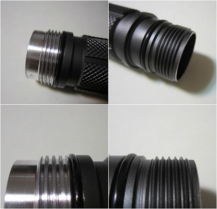

    Threads on both ends are well machined, with the those on the rear end being anodized which allows the light to be locked-out when the tail cap is slightly loosened.
    Threads on either ends on the battery tube mate well with the head and tailcap with no issues of cross-threading or grinding. The screws threads on the front are square-cut and those on the rear are traditional triangular-cut.
    The wall thickness of the battery tube is thick, and the light feel solid.

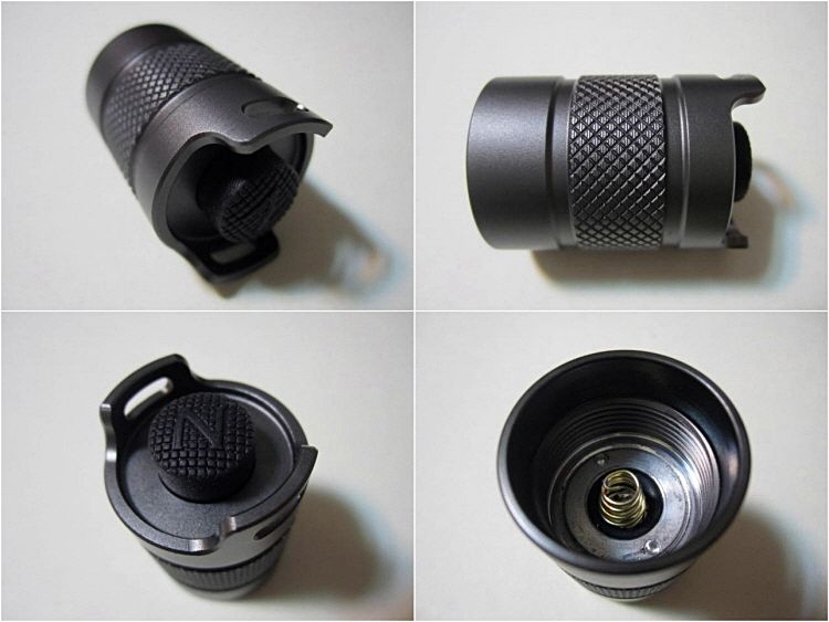

    The tailcap switch is a forward clicky. The rubber switch cap is recessed within the tail end. The switch has nice stiff tension with average travel and tactile clicking feedback. There are also a couple of wide loops for wrist lanyard attachments.
    I found the removable plastic grip ring came with the MH25 fits perfectly on P25 as well, and it will help with holding the light in a cigar style grip and also serves as an anti-roll feature. The grip ring can be fixed on the battery tube securely by screwing the tailcap, and removed without removing the O-ring on the tube. Technically, the light can tailstand, but it's rather unstable due to the small area of the tail end relative to the body size.

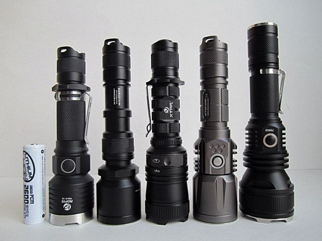

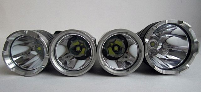

    From left to right, VicLite 18650(2600mAh) protected, Rofis TR31C, Nitecore MH25, Xtar TZ58, Nitecore P25, Crelant 7G6CS. The P25 is quite the same length as MH25.

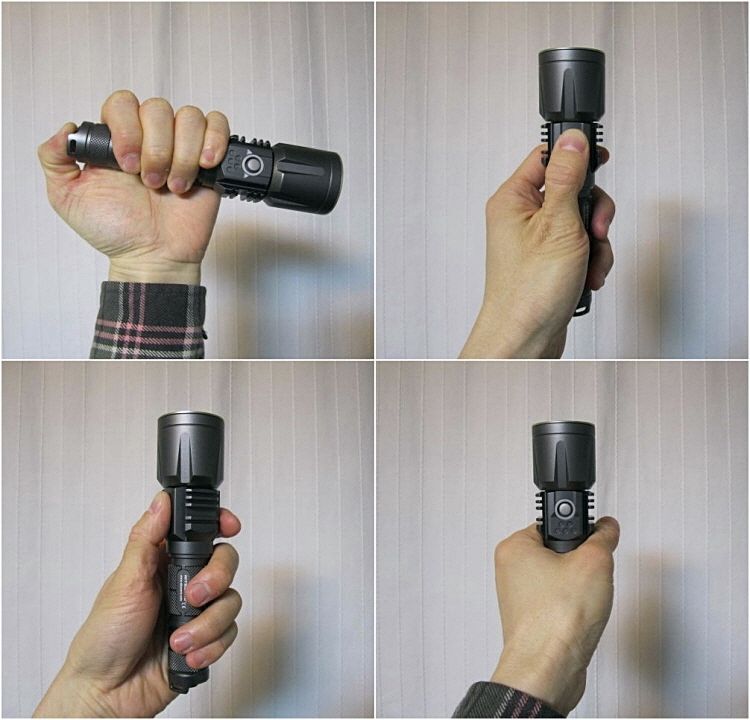

    The head size & body weight excluding battery of the following lights are as follows :
    TR31C - 39.7mm / 180g, MH25 - 40mm / 145g, P25 - 40mm / 172g, 7G6CS - 48.9mm / 217g
    It is good size to hold and can be used as an tactical light. Overall grip is fine.

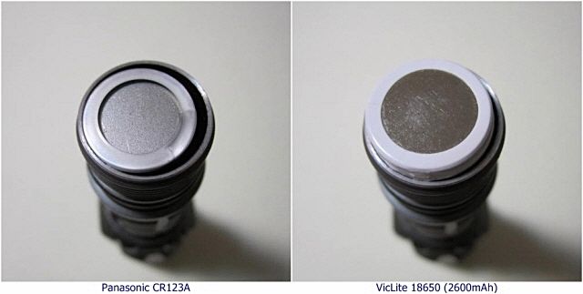

    The CR123A & 18650 fit well in the tube. As mentioned earlier, only small button-top 18650 cells will work fine. Overall build quality seems excellent.

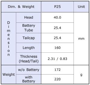

    Measured Dimensions & Weight

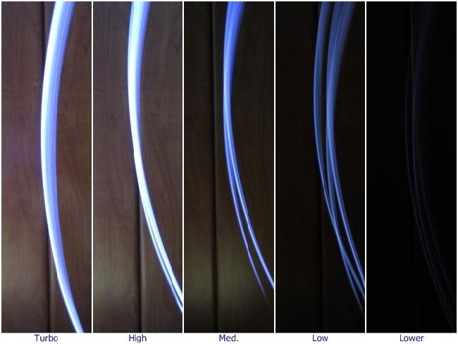

    PWM
    The P25 shows no sign of PWM at any output level as manufacturer claims. I think the light is constant current controlled. I noticet there is no buzzing sound at any levels.

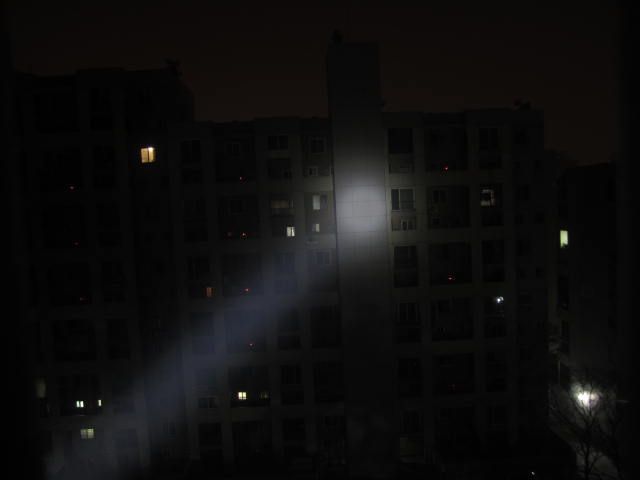

    Beamshot
    1. White door beamshot
    - ISO100, F/3.5, 1/320sec, Auto white balance
    - ISO100, F/3.5, 1/500sec, Auto white balance
    - ISO100, F/3.5, 1/1250sec, Auto white balance

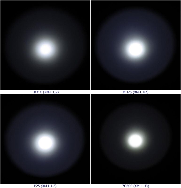

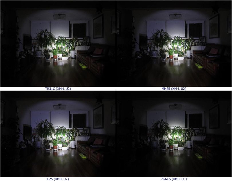

    The light has a middle sized bright hot spot. The hotspot is very well focused, perfectly circular with a defined edge. A soft corona surrounds the hotspot which makes the hotspot seems slightly wider than it actually is. The spill beam region is relatively dim compared to the hot spot, but is clean with no artifacts. The beam has a cool side. (Overall beam profile seems to be identical to MH25.)

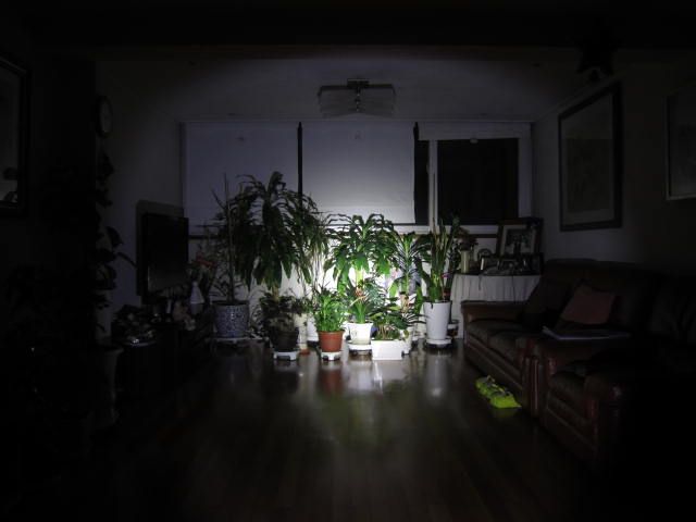

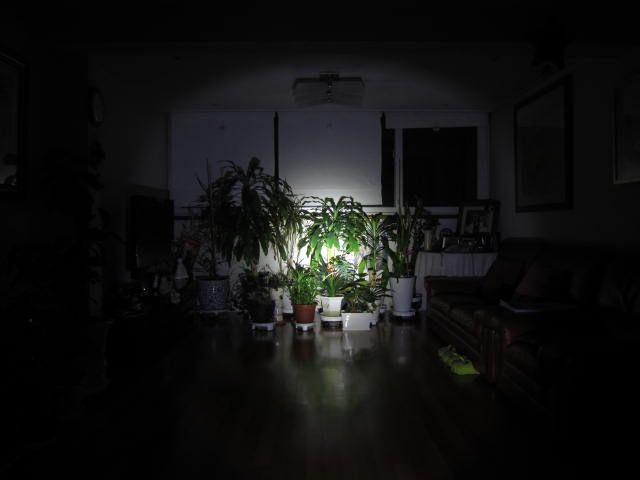

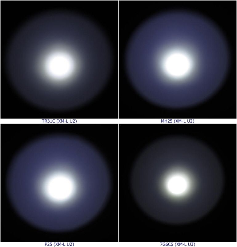

    2. Indoor beamshot (about 7m from the target)
    - ISO100, F/2.8, 1/5sec, Auto white balance
    - Control Shot
    - TR31C (XM-L U2)
    - MH25 (XM-L U2)
    - P25 (XM-L U2)
    - 7G6CS (XM-L U3)

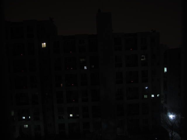

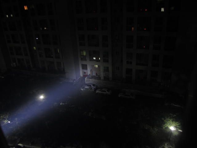

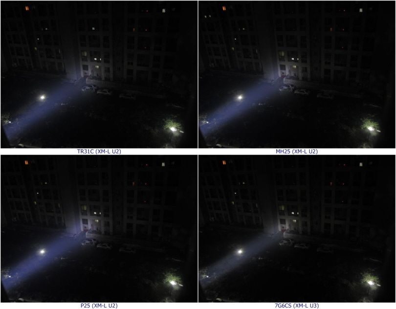

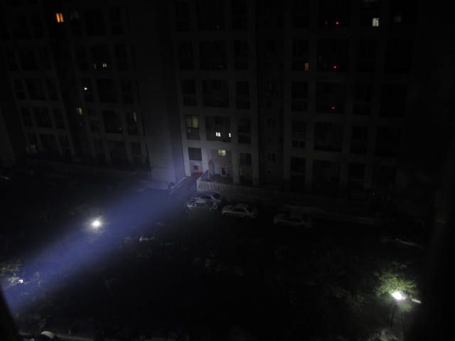

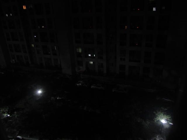

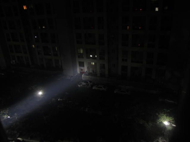

    3. 55m Outdoor Beamshot
    - ISO100, F/2.8, 1sec, Auto white balance
    - Control Shot
    -TR31C (XM-L U2)
    - MH25 (XM-L U2)
    -P25 (XM-L U2)
    - 7G6CS (XM-L U3)

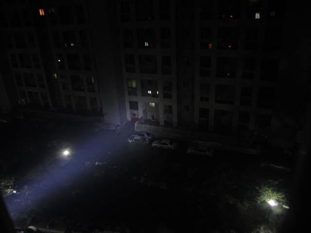

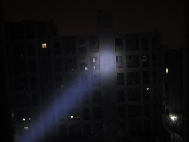

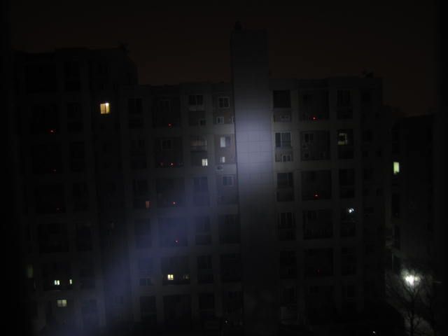

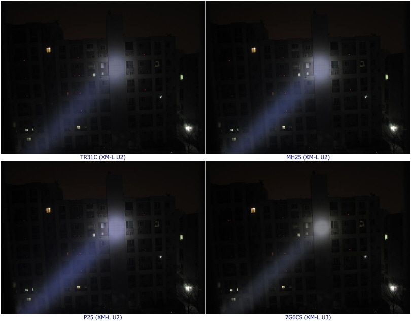

    4. 60~65m Outdoor Beamshot
    -Control Shot
    - TR31C (XM-L U2)
    - MH25 (XM-L U2)
    - P25 (XM-L U2)
    - 7G6CS (XM-L U3)

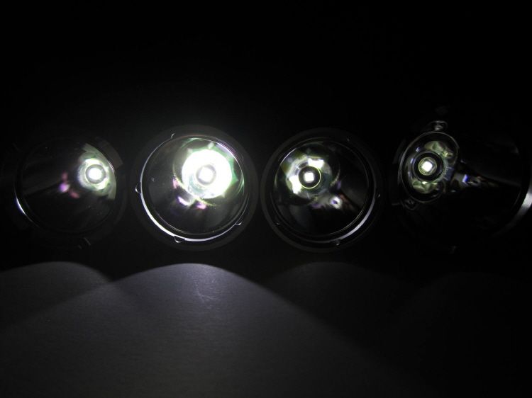

    [New 13.01.17]

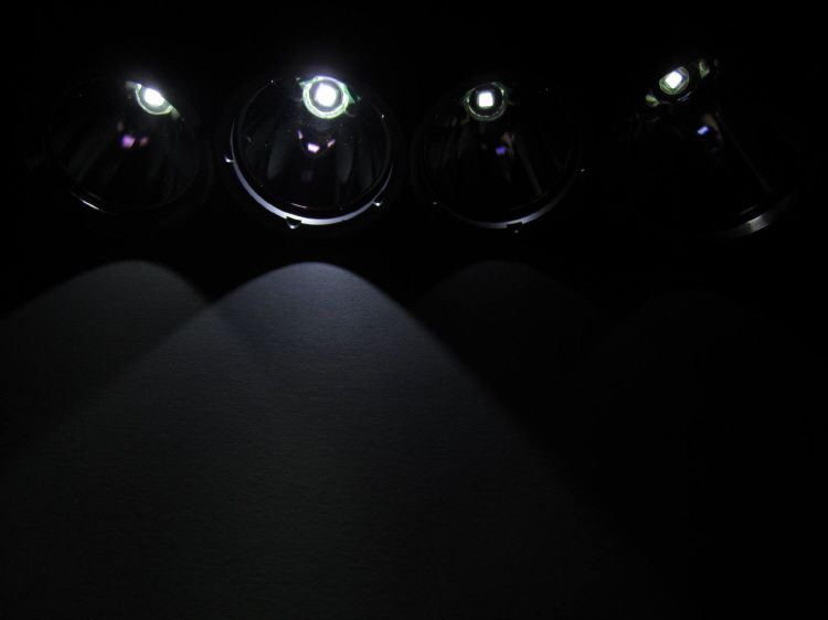

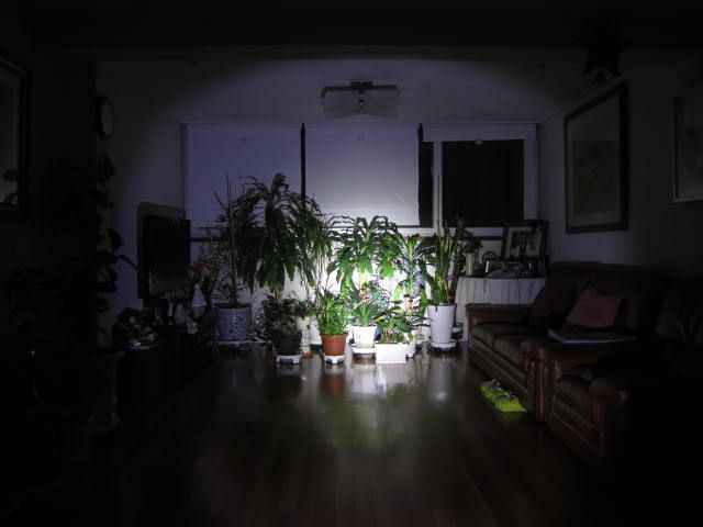

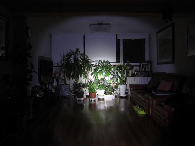

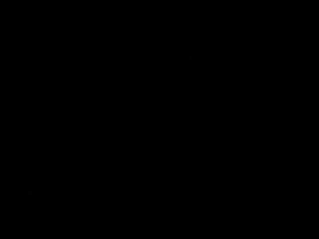

    5. Min. Brightness Level
    - ISO100, F/2.8, 1/500sec, Auto white balance
    - Left to right, TR31C, MH25, P25, 7G6CS

    what's this? crappy regulation plus 2-stage stepdown???
    Default Re: Nitecore P25 "Smilodon" [ XM-L U2, 1x18650, 2xCR123A ] Review
    Rofis has the best tint, superior.
    And the P25 has a donut hole.
    Nice.

    rofis doesn't make LEDs though... it's unfair to judge based on tint from a brand imo

    The P25 has no donut hole. It shows a soft corona surrounds the hotspot, and has a nice beam profile with a deep and smooth reflector though.
    Quote Originally Posted by roadkill1109 View Post
    Just a minor correction, the Crelant you used there is a 7G6CS not a 7G3CS
    That's a good point. Corrected TYPO. Thanks. roadkill1109!
    Looks like the Crelant has the highest lux among the lights, well, figures, it has the biggest head.
    Actually 7G6CS doesn't have the highest output on 1x18650, while it comes close to others on 2x(R)CR123A's.
    P.S. : If you mean "peak throw", that's correct.

    Added [New 13.01.17]
    For my taste it is too fancy....all that ribs, holes and other aunnecessary forms....
    and on the other hand it does`t even has potted electronics....??
    Where is the world of flashlights going to.....?

    Quote Originally Posted by jezdec View Post
    They look cool and functional. What's the potted electronics?
    Well, I don't know. We will have to see.

    I think I would have preferred no tail switch for a shorter length. But I understand this is meant to be gun mountable. Also I would have preferred less throw and more flood. But again...not the design intent. Still...it is a feature full light. How much would something like this cost from Surefire? Quality seems to be there...have to see how durable and dependable the camera button is, time will tell....
    Yes, P25 is more throw & less flood, and looks something like a full-featured (gun-mountable, with built-in charger, two-stage side button, high-output, good quality) light.
    The side button switch is reliable & dependable for use. As you said, time will tell..... for durability.

    I bought a P25 already . But that lossless reflector of TK22 is appealing. Tr31c would be redundant then

    good review I like your beam shot comparison part. a photo tells a thousand story tyvm
    I think you should get all.
    Quote Originally Posted by holylight View Post
    Thanks. holylight! I'll take a good photo.

    Is anybody else having charging connector issues with their Smilodon? I can never get the charger plug to seat properly against the charging port.
