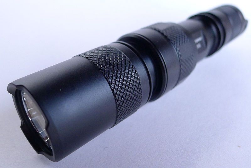

    Initial Impressions:

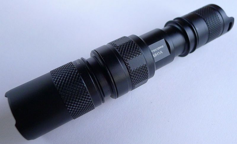

    With the added lumps and bumps in the body of the light, the MH1A does look a bit strange and does take a little getting used to.
    For a 1xAA light, the MH1A is a bit longer and wider than most, mainly due to the inbuilt charger and its cover, however, the MH1A also has a head the size of many CR123 lights. As it incorporates a relatively large surface area emitter, the XM-L U2, this larger head allows for a bigger reflector. The head size may be due to be some component sharing with the other MH series lights (but I don’t have any others to compare it with).
    Overall it does appear lumpy and bumpy although each change in profile has a definite function. One useful consequence of the body shaping is that it makes it easy to use various grips all of which feel totally secure.

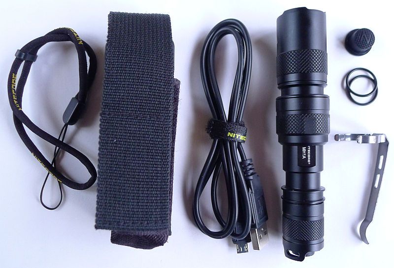

    Included are the MH1A, belt holster, pocket clip, lanyard, USB charging cable, instructions, spare switch boot and two spare o-rings.

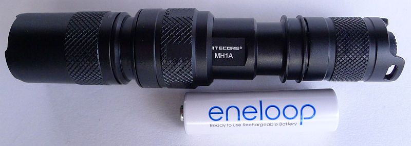

    As we’ve mentioned the added bulk of the built in charger, here is the MH1A with a standard AA battery so you can see how the MH1A sizes up.

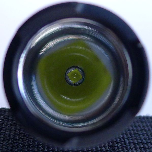

    Looking straight into the lens, the MH1A’s reflector is fitted right up to the XM-L U2’s dome. One of the tightest reflector fittings I’ve seen. This should mean that the maximum possible control over the beam pattern, and gives little room for anything other than excellent LED centring.
    The reflector is deeper than it is wide, and flawless. The colour of the reflected light on the lens shows the anti-reflective coating that is used to minimise losses.

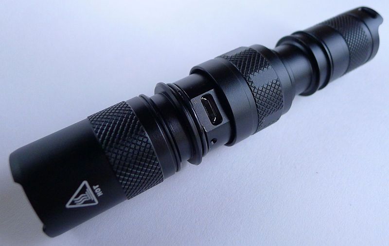

    To reveal the charging port, the port cover is unscrewed until it is able to slide down….
    …as shown here.

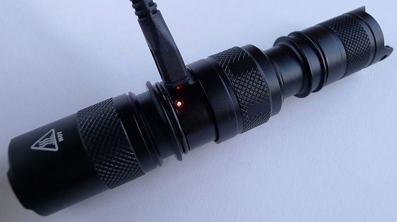

    With the micro-USB cable plugged in a charger indicator light is visible next to the USB socket (more on this later).

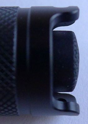

    Looking side on, you can see that the tail-cap design does allow for tail standing, however, this is not very stable as the light is top heavy.

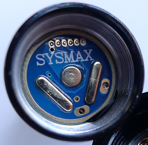

    The head contacts show the physical reverse polarity protection designed into the contacts.

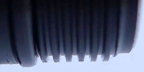

    The battery tube threads at the head of the light are bare aluminium and near-square cut threads. These are very cleanly cut and ultra-smooth in operation.
    The tail-cap threads are fully anodised and more trapezoid in form.

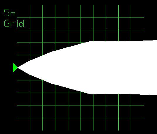

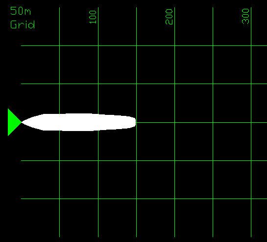

    NEW for Winter 2012 ANSI standards include maximum beam range. This is the distance at which the intensity of light from an emitter falls to 0.25lux (roughly the same as the lux from a full moon). This standard refers only to the peak beam range (a one dimensional quantity), so I am expanding on this and applying the same methodology across the entire width of the beam. From this data it is possible to plot a two-dimensional ‘beam range profile’ diagram which represents the shape of the illuminated area.
    In order to accurately capture this information a test rig was constructed which allows a lux meter to be positioned 1m from the lens and a series of readings to be taken at various angles out from the centre line of the beam. As the rig defines a quadrant of a circle with a radius of 1m, all the readings are taken 1m from the lens, so measuring the true spherical light intensity. The rig was designed to minimise its influence on the readings with baffles added to shield the lux meter from possible reflections off the support members.
    The distance of 1m was chosen as at this distance 1lux = 1 candela and the maximum beam range is then calculated as the SQRT(Candela/0.25) for each angle of emission.
    In this plot, the calculated ANSI beam ranges are plotted as if viewed from above (for some lights there may also be a side view produced) using a CAD package to give the precise 'shape' of the beam.
    The MH1A’s beam profile one of the smoothest I’ve seen. And the beam shot photos also confirm this. There is a soft hotspot, but the spread of light has an gentle transition with no spikes moving from hotspot into the spill.
    The complete beam range profile is very smooth and well-shaped for an EDC size light.

    Following a few comments I've received regarding the safety aspects of the charger, in the interests of science and safety, I've just tried this.
    The MH1A's charging light has four possible indications:
    Steady on - Fully charged
    Flashing 2 times per second - Charging normally
    Flashing rapidly - Problem, not charging (maybe the tail-cap switch is not 'on')
    OFF - no USB input or not charging.
    So I popped in an old Ni-Mh which powered the MH1A perfectly well.
    Connected the USB lead (charging light rapidly flashing) and switched on the tail-cap, at which point the charging light went off.
    So it looks like the MH1A's charger does protect from users trying to charge Ni-Mh.
    Just to make sure I hadn't blown the charger circuit, I popped in a partially used 14500 and charged this normally.
    I have also just confirmed that it will reset a protected 14500 if the protection has kicked in. (I just ran a 14500 down until the protection stayed on and the battery read 0V and then plugged in the charger. It charged normally.)
