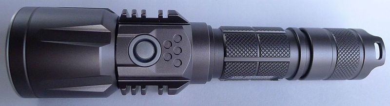

    The colour of the anodizing, incorporated Picatinny rails/heat-sink fins and two-stage switch with blue illumination, all give the P25 a futuristic look.
    Amongst my work colleagues it has elicited a great deal of interest in, what has been described as, ‘a light sabre’ and ‘something out of Star Trek’.
    Fit and finish is amongst the best I’ve seen with rich anodising in a grey/green/brown shade. It handles so well, with the side switch making it comfortable to operate and giving you access to all the main features.

    The P25 is a little longer than some single 18650 lights due to the side switch/USB charger section between the head and battery tube. This extra length makes it possible to take a very firm tactical grip and not end up pressing the side switch accidentally. It also makes it work ergonomically allowing your thumb to rest over the switch naturally.

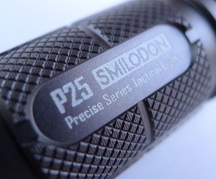

    The model’s designation and name are laser etched into the flat areas on each side of the battery tube.

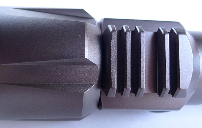

    Either side of the switch section, there are heat-sink fins which also form a Picatinny rail which allows for various ‘tactical’ configurations when gun mounted.

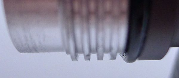

    The tail-cap’s standard threads are fully anodized.

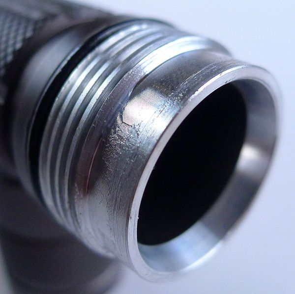

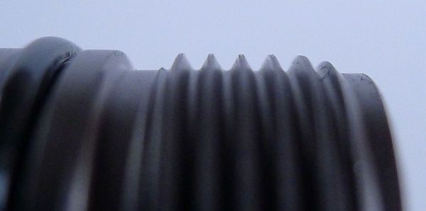

    The threads at the head end of the battery tube are near-square cut and bare aluminium.
    The battery tube wall thickness appears substantial, but further along the tube the thickness is machined down.

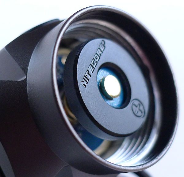

    Inside the head is an unusual ‘feature’ positive terminal, with physical reverse polarity protection. This requires a button top cell to work. Flat top cells will not work in the P25. The clever part about this terminal design is that the positive terminal is still sprung (so being good for shock protection) but still has the physical reverse polarity protection thanks to the contact disk being mounted on the end of the spring.

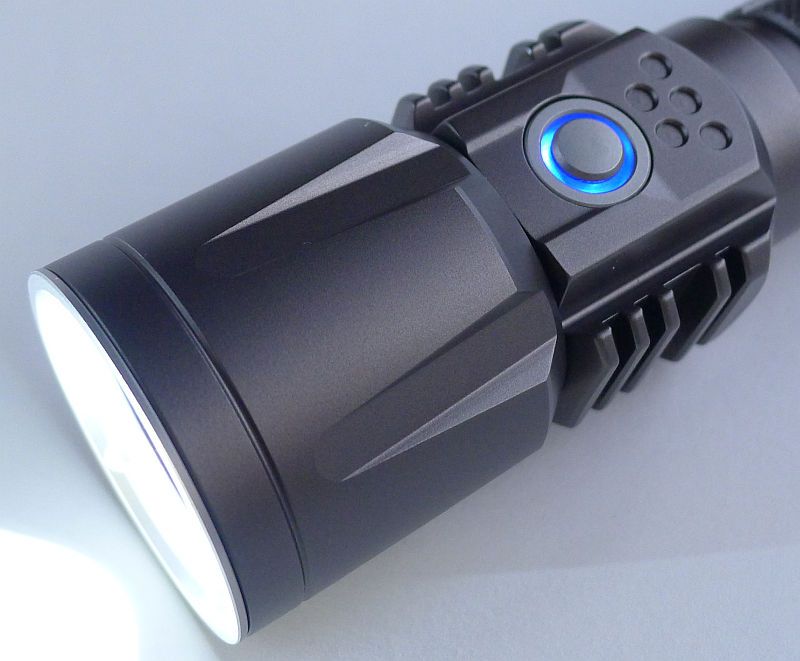

    Visible as a ring of light around the side switch button, the P25 has a blue indicator light showing various statuses.
    Here one of the low battery flashes has been captured while the P25 is on.

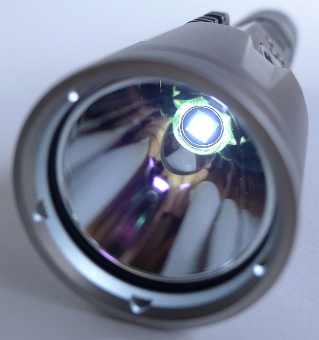

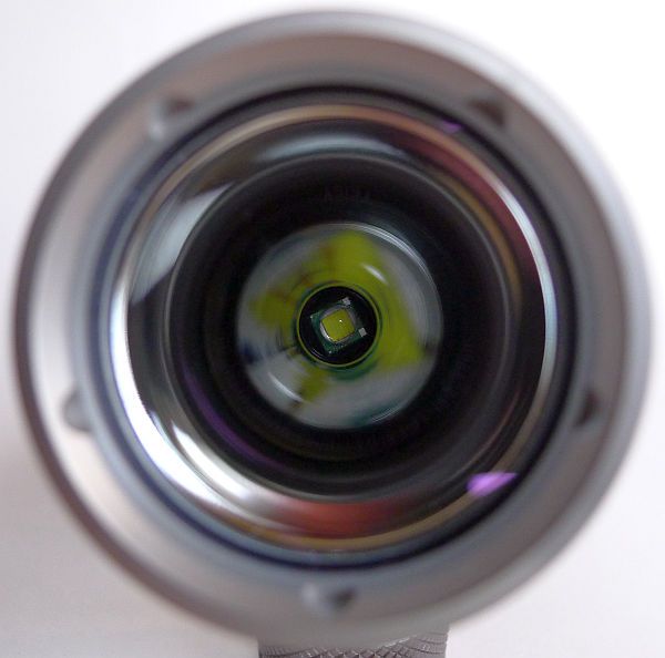

    The P25 is fitted with an XM-L U2 LED and smooth reflector.

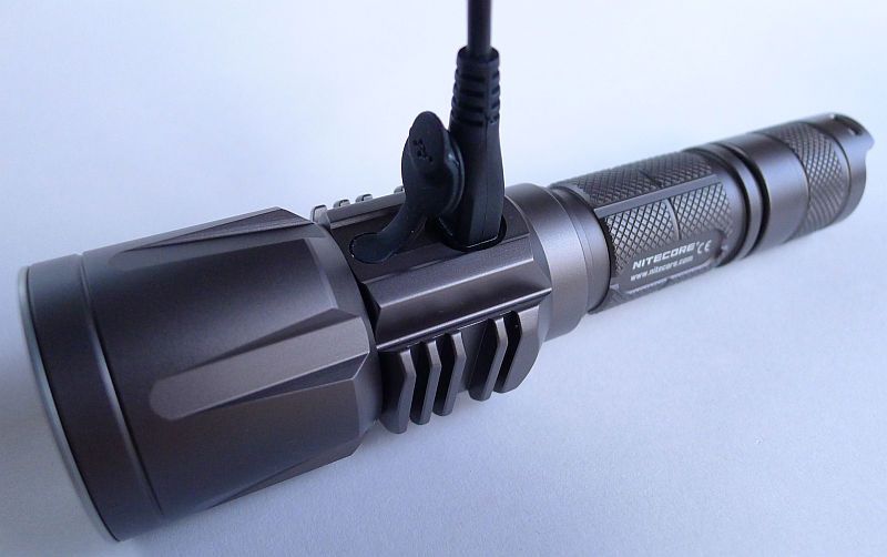

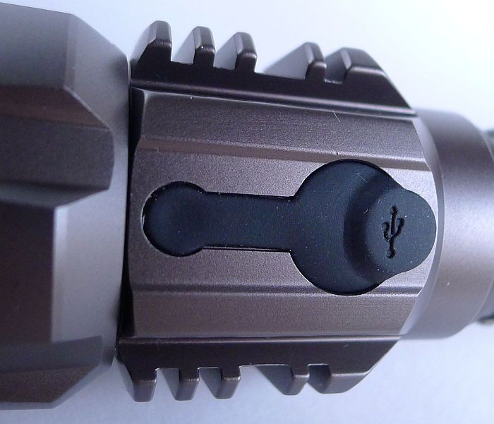

    To protect the built in charger port, there is a well-fitting rubber cover. The tab to open it is close fitting to the body.
    The Micro-USB charging port revealed…
    …and the USB cable plugged in.

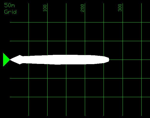

    NEW for Winter 2012 ANSI standards include maximum beam range. This is the distance at which the intensity of light from an emitter falls to 0.25lux (roughly the same as the lux from a full moon). This standard refers only to the peak beam range (a one dimensional quantity), so I am expanding on this and applying the same methodology across the entire width of the beam. From this data it is possible to plot a two-dimensional ‘beam range profile’ diagram which represents the shape of the illuminated area.
    In order to accurately capture this information a test rig was constructed which allows a lux meter to be positioned 1m from the lens and a series of readings to be taken at various angles out from the centre line of the beam. As the rig defines a quadrant of a circle with a radius of 1m, all the readings are taken 1m from the lens, so measuring the true spherical light intensity. The rig was designed to minimise its influence on the readings with baffles added to shield the lux meter from possible reflections off the support members.
    The distance of 1m was chosen as at this distance 1lux = 1 candela and the maximum beam range is then calculated as the SQRT(Candela/0.25) for each angle of emission.

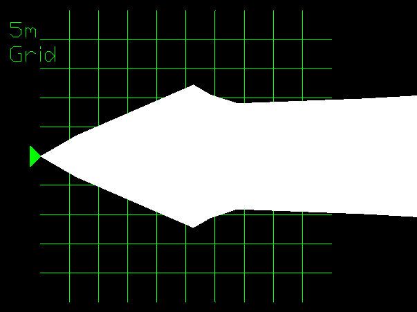

    In this plot, the calculated ANSI beam ranges are plotted as if viewed from above (for some lights there may also be a side view produced) using a CAD package to give the precise 'shape' of the beam.
    With its large smooth reflector, the P25’s beam is more of a thrower so the spill is quite narrow and not that bright.
    Zooming out to the 5om grid shows the full extent and shape of the beam’s range.

    Although the rubber charger-port cover is very low profile, this has been catching on the holster I have been using (the sample did not include the P25’s proper holster). The rubber itself is quite grippy, which is why is has ‘rolled up’ when being pushed into with the holster. As this will compromise the waterproofing you need to be aware that the rubber cover can catch and come loose. This may not happen with the NITECORE holster, but I don’t have one to check it with.
    Having the built-in charger more than makes up for having to check the port cover. You can top up the battery using any Micro-USB charging cable from a mains adapter, car charger, or computer port.
