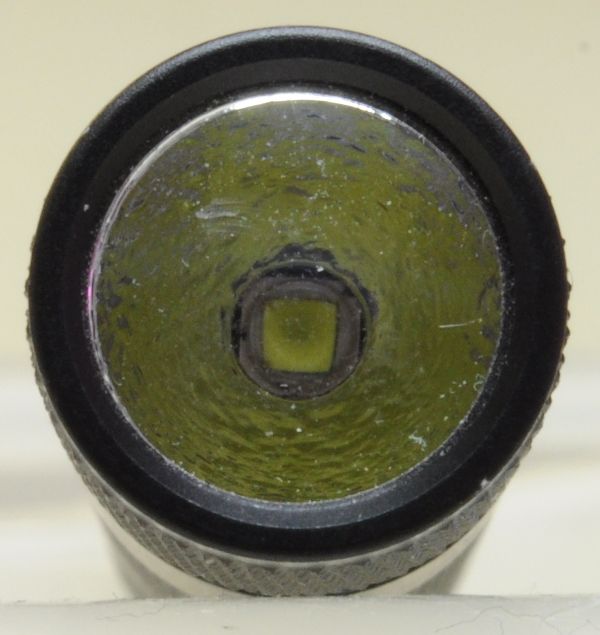

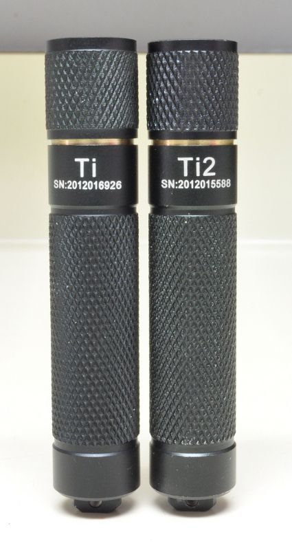

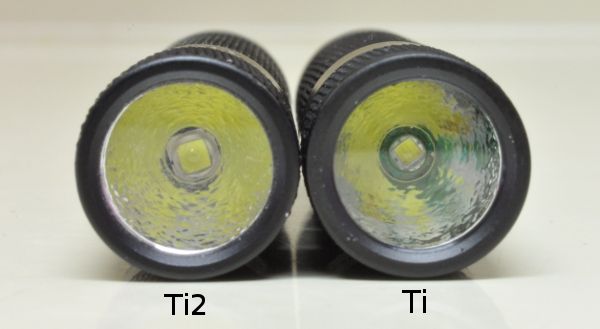

    Upon receiving the Ti2 I compared the boxes & bodies of the Ti & Ti2. The bodies are identical, the only visible difference is the emitter. The 3-60 lumen Ti uses the Cree XP-E R4, while the 3-81 lumen Ti2 uses the XP-G2. While both emitters are the same size according to specs (3.45mm x 3.45mm), the die in the Ti2 appears larger than that of the Ti. One interesting note is that Thrunite chose to use stickers on the Ti2 boxes to distinguish between the Ti and Ti2 models. However, they neglected to change the max lumen rating on the Ti2 box to the 81 lumens shown on their website. When compared side by side against a wall about 8 feet away, the beam of the Ti is noticeably tighter and thus appears slightly brighter than that of the Ti2 (both in low and high modes). The Ti2 provides more flood than the Ti, which makes me theorize that the Ti is actually a better thrower than the Ti2. I have no way of testing to confirm this. Knowing this it's difficult to say which I would prefer to have on my key chain.

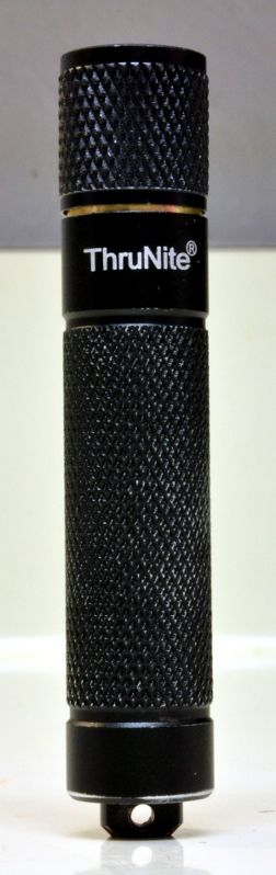

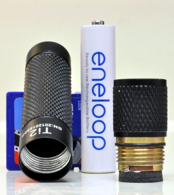

    The packaging of the Ti2 is simple and essentially identical to the Ti except for the sticker mentioned earlier. It comes with a short manual, two spare O-rings and a keyring. The design of the Ti2 is nice, it's obvious this is meant to be a simple, small key chain light and I believe it serves that purpose rather well. The knurling isn't aggressive or rough, so when the light gets wet it is a little slippery. It won't go flying out of your hand like a bar of soap, but it certainly isn't designed to be a pocket light for water sports. I can see its diminutive size being a problem if one attempts to keep it in a large bag, so securing it via a lanyard or the keyring is definitely recommended. I like the size and shape of the integral keyring / lanyard hole. It's large enough to feel secure, but not so big that getting it onto a keyring is difficult. It's also just the right size to allow the light to tail stand, but if the surface is uneven or gets bumped, the light is likely to fall over. The finish on my light has worn a little over the six weeks it's been on my keyring. I have a lot of keys, and they get banged around on a daily basis, so this doesn't surprise me. I imagine after six to twelve months it will look like a beat up old MagLite. So long as it still functions, I couldn't care less. The printing on the light is clear and bright, giving it the appearance of a precision tool instead of a cheap toy.

    I have a couple Ti lights and one has a more focused hot spot. This Ti appears to slightly outhrow my Ti2, but it's really difficult to notice. As TEEJ noted, on a 10440, my Ti2 is a monster, significantly brighter than the Ti when both are running 10440s.
