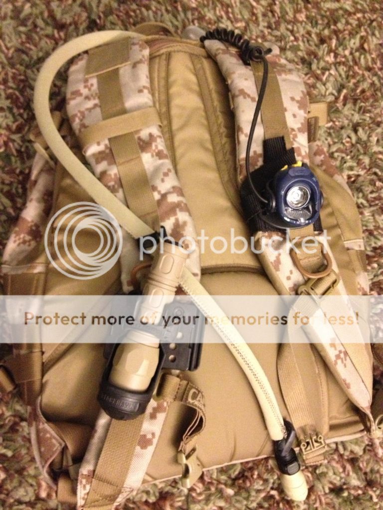

    Personally
    I have the 3AA Petzl Myo XP that I custom strapped to my backpack shoulder strap for another hands free lighting option.
    I use the Night-Ops Gladius holster with a Surefire G2x Pro-D-Tan also mounted to the shoulder strap
    I carry the Nao in my pack for when I am in a true handsfree situation, like climbing or balancing on a log over a stream, etc.
    And a Princeton tec Strobe on top of the pack for visibility.
    Aside from that I like to take different lights to test out in the wilderness to see how they hold up. I'll throw them down in the water, snow, dirt etc.
    I'm planning a snow hike this weekend since its forecasted to snow here Thur-Friday. I'm taking up the Fenix PD32 UE to abuse the heck out of it to see if. Can get it to fail.
    For me, having 2 handsfree options are a MUST have since I frequently climb boulders, rocks, navigate over or through streams, etc. I can't just have a handheld light option. That being said, I do take a few handheld lights with me. I usually take one with good output and one with good runtime (5 hour+ minimum). I'm interested to see how the Fenix PD32UE will fit in since it's 740 Lumens all the way down to 9 Lumens.
    What I usually do is make a list of must have features like say 5 hour runtime, 100 lumens+, etc. Then I'll go to an REI or Bass Pro Shops and check out all the options there. And research YouTube reviews, internet reviews, etc. to come up with lights that fit my wants and needs.
    I think what it comes down to is just doing massive research and picking lights that you like. There is no definitive answer to what flashlights are good for Geocaching or hiking, etc. What one person likes, another may not and vice versa.
