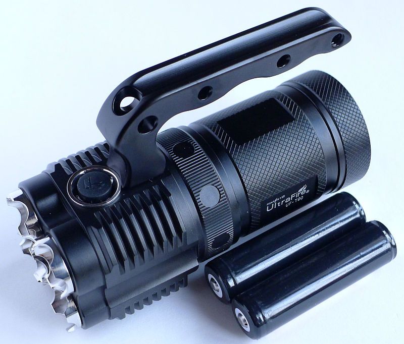

    The box was smaller than I expected, and opening the box revealed a nice compact light. The handle adds quite a lot of bulk, but this is relative, as the overall light is nice and compact. The handling is much improved with the handle, so although it adds to the overall size it is worth keeping. If you really need to, the handle can be removed easily using a screwdriver.

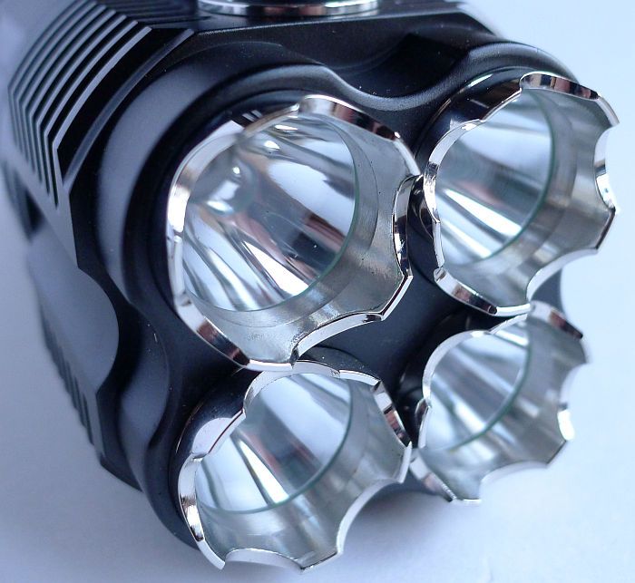

    The ‘attack’ bezel around each of the four reflectors might seem a little aggressive, but it is nicely finished with no actual sharp corners, so it is not actually abrasive. It does give good protection to the lenses, especially if you place the light on a surface bezel down. There is plenty of clearance from the surface you put it on to show the light is on, so you won’t forget it is running.

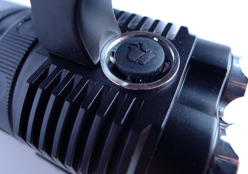

    Placement of the main switch is a little awkward as it is so tight to the handle. With the handle fitted, one handed operation is not easy.

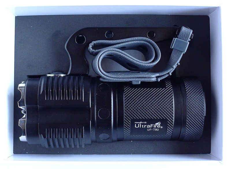

    A cut-out of closed cell padding holds the light securely.

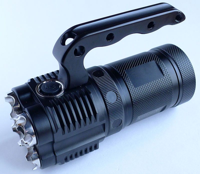

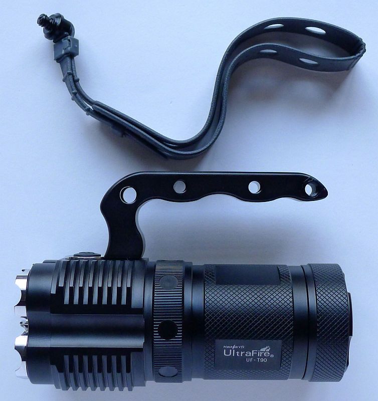

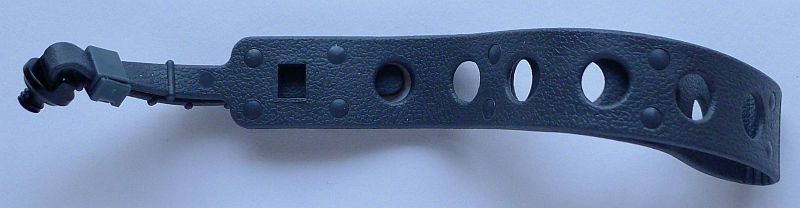

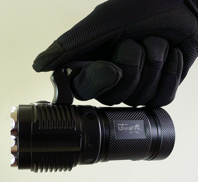

    The UF-T90 with handle attached and rubberised flat wrist strap. The strap screws either into the end of the handle, or if the handle is removed, it can fit into the screw hole for the handle fixing screw.

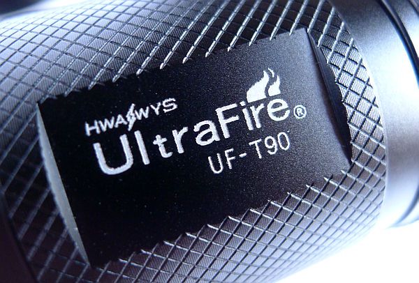

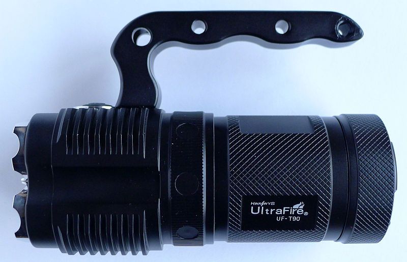

    The brand and model are laser etched into the anodised surface.
    The wrist strap provided has a metal screw to fix it to the UF-T90.
    Looking side-on, the handle’s three finger indents are visible. On the far right of the handle you can see the grease surrounding the lanyard attachment threaded hole. (the grease is from an o-ring that was meant to sit between the screw and the handle. This o-ring split the second time I fitted the lanyard)

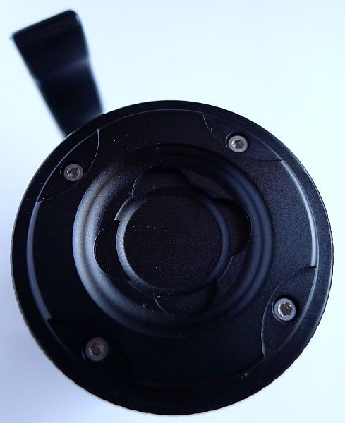

    The tail has four screws which secure the contact board inside the light.
    The power switch and heat-sink fins.

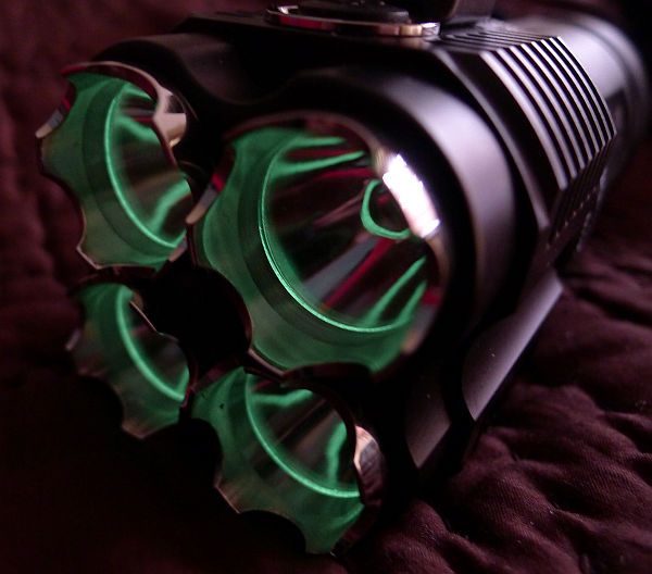

    The deeply scalloped stainless bezels. All edges are smoothed off so there are no sharp corners to abrade your pocket or any pouch you might carry it in.

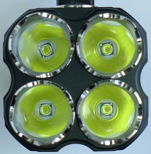

    The XM-L U2 LEDs

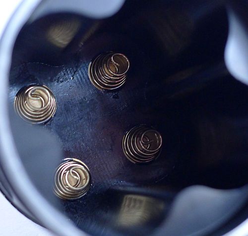

    At the base of the battery tube are the negative contact springs which give an ample leeway for cell length.
    The battery tube has shaping which holds the 4 x x18650 cells in place. It also allows for two cells to be paced in adjacent positions and held securely enough to assemble and use the light. (one cell on its own will slide out of place)

    When you switch off the UF-T90 off you are presented with a green afterglow courtesy of the GITD o-rings used to seal the lenses.

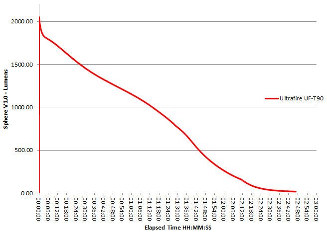

    The runtime graph was intended to capture the maximum output; the following output trace is the result.

    The handle of the UF-T90 is very comfortable to hold and makes long term use easy. The only complaint being the positioning of the power switch, however unless this were moved to the handle itself, the ergonomics of this couldn’t really be improved.

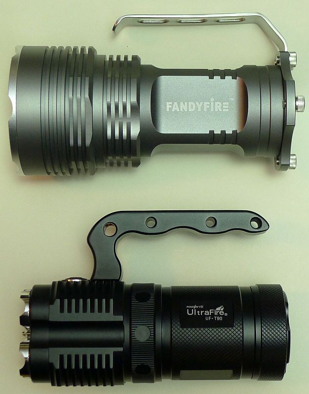

    Shown here next to a couple of protected 18650s, the compact form of the UF-T90 can be appreciated.

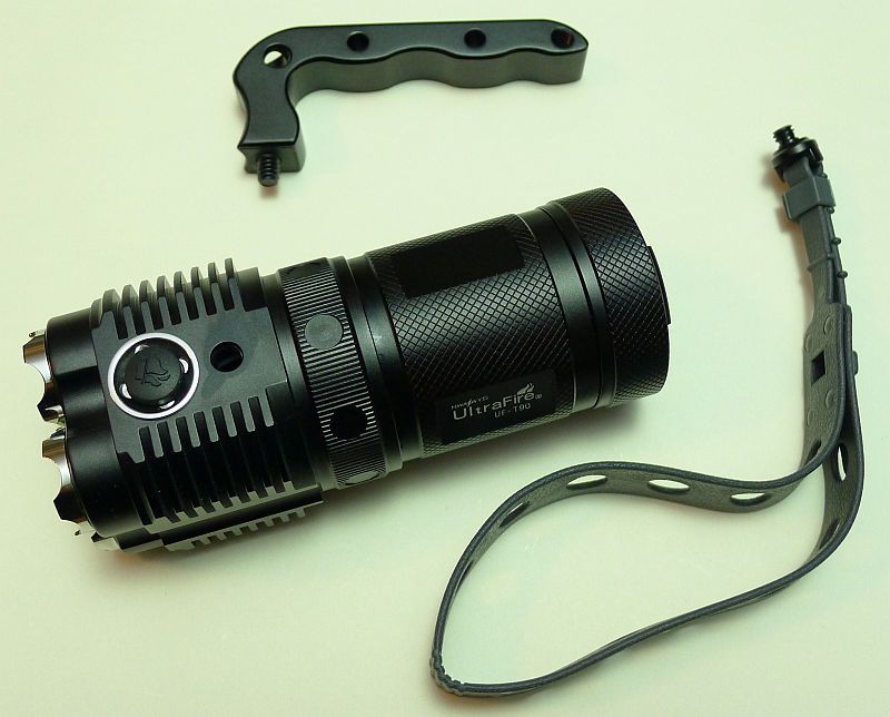

    It becomes even more compact with the handle removed. Unfortunately if you fit the lanyard screw into the hole left by removing the handle, it does interfere with the easy operation of the power switch.
    Putting it next to the FandyFire Raging, the UF-T90 has a much smaller profile, with a considerable more compact head.

    Due to the body design, there is no simple way to include a DMM for current reading drawn from all four cells so I won't be doing that.
    All my runtimes are carried out with active cooling unless stated otherwise. This light was tested with cooling.
    Putting a light into a clamp and leaving it sitting still in static air running at maximum is a very unrealistic test as far as heat goes. Even holding in your hand, your hand will act to cool the light. This is why (unless stated otherwise) cooling is always used for these tests.
    The gradual decline in output is a combination of getting to the point of thermal equilibrium and then the fact that there is no regulation at all in this light.
