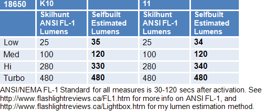

    • Output/Runtime: Turbo 480lm/2hrs, High 280lm/3.5hrs, Med 100lm/10hrs, Low 25lm/40hrs

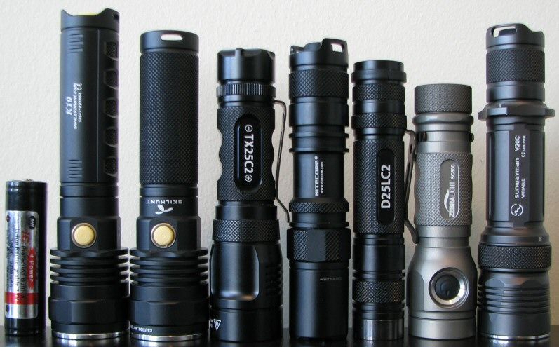

    From left to right: AW Protected 18650; Skilhunt K10, K11; Eagletac TX25C2; Nitecore MH25; Eagletac D25LC2; Zebralight SC600; Sunwayman V20C.
    Skilhunt K10: Weight: 122.8g, Length: 140.4mm, Width (bezel): 34.1mm
    Skilhunt K11: Weight: 120.5g, Length: 129.6mm , Width (bezel): 34.1mm
    Eagletac D25LC2: Weight: 50.0g, Length: 116.3mm, Width (bezel): 22.5mm
    Foursevens Quark Q123-2 X (Regular tailcap): Weight: 44.6g, Length: 112.7mm, Width (bezel) 22.0mm
    Jetbeam PC20: Weight: 60.0g, Length: 127.5mm, Width (bezel): 22.6mm
    Olight S20: Weight: 51.8g, Length: 105.4mm, Width (bezel): 23.1mm
    Sunwayman C20C: Weight 57.6g, Length: 104.8mm. Width (bezel): 25.6mm
    Thrunite TN10: Weight: 154.7g, Length: 145.5mm, Width (bezel): 35.1mm
    Zebralight SC600: Weight 87.2g, Length: 107.8mm, Width (bezel) 29.7mm

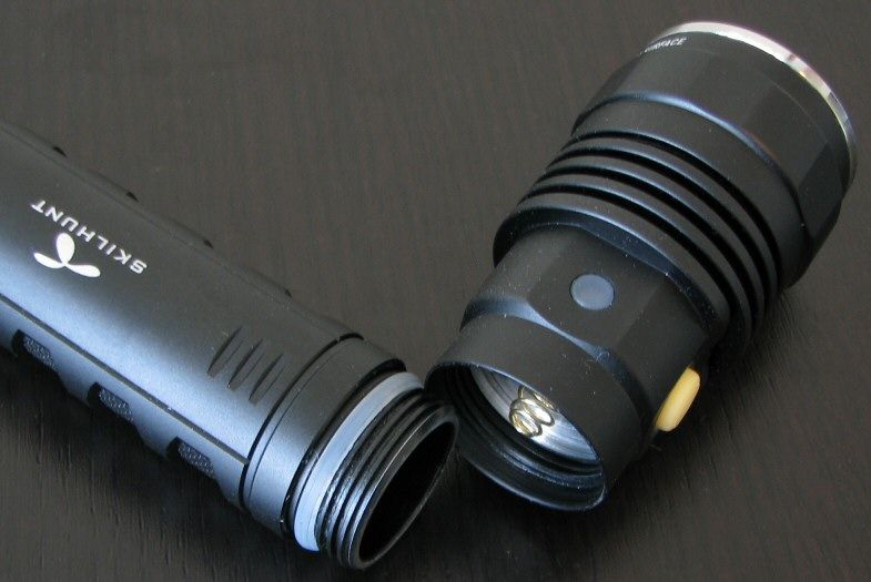

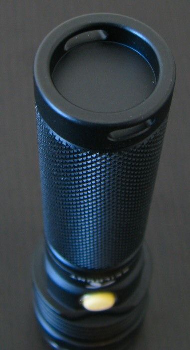

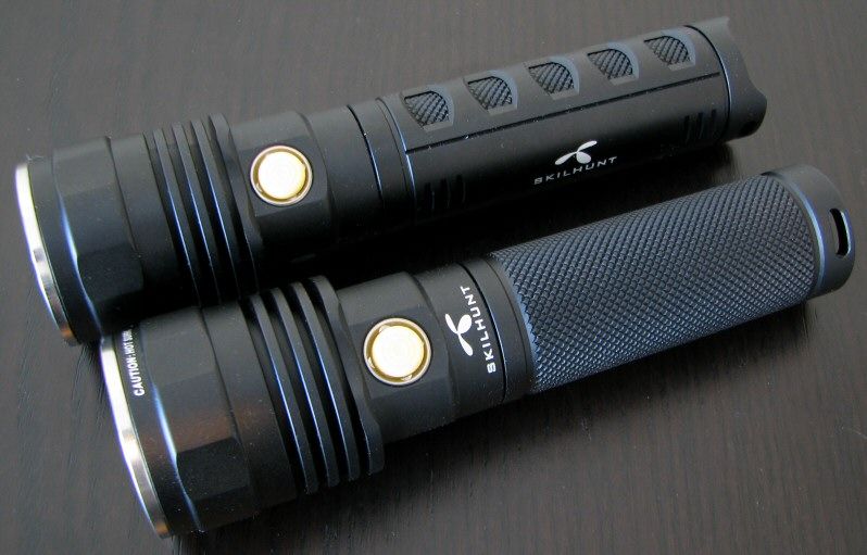

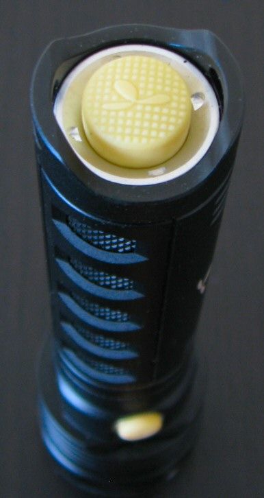

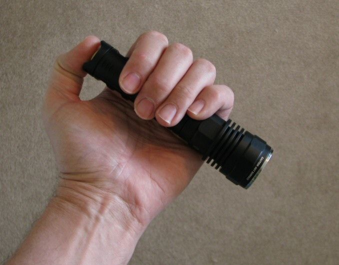

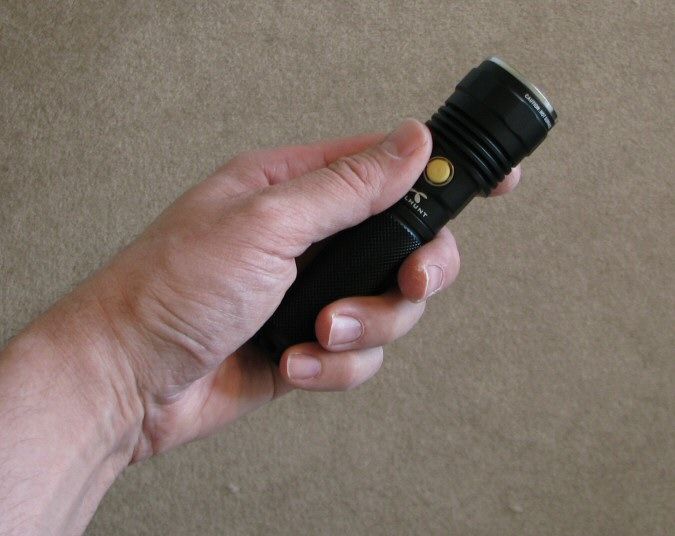

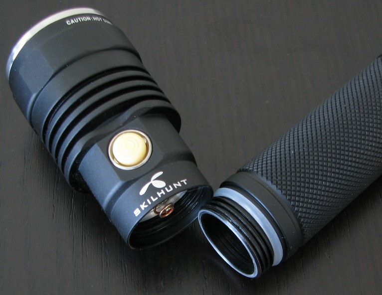

    Physically, the K10 and K11 have very similar looking heads – where the two models diverge is in the battery/body tube and tail. As always with Skilhunt, overall styling is distinctive – particularly on the K10.
    On both lights, anodizing is a flat black – and in excellent shape on my samples. The K10 has little knurling, but features a distinctive hollow core with cut-outs along the battery handle (i.e., the exterior rotates around the stationary core). I imagine this rotation is mainly for the bling effect but the cut-outs do help with grip. In contrast, the K11 has a generous amount of knurling all over the body tube, of typical aggressiveness. I would consider grip reasonably good on both models.
    Labels are bright white and clear against the black background.

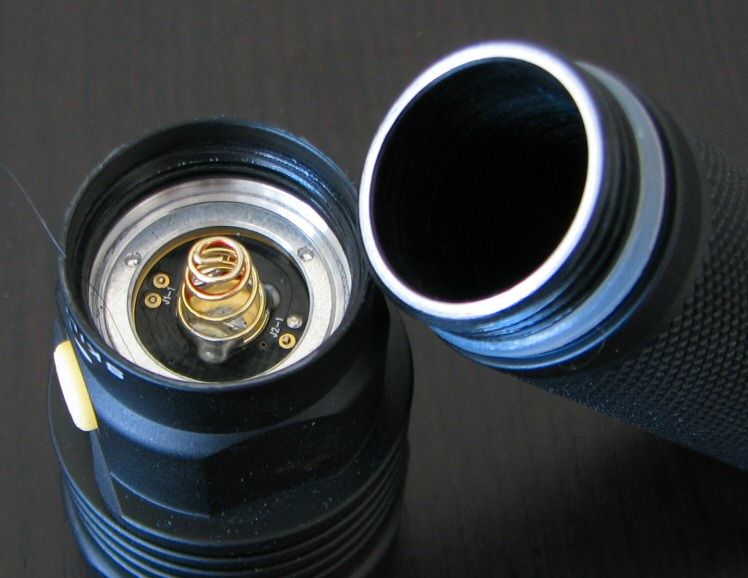

    There are anodized screw threads where the body tubes meet the head, allowing you to lock out either light. Threads are deeply cut, and have a good feel.

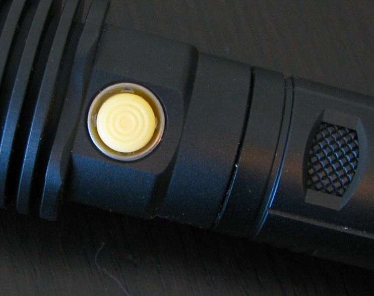

    The K10 features a forward clicky tail switch for On/Off, and a side switch for mode changing. In contrast, the K11 uses the side switch for both On/Off and mode changing. This side switch design is very similar to other Skilhunt lights I reviewed (i.e., an electronic switch under yellow button cover). There is a clearly audible click upon a press-release of the side switch, which is as loud as a traditional physical clicky switch. The K10 also features a recessed low-voltage warning LEDs on the left side of the switch (see User Interface discussion below for an explanation).

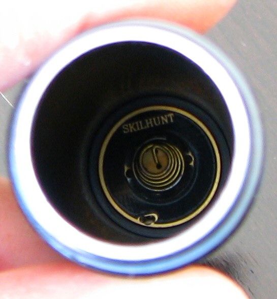

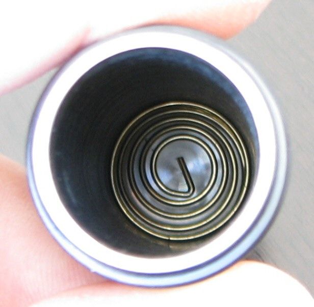

    There are springs at both the head and at the base of the tail – an integrated spring with the tail clicky switch on the K10, a stand-alone spring on the K11. Body tube was wide enough to take all my higher-capacity cells, on both lights. And all my flat-top cells worked fine.
    The lights can both tailstand, but the K11 is more stable due to its completely flat base. There are wrist lanyard attachment points on both lights (although a lanyard may interfere with tailstanding on the K11).

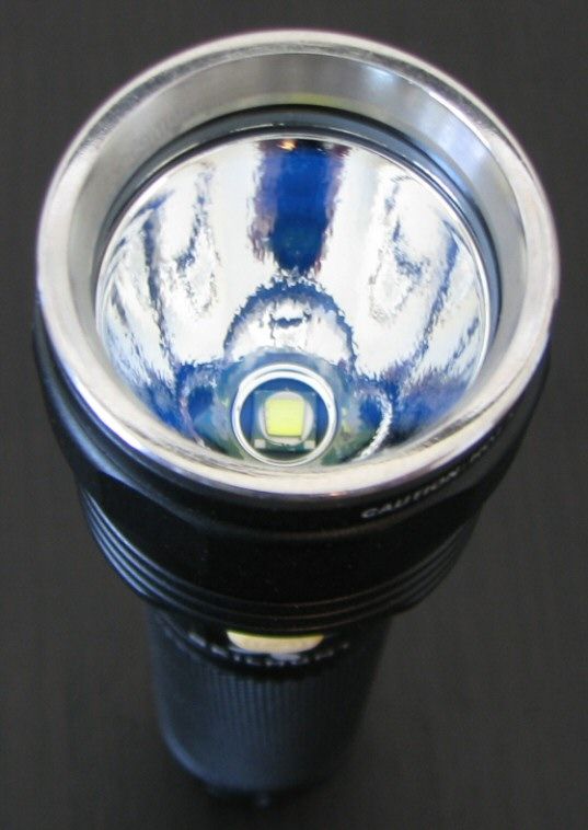

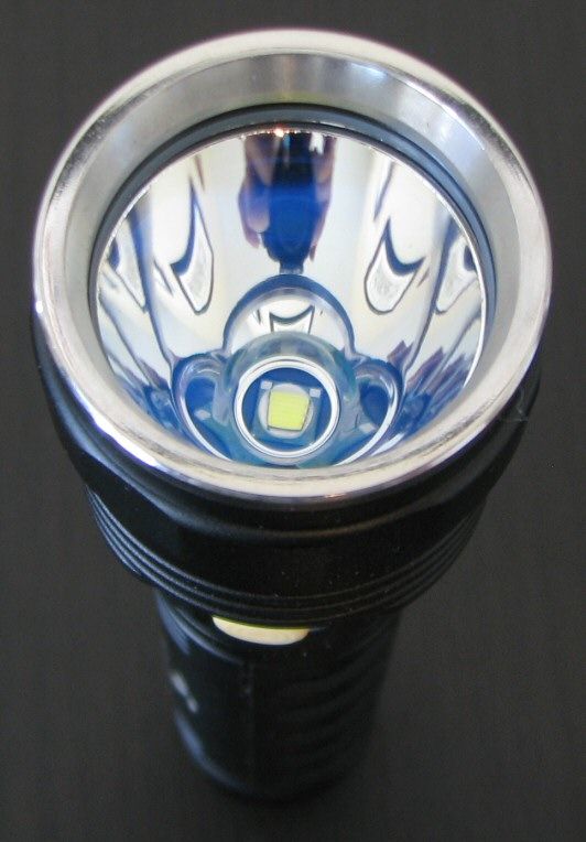

    Let's see how the business ends of the lights differ:
    K10:
    K11:
    They don't differ by much – the only real difference here is the smooth reflector on the K10, and the textured (medium orange peel) on the K11. I understand that each reflector type is available as an optional accessory for either light. The reflector is fairly deep, and should translate into pretty good throw for the size. The XM-L emitters (Cool White on my samples) were both well centered. Scroll down for beam comparison pics.

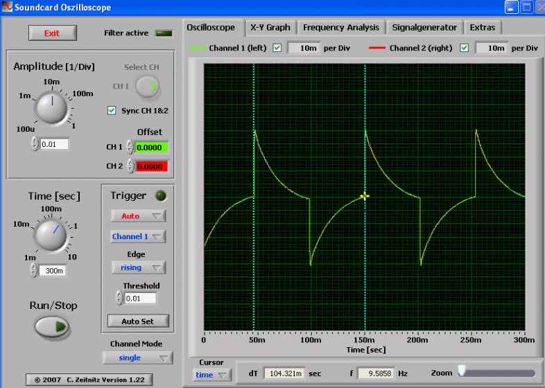

    PWM/Strobe
    There is no sign of PWM on any level, on either model – I believe the lights are current-controlled.
    K10 Strobe:
    K11 Strobe:
    The K10/11 series have a fairly typical (and common) strobe mode, of ~9.6 Hz on my two samples.

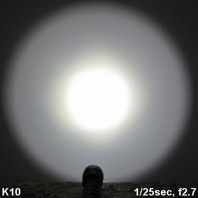

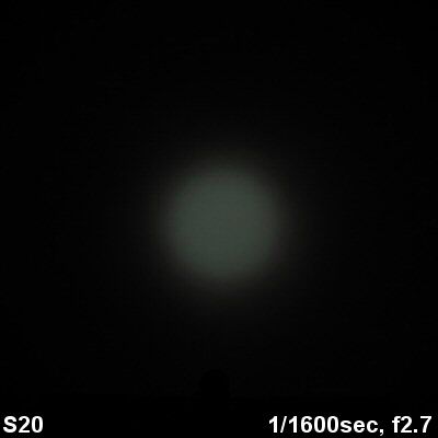

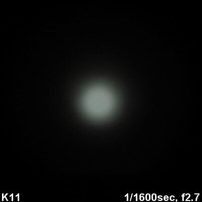

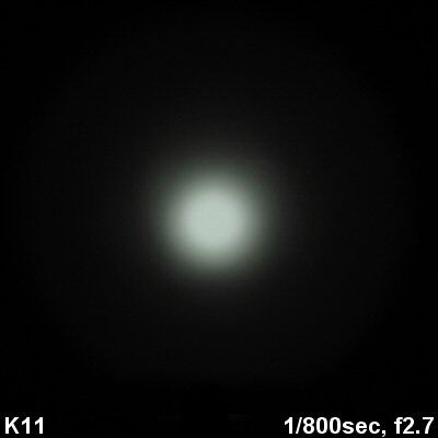

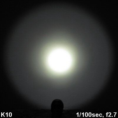

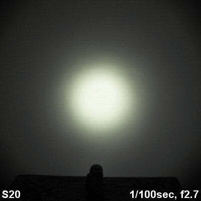

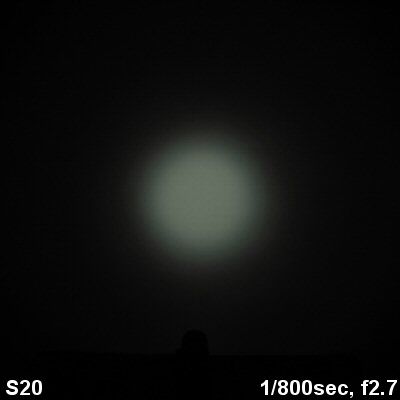

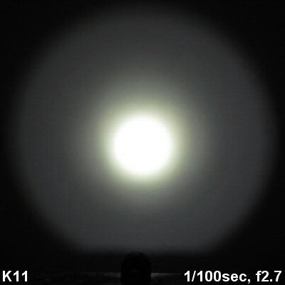

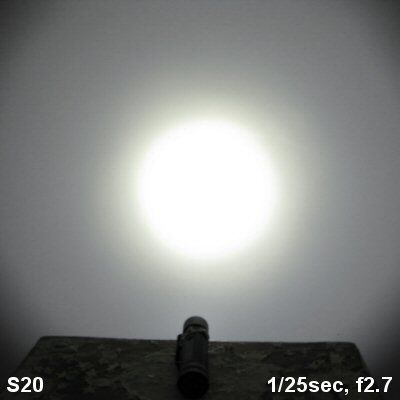

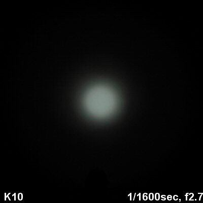

    And now, what you have all been waiting for. All lights are on 1xAW protected 18650, about ~0.75 meter from a white wall (with the camera ~1.25 meters back from the wall). Automatic white balance on the camera, to minimize tint differences.
    Despite the smooth vs MOP reflectors, the beams of the K10 and K11 look very similar. The reflector texturing may slightly soften the center beam hotspot, but there really isn't a big difference. Spillbeam width is as you would expect for a relatively deep reflector.
    Overall output is comparable between the K10 and K11. Scroll down for a more detailed comparison to other lights in my collection.

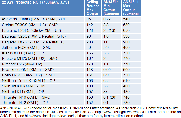

    Output and beam intensity specs seem pretty accurate in my testing, with perhaps a slightly higher peak throw on my samples. I have previously observed that my testing methods correlate very well with Skilhunt's ANSI FL-1 numbers.

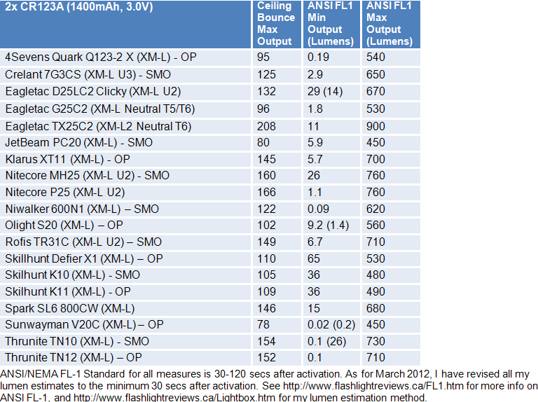

    Output levels are very consistent across all supported battery types. Note that as expected, max overall output is at the low end of this class.
    Let's see how outputs compare on my two samples, at all levels:
    Again, my testing results are very consistent with Skilhunt's own specs.

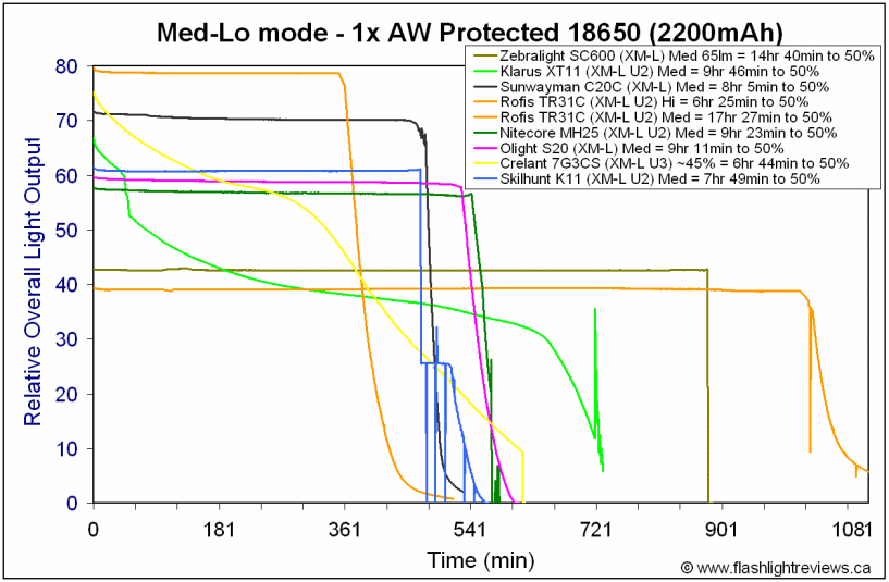

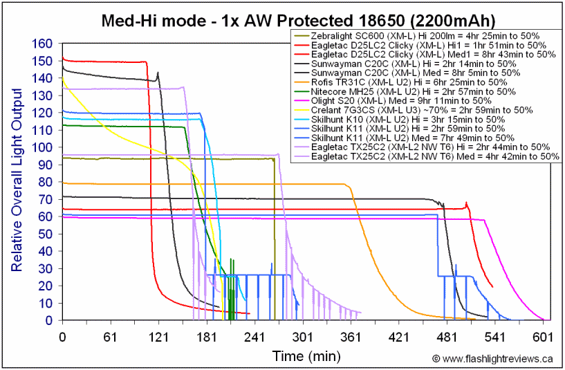

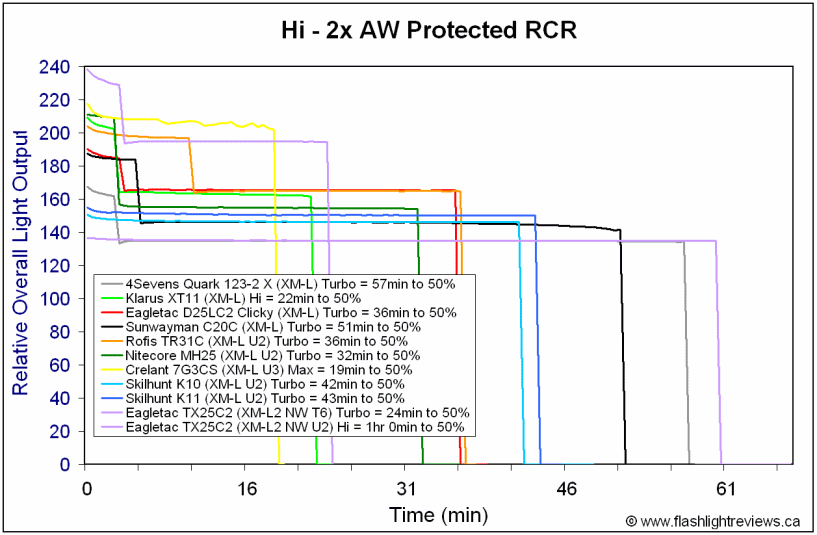

    Output/Runtime Graphs:

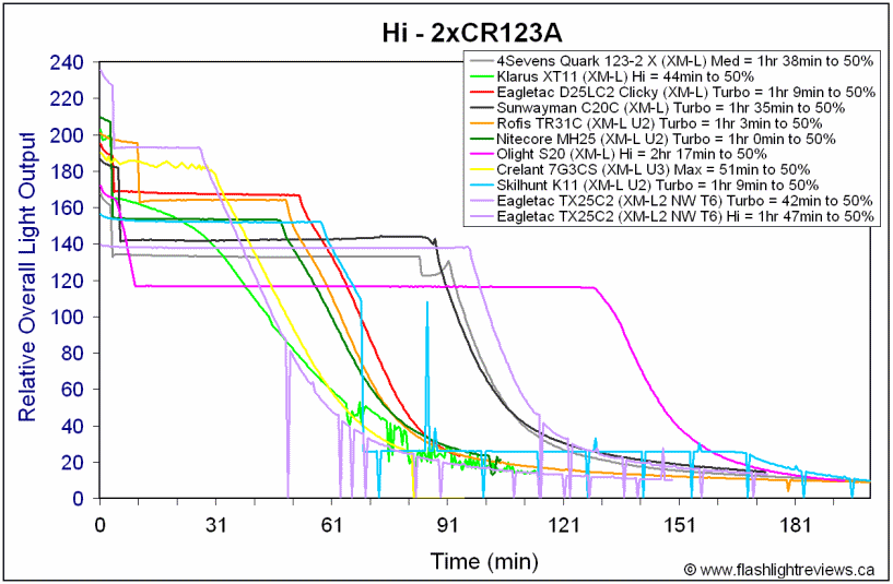

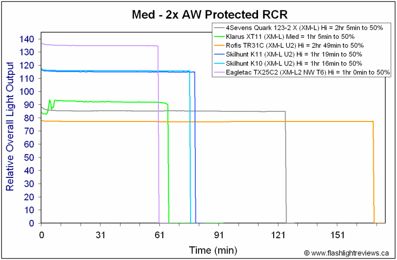

    Consistent with the nearly identical output levels across the K10 and K11, runtimes are similarly consistent at all levels. Overall output/runtime efficiency seems about typical for the class of the emitter.
    Regulation patterns are consistently flat, at all levels. Note that rather than just drop off rapidly, the lights both step down to lower levels as the batteries near exhaustion. Once the circuit can no longer maintain perfectly flat regulation, a gradual drop-off in output occurs.
    As expected, the K11 showed periodic warning flashes in the main beam, once step-down occurred. The K10 showed red flashes on the side-mounted LED indicator.
    As usual, Skilhunt seems to be slightly conservative in their ANSI FL-1 runtime numbers. My relatively low-capacity 2200mAh cells lasted almost as long as the published runtime specs (recall that FL-1 standard is time to 10% output). Most specs tend to be based on higher 2800+ mAh capacity cells, but it seems like you could reach these specs with 2400mAh.
