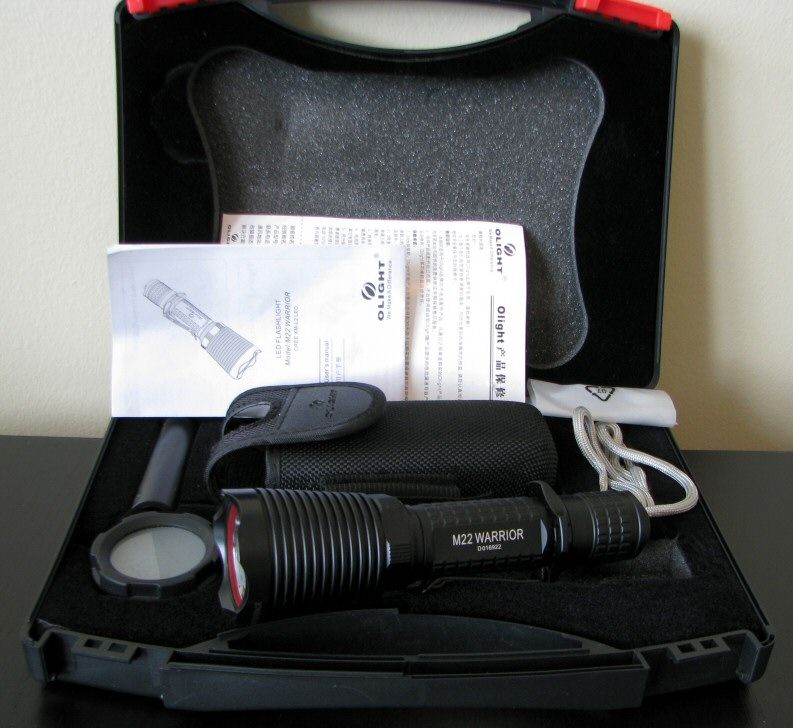

    • Included accessories: presentation display case, diffuser cover, holster, battery magazine, lanyard, extra o-rings, manual, warranty card.
    • Optional tactical accessories: weapon mount, filter, tactical remote switch, etc
    • MSRP: ~$95
    The M22 comes in a presentation-style plastic carrying case, similar to the other M-series lights from Olight. The light and all accessories are carefully packaged in cutout foam. Included with the light is a sturdy belt holder, spare O-rings, GITD tailcap button cover, good quality lanyard, 2xCR123A battery carrier, diffuser cover, warranty card and manual.

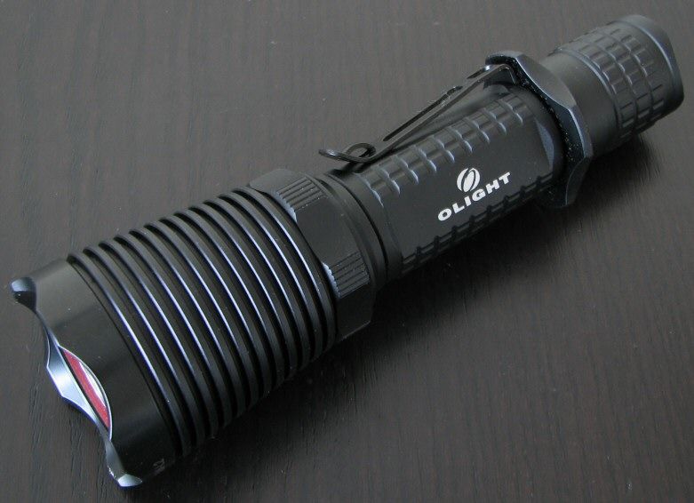

    Physically, the build of the M22 has changed from the earlier M20/M21 – although the overall external styling the body handle and tailcap look pretty similar across this series. Anodizing is now a matte finish (previously glossy black), but remains hard anodized (i.e., type III). Body labels remain bright and clear, and are sharp against the black background.
    As before, these lights don't use knurling per se – instead, the trademark Olight raised checkered pattern is used over the battery tube and tailcap to help with grip. It does fairly well, but is not as "grippy" as aggressive knurling. The head has distinctive concentric fins - likely to help with heat dissipation, but also serve to enhance grip. With the metal grip ring and clip installed, I would definitely consider grip to be above average for the class.

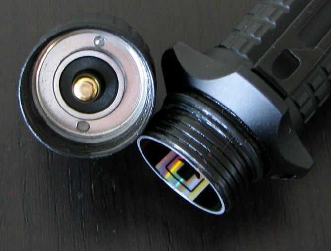

    Screw threading has changed from the earlier models, and the M22 features square-cut threads (of good quality). These are anodized at the tailcap to allow for lock-out.
    As before, there is a spring mounted on the positive contact board in the head, so flat-top cells can be used In the light.

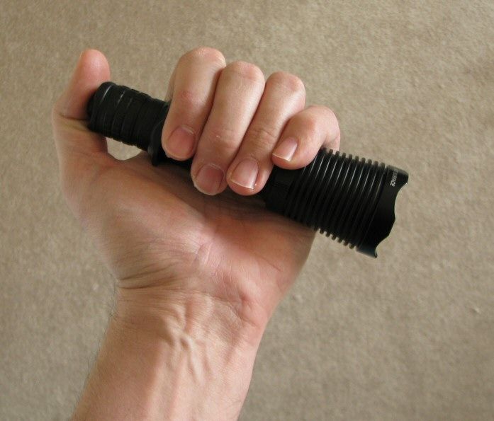

    The bundled cigar grip ring is made of metal, and has a groove that fits into a slightly raised piece of metal by the removal clip (as shown above). This helps hold the grip ring in place.

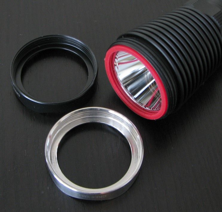

    I also quite like the standard Olight diffuser cover (included), which fit over the head of the light. Olight diffusers are of high quality, and can generally be used on many other lights of similar bezel size (thanks to the somewhat stretchy rubber cover).

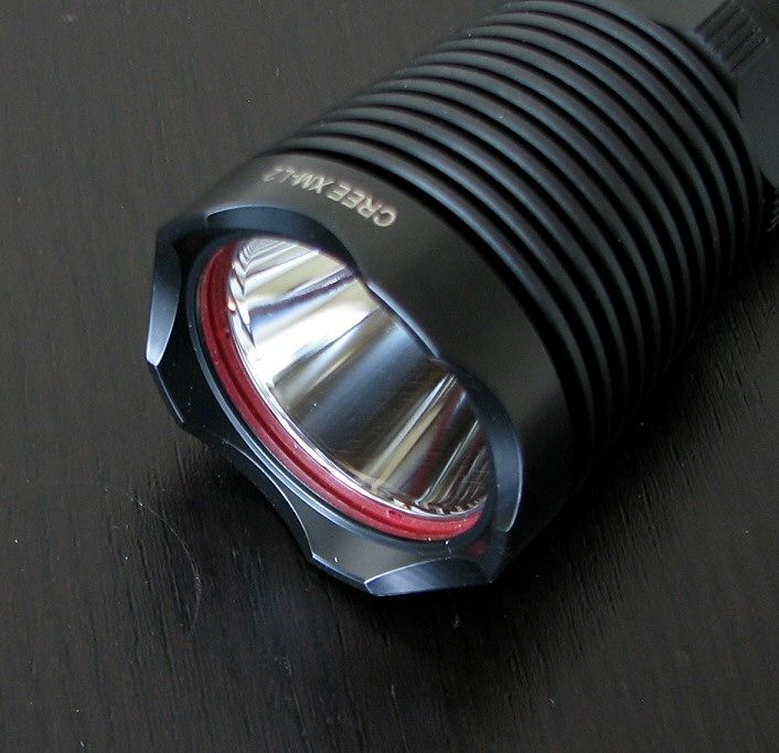

    The light comes in one of two bezel styles - a black stainless steel bezel, or a typical brushed stainless steel bezel. I believe you have to specify the bezel type when ordering (no difference in price), but both were included on my sample for comparison purposes.
    M22 XM-L2 T6:
    Reflector is smooth, and fairly deep. Coupled with the XM-L2 emitter Cool White emitter (which was well centered), I would expect reasonably strong throw. Note that you can distinguish the XM-L2 (shown above) from the original XM-L (shown below) by the lack of bond wires over the die surface now, and the use of a silver mask (instead of green) outside the die/dome area.

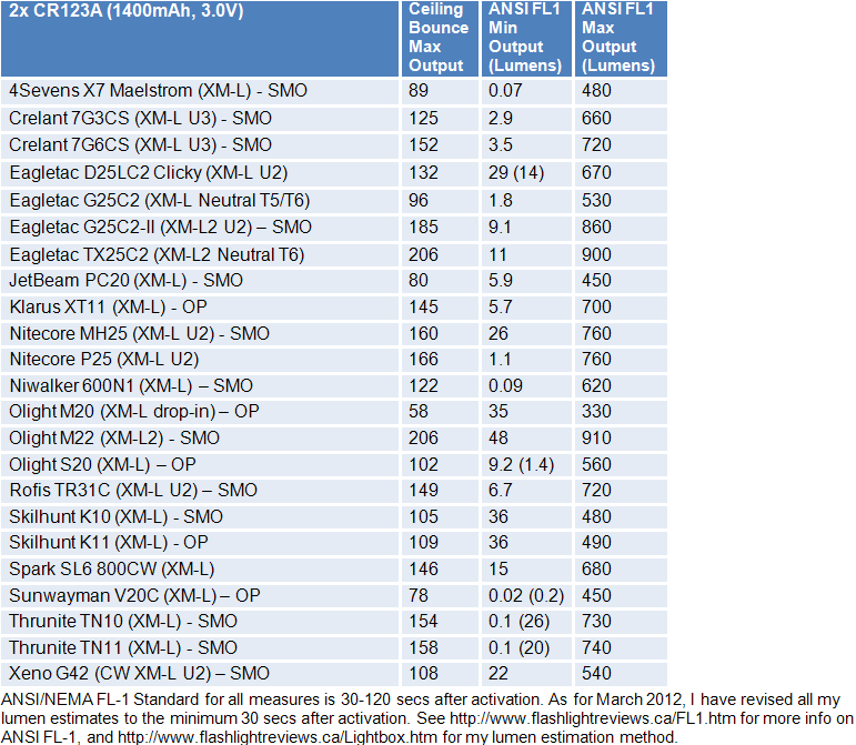

    For white-wall beamshots below, all lights are on Max output on an AW protected 18650 battery. Lights are about ~0.75 meter from a white wall (with the camera ~1.25 meters back from the wall). Automatic white balance on the camera, to minimize tint differences (i.e., my TX25C2 Neutral White won't look any different from the others, but it is a lot warmer in real life).
    Output has certainly increased greatly from the M20 with XM-L U2 module. Overall beam pattern is very similar to my recent Eagletac G25C2-II XM-L2, although the M22 has a slightly wider spillbeam and a more sharply defined hotspot.
    Overall output and peak throw of the Olight M22 (XM-L2 T6) are very similar to my other two recent XM-L2 lights - the Eagletac G25C2-II (XM-L2 U2) and TX25L2 (XM-L2 T6). The M22 is certainly a significant increase in max output and throw compared to the M20 (XM-L U2).
    Unlike some of my other lights, the M22's max output performance is actually a bit different across the battery types tested. Although the official specs for the M22 are "950 lumens" on Hi, Olight has confirmed with me more specific numbers for 1x18650 and 2xCR123A, as shown below.
    Overall, my lumen estimates vary somewhat from Olight's reference values, but the difference isn’t huge. The M22 is somewhat brighter on 2xCR123A than it is on 1x18650. See my runtimes below for more information.
    It bears repeating again that my estimated lumen scale is just that - an estimate, based on a consistent calibration of my lightbox. But even though the absolute value correlation is unknown, the relative comparisons still hold. All I can really say is that one light is higher or lower than another, by a certain relative percentage. So please don't get hung up on the absolute values of the estimates, or on small relative percent changes.

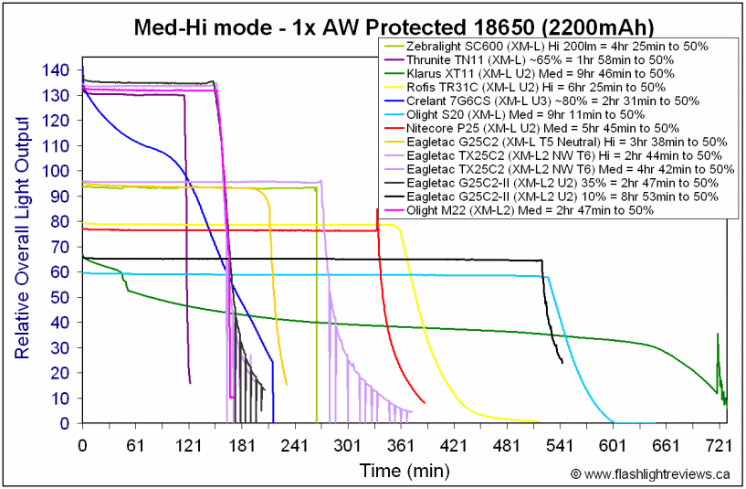

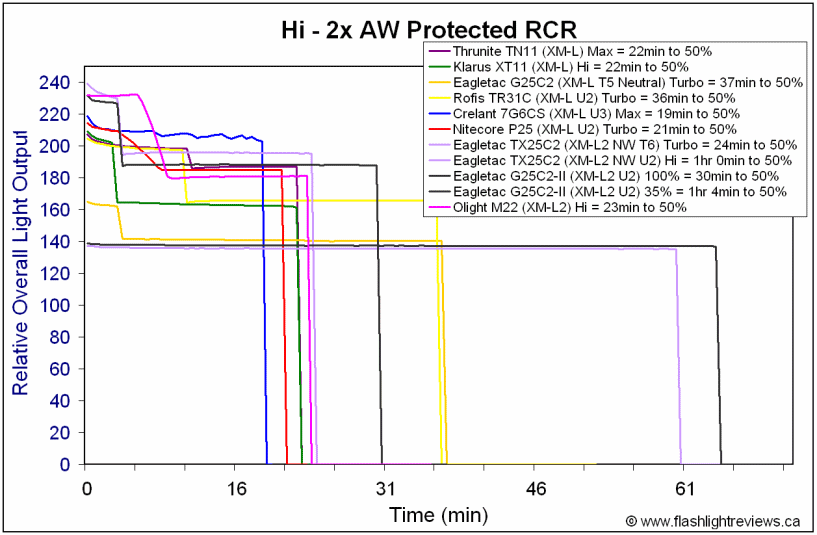

    Output/Runtime Graphs:
    My first observation from the above is that my Olight M22 (XM-L2 T6) is generally similar in output levels and overall efficiency as my Eagletac G25C2-II (XM-L2 U2) – at least on Hi and Med. The only real difference is that the M22 steps down more gradually on Hi - starting at ~6 mins into the Hi mode run, and leveling off at ~25% lower output by ~8.5 mins.
    On 2xCR123A, I'm impressed that the M22 can keep the ~910 lumen Hi mode in regulated fashion for over 6 mins (on fresh batteries). Overall output/runtime efficiency is excellent on the M22, and similar to my recent Eagletac lights.
    On all levels, the light maintains perfectly flat regulation for an extended period, before dropping off slowly in output (on 1x18650 or 2xCR123A) or with an abrupt shut-down due to protection circuits being triggered (2xRCR). Once the light has completely fallen out of regulation on 1x18650 or 2xCR123A (i.e., batteries are nearly exhausted), it starts to flicker rapidly at a low output level.
    As with my other recent Olight lights, ANSI FL-1 runtime specs on 1x18650 and 2xCR123A are generally consistent with my results. Recall that I use lower capacity 2200mAh 18650 cells, and that the FL-1 standard calls for time to 10% output (not 50%, as reported above). In that sense, my Hi mode runtimes are actually longer than I would have expected (based on the specs).

    Got mine now too love it, the only bad I found is; pocket-clip is to tight, tactical-ring that isn't threaded (because of that the ring moves slightly- even more when you remove the pocket-clip)
    Yes, there is some play in the grip ring, due to its being fitted into a socket (as opposed to being threaded).

    Do you know if red/blue/green filters will be available? or is it possible to use other filters from Olight on the M22?
    Mostly reading.
    6,936
    Default Re: Olight M22 (XM-L2, 1x18650, 2xCR123A/RCR) Review: RUNTIMES, BEAMSHOTS, VIDEO + mo
    Sorry, don't know if they colored filters in this size - you'd have to check with Olight or their dealers. The diffuser comes with it, and is larger than the older M-series diffuser/filters.
    The m22 uses the same exact diffuser as the m21 flashlights. Unfortunately, they never made colored filters for the m21 series. Maybe if the demand grows for the m21 and 22 lights, they will start making them.

    the m22 run with unprotected battery???? what you council between this and the eagletac tx25c2?
    6,936
    Quote Originally Posted by ciccio90 View Post
    I never recommend unprotected batteries, but the M22 would be one of the better lights to use an unprotected 18650 in. The reason for this is that there is a clear drop-off in output as the battery drains - including an extended period at a low level. This will give you plenty of visual warning that it is time to charge the cell while still in a safe voltage for the cell.
    This is in contrast to fully-regulated lights, where the unprotected battery voltage drops to unsafe levels almost immediately upon the initial drop in output. Basically, any light where you see the 18650 protection circuit kick in abrupty with no warning is a light you do NOT want to run unprotected cells in.
    As for the Eagletac lights, I quite like both the TX25C2 and G25C2 (the latter uses a tail clicky, like the M22). I would choose between the three lights based on your preferred user interface.

    I have the Olight M21 green filter now. It fits my M22 as well
