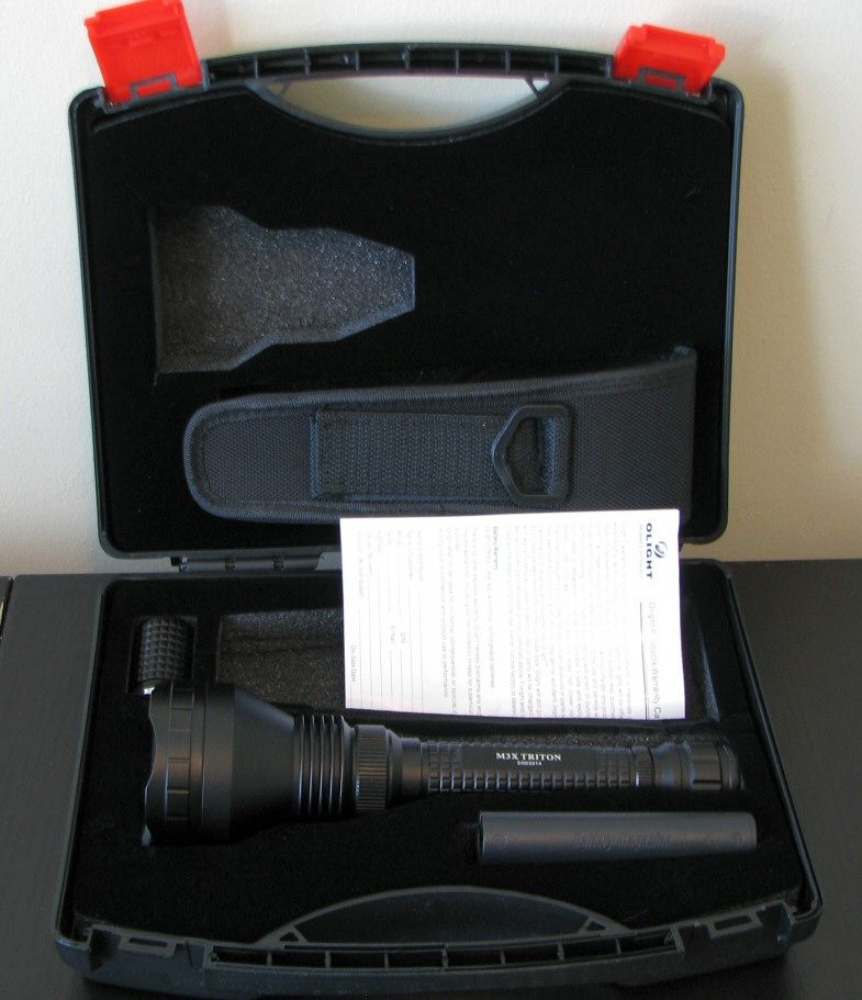

    The M3X comes in a presentation-style plastic carrying case, similar to the other M-series lights from Olight. Inside everything is firmly secured in cut-out foam. You will find the light with battery extender tube, manual, warranty card, battery carrier, spare o-rings, and belt holster.

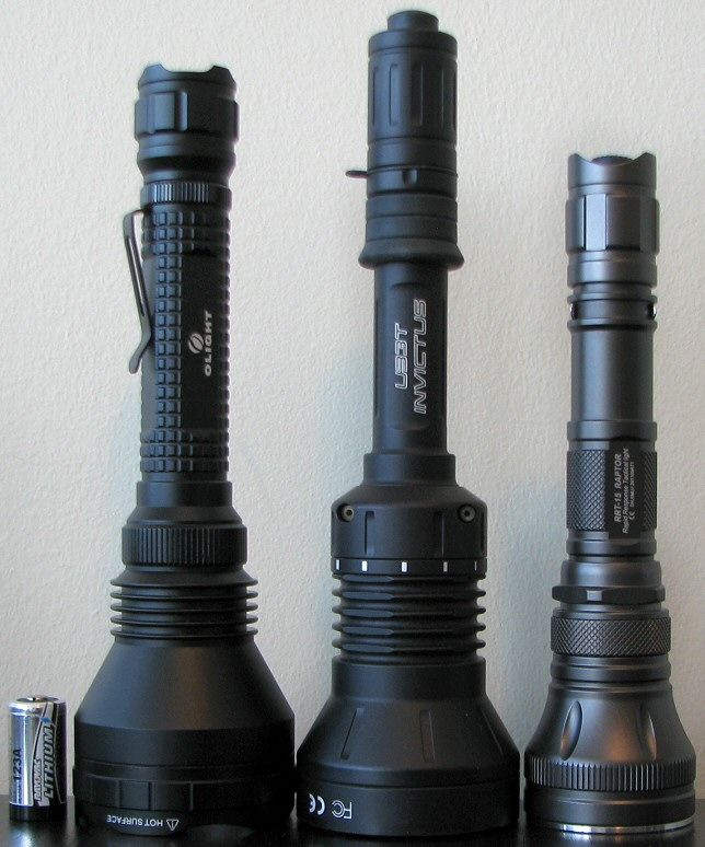

    From left to right: CR123A; Olight M3X; Surefire UB3T; Jetbeam RRT-15.
    With battery extender in place:
    From left to right: AW Protected 18650; Olight M3X; Crelant 7G5CS; Klarus XT-30; Nitecore MT40; Thrunite Catapult V3; Sunwayman T40CS.
    Olight M3X no Extender: Weight: 260.9g, Length 211mm, Width (bezel): 62.3mm
    Olight M3X with Extender: Weight 277.8g, Length 244mm, Width (bezel): 62.3mm
    Olight M31 no Extender: Weight: 258.1g, Length 209mm, Width (bezel): 62.3mm
    Olight M31 with Extender: Weight 275.1g, Length 245mm, Width (bezel): 62.3mm
    Crelant 7G5CS: Weight: 334.5g, Length: 247mm Width (bezel): 64.0mm
    Eagletac GX25L2: Weight: 198.3g (with battery pack: 290.1g), Length: 224mm, Width (bezel): 39.5mm
    Eagletac SX25L2: Weight: 279.4g (with battery pack: 470.3g), Length: 239mm, Width (bezel): 47.0mm
    Klarus XT30: Weight: 283.1g, Length: 247mm, Width (bezel): 58.0mm
    Niwalker 750N1: Weight: 408.0g, Length: 269mm, Width (bezel): 58.6mm
    Sunwayman T40CS: Weight: 296.7g, Length 227, Width (bezel): 63.5mm
    Thrunite Catapult V3: Weight: 434.8g, Length: 254mm, Width (bezel) 58.0mm, Width (tailcap) 35.1mm.

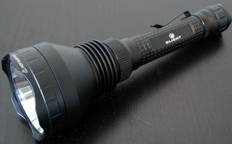

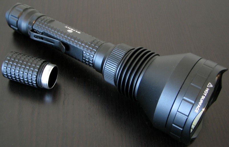

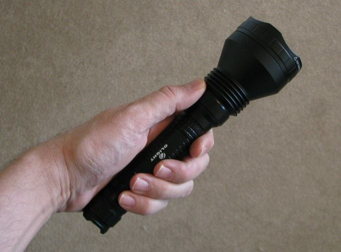

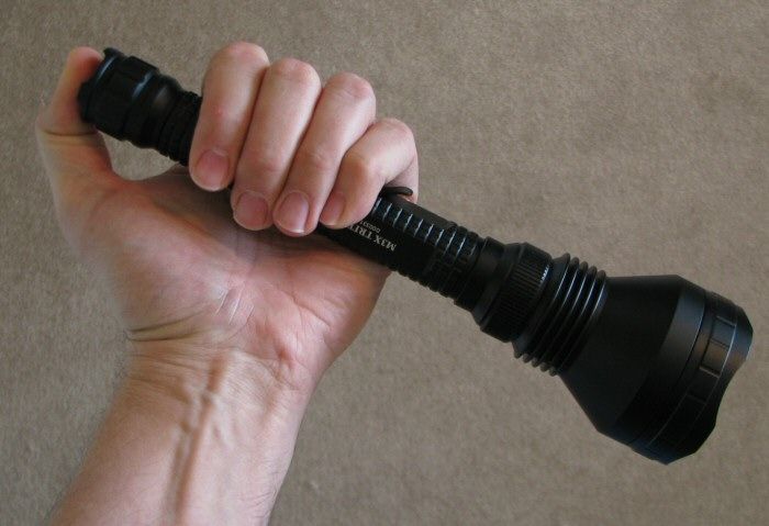

    The M3X has the same basic dimensions as the earlier M31 and M3X models, with a fairly wide head for this class.
    Physically, the build of the M3X hasn't really changed over the years. The M3X comes with matte finish type-III (hard) anodizing, in black. Rather than traditional knurling, the M3X continues to have the trademark Olight raised checkered pattern to help with grip. I typically find Olight lettering is bright and clear, and the M3X is no exception.
    Screw threads are not anodized on the battery tubes, but there is anodizing on the tailcap screw threads. So lock-out is possible, although it may not be as robust as where both sets of matching threads are anodized.
    The attached clip can be removed by unscrewing the retaining ring above it and pulling the clip off. The cover hides the attachment point in use.
    The tailcap switch is a typical forward clicky, with good feel. Both the bezel opening and tailcap have raised scalloped edges. Like earlier lights, the M3X can also tailstand.
    The included 3xCR123A/RCR battery holder is optional – you don’t need to use it in this configuration, but it does remove battery rattle if you choose to. The bore width of the body tube is wide enough to accommodate protected 18500/18650, so thinner CR123A cells are prone to some rattle. At the very least, it makes a good storage holder for an extra set of cells.
    Note the spring in the head, so high capacity flat-top batteries can be used. All my 18650 cells fit, but some of the longer cells seemed to be under a fair amount of tension.

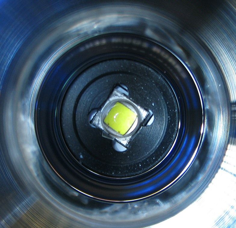

    M3X XM-L2 T6:

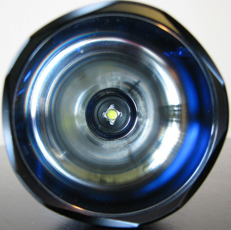

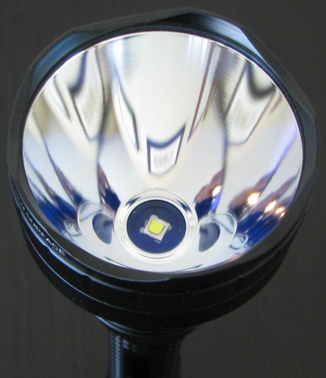

    As before, reflector is smooth, and both wide and deep. Coupled with the XM-L2 emitter Cool White emitter (which was well centered on my sample), I would expect very good throw.
    Note that you can distinguish the XM-L2 (shown above) from the original XM-L by the lack of bond wires over the die surface now, and the use of a silver mask (instead of green) outside the die/dome area. In case you are wondering, here is what the original SST-50-equipped M31 looked like:

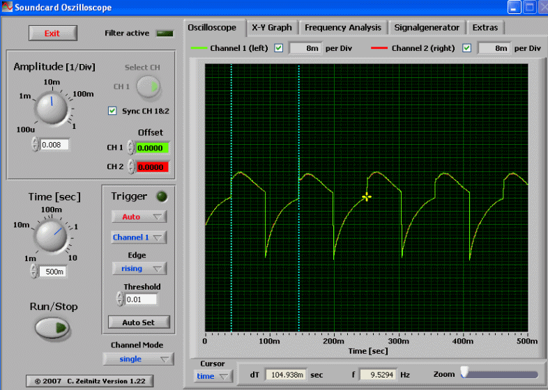

    PWM/Strobe
    As always, there is no sign of PWM at any output level – The M3X is current-controlled like its predecessors.
    The strobe is a fairly typical fast "tactical" strobe, of 9.5Hz frequency (as before).

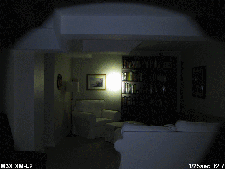

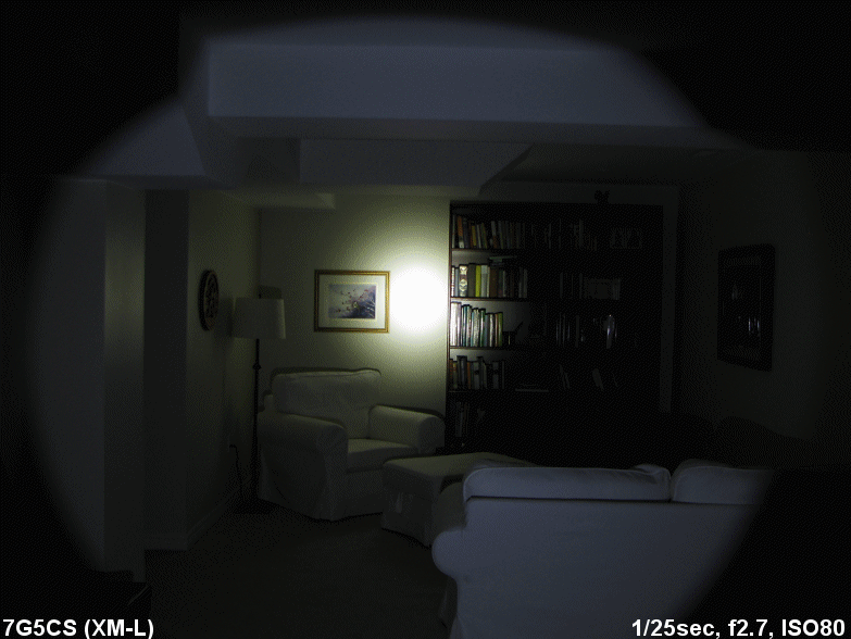

    For white-wall beamshots below, all lights are on Max output on 2x AW protected 18650 batteries. Lights are about ~0.75 meter from a white wall (with the camera ~1.25 meters back from the wall). Automatic white balance on the camera, to minimize tint differences.
    The M3X has a very wide spillbeam for this class, with a sharply defined hotspot. This is the classic "thrower" style, and you can probably tell from the above that this light will throw far.
    Of course, the true test will be in outdoor shots. The snow is nearly gone here, so I should be able to get to these soon. In the meantime, here are some indoor shots. These will at least allow you to compare the throw and spill of the lights. For your reference, the back of the couch is about 7 feet away (~2.3m) from the opening of the light, and the far wall is about 18 feet away (~5.9m). Below I am showing a series of exposures, to allow you to better compare hotspot and spill.
    The M3X definitely has the brightest (and largest) hotspot among by best 2x18650 XM-L-based throwers.
    I've thrown another XM-L2 light into the mix above (Eagletac SX25L2), but clearly it can't compete with the standard head. Eagletac will be sending me Turbo heads for those series, so we'll see how they do when they arrive.

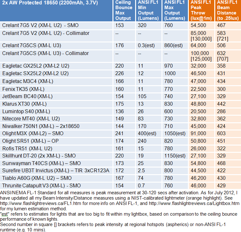

    The Olight ANSI FL-1 output and throw specs for the M3X seem very good – my measures match them closely.
    The 91,000cd center beam intensity makes this the furthest throwing reflector-based 2x18650 light in my collection at the moment. Only the aspherical (collimator) lights are able to beat it (and even there, not by much).

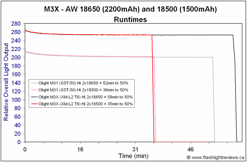

    Output/Runtime Graphs:

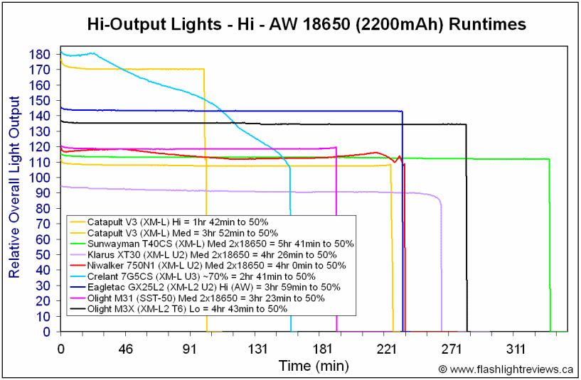

    On max, the M3X has very high output for the class, with no sign of any sort of step-down. It is interesting to compare it to the original M31 – as you can tell from the 2x18650 runtimes above, the M31 was clearly driving its SST-50 emitter very hard (i.e. runtimes were relatively low for the class).
    It is interesting to note that the "Lo" on the M3X is brighter than the "Med" mode of most other lights. Efficiency of the XM-L2-equipped M3X seems very similar overall to the Eagletac GX25L2, at all levels. Both Olight and Eagletac are known for their efficient current-controlled circuits.
    Let's see how the Olight lights compare on 2x18500 (which fit into the light with the extender in place):
    These lights are not well suited to 2x18500, given how hard they are driven on 2x Li-ion sources (i.e., you are better sticking with good capacity 18650 cells). But it's nice to know the option is there if you need it.

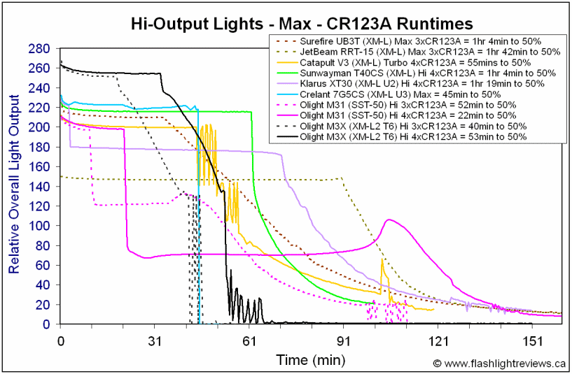

    For the CR123A runs, I am comparing below the M3X and M31 to a number of 3xCR123A and 4xCR123A lights (with the 3x runs in dotted lines, 4x runs in solid).
    The Hi mode of my M3X performed better on CR123A primary batteries than my earlier M31.
    But to understand why, I need to first explain the apparently unusual behavior of the M31 on 3x and 4x primary battery sources (i.e., those rapid dips and partial recoveries). The older M31 is driven high enough on Max to trip the PTC safety devices of most primary CR123A cells, when run over a sustained period.
    Simply put, a PTC (Positive Temperature Coefficient) functions kind of like a resistor or circuit breaker, and is incorporated into every primary CR123A battery. Technically, they are thermistors – circuit devices whose resistance varies with temperature (in this case, resistance increases with temperature, aka a posistor). Battery PTCs are of the "switching" type, which means their resistance rises suddenly once a certain critical temperature is reached. I have previously observed that there are marked differences in the speed in which made-in-the-USA cells will trip compared to made-in-China cells (i.e., made-in-the-USA cells trip earlier). My CR123A testing is done with made-in-China Titanium Innovations cells, which tend not to trip as easily. This conclusion, based on extensive testing in another light, is thoroughly discussed in this thread.
    The point is that once the temperature reaches a certain threshold (which varies according to the battery manufacturer), the PTC resistance rises and current limitation kicks in, causing a rapid drop in output. Over time, the temperature drops and the cells recover, showing an uptick in output. This is what you are seeing on the earlier M31 traces above, which was hard on all primary batteries (even on my more forgiving Titanium Innovation cells).
    I am happy to report that the M3X doesn't seem to heat/drive the cells to the same level as the M31 (i.e., no sign of PTC engagement in these tests, using the same brand of cells as before). That said, I can tell that the M3X current draw on Hi is still hard on the primary cells - I saw clear evidence of wrapper damage near the PTCs after these tests. Note that this wrapper damage issue is not unique to this light - I've seen signs of this before on many heavily-driven 2x and 3x/4xCR123A lights. But it suggests that had I been using made-in-the-USA cells (which trip earlier), it is possible that PTCs may have engaged to limit the current on the M3X as well.
    As such, I continue to recommend you do not run any of the M3x-series lights on Hi for extended periods on 3x or 4xCR123A cells. I would also recommend Olight introduce a step-down feature in this light, as they have in a number of their other models (e.g. the recent M22 and S20).
    As with my other recent Olight lights, ANSI FL-1 runtime specs are consistent with my results. Recall that I use lower capacity 2200mAh 18650 cells, and that the FL-1 standard calls for time to 10% output (not 50%, as reported above).
    All M3x-series lights are heavily driven on Hi, with no automatic step-down feature. As such, I recommend you do not run the light on Hi for extended periods of time on primary CR123A or 2x18500. On Hi, the light is really best suited for 2x18650.

    Quick note about the defuser (or lack there of):
    My SR51 defuser fits perfectly on the M3X. I like to use it more as a protective cover for the lens, but it works great at defusing the beam.
    If people out there don't have an SR51, they can order the defuser for one from Olight.

    Yes, I can confirm the SR50/SR51 diffuser fits and works fine on this light. I'll add that note to the review. It is available seperately, although it would have been nice if Olight had bundled it directly.

    I have updated this review with outdoor beamshot comparisons of M3X to the Eagletac SX25L2 Turbo head, and ArmyTek Barracuda - two recent XM-L2 lights.
    For outdoor beamshots, these are all done in the style of my earlier 100-yard round-up review. Please see that thread for a discussion of the topography (i.e. the road dips in the distance, to better show you the corona in the mid-ground).
    FYI, any "streaks" you see across the images are bug-trails. Flying insects are often attracted to the bright lights, and their flight trails get captured as swirly streaks due to the long exposure time.
    As you can see, the M3X is an outstanding thrower, with a wider spillbeam than the other lights (especially the Barracuda). The Barracuda has the highest centre beam lux throw in my collection at the moment, but the M3X XM-L2 is very close. Again, ignore any tint differences above – they are mainly due to the automatic white balance setting on the camera.

    The manual makes no mention of RCR, or the max circuit range. Clearly, 3xRCR should work (given that it take 4xCR123A), but I don't know if 4xRCR is supported. 4xRCR ran fine in my original M31, but I haven't tried it in the M3X, so can't say for certain.
    In any case, I think you are better using 2x18650 or 2x18500 as a rechargeable option. You loose capacity when you go down to multiple RCRs, and there is no advantage in terms of output (i.e., you just lose runtime). The M3x-series lights are heavily driven on Hi As such, I don't recommend 3xRCR (standard ICR) on Hi, as you will likely be running the cells pretty close to the maximum discharge rate.
    SB,,,,Can it use the longer 18650 protected batteries? 69 to 70mm?
    I looked up the AW 2200Mah 18650 you were using and they were on 67.8mm.
    Thanks
    6,936
    Default Re: Olight M3X (XM-L2, 2x18650, 3x/4xCR123A) Review: RUNTIMES, BEAMSHOTS, VIDEO + mo
    Should be fine. Typically, longer cells work fine in multi-cell length lights. If anything, it is shorter cells that typically have a problem in these lights (due to low tension).
    EDIT: to clarify one point - a potential issue with longer cells is too much tension on the batteries. This could lead to denting of the cells, especially the positive terminal (if it uses a very thin button top, for example).

    Center Beam: Not focused, blurry ,distorted with Mickey Mouse ears at 1,5, 7 and 11 o'clock. These were wall shots from about 7' away.
    Also a very Yellow tint unlike any of my other XM-L or L2 torches.

    Not that I am aware of. The body is designed for 3xCR123A (with the extender for 2x18650 or 4xCR123A), so 1x18650 won't make contact. The circuit is also unlikely to be powered by 1x18650, given the support for higher voltages.

    As with all my reviews, many relevant comparisons are included in the output/throw summary tables and runtime graphs. You will find the SR51 data in the output/throw table in the review.
