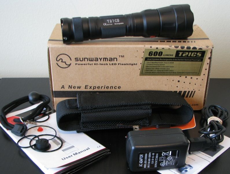

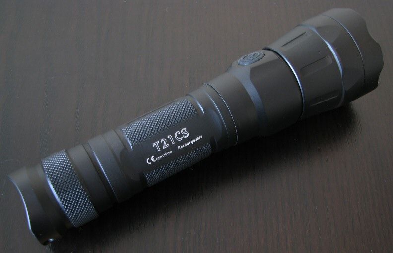

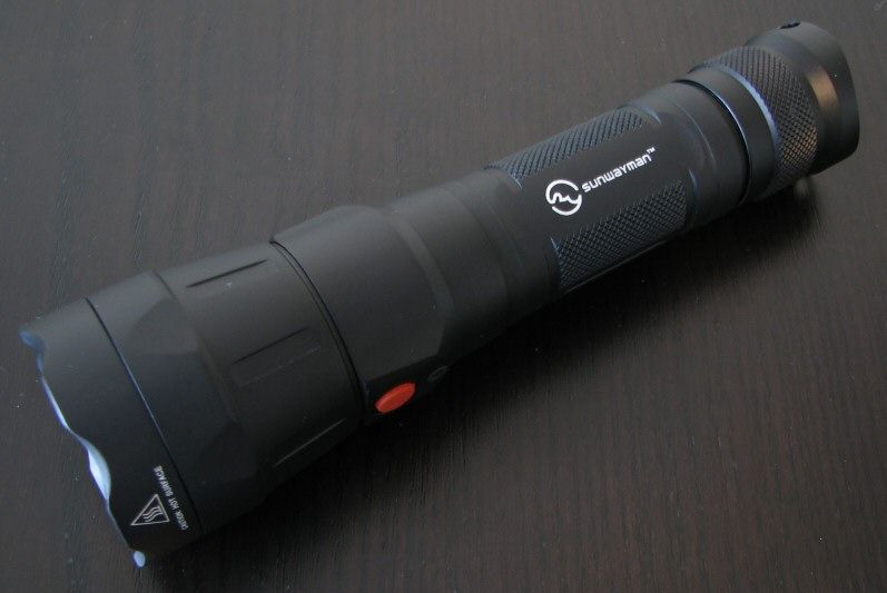

    The T21CS comes in study packaging. Inside the cardboard box, there are two layers of cut-out foam. The top layer has the light, securely packaged. The lower layer has the holster (with a baggie containing the wrist strap, extra o-rings, and extra charging port cover), USB charging cable, AC adapter, manual, warranty card and product insert.
    From left to right: AW Protected 18650; Sunwayman T21CS; Rofis TR31C; Nitecore MH25, P25; Eagletac G25C2-II; Olight M22.
    Sunwayman T21CS: Weight 161.9g, Length: 154mm Width (bezel): 41.4mm
    Klarus RS11: Weight 158.0g, Length: 160mm, Width (bezel) 34.9mm
    Nitecore P25: Weight: 171.3g, Length: 160mm, Width (bezel): 40.0m
    Rofis TR31C: Weight: 180.7g, Length: 153.0mm, Width (bezel): 39.8mm

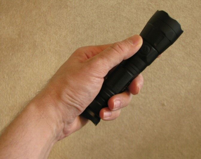

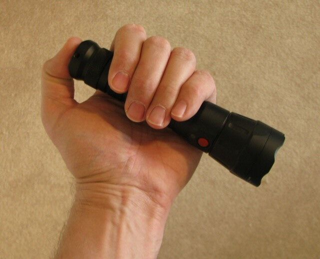

    Overall size and weight is in keeping with other lights with built-in 18650 charging options. Note that this typically adds a bit of length and weight, due to the extra circuitry and tailcap/body tube spacing needs.

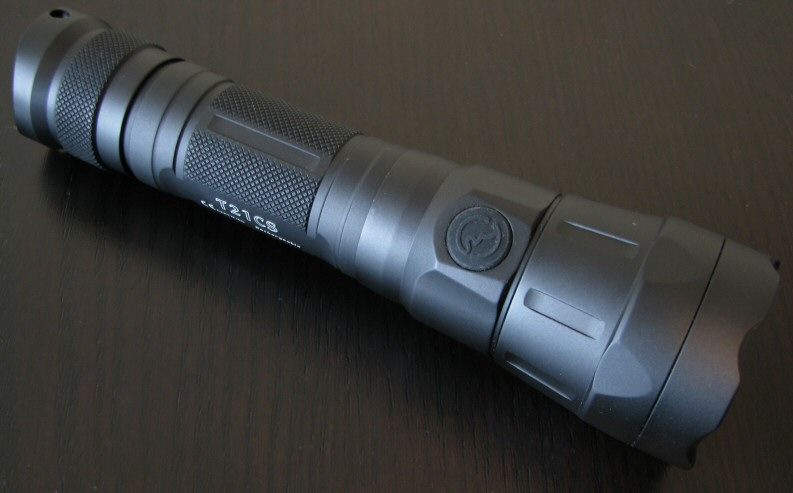

    Anodizing is a very flat matte black, with no chips on my sample. This is different from the glossier natural finish that I am accustomed to with Sunwayman (and prefer, to be honest). Labels are bright white against the dark background. There is some limited knurling around the body tube, but it is of mild aggressiveness. Grip is not as high as it could be.

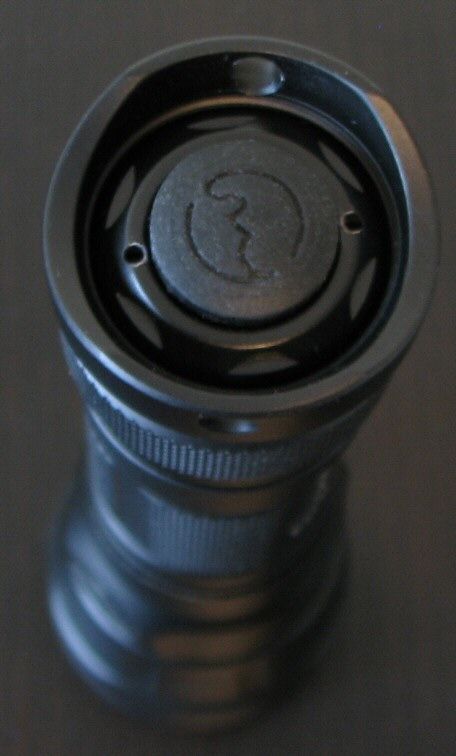

    In addition to the tailcap forward clicky switch, there is also an electronic side switch in the head. Switch feels are about typical for both. Note that the functions of the switches are different from other lights I've tested – scroll down to the User Interface section for an explanation.
    The T21CS comes with a crenaled bezel ring. It looks to be aluminum, like the rest of the light.
    There is a spring on the positive contact point in the head, which means flat top cells can be used. Even with the inner sleeve (explained below), the internal body tube is wide enough to take high-capacity protected 18650 cells.

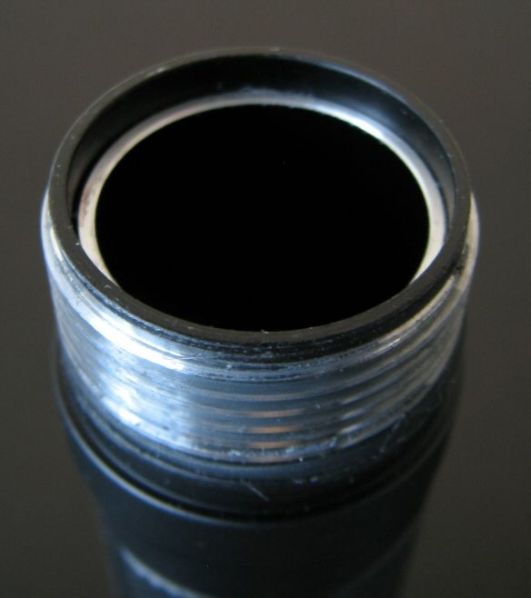

    Screw threads are square cut (i.e., trapezoidal), and seem of good quality. They are not anodized, as the threads are required for one of the current paths. There is anodization to separate the two current paths (i.e. the inner sleeve from the outer threads). This is all explained below.

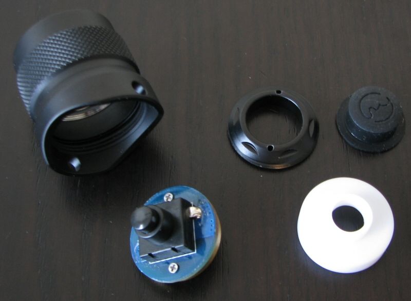

    Light can tailstand stably. Note there is an external switch retaining ring in the tailcap (black).

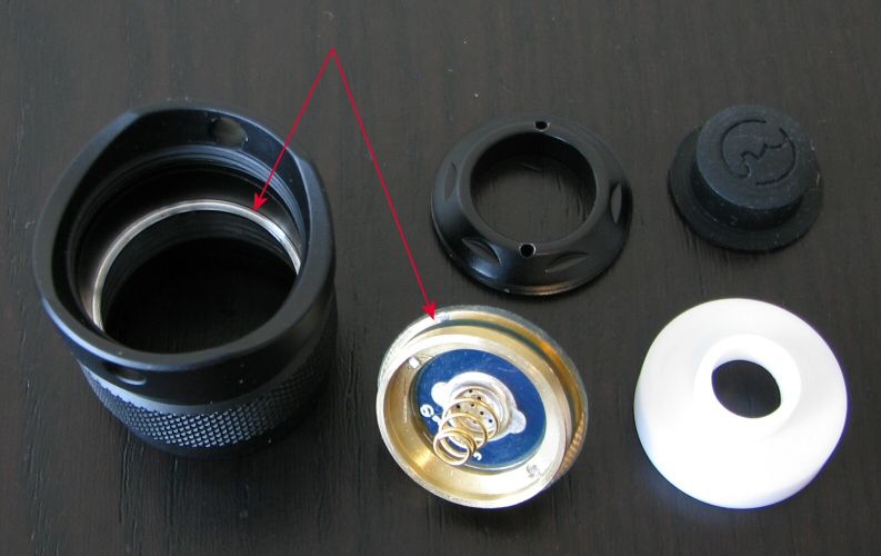

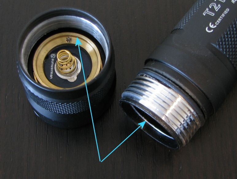

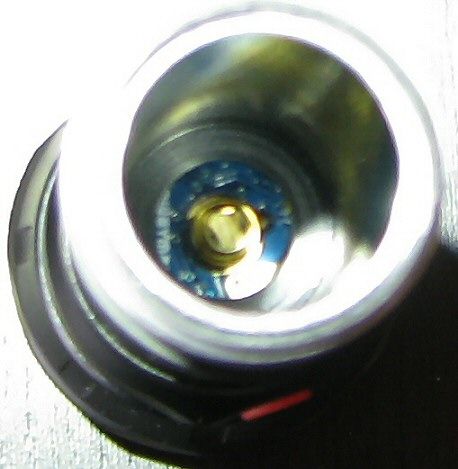

    As mentioned above, there are actually two current paths for how the tailcap connects to the circuit in the head:
    The external path is illustrated by the red arrows above. Basically, there is a continuous connection between the switch spring and an outer contact ring on the switch PCB. This connects to a non-anodized portion of the tailcap base, which in turns connects through the non-anodized screw threads. As a result, you have a continuous standby connection as soon as you first start screwing on the tailcap. Clicking the switch has no effect on this current. This connection is what allows the electronic switch in the head to draw power and operate (and, I presume allows charging of an 18650 inside the light).
    The second connection path is carried by the inner metal sleeve of the body tube. This sleeve has a non-anodized portion that makes contact with the raised brass ring on the switch PCB (blue arrows above), only when the tailcap is fully tightened. This current path is under control of the switch – you can break this connection by clicking the switch off, or loosening the tailcap a quarter turn.
    See the interface discussion below for the unique way Sunwayman has designed the interface.

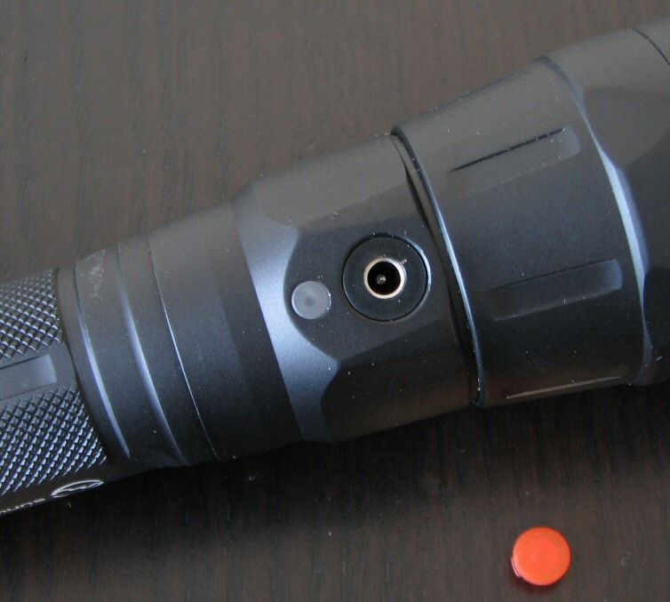

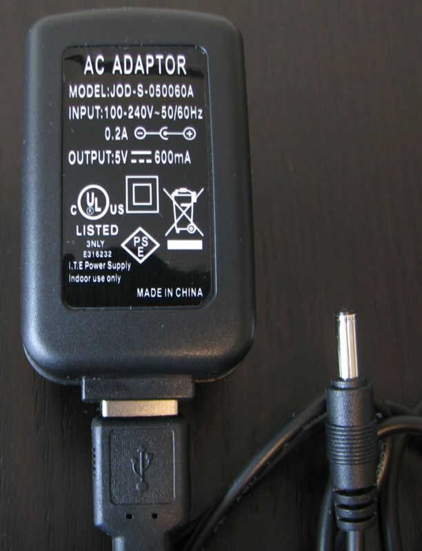

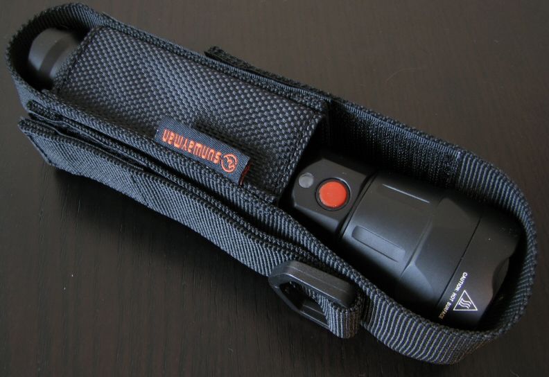

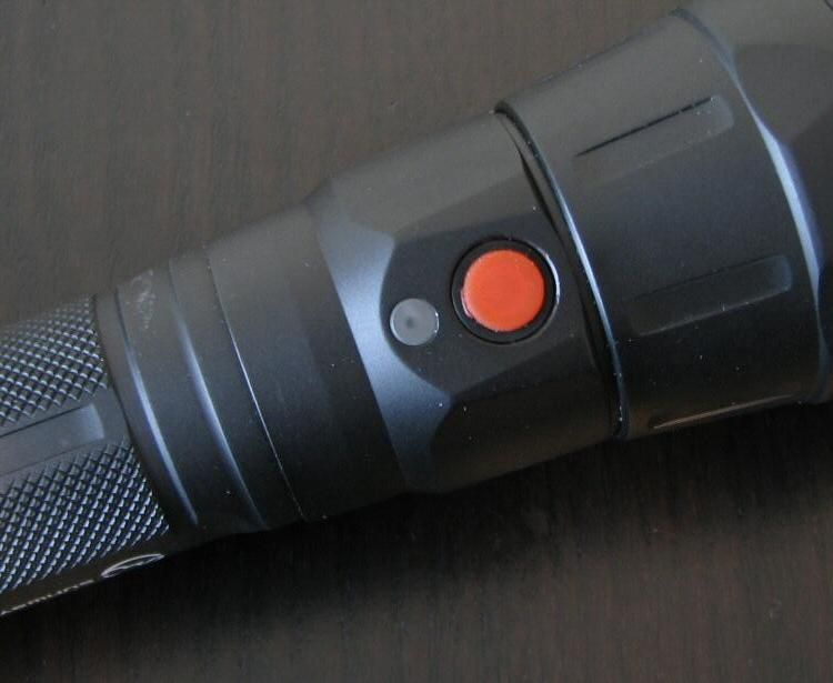

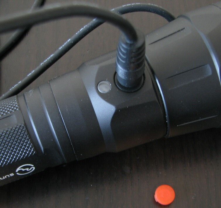

    The charging dock uses a standard 12V DC pin-style connector, under a removable red plug (USB charging cable and USB-AC adapter included). Since this plug is not attached, I would be worried about losing it (note that a spare is provided with the package).
    There is a LED indicator on the light, which tells you the charging status when the charger is attached. When charging, the LED will flash red at a slow rate. When fully charged, the LED will switch to constant green.
    The AC adapter for the included USB cable list a maximum charge rate of 600mA, which is higher than the standard USB 2.0 specs (which limit you to 500mA charging current). From my testing, when connected through just the USB cable to a computer, the charging rate was 5 hours and 15mins for my 2200mAh 18650 cells. When plugged into AC power through the adapter, the charging rate dropped just over 4 hours.
    This accelerated charging on AC power is similar to the time it takes my Pila IBC charger to charge these cells. It is certainly faster than most of the other USB-only in-light 18650 chargers I've tested (typically, ~6-7 hours). Resting voltage for the cells was a fairly consistent ~4.19V, which is appropriate.

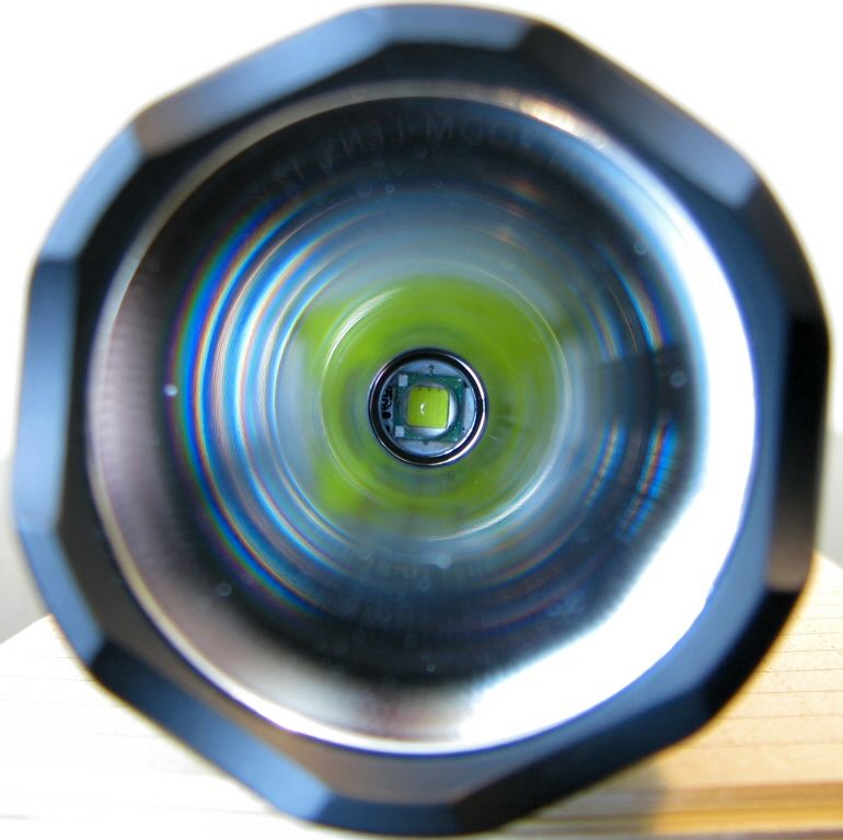

    Reflector is basically smooth, and fairly deep. There seems to be some fine texturing of the reflector, which shows up as reflected rings and a slight haze (likely to smooth out the beam). There is an anti-glare coating on the lens. The XM-L (cool white) emitter was well centered on my sample.

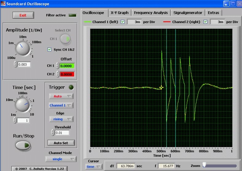

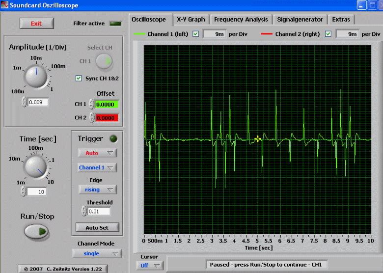

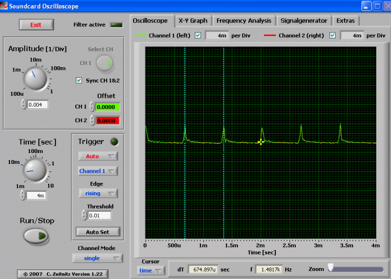

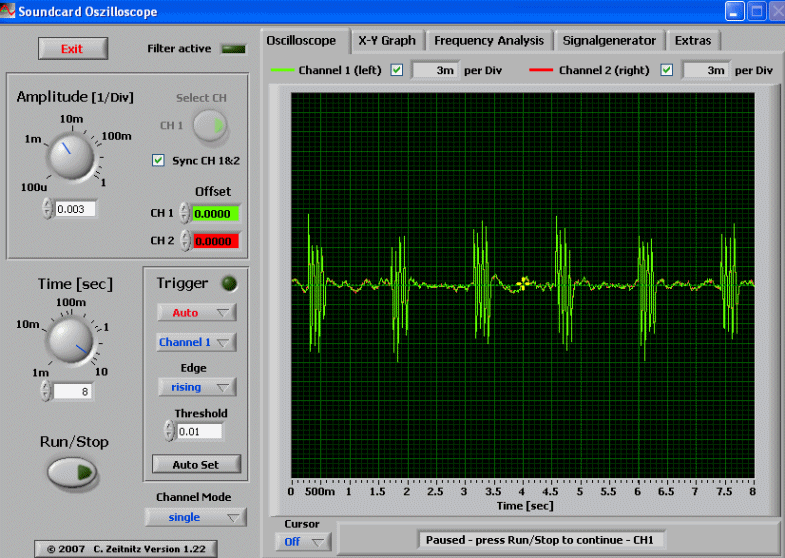

    PWM/Strobe
    I didn't see any evidence PWM at the Med or Hi levels, but there was a non-visible reoccurring signal on the Low mode:
    Judging from its appearance – and the lack of concomitant signal on Med – I think this is some sort of circuit noise on Lo. At 1.48kHz, this signal frequency is above the visual detection threshold, so you won't see it. The intensity is high enough that you may be able to faintly detect it when shining on a fan, though.

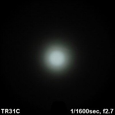

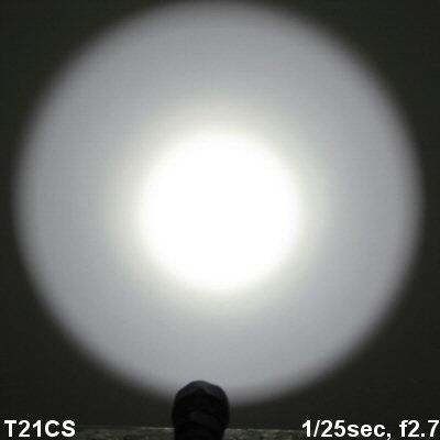

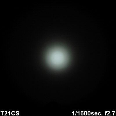

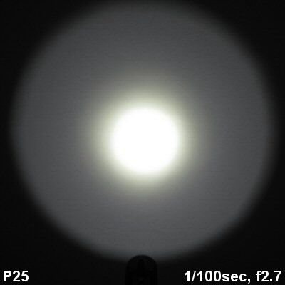

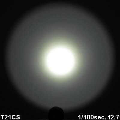

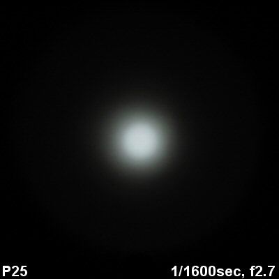

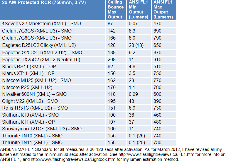

    Beam pattern and overall output is certainly in keeping with the other in-light 18650 charging models shown above. Throw is reasonable for the class, about the same as the Rofis TR31C (but less than the Nitecore P25). Scroll down for detailed comparison testing results.

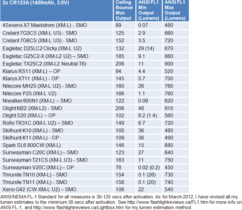

    The first observation above is that the T21CS is brighter on 2x battery sources than 1x (e.g., like the Klarus XT11). But there are additional differences between how these modes operate (i.e., timed step-down only on 2xRCR). See runtimes below for more information and a discussion of relative output levels.
    Sunwayman ANSI FL-1 specs seem over-stated for throw, as my direct beam intensity measure on 1x18650 (18,500cd) is lower than what they report. I have also tested the light on 2xRCR (not shown in the table above), and got 21,700cd, which is still lower than their reported 24,00cd. In any case, the throw for my T21CS is still quite good for the size and relative output levels.

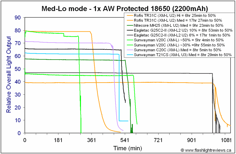

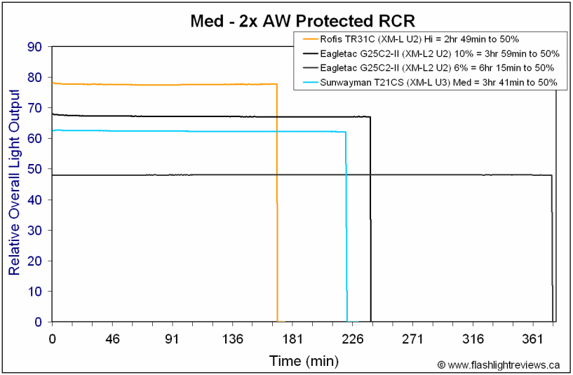

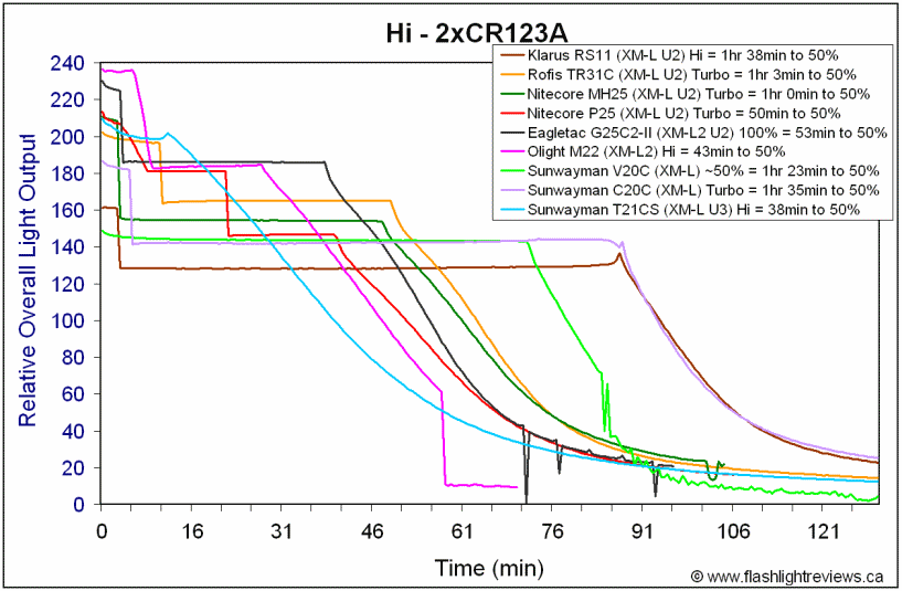

    Output/Runtime Graphs:
    As previously mentioned, the T21CS is brighter initially on 2xRCR or 2xCR123A. Runtime patterns are different however, with an apparent timed step-down only on 2xRCR (but not 2xCR123A or 1x18650), after 5 mins. The light is typically fully regulated, except on Turbo with 1x18650, where you see a semi-regulated runtime pattern on Hi (i.e., direct-drive-like).
    As a result, it seems that the specs are bit misleading in this regard - Sunwayman reference to the "Turbo" and "Hi" modes appears to refer to the before and after stepdown, but only the 2xRCR actually steps down.
    To summarize the output results: 1x18650 only shows a "Turbo" of 620 estimated lumens (no step-down), 2xCR123A only shows "Turbo" of 750 estimated lumens (no step-down), and 2xRCR shows an initial "Turbo" of 740 estimated lumens with a timed step-down to "Hi" of 480 estimated lumens.
    Note that on the fully regulated modes (i.e., all modes except the semi-regulated Turbo 1x18650), there is step-down to Med and/or Lo as the batteries near exhaustion. This is a nice feature, and one that I would like to see more often (i.e., as opposed to a complete shut-down). The semi-regulated Turbo 1x18650 doesn't need defined step-downs, as the gradual drop-off accomplishes the same effect.
    Overall efficiency is good on all batteries, consistent with a typical XM-L based current-controlled light. ANSI FL-1 runtime specs are believable for 1x18650 (recall that the FL-1 standard is for runtime down to 10% of initial output, and most manufacturers use higher capacity batteries than my AW 2200mAh cells used here).

    The charging port cover is fully removable, and could potentially be lost during charging cycles. Sunwayman provides an included replacement plug, however.
    The side switch is difficult to locate by touch or sight, as the charging port cover actually stands out more.

    yeah that red plug is gonna get lost in a second with most users. I guess there isn't truly any graceful or aesthetically pleasing way to attach it on there though
    Yes, although most makers have opted to permanently attach the plugs in some way (which generally makes them more prominent, though). The end result is often that the charger plug is more easily identified by touch or sight than the side switch (which I find is the case here too).
    Some makers (like Nitecore on the MH-series) have opted for a metal screw-down cover (with o-rings for waterproofness). But it's difficult to verify the o-rings are there, since they are not visually apparent. One interesting solution is the Rofis TR31C, which doesn't use a plug cover at all - apparently, they have somehow waterproofed the connector socket (based on preliminary evidence in a video from a dealer who tested it). I suppose it is possible to pot the connector in some way, but of course that isn't accessible to end user to verify.
    No perfect solution yet for an in-light charging feature, I guess.
    Klarus does a good job with their magnetic charging connection
    Yes, that is a good body design for a charging port at the tailcap (as there is no open voltage or exposed entry). However, the dual-circuit design means that PWM is used. I recommend people check out my review of that light for a more thorough discussion of the magnetic charging cable design.

    After reading and watching your review again I noticed that the holster is somewhat to small for the light. The hard-velcro-part can touch the flashlight, which can cause scratches.
    Now, I don't know if you use the light and holster much- but if you are using it (a lot), are you noticing some marks on the HA-III coating?
    Interesting observation, I could see that would be possible. I haven't noticed, as I have not been using the light.
    Have this same problem with the Fenix TK21 holster. Because of that, I use a Maxpedition holster now for that light.
    I can imagine you can't use all the lights, manufacturers send you for review

    I own a Nitecore MH25 and love the self-charging ability but that light has some limitations (the low setting mostly). Thought this might be better but......
    what blows me away is that they make a light with that much complexity in the UI and do not give it the ability to come on in low (unless I missed something). It seems anyone who follows this forum even a little would know that that is a very common desirable trait. Instead, they use the complexity to add addtional strobe modes (??) Are there really a lot of folks out there wishing they had more strobe functions on their lights?
    Light makers (IMHO) seem to have this incredible knack for making a really good light and then just screwing up one key (simple) thing, that diminishes it greatly.

    ^ i hope there is some way to allow this model to come on in low - i just ordered one along with a nitecore srt7 - should arrive today -
    i am not so sure about the complex user interface too
    i wonder what the main difference between the t20cs and the newer t21cs is? i figured the t21cs can be used in 600 lumen mode with a 2.2 hour runtime? also more aluminium (heavier) means better heat absorption?
