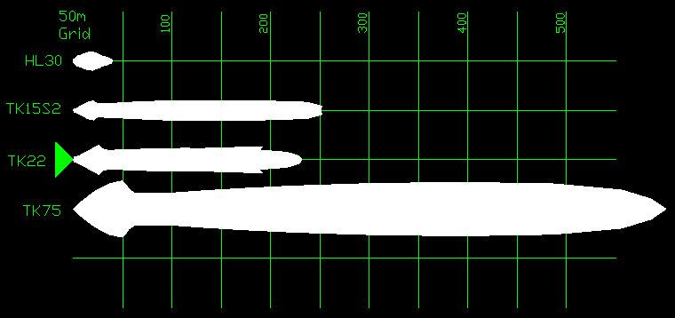

    Each light in this line-up was carefully chosen to provide a range of capabilities to cover all of these needs. This is clearly illustrated when you see the set of beam range profiles side by side. Starting with the lowest power light, the HL30 (a headlamp), which has a flood beam ideally suited to manual tasks, moving up to the TK15 S2 which has narrow beam with good range, then the similarly sized TK22 with much greater output but with a very wide beam, and finally the monster search light TK75 with its hugely impressive mix of flood and throw.

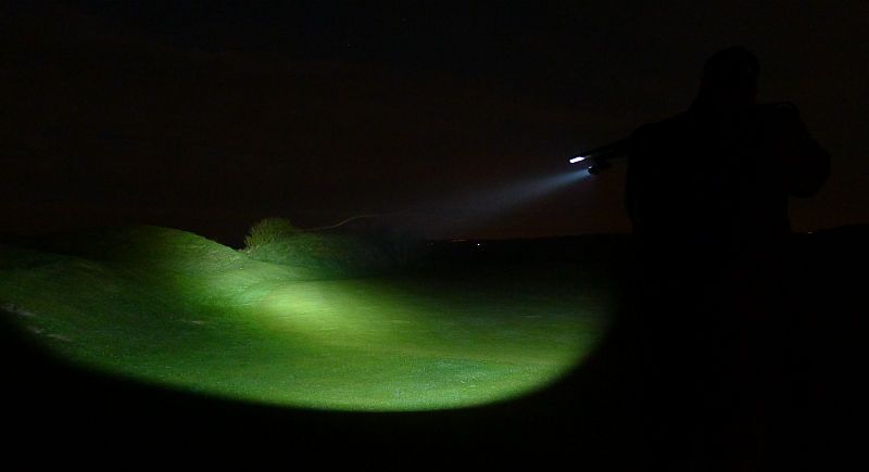

    Starting off with the rifle, you can see the spill light that hits the bottom of the sound moderator, but does not otherwise light up the shooter.

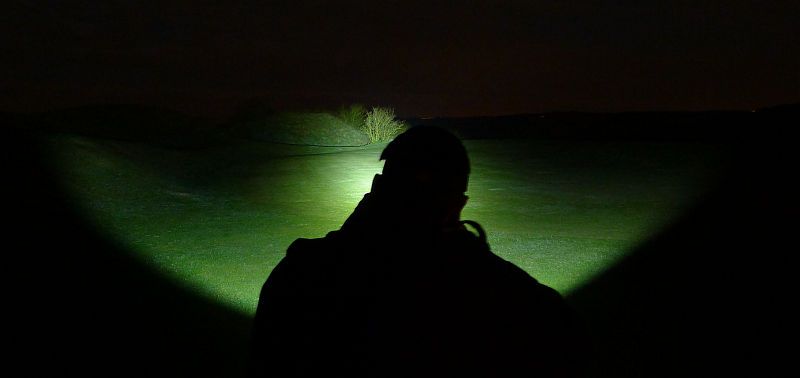

    Moving behind the shooter shows the brightly illuminate hotspot area which correlates very well with the 3-9x scope I use.
    Popping the red filter on does drastically reduce the overall output, but still provides plenty of light for targets within 50m. Using red light it is possible to get incredibly close to the quarry without seeming to notice you at all. A very useful addition. The lens in the filter is of excellent quality and colour. Of course there is the green and blue filter if you prefer these.

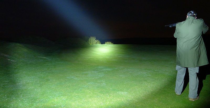

    Coming across an infestation, the 12g shotgun becomes the better choice (unfortunately due to the activity of the photo shoot, the quarry are nowhere to be seen here as they all took cover!). Here the shooting assistant is lighting up the killing field allowing the shooter free reign to acquire multiple targets and work efficiently.

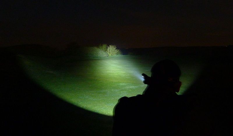

    As an alternative, the 12g is fitted out with the TK22. Its broader beam (which you can see lighting up the underneath of the barrel) providing a wide enough view to easily track running targets.
    Moving behind the shooter to show the wide field of view. The TK22 has over twice the output of the TK15, so is actually brighter than it appears here.

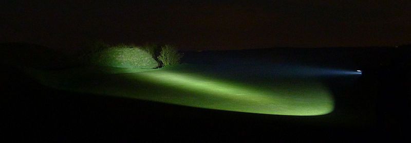

    Scanning the fields with the TK75.
