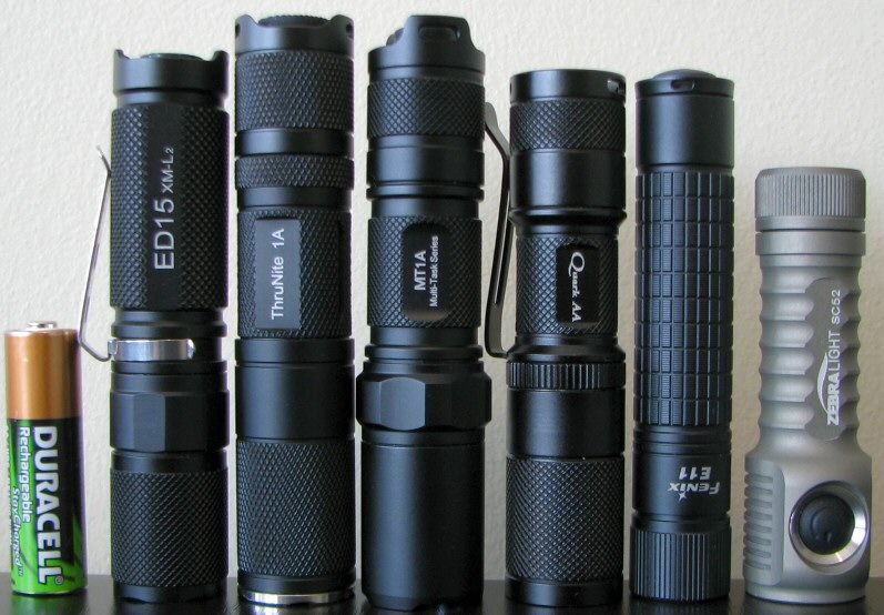

    From left to right: Duracell AA NiMH; Lumintop ED15; Thrunite Neutron 1A; Nitecore MT1A; Foursevens Quark QAA; Fenix E11; Zebralight SC52.
    Lumintop ED15: Weight: 59.7g, Length: 100.1mm, Width (bezel): 21.2mm
    Zebralight SC52: Weight 39.5g, Length 79.0mm, Width (bezel): 22.6mm, Width (max) 25.4mm
    Zebralight SC51: Weight: 37.4g, Length 80.5mm, Width (bezel) 21.1mm, Width (max): 22.6mm
    Nitecore MT1A: Weight: 54.6g, Length: 104.6mm, Width (bezel): 22.7mm
    Nitecore SENS AA: Weight: 26.1g, Length: 82.7mm, Width (bezel): 19.8mm
    Nitecore EZAA: Weight 20.9g, Length: 85.0mm, Width (bezel) 16.6mm
    Rofis ER12: Wright: 35.5g, Length: 96.2mm, Width (bezel): 18.6mm
    Tiablo E2A: Weight: 45.7g, Length: 101.2mm, Width (bezel): 19.9mm
    Xeno E03:: Weight: 48.1g, Length 96.7mm, Width (bezel): 21.5mm
    Xtar WK25B: Weight 42.9g, Length: 102.3mm, Width (bezel): 22.5mm

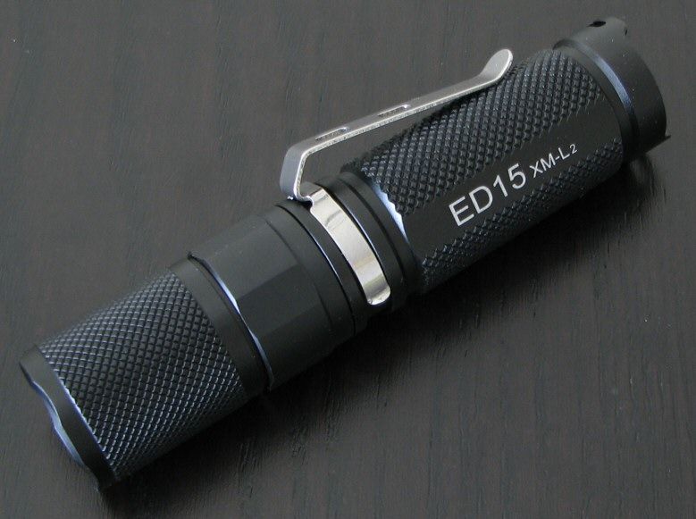

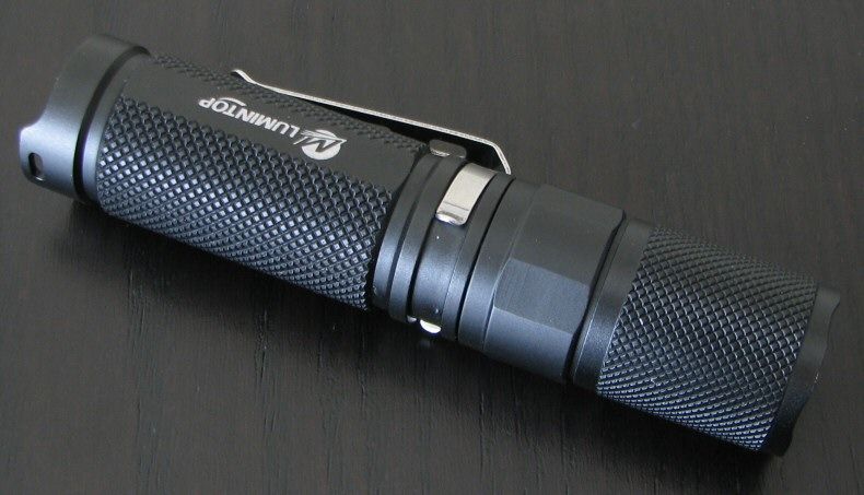

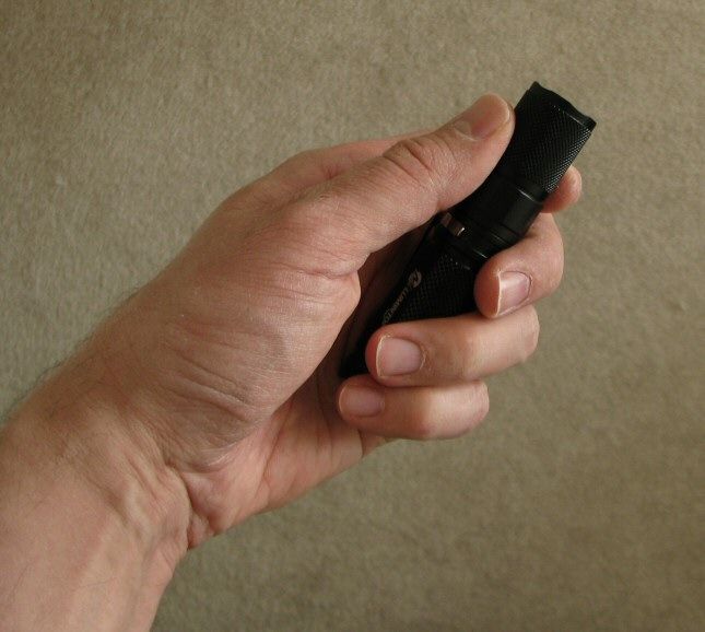

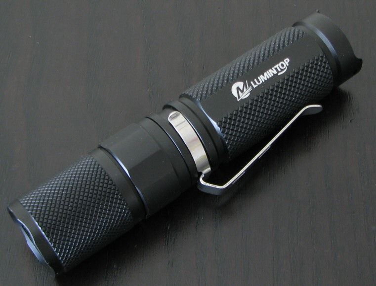

    Like the ED11, the ED15 is relatively compact for a 1xAA light with a clicky switch.
    The overall build is fairly solid, with a decent weight for the size. The ED15 features black anodizing (matte finish), with clear white labels. Although it does have a considerable amount of knurling on the head and body, it is not very aggressive. Especially with the pocket clip attached, I'd say grip is good.
    On that note, the pocket clip is of the clip-on style, and holds onto the light only as securely as typical for that style. It is reversible, so you carry the light in either orientation (although deep pocket carry isn't really possible).
    The tailcap features a reverse-clicky tail switch (i.e., click and release for the light to come on). Reverse clickies are typically low profile, facilitating tailstanding. There is a stylish shiny tailcap retaining ring at the base of the boot cover.
    Tailstanding is pretty good on my sample, although there does seem to be a slight instability due to the raised tailcap regions not being very wide. On the plus side, you can easily activate the switch with a thumb or finger, depending on how you plan to carry the light. There are split-ring/lanyard attachment holes on the side of the raised tail cap regions.

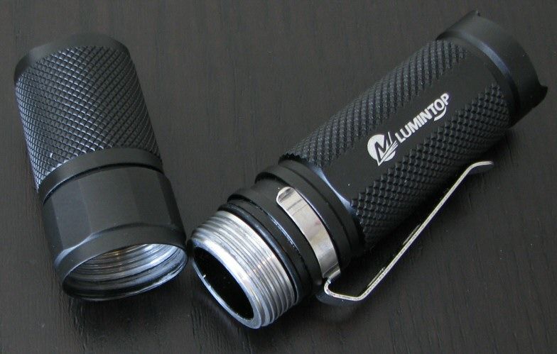

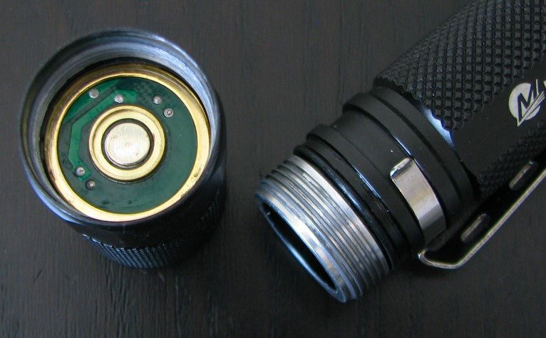

    Screw threads are standard triangular cut, and are in good shape on my sample. They are not anodized for lock-out, however, given how the interface works (scroll down for an explanation).
    The light has a slightly scalloped bezel, with a relatively smooth reflector. Although smooth, the reflector doesn't seem as shiny as most (i.e., perhaps a very fine texturing). It is also slightly deeper than most lights in this class (but that probably won't enhance throw too much, given its overall size). Cool white XM-L2 T6 emitter was not perfectly centered on my sample, but is not bad.

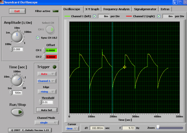

    Fast Strobe:
    Strobe is a standard "tactical" high frequency strobe, measured at 9.7 Hz.

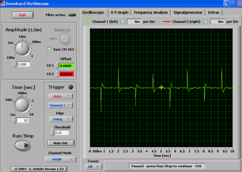

    Slow strobe is a one-second On pulse, followed by one-second Off, in repeating sequence
    Beacon:
    Beacon mode is a quick flash once every ~3.4 seconds.

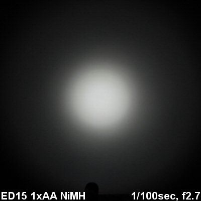

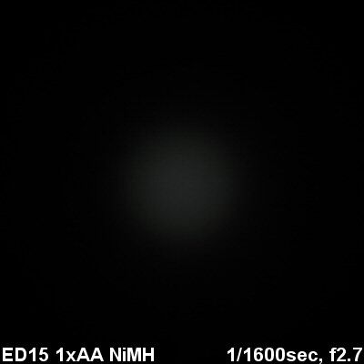

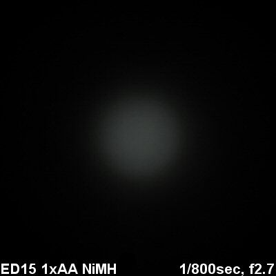

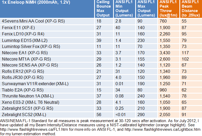

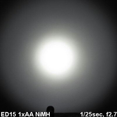

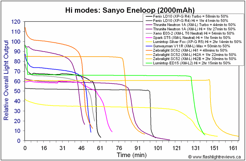

    All lights are on Max output on Sanyo Eneloop AA NiMH. Lights are about ~0.75 meter from a white wall (with the camera ~1.25 meters back from the wall). Automatic white balance on the camera, to minimize tint differences.
    Beam pattern is as you would expect for a XM-L2 light with this size reflector – a fairly big hotspot and decent sized spillbeam. It looks pretty similar to the other XM-L lights shown above. Scroll down for full output details in my tables.
    The output is quite good on 1xAA – pretty much the same as my Thrunite Neutron 1A. It is not driven as hard as the recent Zebtralight SC52, though. Similarly, throw is quite reasonable for the output level and size.
    What you can't tell above is that there is a timed step-down after 3 mins runtime – see my runtime graphs below for more info.
    Note that the ED15 does NOT support 1x14500 Li-ion 3.7V. You are likely to blow the circuit if you try.
    As an aside, the XM-L2 T6 emitter used here should perform equivalently to a XM-L U3 (given the change in the output bin numbering).

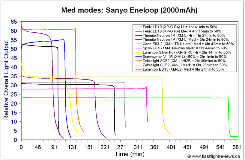

    Output/Runtime Comparison:
    Thanks to the timed step-down at 3 mins, the ED15 has excellent overall regulation and efficiency on Hi. It is also quite a good performer on Med. In fact, overall efficiency and runtime patterns on both levels – on all cells - seems quite similar to my Zebralight SC52, when matched for output.
    Not shown above, but I estimate the Med mode to be 30 lumens on NiMH. My estimate are thus very close to the official Lumintop ANSI FL-1 specs.
