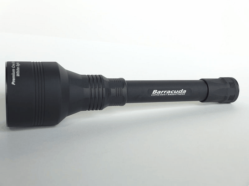

    Though ArmyTek's Predator is an excellent thrower, sometimes you want more, and in the Barracuda you get just that. With a large reflector optimised for the XM-L2 U3 LED that this current version comes with, the Barracuda has a very long reach.
    Initial Impressions:

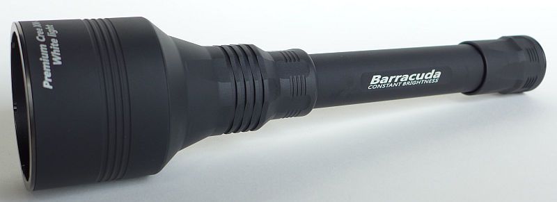

    The Barracuda sports the signature matt anodised surface of the original Predator and other Armytek lights. This finish feels different to standard smooth anodising and gives Armytek's lights a covert appearance. The finish seems to make the Barracuda feel less cold to touch and has good grip.
    Despite being powered by 18650s, just as the Predator is, the Barracuda's body feels surprisingly slender, yet still strong.
    The square shape of the head belies the true size and depth of the reflector which goes well into the stepped down portion of the head.
    The attention to detail is excellent and extends to touches like the inside of the holster has the metal popper covered so it does not scratch the Barracuda during use. The model and branding engraving is some of the sharpest I've seen, and overall finish is flawless.

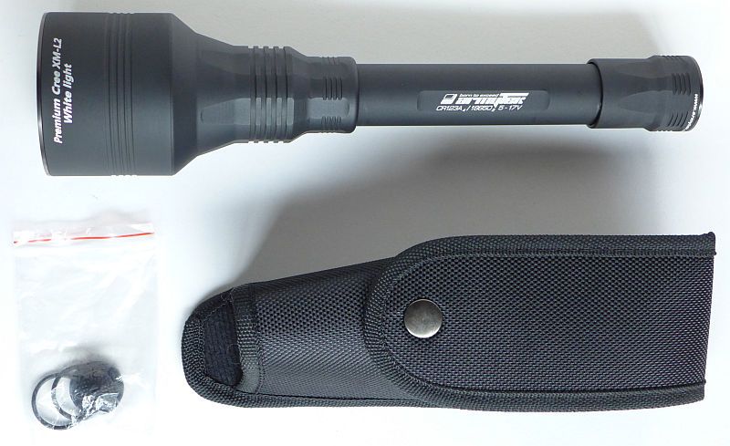

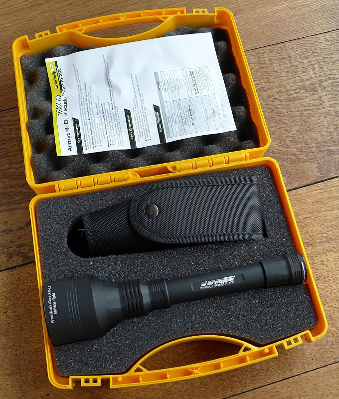

    What is in the box:
    The ArmyTek Barracuda arrives in plastic storage/carry case which is only just wide enough to accommodate the Barracuda's long but sleek design.
    The foam lining is cut to fit the Barracuda and holster.
    The Barracuda comes with a spare switch boot, two spare o-rings, a holster and the instructions.

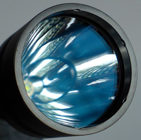

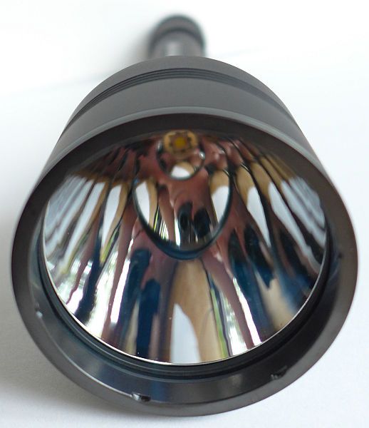

    The very deep reflector.
    The LED sits precisely at the base of the very deep reflector.
    The XM-L2 U3 LED, very precisely centred.

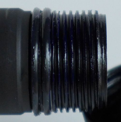

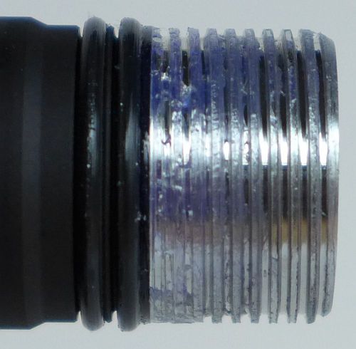

    At the head end of the battery tube the threads are bare aluminium. The threads have an almost fully square profile and double o-rings are used to seal the tube.
    At the tail-cap end the same, almost square thread profile is used, but they are anodised. Again double o-rings are used to ensure a very good seal.

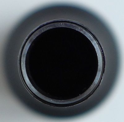

    Looking down onto the tube end, the profile looks quite thin, but this is only at the threaded part, the main battery tube is thicker.

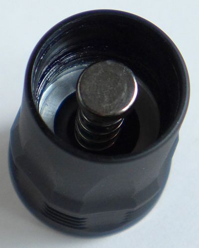

    The Barracuda uses a capped spring for the negative, just like the Predator has.
    The positive terminal is a spring, shown here with the battery tube removed. You can also see the circular contact used to detect the battery tube being tightened for mode changes.

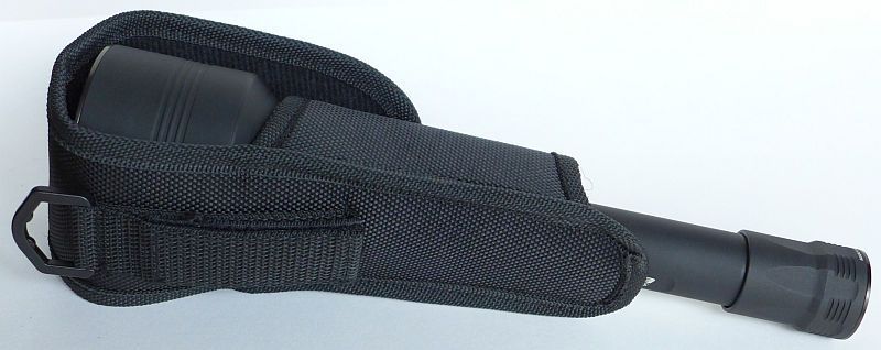

    Lastly a quick look at the holster. It is an open bottom design, so it takes up less space when the Barracuda is not in it. Attention to detail is good, with the inside surface of the popper is covered to prevent scratching. Many manufacturers do not bother to do this, but ArmyTek do.
    Looking at the back there is a d-ring and belt loop.

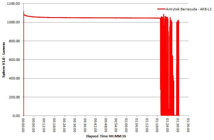

    The Barracuda uses output stabilisation just like the ArmyTek Predator's FULL stabilisation which maintains the specified output level without dropping at all until the battery can no longer maintain that output. At the end of this trace incredibly flat output trace you can see the Barracuda starts to flash when the battery voltage is getting low.

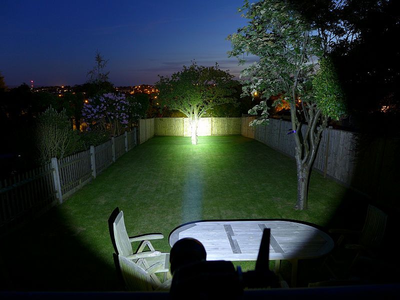

    Taking the Barracuda outdoors and with a longer range it really comes into its own. The narrow spill helps to underline the extreme range the Barracuda is capable of reaching. Like a hand-held spotlight, at longer ranges the spill fades and the circular hotspot lights up the target.
    With the flat runtime trace shown earlier the output of the Barracuda does not fade. You get full output as long as the batteries can manage it so this means the beam's reach does not become any less effective even if the batteries are only half full.
