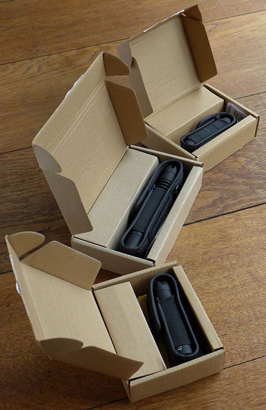

    On test are all six of the Partner models. The A2, A1 and C1 come in both XP-G and XM-L emitter versions, so in this section I will take a quick look at only once at the A2, A1, and C1.
    Being Pre-production samples, ArmyTek stated that these boxes were not the final version.
    Looking inside, I suspect it is only missing the final printing on the box as each light is presented well with a section of the box holding the accessories supplied.

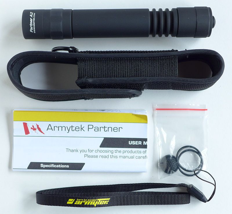

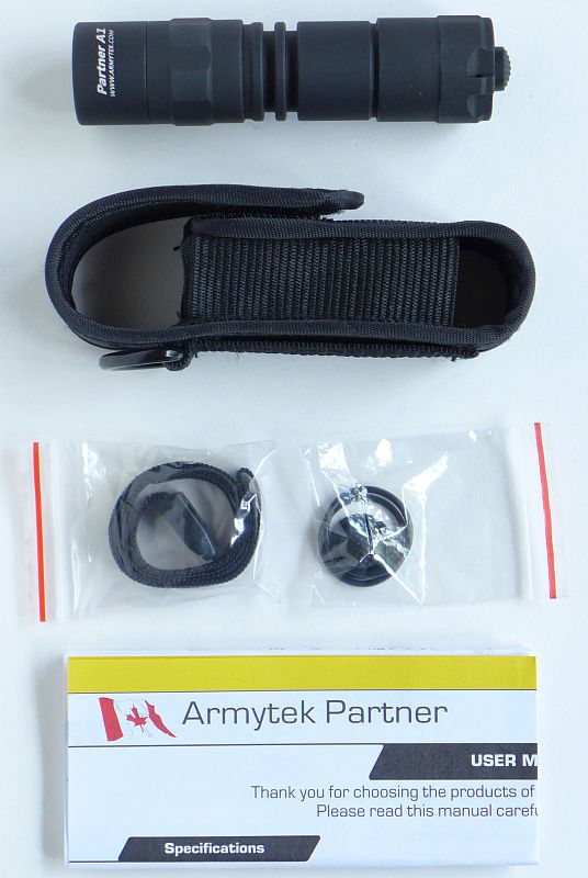

    Starting with the largest, the A2, it comes with a holster, strap, spare switch boot and o-ring and a set of instructions.
    The A1 with its holster, strap, spare switch boot and o-ring and a set of instructions.
    And lastly the C1 with its holster, strap, spare switch boot and o-ring and a set of instructions.

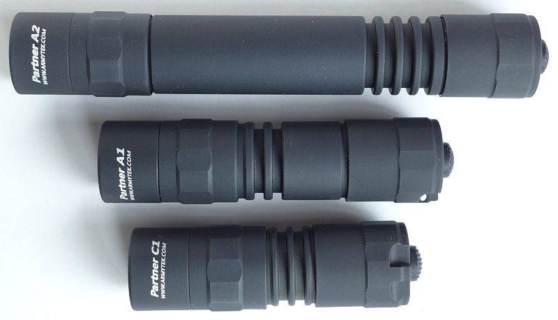

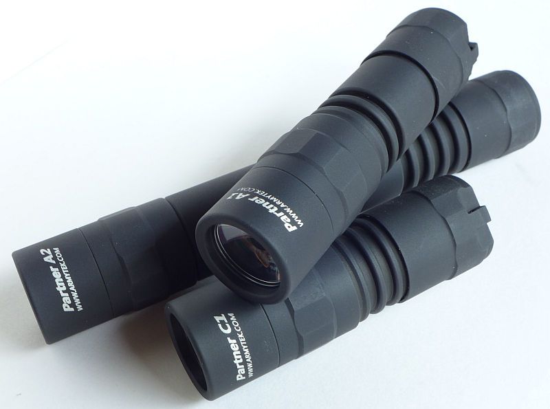

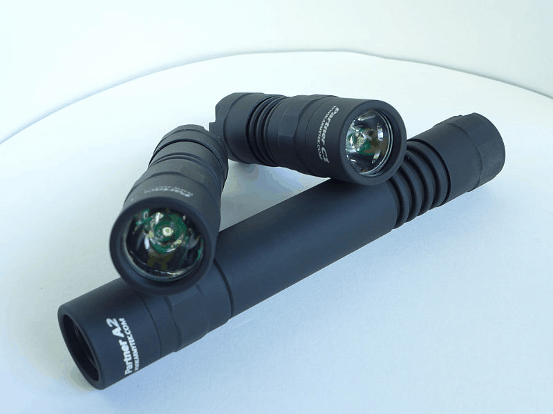

    The three different sizes of Partner shown side-by-side. As you can see they share components, the main difference being the battery tube and holster.

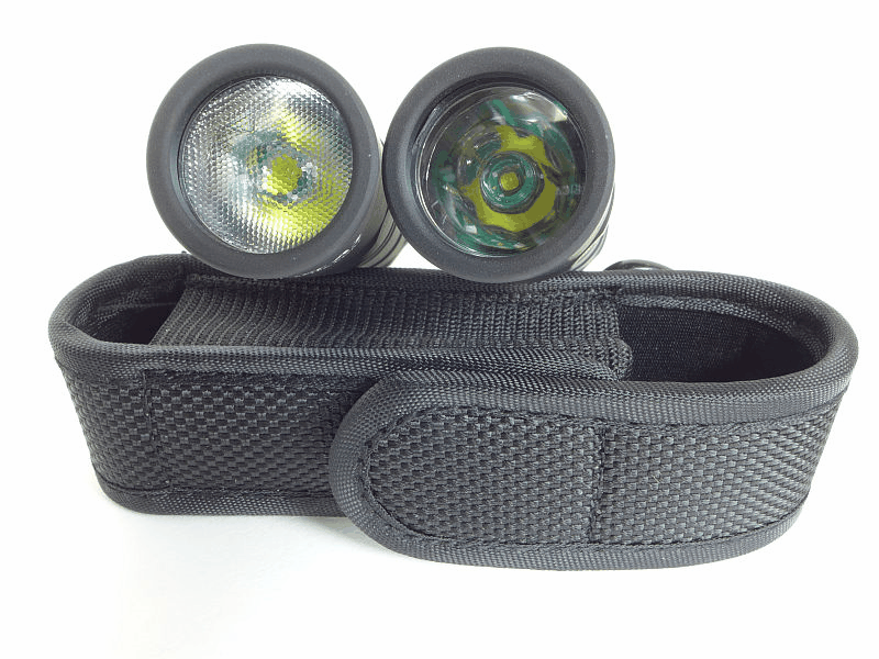

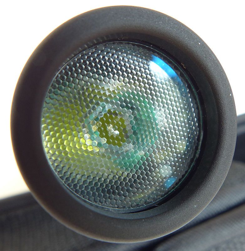

    The Partner XP-G and XM-L versions use different optics, designed to suit the emitter in use. Neither version uses a reflector, instead using TIR (Total Internal Reflection) optics.
    Looking at the XP-G optic from an angle you can see the central hole in the optic and a hint of the anit-reflective coating on the glass lens that protects the plastic optic.
    Moving to the front of the XP-G version's optic and you can see how the surface of the optic is reflecting the yellow colour of the LED's phosphor coating.
    The XM-L optic is something else! The outermost layer is the same coated glass lens, but for the XM-L version, there is a honeycomb optic diffuser sitting in front of the TIR optic giving the lens a very distinctive and unusual look.
    Looking at the lenses side by side, there is no mistaking the XP-G and XM-L versions.

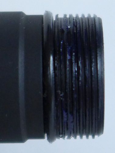

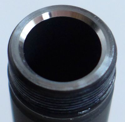

    The Partners use almost square threads and a single o-ring . The threads are fully anodised providing lockout should you need this.
    The positive terminal is a robust metal pad.

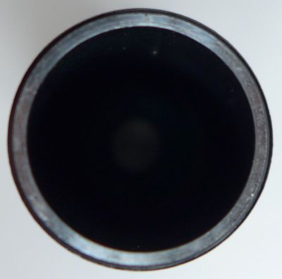

    With the CR123 cell being a larger diameter, the C1's battery tube wall is thinner, but still strong.

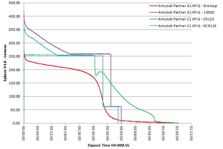

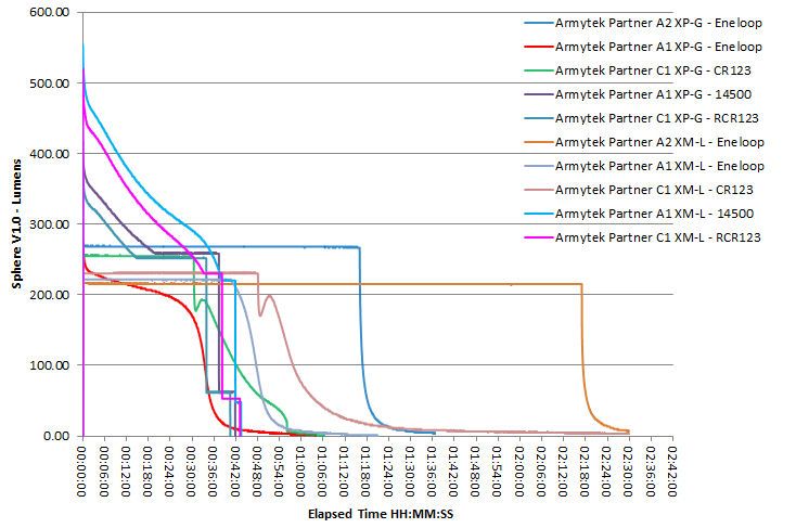

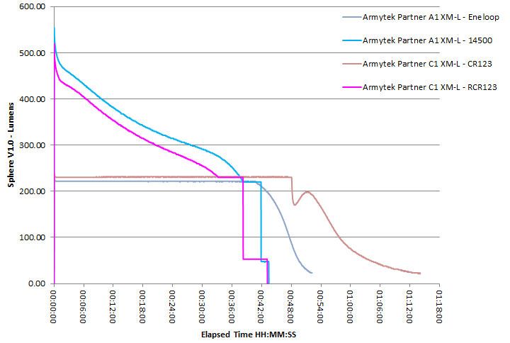

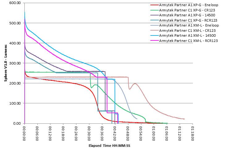

    The Partners all use output stabilisation similar to the ArmyTek Predator's FULL stabilisation which maintains the specified output level without dropping at all until the battery can no longer maintain that output. At the end of this incredibly flat output trace you can see the output drop sharply but does not cut off completely when the battery voltage is getting low.
    However, when the A1 and C1 are used with li-ion they jump well above the stabilised output level so initially the output does not appear regulated at all. The following output traces will explain further.
    In this first graph all of the Partner models are shown, but they are only running on standard AA rechargeable or primary battery types. This is how ArmyTek originally specified the usable power sources.
    Here the A1 XP-G is the odd one out as running on only 1 AA cell and with a higher initial output than the XM-L model, it struggles to keep the output steady.
    Next we simply add in the li-ion output traces for the A1 and C1 XP-G and XM-L models. Due to the A2 XM-L output being the longest, the other traces are somewhat compressed.
    Taking the A2 out of the picture the other output traces are easier to see.
    Then for better comparison of the XP-G models running on standard and li-ion cells they are shown on their own.
    And the same with the XM-L models.

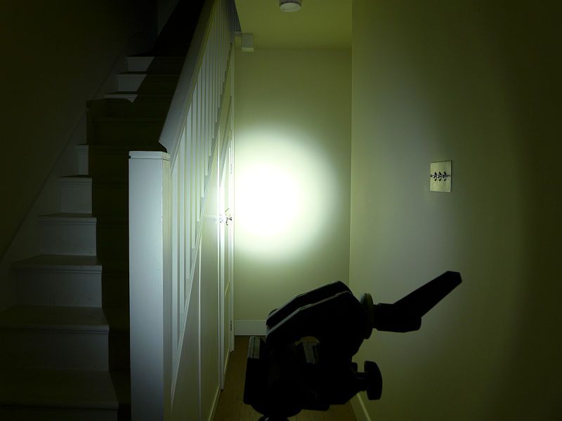

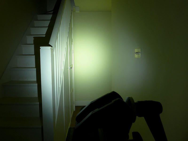

    The beam of the XM-L model has a real flood light profile thanks to the larger emitter and diffuser. For indoor use, this is my ideal beam format. An excellent soft spread of light, with a smooth tapering hotspot spreading into a wide and bright spill.
    This type of beam is perfect for indoor use making it easy on the eyes and giving you a wide field of vision.
    While looking at the Partner A2 XM-L's beam, I need to point out a 'feature' which, though not a problem at all when using it, is something you should know before buying it.
    Thanks to a combination of the large square emitter, the TIR optic and the honeycomb diffuser, the spill can appear square rather than round.
    I have purposely photographed this effect in a way that enhances its visibility and combined two photographs rotated at 45 degrees to each other. If you look back at the previous beamshot, you may now notice the square shape of the outer spill.
    Though you can see this during normal use, it is not a problem at all. In fact the beam of the Partner XM-L is a very easy beam to get on with.
