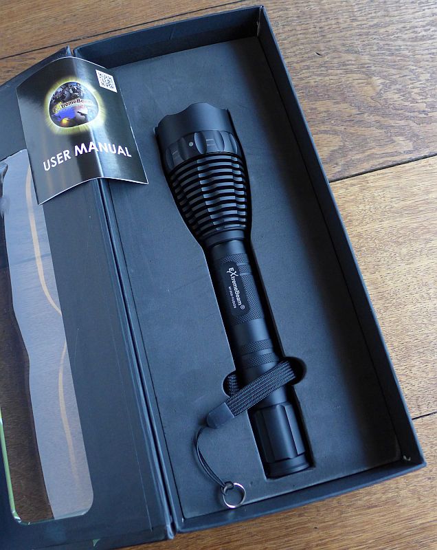

    The M1000 arrives in a sturdy box. The clear window had a tear off protector film when it arrived.
    Opening the flap, the M1000 is held in a dense closed cell foam tray.

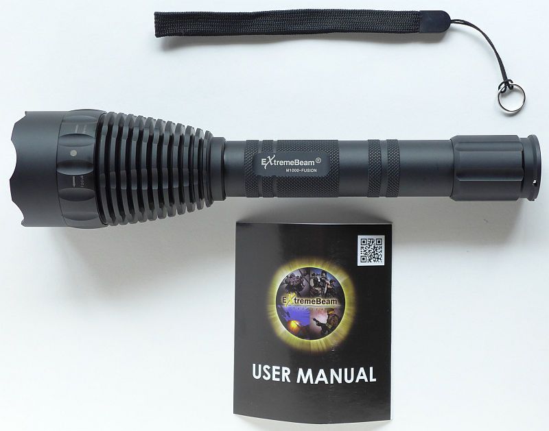

    As well as the M1000 light, there is a wrist strap and generic ExtremeBeam manual. (no spares are provided)

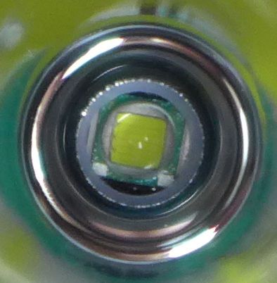

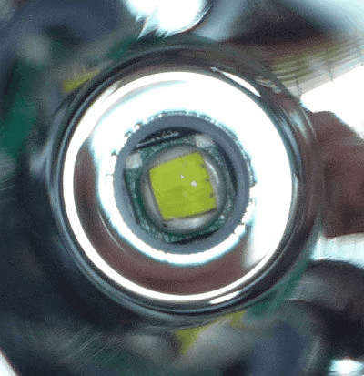

    Looking straight into the reflector and at the XM-L U2 emitter.
    And even closer.

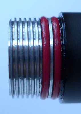

    The threads on the head end of the battery tube are bare aluminium and a heavy square cut thread. Double o-rings are used to seal the join.
    The tail-cap end of the tube has anodised threads allowing you to lock out the tail-cap should you wish to. Again double o-rings are used.

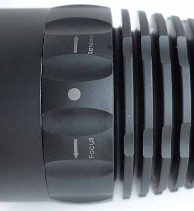

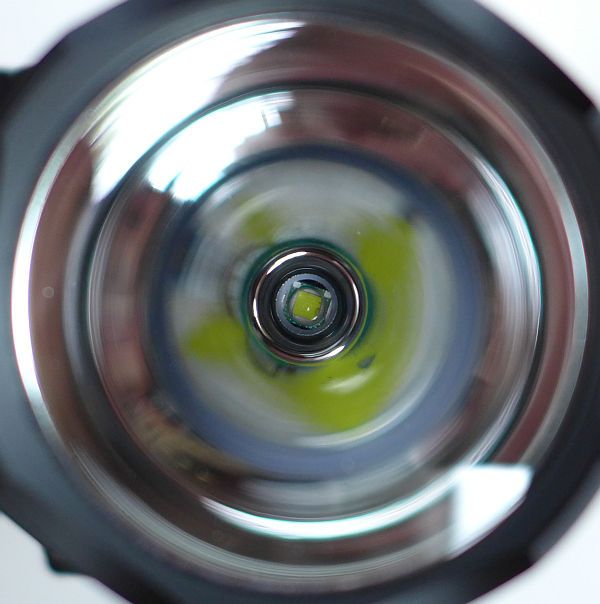

    Just back from the bezel is the focus ring. This can be unscrewed to move the reflector forward from the LED and defocus the beam. As you loosen the head, even if you expose the first o-ring, there is a second one to keep it watertight.
    The effect of adjusting the focus ring is to move the reflector forward of the LED, so the LED is no longer in the focal point of the reflector. Looking closely you can see the LED appear to move backwards.

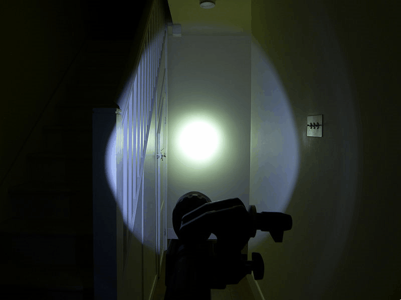

    In the tight focus/thrower position, what you have is a large reflector with the LED positioned precisely at the focal point of the reflector providing the best focus of the beam and none of the losses associated with an adjustable focus. So in this position you have an well executed thrower design.
    Then as a bonus feature, the M1000 has been designed to allow the entire reflector to be moved forward to take the LED out of the optimum focus and spread the beam. As shown in the previous sections the effect is to move the LED back out of the reflector slightly. This of course means that some of the LED's light is lost behind the reflector (as shown in the output figures) and provides a less refined beam slightly reminiscent of the old Maglite unfocussed beam.
    Don't forget though that what you have is an optimised thrower with the built-in facility to spread the beam if you need a wider area light. If you don't like the wider beam, don't use it, but the facility is there without adding a diffuser or having to have a second light.
    So the M1000 is a master of the thrower beam and an apprentice of the flood beam.

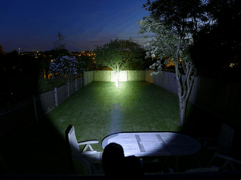

    Starting off indoors, this image shows the difference between the tight focus and wide focus configurations.
    Moving outside for a bit more distance, again switching between tight and wide focus.
