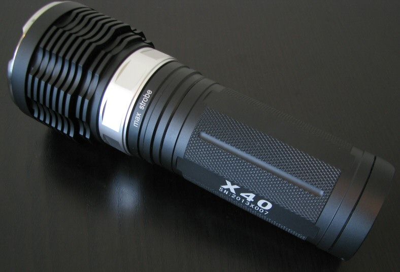

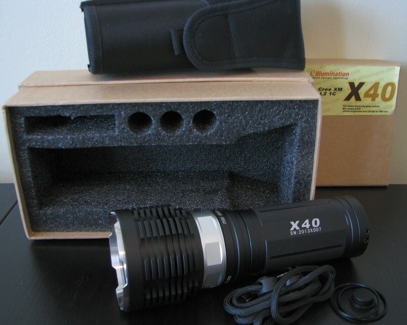

    My X40 came in a hard cardboard box with cut-out packing foam. Along with the light was a good quality lanyard, belt holster with closing flap, extra o-rings, spare tail switch boot cover, USB charging cable with AC adapter and DC car adapter. The manual wasn't ready when the light was shipped to me, but I was supplied with an electronic copy.

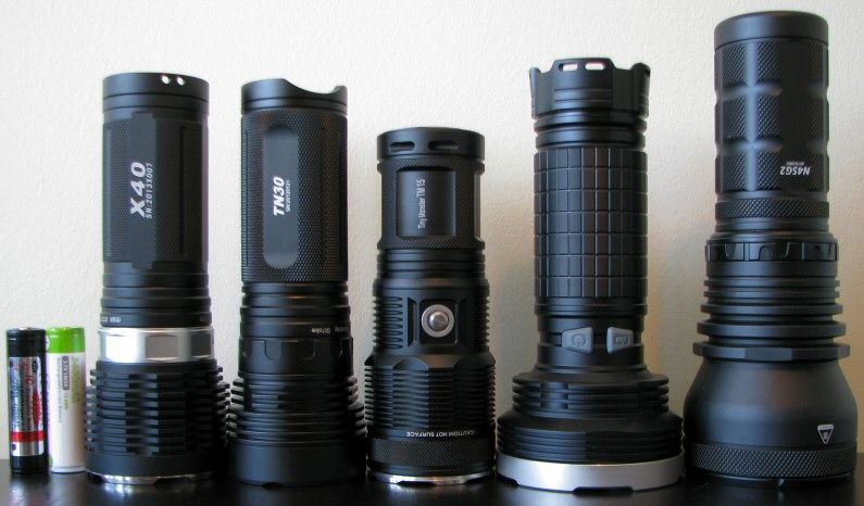

    From left to right: AW Protected 18650; Eagletac Protected 3400mAh; L3 X40; Thrunite TN30; Nitecore TM15; Fenix TK75; Niwalker BK-FA02.
    All dimensions are directly measured, and given with no batteries installed:
    L3 Illumination X40: Weight: 517.2g (~655g with 3x18650), Length: 182mm, Width (bezel): 68.0mm
    Fenix TK75: Weight: 516.0g (~700g with 4x18650), Length: 184mm, Width (bezel): 87.5mm
    Nitecore TM15: Weight: 450.6g (~634g with 4x18650). Length: 158mm, Width (bezel): 59.5mm
    Nitecore TM11: Weight: 342.6g (~526g with 8xCR123A), Length 135.3mm, Width (bezel): 59.5mm
    Sunwayman T60CS: Weight: 338.9g (~477g with 3x18650), Length: 145.0mm, Width (bezel): 60.0mm
    Thrunite TN30: Weight: 468.2g (~620g with 3x18650), Length: 179mm, Width (bezel): 64.3mm, Width (tailcap): 49.0mm
    Xtar S1 Production: Weight: 876.0g (~1028g with 3x18650 protected), Length: 240mm, Width (bezel): 83.4mm
    Olight SR92: Weight: 1.15 kg (with battery pack), Length: 271mm, Width (bezel): 98mm

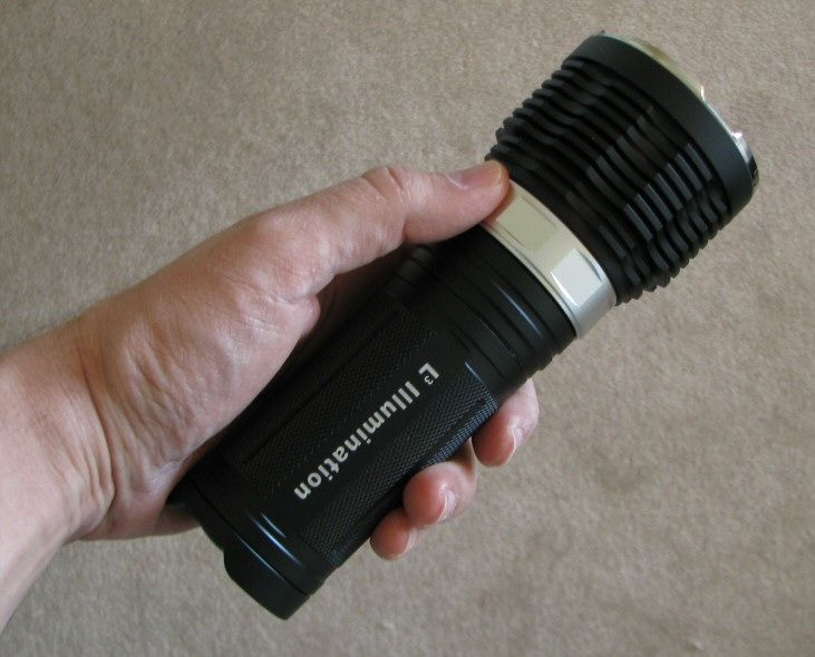

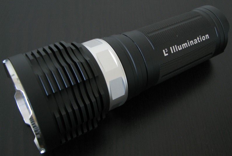

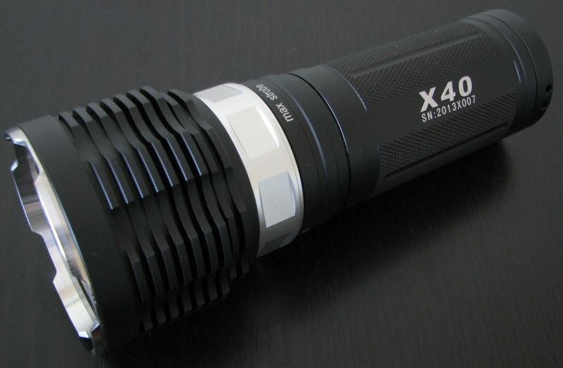

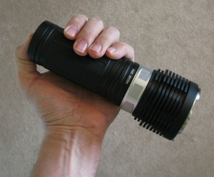

    The overall size and weight of the X40 is in keeping with other lights of this class. Note there is a lot of variation in the class, depending on what features you are looking for.
    The X40 build is probably most reminiscent of the Thrunite TN30, although with a more distinctive control ring (more on that in a moment). Anodizing is a flat black, and seems to be in very good shape on my sample. Labels are sharp and clear, and include a serial number.
    Knurling is present over most of the handle, and is of fairly high aggressiveness. Combined with the control ring flats and heatsink fins in the head, I would say overall grip is pretty good. Light can roll fairly easily, but the indented flats in the head help limit that somewhat.

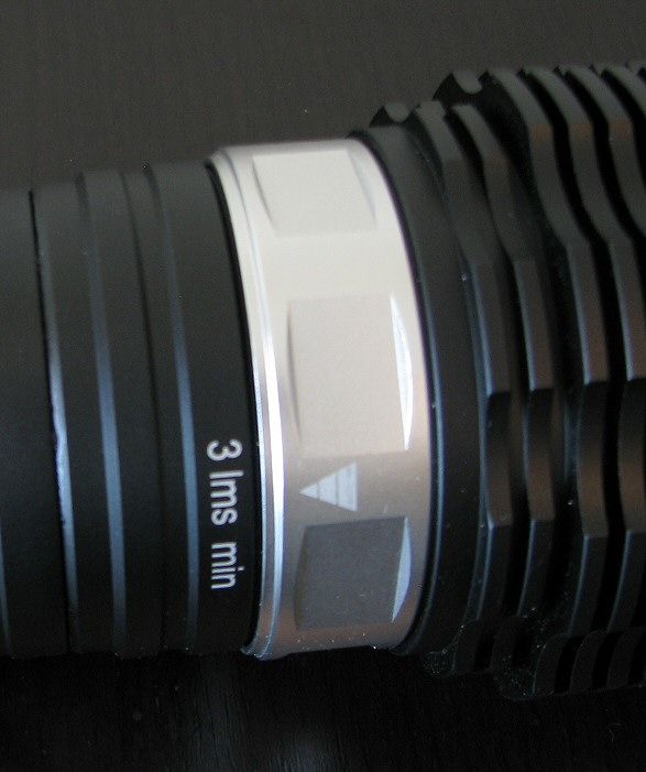

    There are flat indents on the control ring to help with feel. There is a label mark on the control ring that lines up with the labels on the head. Going clockwise, the output modes are min output "3 lms" (first detent), lowest level of the continuously-variable ramp (second detent), output ramp, "max" output (third detent) and "strobe" (fourth detent). The detents are firm at each level, with even resistance across the ramp area.
    Screw threads are traditional triangular cut, but seem of good quality.

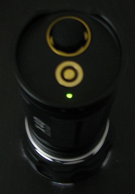

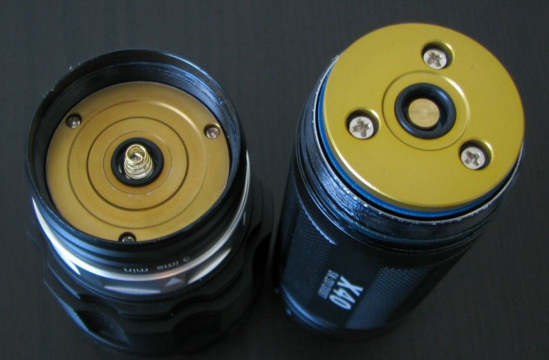

    The light can tailstand stably, and the tailcap cut-outs facilitate access to the switch. Switch is a forward clicky switch (i.e., press for momentary, click for locked-on). Switch feel has a slightly longer traverse than typical, with a definite click. There is a charging dock in the tail that connects to the supplied USB-cable. See below for a discussion.
    There is also a small LED indicator. It is green when the light is on and the batteries well charged (or, when charging, if the batteries are fully charged). It is orange when on and the batteries are <50% power. It is red when on and the batteries are <30% (or when batteries are being charged), and flashing red when the on and the batteries are <10%.

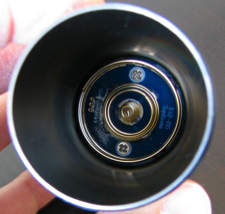

    There is a triple set of springs in the base, in addition to the spring in the head. The extra set of springs in the tail is obviously required for the charging feature. FYI, I notice the contact board says SupBeam X40 …

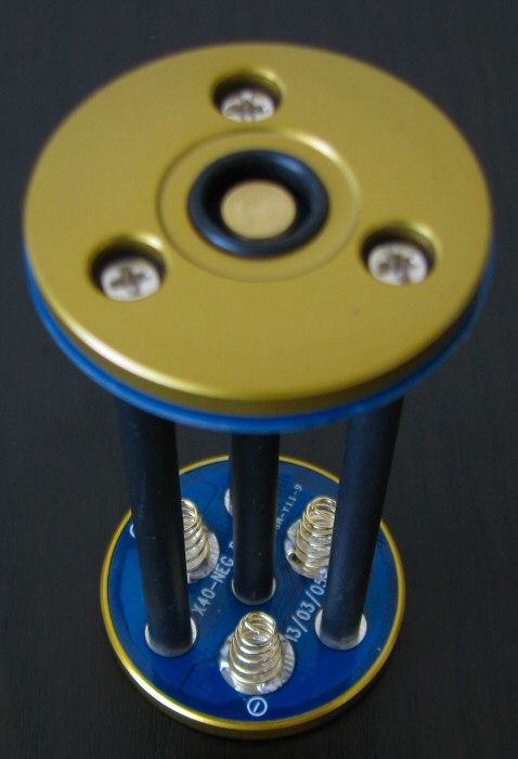

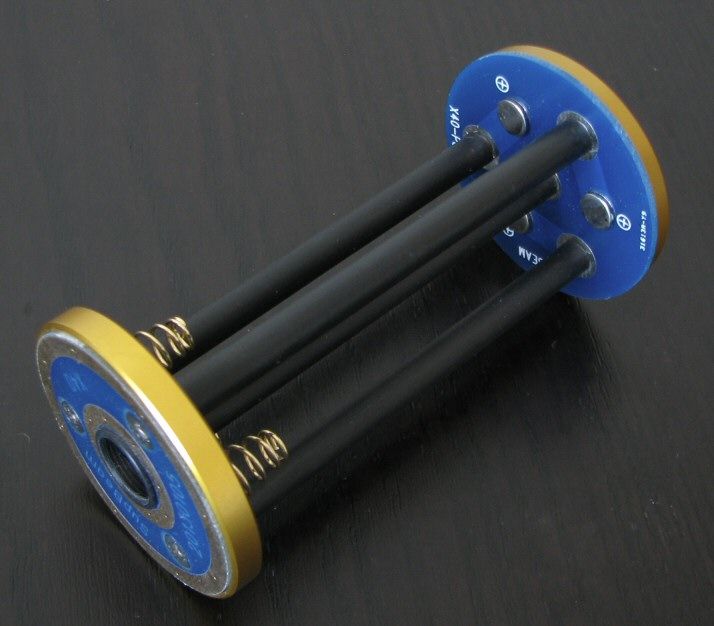

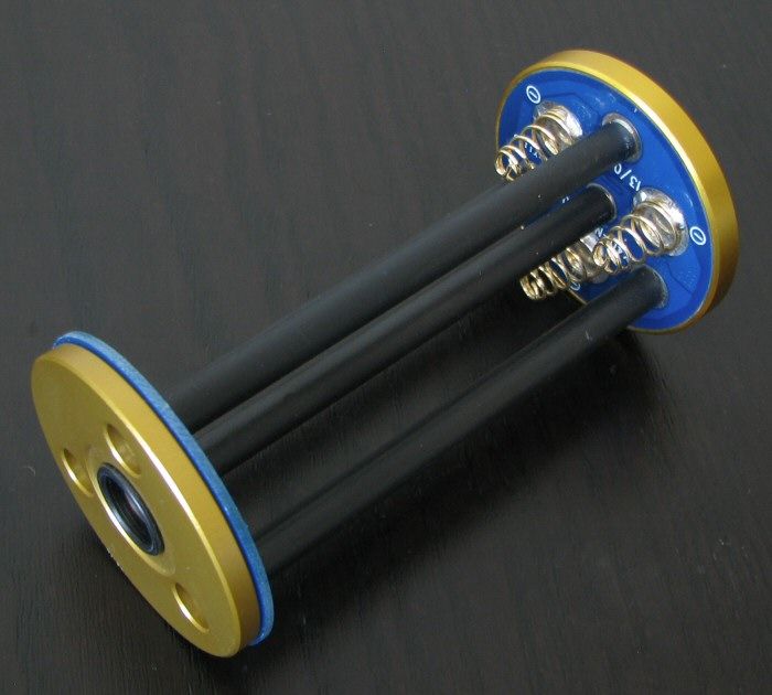

    Let's take a closer look at the battery carrier:

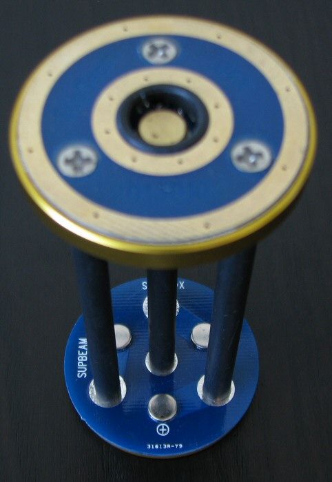

    There is a metal battery carrier that holds 3x 18650 cells. The positive contact points inside the carrier are slightly raised, so all types of 18650 cells should work fine (i.e., true flat-tops, wide and small button-tops). Longer cells may be a bit tight with the base springs, but my protected 3100mAh cells all fit (although some wider cells may make it harder to fit the loaded carrier back into the handle). Unlike other carriers, all the cells point the same way here (i.e., negative terminals at the base, positive terminals toward the head). The carrier is a 3s arrangement (i.e., all cells in series, not parallel).
    The carrier only functions one way, with the contact board facing the springs in the tailcap. The inner-most positive contact of the carrier is recessed at both ends, and there is a large metal plate at the carrier end that contacts toward the head. Note that the negative current path is carried by the body of the light. The positive path connects through the spring in the head unit.
    Note that CR123A are not supported – the X40 is 3x18650 only.

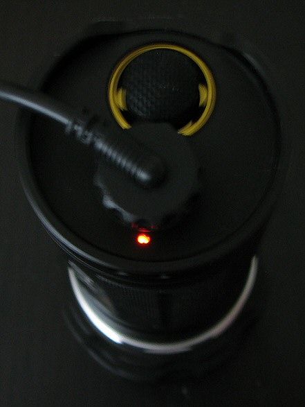

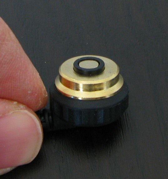

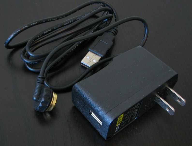

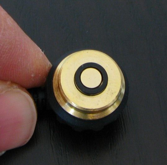

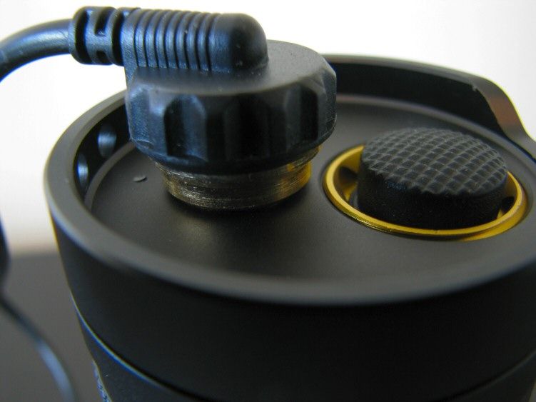

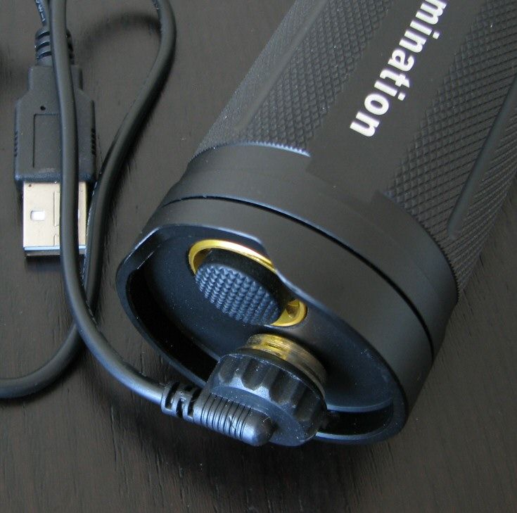

    The charging dock is interesting. Like the Klarus RS11 (which this charging solution resembles), the dock is magnetic and there is no open voltage at the tail (i.e., no risk of shorting when cells are loaded). What you see at the exterior base are two metal circular contacts – these are connected to the terminals of the carrier through the springs. The charging cable directly attaches to the external contacts through a strong magnetic connection, just like the Klarus RS11.

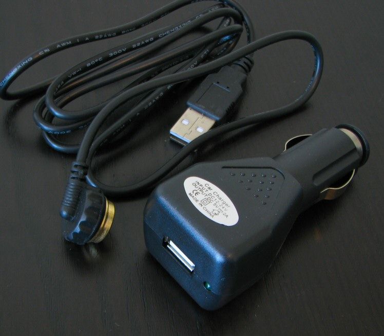

    Both AC and 12V DC adapters were provided on my sample.
    Because of the strong magnetic pull of the charging cable head (i.e., it will attach itself to anything made of metal), I recommend you connect the head to the flashlight BEFORE you connect the USB end to your computer or an AC power adapter. The reason for this is that when the USB end is plugged in to a power source, I can measure an open voltage at the charger head. Should the magnetic head of the cable then attract a nearby piece of metal, you could potentially short out your USB port (or worse, your AC outlet).
    The risk of this is probably fairly low, as there is a raised plastic divider separating the inner and outer contacts on the charging cable to prevent this from happening (i.e., see the pic above with the paperclip). So on a perfectly flat metal surface, you should be fine. But given that the magnet is fairly strong, I wouldn't want to trust that tiny bit of plastic to rule out the potential for even a momentary short. You are better off making sure the magnetic end makes contact before the USB end does.
    Using the AC adapter, charging time was a little under 6 hours for fully-drained AW protected 2200mAh cells. The charging rate was longer on just a USB (2.0) port - it took just under 9 hours to full charge my 2200mAh AW cells from the tripped state. This rate seems rather high for me for a standard USB port, so I recommend use of the adapter. I would expect it to take longer for higher capacity cells. Resting voltages for the cells (once the indicator went green) were ~4.15-4.17V, which is quite reasonable.

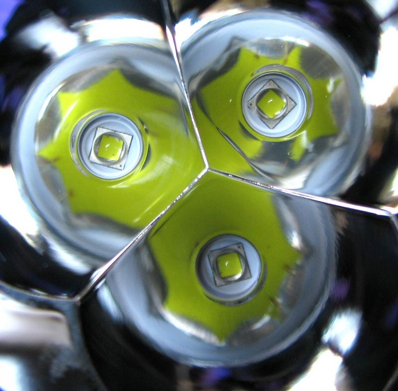

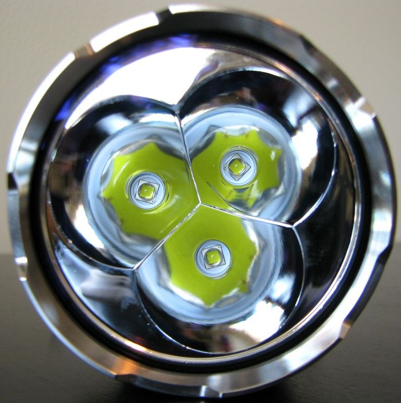

    The X40's reflector has relatively deep emitter wells, overlapping a significant amount in the middle. Although there is no such thing as a "typical" tri-head structure, this seems pretty close to the average of the various heads I've seen. The reflector appears to be in excellent shape on my sample, very smooth, with three reasonably well-centered XM-L2 U2 cool white emitters.
    The overall impression of the build is that this is a quality light. It is at least on par with my Thrunite TN-series lights.
    Turn the light off/on by the tailcap clicky – press for momentary, press and release (i.e., click) for constant on.
    Change output modes by turning the control ring in the head. Arranged from clockwise/left-to-right (looking down at the light, held in traditional flashlight carry), the modes are detent 1 (moonlight) > detent 2 (lowest level of the ramp) > continusouly-variable ramp > detent 3 (max) > detent 4 (strobe).
    Note that there is no standby mode – light is always produced when clicked on.

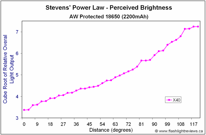

    The X40's "continuously-variable" ramp is actually composed of a series of discrete steps. Technically, all "continuously-variable" ramps actually have discrete steps – it is just a question of how many there are, and can you notice them. It is hard for me to give a precise number, but I would say there are at least ~25-30 discrete levels in this case.
    The raw data coming out my lightbox (above) doesn't actually give you a good feel for how "visually linear" the X40 is. For that, I have plotted the results on a cube root scale, based on modern perceptual research that shows we actually perceive non-point sources of light according to this power relationship:
    The X40 ramp looks very linear to my eyes.

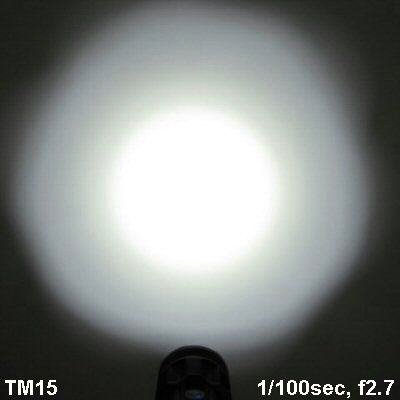

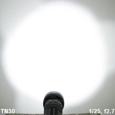

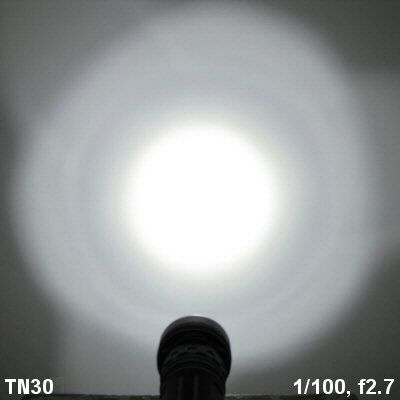

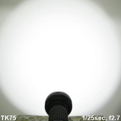

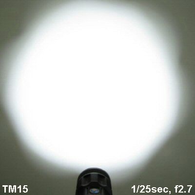

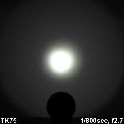

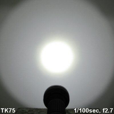

    And now, what you have all been waiting for. All lights are on their respective max rechargeable battery sources (i.e., 18650s), about ~0.75 meter from a white wall (with the camera ~1.25 meters back from the wall). Automatic white balance on the camera, to minimize tint differences.

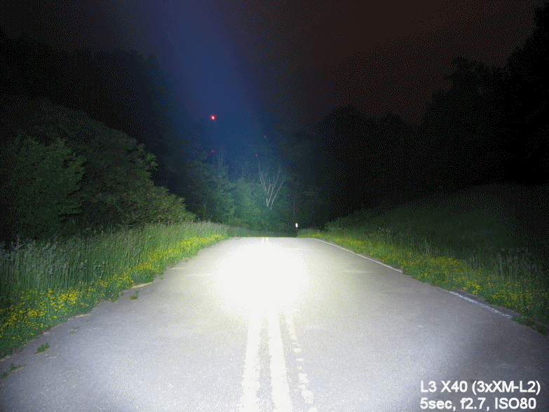

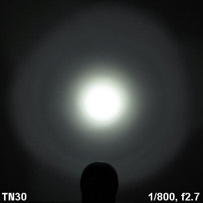

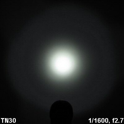

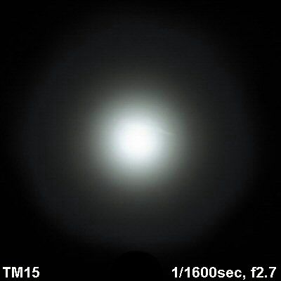

    The X40 definitely has an impressive output level on max. Beam pattern is about "typical" for a tri-head (overlapping well) reflector design – you get reasonable throw, with a lot of artifacts in the spillbeam. It is a bit more focused for throw than the Thrunite TN30.

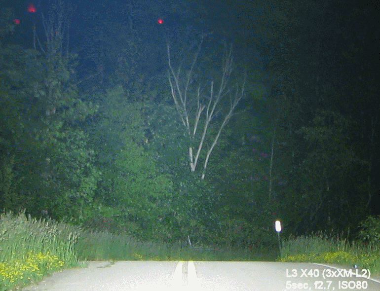

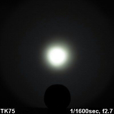

    For outdoor beamshots, these are all done in the style of my earlier 100-yard round-up review. Please see that thread for a discussion of the topography (i.e. the road dips in the distance, to better show you the corona in the mid-ground).
    FYI, any "streaks" you see across the images are bug-trails. Flying insects are often attracted to the bright lights, and their flight trails get captured as swirly streaks due to the long exposure time.
    Sorry, the MX25L2 should say "SST-90", not XM-L2 above. :shhh:
    Again, despite the slightly variable positioning, you should be able to tell that the X40 has a slightly more focused hotspot over the TN30. Overall output is a touch higher as well, although the difference isn't huge.
    Max output of the X40 is quite high – it is slightly higher than my Thrunite TN30 - which makes the X40 the current output champ among my 3x emitter lights. Throw is also somewhat higher on the X40 compared to the TN30, as you could also tell from the beamshots.
    The official specs for the X40 seem a little inflated, for both output and throw. But as always, my output lumen estimates are just that – estimates based on all the lights in my collection. So while I can make no claim to their absolute accuracy, you can trust the relative comparison between lights. Note that my throw measures are direct measures, based on a NIST-certified light meter, and taken under ANSI FL-1 strandard testing conditions (or at least, as close as I can provide).

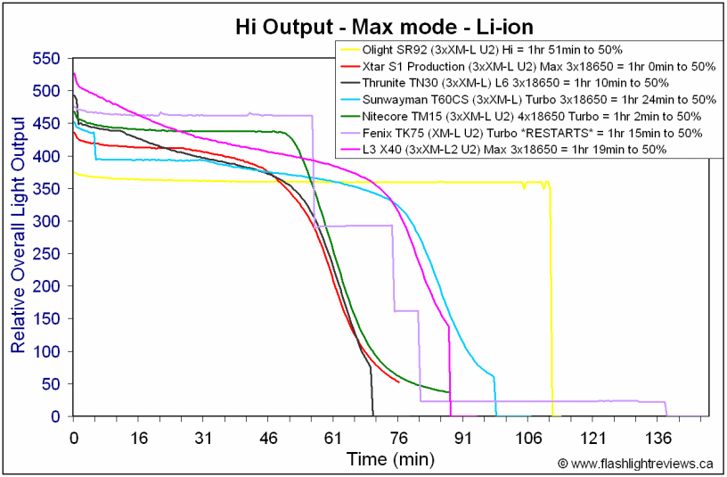

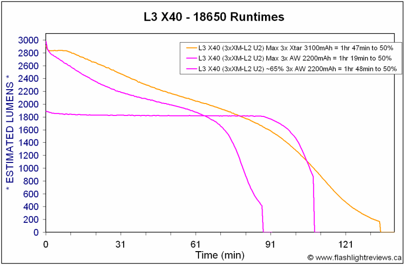

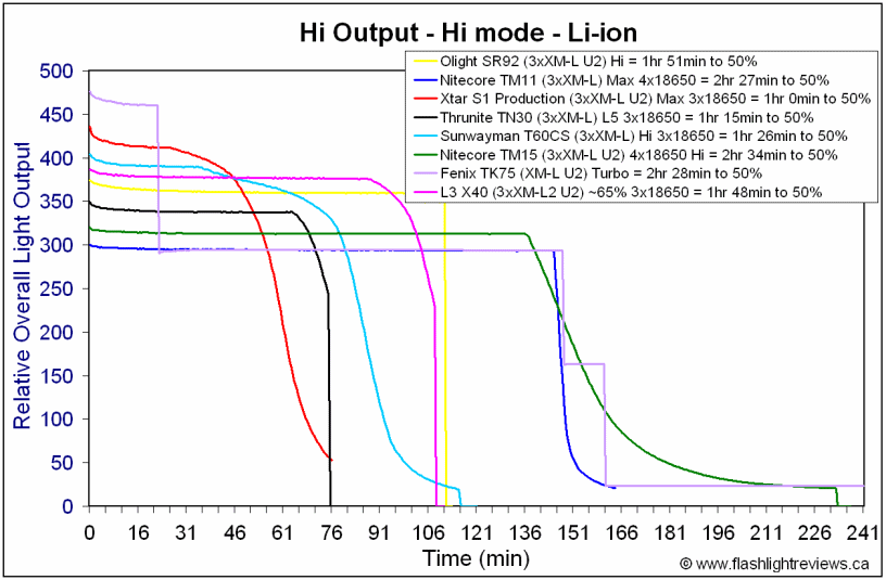

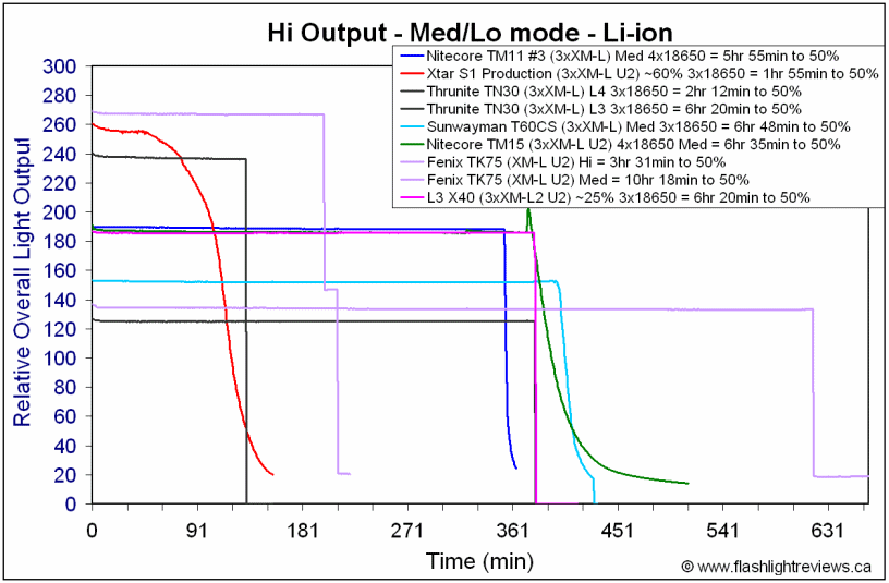

    Output/Runtime Comparison:
    Note: All my standard 18650 runtimes are done using AW protected 2200mAh.
    On max, the light appears to be largely direct-drive – but that depends somewhat on the actual 18650 cells used. As you can see above, my 3100mAh cells were able to maintain a relatively stable output for about 10-15mins, before dropping off in a direct-drive-like way. At lower outputs, the light maintains flat regulation for an extended period (on all cells).
    The X40 shows very good overall output/runtime efficiency, at all levels tested. This is again consistent with good current-controlled circuit. But it is all the more impressive when you consider the extended range of outputs available through the ramp.
    Unlike some of the competition, the X40 doesn't support CR123A or RCR (i.e., 18650 only). But it is not inconsistent to find 18650-only lights in this class.

    The magnetic charging cable worked well in my testing, with no open voltage reading at the tailcap (i.e., no apparent risk of shorting your battery inside the light). However, there is at least a potential risk of shorting your USB port (or worse, an AC outlet if using an adapter) if you don't connect the magnetic end of the cable to the light first (as the magnetic connector of the cable strongly attracts nearby metal). To negate this risk, there is a raised plastic divider on the cable head to seperate the inner and outer ports. You should be fine, but I recommend you keep this point in mind.

    Charging time was a little under 6 hours for fully-drained AW protected 2200mAh cells. I would expect it to take longer for higher capacity cells. Note that using the AC adapter makes no difference – it doesn't charge any faster of AC power than it does off USB (which limits you to 500mA).
    I think with USB 3.0, the limit has been raised to 900 mA. I don't know what this could mean for future USB-powered chargers though, but I'm sure the flashlight / battery industry won't keep us in the dark (!) much longer.
    The link takes you to the result page of a Google search of "USB 3.0 900 mA"
    http://goo.gl/TpsEZ

    I am somewhat confused here. The X40 charges the 3 cells in PARALLEL, not in series. As a result the actual charge current (and draw from the USB port) is up to 1500ma. I am not sure how many USB ports can support 1500ma. The AC adapter is rated for 2 amp output, and with the AC adapter the charging time is quoted as ((battery capacity/500ma)+.5 )hours. As a result I would expect the batteries to charge faster with the AC adapter than using a USB connection on a computer. At 900ma from the USB port the charging time for 2200mAh cells would be about 7.5 hours.

    Quote Originally Posted by mattheww50 View Post
    I agree, 1500mA is not feasible for a USB port - and judging from the charging rate, it is clearly not doing that. But note that the carrier has the cells in series - despite how it looks (i.e., the voltage across the either of the two carrier contacts is ~12.4V, fully charged).

    The carrier has the cells in series for the lamp, but according the literature, it does the charging in parallel. If you look carefully at the battery carrier there are in fact 2 contacts on the top of the carrier,
    and 3 more on the bottom of the carrier, so there is no shortage of contact points.
    Let me quote from the owner's manual however:
    'Each battery is charged at 500ma current and total current is 1.5A for three batteries'.
    Anyway you want to look at it, you are going to need close to 1.5A to charge the batteries, either via 500ma each in parallel, or with a boost driver to convert 5V to ~12V at 500ma
    If you do the math on your charging exercise if you assume you discharged down to 20%, than each cell required a charge of .8x 2200 x 4V, that works out to about about 7 watt hours per battery,
    or 21 watt hours in total. That is 3.5 watts hours per hour. There is no way to get that from 5V @ 500ma! IF the batteries were in fact discharged to 0%, the problem gets worse, because
    we need even more energy.
    While I own an X40, I have never discharged the batteries (3100mAh protected Panasonics) far enough to try to get any sort of measurement on the charge rate.
    Hmmm, looking over my notes, I'm not sure if I tried doing a full charge from tripped cells by the USB-port only. I try it tonight and see what I get tomorrow. It was definitely under 6 hours the two times I tried it from tripped cells with the AC adapter (all cells ~4.15-4.16V once the indicator went green).
    6,936
    Default Re: L3 Illumination X40 (3xXM-L2 U2, 3x18650) Review: RUNTIMES, BEAMSHOTS, VIDEO +
    The charging rate for 3x18650 was longer on the USB (2.0) port - it took just under 9 hours to full charge my 2200mAh AW cells from the tripped state (compared to just under 6 hours with the AC adapter). As before, resting voltages for the cells (once the indicator went green) were ~4.15-4.17V.
    This rate seems rather high for me for a standard USB port, so I recommend use of the adapter. And I still don't see how the cells could be charged in parallel, as every contact point that I can find on the carrier returns an open voltage ~12.4V (with fully charged cells loaded in).
