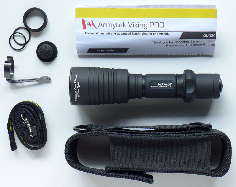

    Each Viking comes with a bezel-down holster, lanyard, pocket clip, two spare o-rings, spare switch boot, and a rubber blanking ring to use if you remove the tactical grip ring. (as both are the same I’ve only shown the Viking Pro)

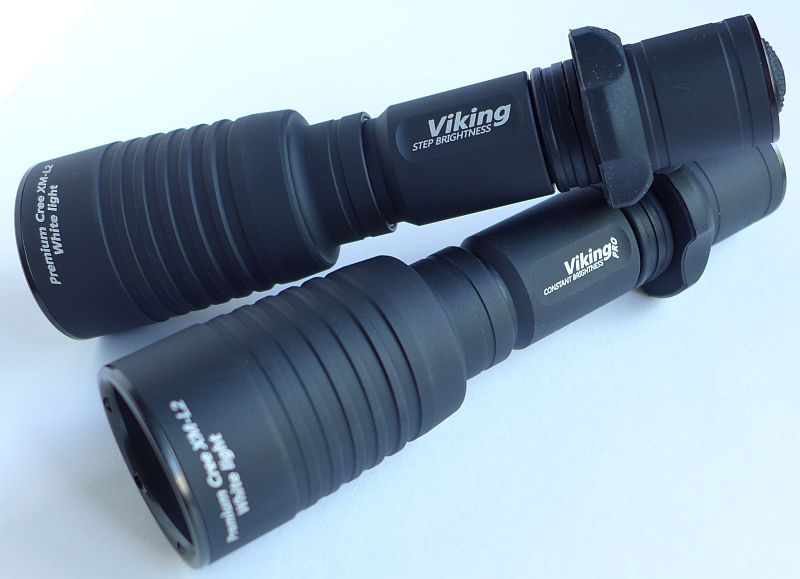

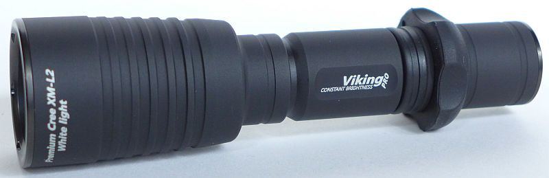

    When taking a closer look, most aspects of the body design are identical, so will only be shown once.

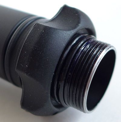

    There are two flats on the side of the battery tube which have the model designation (here the Viking Pro) and on the other side the Armytek logo.

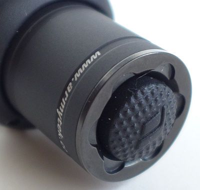

    The tailcap switch has a Ti coated stainless retaining ring (which if removed allows replacement of the switch boot – though this is very stiff).

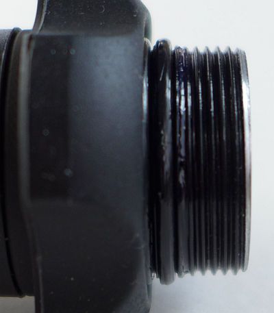

    Taking the cap off reveals the anodised standard threads used for this end of the battery tube.
    Looking from a slight angle you can see the double o-rings used to seal the tube. The Viking models have a removable silicon rubber tactical grip ring which has a hole for fixing a lanyard through. The grip ring also adds an anti-roll feature to keep it stable on a flat surface.

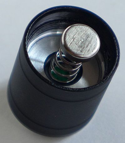

    Just like the Predators, the Viking uses a capped negative spring with plenty of travel to accommodate protected or unprotected cells.

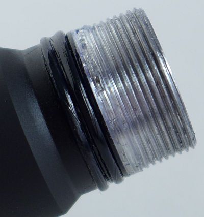

    Unscrewing the battery tube from the head shows the bare aluminium standard threads and double o-ring seal.
    The positive terminal is a metal disc and around the outer edge is the second contact used for detecting the head-tight (line 1), or head-loose (line 2) modes.

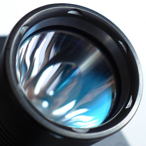

    Looking straight into the reflector shows the excellent quality and emitter positioning. (The dark spot in the middle of the emitter is only due to the ambient light reflecting onto the LED surface in a ring shape, and is not a flaw of any type).
    The lens is coated to reduce losses.

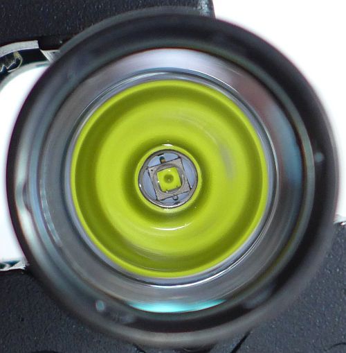

    A closer look at the XM-L2 LED.

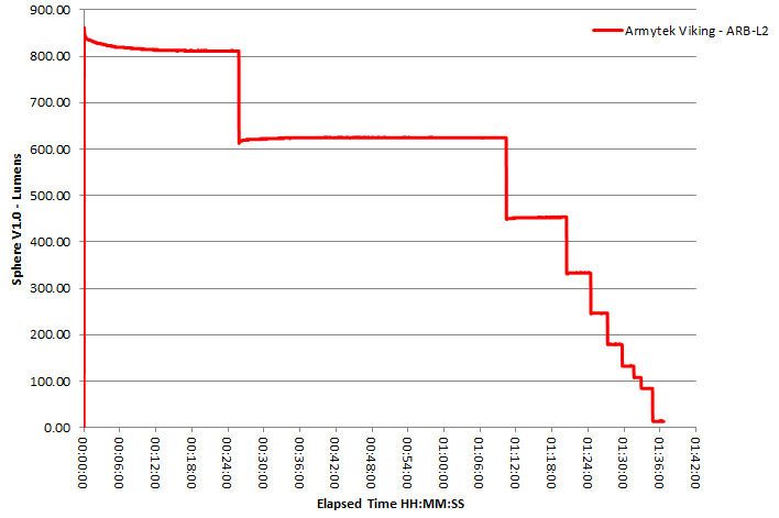

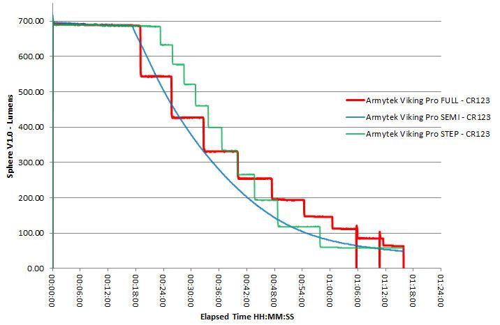

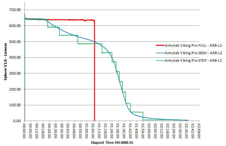

    The Viking uses STEP stabilisation on the maximum output mode. This is clearly visible in the output runtime trace. Once one of the step levels can no longer be maintained the Viking drops to the next level.
    Viking Pro v2.5 using ARB-L2 I.S. measured ANSI output Lumens PWM frequency (Hz)
    Military (default) High 644 0
    Military (default) Medium 177 0
    Military (default) Low 5 0
    (High on CR123 was 642lm)
    Like the Predator the Viking Pro uses three different types of output stabilisation (see the instructions for more details), including FULL stabilisation which maintains the specified output level without dropping at all until the battery can no longer maintain that output.
    The default configuration is for the Line 1 modes to be run as FULL stabilisation, and the test was re-run for SEMI and STEP stabilisation. The characteristics of each are clearly shown in the trace.
    During initial testing I noted some improvements that could be made to the output. Taking a proactive approach, Armytek tweaked the S-Tek driver to implement these improvements and provided a new test sample to demonstrate this. This is an excellent response and shows Armytek's desire for optimum performance. The following trace is from the tweaked Viking Pro.
    With the different characteristics of the CR123 power source, the trace changes slightly. The FULL stabilisation in this case takes on a larger step output characteristic.

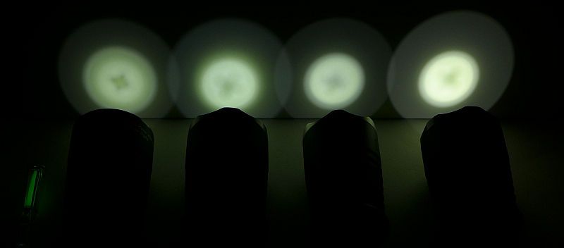

    Another aspect of the S-Tek driver's output that must not be looked over are the excellent ‘firefly’ modes. At a specified 0.1lm, 0.5lm and 1.5lm these are too low for my integrating sphere to measure. Bearing in mind that ArmyTek have specified their outputs as at the LED, the real output of these firefly modes is probably even less.
    In this first photo the Viking Pro is on the far left with the Predator X, Predator v1.2, and Predator G2 v2.0 on the right.
    To put this in perspective here are the Predators shown previously are with other low output lights. Far left is the Quark AA on moon mode, then the Predator G2, Predator X and the Photon Freedom Micro all on their lowest modes.
    Bear in mind the Photon Freedom Micro used very low frequency PWM to achieve this output whereas the Predator Pro and Viking Pro models have constant output with no flicker.

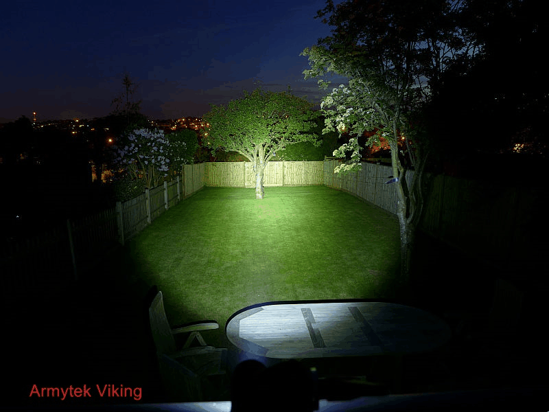

    The Viking Pro v2.5 and Viking v2.5’s beam is very smooth with a very even and soft edged round hotspot. Indoors the Viking and Viking Pro look the same, so here is a normal exposure, and one which is underexposed to better show the hotspot size and shape.
    Moving outdoors, the extra output offered by the basic Viking can be seen, though without this direct comparison would not be as noticeable.

    Will this flashlight work with Panasonic NCR18650B 3.7V 3400mAh Rechargeable Li-ion Batteries? My concern is not the batteries but the recessed positive terminal on the battery and the fact that it looks like the head end battery terminal on the flashlight is not a spring. Thanks in advance for your time.
    Hove, UK
    2,449
    Default Re: ArmyTek Viking v2.5 and Viking Pro v2.5 dual Review
    Quote Originally Posted by nick.clendenning View Post
    The Viking and Viking Pro, just like the Predators, has a raised positive terminal, so even though not a spring, I have been using flat tops perfectly well with them.
