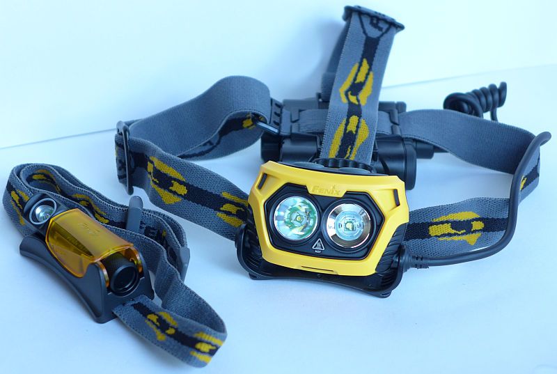

    Picking up the HP25 and the feature that really stands out is its twin lens light-head, and that each lens looks different. One lens is a full flood beam, and the other has a focussed reflector to give a tight hotspot and plenty of throw.
    Having reviewed the Fenix HP11 and HL30 previously, you may have picked up on my preference for flood beams on headlamps. For my purposes, I am more often working at close ranges, so find the flood beam far more suitable. However, whatever your preference, the HP25 gives you both flood and throw, either independently or combined, for excellent flexibility.
    With the HP25s twin-lens head, high-output, top strap and separate 4xAA battery box this seems like a real 'working' headlamp.
    On the other hand, the diminutive HL10 comes in a very compact package. Neatly designed to be used either as a headlamp, or if the light is unclipped from the housing, it becomes a tiny right angle floodlight you can keep on your key-ring.
    The single strap design is perfectly stable as it has very little weight to hold. The flood beam seems surprisingly powerful for a single AAA light, and this is just such a handy size.

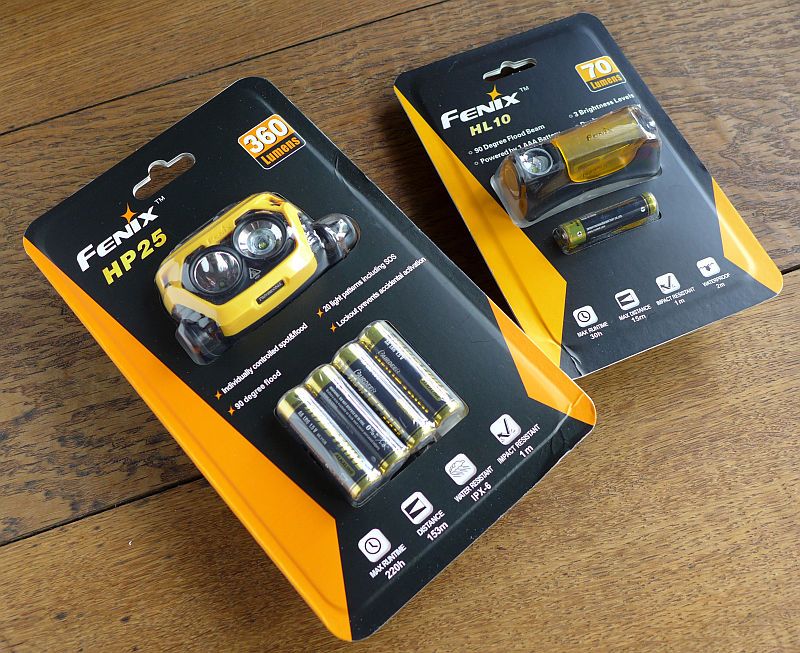

    Both these headlamps arrive in a hybrid cardboard/blister pack.

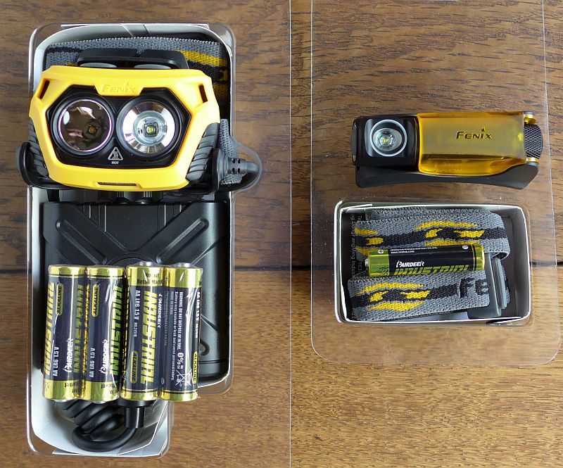

    Removing the blister part from the cardboard surround allows them to open clamshell style.

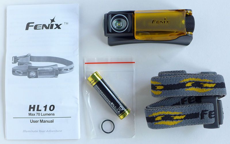

    Included in the HL10's package are the HL10, the head-strap, instructions, AAA alkaline battery and a spare o-ring.

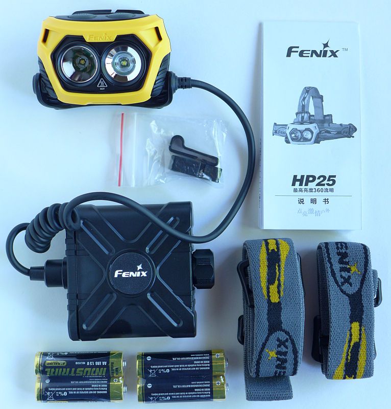

    Included in the HP25's package are the HP25 lamp unit and attached battery pack, the head-strap components, cable clips, instructions and 4xAA alkaline batteries.

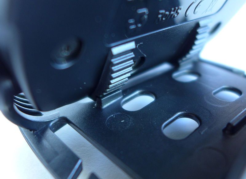

    The lamp unit is hinged on its headband mount, allowing the user to tilt the beam to their preferred angle.
    When pushed flat, the mount half covers both the power switches to help avoid accidental activation when stored.
    Looking a bit closer at the angle adjustment, you can see it is a simple plastic ratchet. This is the same system used on the HL30 which I have found over long term useto be reliable and stable.

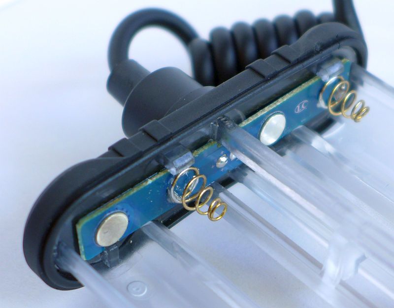

    At each end of the clear plastic battery carrier is a contact circuit board with durable metal pads and springs.
    - As a little tip, under the middle two cells are cut-outs in the carrier that allow you to push these cells out from behind. It is then easy to remove the remaining two cells.

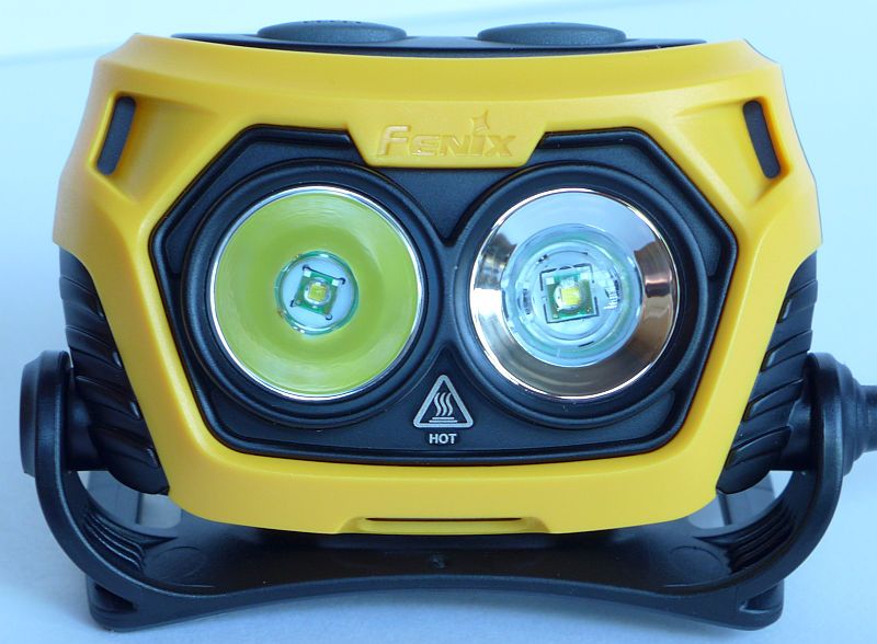

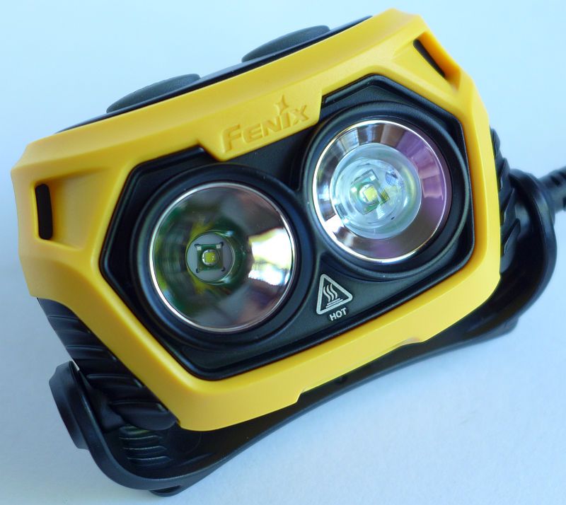

    Looking dead onto the front of the lamp unit, you can clearly see the different reflector configurations.
    On the left, the 'spotlight' reflector looks yellow due to focussing the light from the phosphor surface of the XP-E LED. To the right is the flood beam assembly which has virtually no reflector, instead having a clear dome over the emitter to smooth out the flood light.

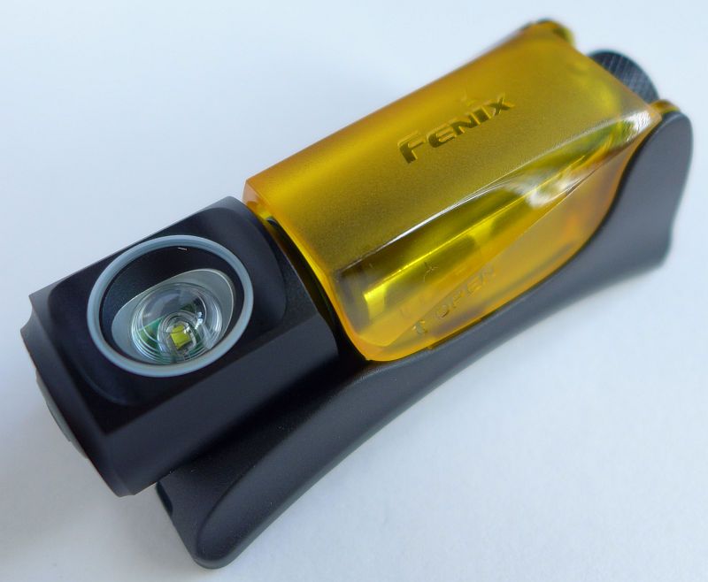

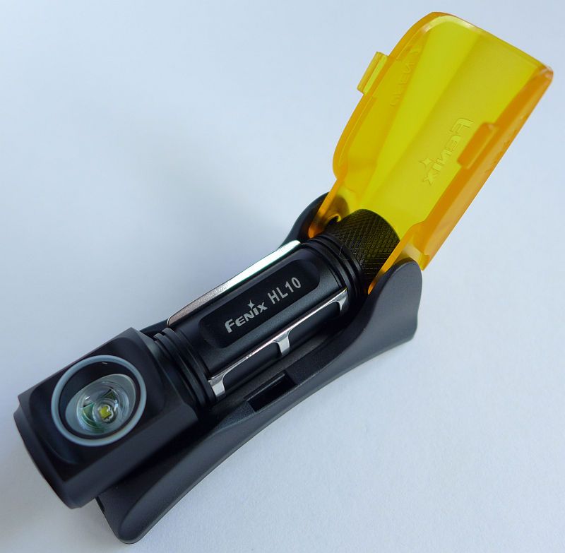

    As the HL10 is a dual purpose light, it uses a plastic lamp holder when configured as a headlamp.
    There is a hinged door that opens to reveal the lamp itself and the metal clip that holds it tightly in place and allows for angle adjustment.
    Pulling the lamp out of the holder frees it for use as a separate compact right-angle light.

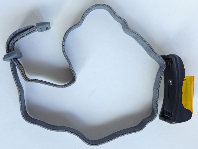

    On the back of the lamp holder each end has a headband strap clip. Like all other Fenix headlamps this allows the user to easily fit and remove the headband (for replacement or washing).
    The single strap is a simple adjustable loop with sliding adjuster. On the free end of the strap is a strap clip allowing you to tidy the end of the strap (and stop it flapping around) by attaching it to the headband. A nice touch.

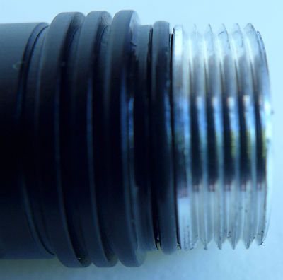

    The battery tube thread is bare aluminium (meaning no lockout is possible) and are a standard thread profile.

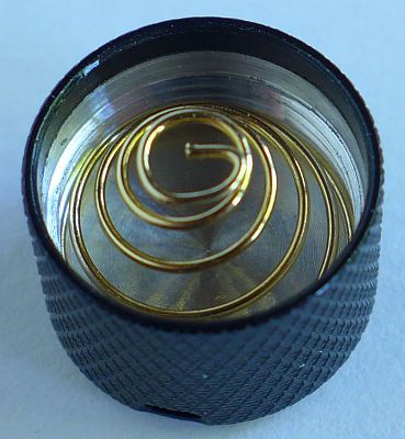

    The simple tail-cap has a gold plated spring contact.

    Considering the size of the actual light, the housing seems a bit oversized, and unfortunately when in the housing it is not possible to change the battery. Instead you have to pull it out of the housing.
    The metal clip which holds the light in the housing is a bit on the strong side. When taking the light in and out of this, or just rotating it to adjust the angle, the anodising 'creaks' and will ultimately become scratched. So far in testing the anodising has not come off, but is starting to shine-up in the areas of contact. This would be less of an issue if you could change the battery while it was in the housing, but unfortunately you can't.

    I'm intrigued by the design of the HP25, and am wanting to pick one up, in the near future. I only wish they had a high power unit (like their HP30, which also uses a separate belt/pocket baterry pack and higher performance 18650 batteries), but which also incorporates the dual LED design of the HP25. To me, that would be the perfect marriage of power and beam patterns.
    They can call it the HP27.5 (lol).
    Seriously, not everyone wants to be carrying batteries on their head, and the 18650 belt-carryable pack would cater more towards the flashaholic, who is accustomed to using 18650 batteries, anyway. Also, I'm not sure, but it appears that the interface cable that connects the battery pack to the light is hardwired into the battery pack - which I think is a poor design. It would make more sense to have a modular cable that could be user-replaceable, in the field, if the cable ever failed. That'd be nice.
    Also, I could do without that USB charging plug found in the HP30.
