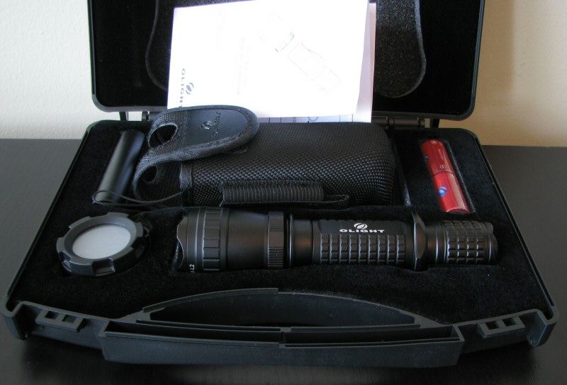

    My samples came in the Deluxe packaging.
    M20S-X
    Note that the M20-X and M20S-X have identical packaging - it is the light that identifies the specific model.
    M21-X

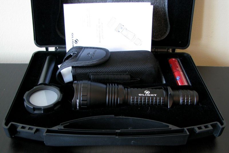

    For the Deluxe packaging, each light comes in a presentation-style plastic carrying case, similar to the other M-series lights from Olight. The light and all accessories are carefully packaged in cutout foam. Included with the light is a sturdy belt holder, spare O-rings, GITD tailcap button cover, good quality lanyard, 2xCR123A battery carrier, diffuser cover, warranty card and manual.
    M20S-X

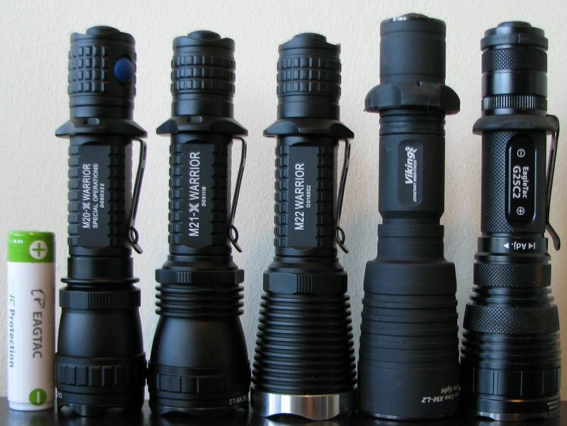

    From left to right: Eagletac Protected 3400mAh 18650; Olight M20S-X, M21-X, M22, Armytek Viking Pro v2.5, Eagletac G25C2-II.

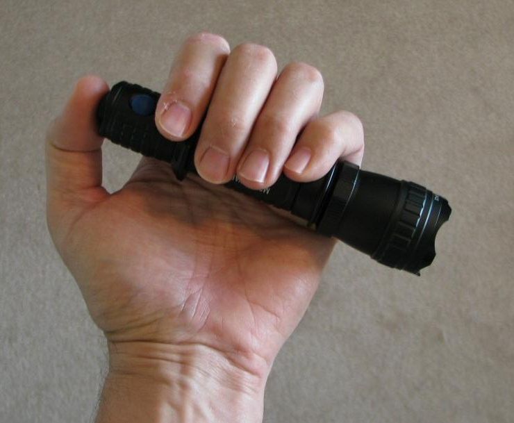

    Olight M20S-X: Weight: 124.1g, Length: 145.4mm, Width: 35.5mm (head)
    Olight M21-X: Weight: 125.5g, Length: 144.5mm, Width: 40.3mm (head)
    Olight M22: Weight: 148.4g, Length: 144.8mm, Width: 41.2mm (bezel)
    ArmyTek Viking V2.5: Weight: 159.8g, Length 153mm, Width (bezel): 39.5mm
    ArmyTek Viking Pro V2.5: Weight: 161.9g, Length 152mm, Width (bezel): 39.5mm
    Nitecore SRT7: Weight: 172.4g, Length: 158mm, Width (bezel): 40.0m
    Overall dimensions for the M20/M21/M22 class are similar – except for the larger bezel diameters as you go up in model numbers. Overall, they are very similar to other lights in this class.

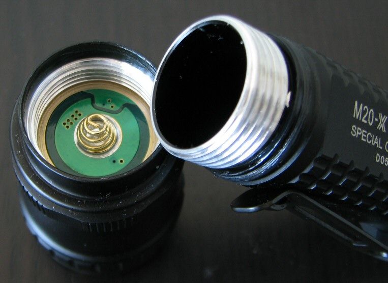

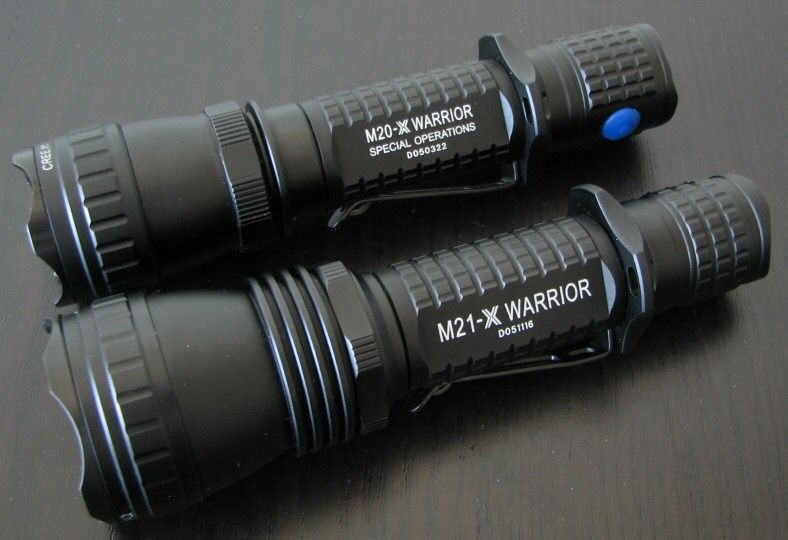

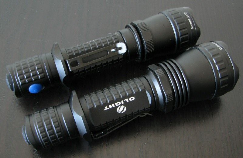

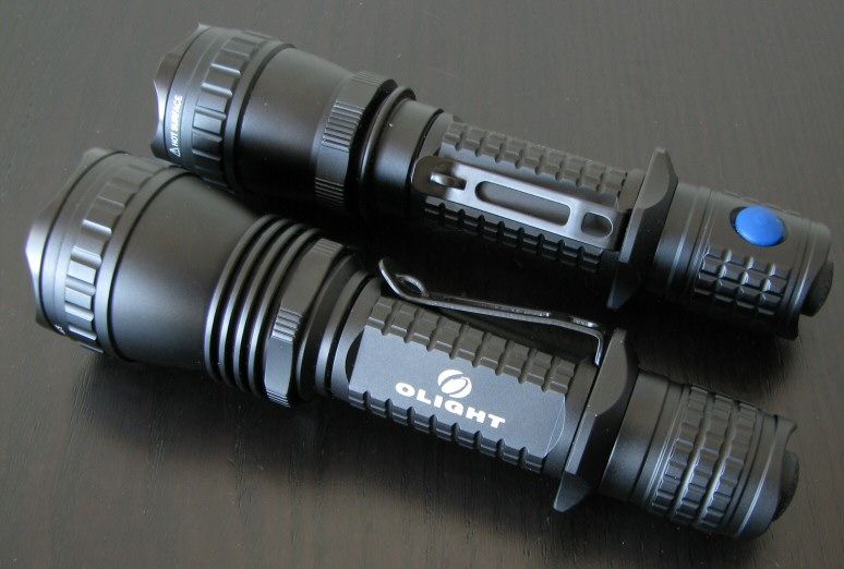

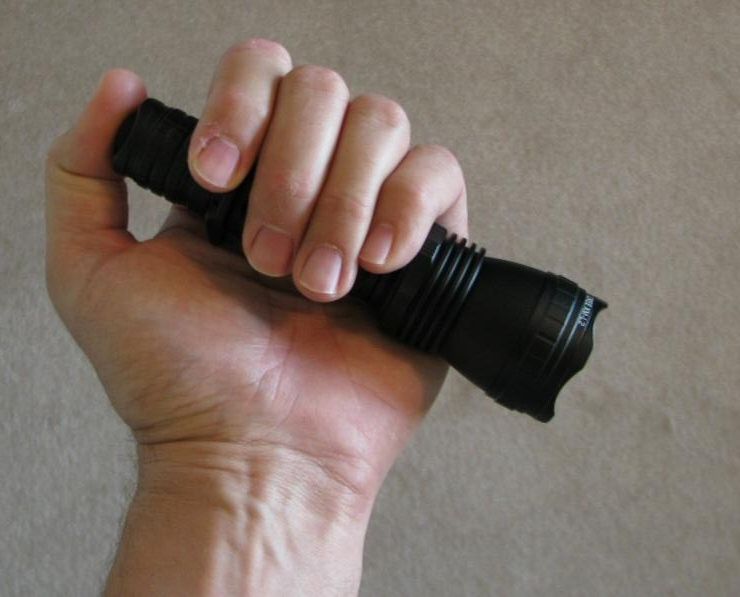

    Physically, the build of these lights are similar to the other lights in the M-series, with generally common external styling of the body handle and tailcap. Anodizing is a matte finish now (previously glossy black on the early models), but remains hard anodized (i.e., type III). Body labels remain bright and clear, and are sharp against the black background.
    As before, these lights don't use knurling per se – instead, the trademark Olight raised checkered pattern is used over the battery tube and tailcap to help with grip. It does fairly well, but is not as "grippy" as aggressive knurling. With the metal grip ring and clip installed, I would definitely consider grip to be above average for the class.

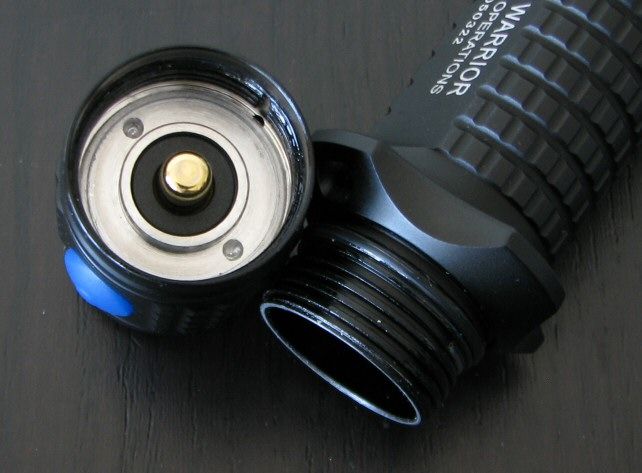

    One thing that has changed is screw threading – the new M20S-X and M21-X feature square-cut threads (of good quality), just like the recent M22. These are anodized at the tailcap to allow for lock-out, on either light.
    As before, there is a spring mounted on the positive contact board in the head, so flat-top cells can be used in the light.
    The bundled cigar grip ring is made of metal, and has a groove that fits into a slightly raised piece of metal by the removal clip (which helps hold the grip ring in place). There is a hole in the grip ring to let you thread a lanyard strap through.
    Due to the forward physical clicky switch, neither light can tailstand.
    The main physical difference between the lights is the larger head on the M21-X (although still smaller than the M22), and the secondary mode switch on the tailcap of the M20S-X. This is an electronic side-switch, under a blue cover. Switch feel is typical for an electronic switch. Scroll down for a discussion of the user interfaces.

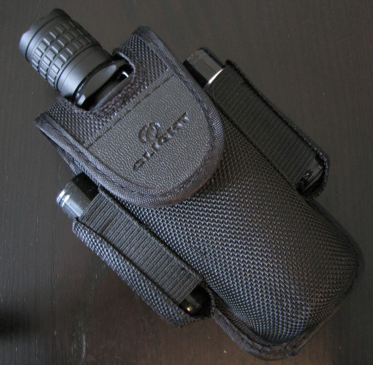

    The holster remains a distinctive item in the package. There is a hole in the bottom (so you can tell if the light is on), and space to carry two extra 18650 cells (or carriers with 2xCR123 each).
    I also quite like the standard Olight diffuser covers (included in the deluxe packaging), which fit snuggly over the head of the lights. Olight diffusers are of high quality, and can generally be used on many other lights of similar bezel size (thanks to the somewhat stretchy rubber cover).
    Both my samples came with black stainless steel bezels, although I believe shiny metal finish is also available. Let's take a closer look at the heads:

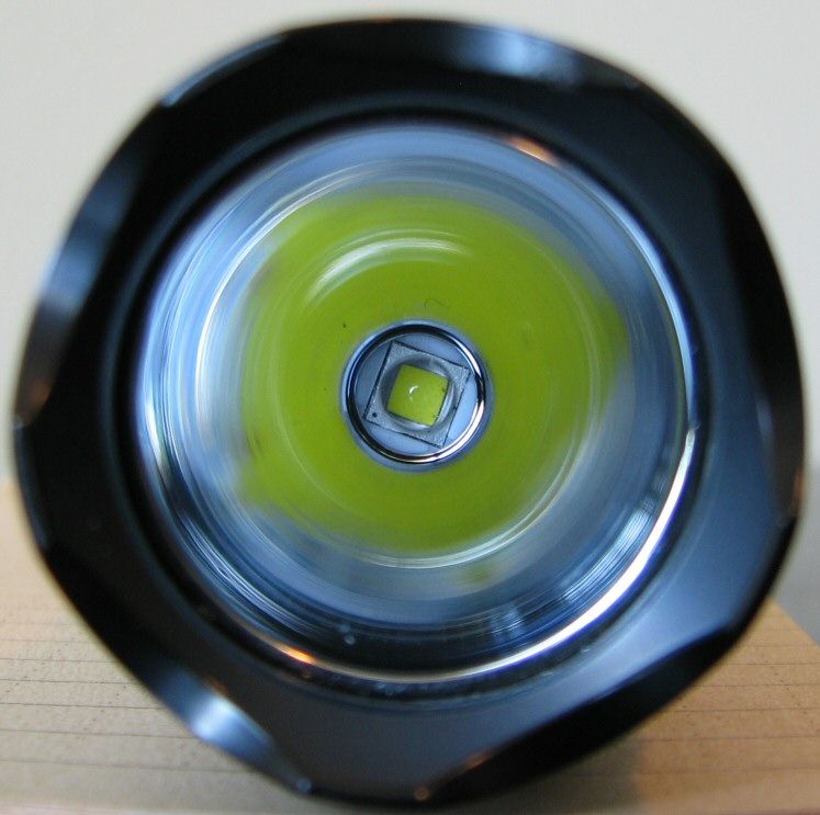

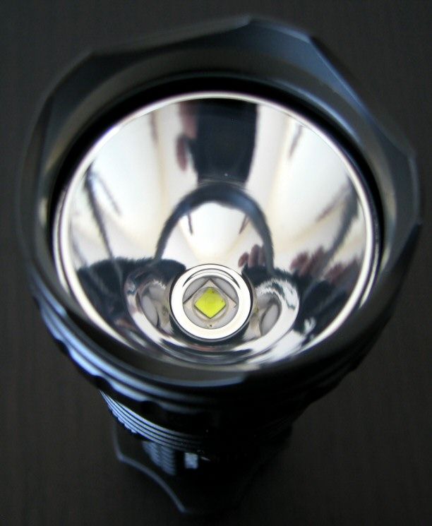

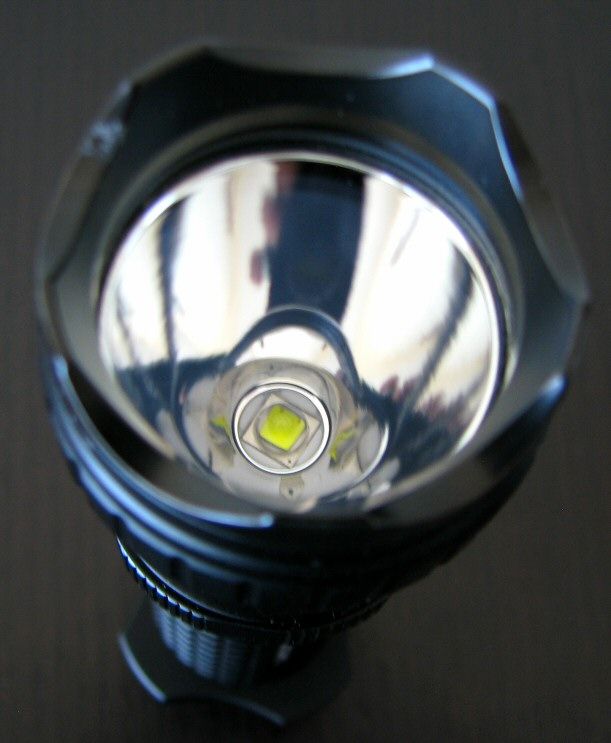

    Reflectors are smooth on both my samples (larger on the M21-X, of course). XM-L2 emitters (Cool White) were well centered on both. Scroll down for beamshot comparisons.

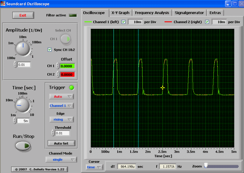

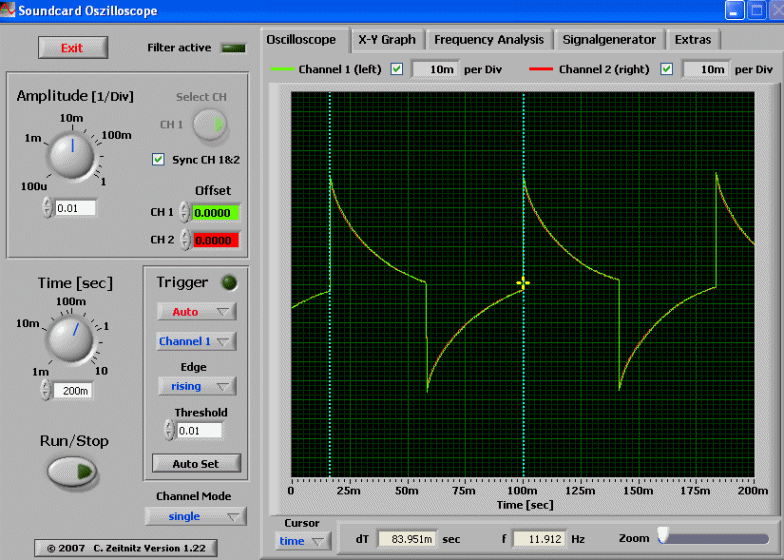

    PWM/Strobe
    M20S-X:
    Like the original M20S, Pulse Width Modulation (PWM) has to be used to support the dual-switch option. Apparently, this is required to synchronize the dual circuits (i.e., one in the tail, one in the head). All the other M-series Olight lights are current-controlled.
    PWM Lo
    PWM Med
    PWM Hi
    As you can see, on the M20S-X, PWM is of a constant frequency of 1.157 kHz. The duty cycle (i.e., on-off phase) depends of the apparent intensity of the light. Unlike many lights though, PWM is still present on Max output here. Again, I understand this is required for circuit synchronization.
    In any case, the 1.157 kHz is fairly acceptable in practice, in my view. I am particularly sensitive to PWM flicker, and I don't find these sorts of >1 kHz frequencies too bad. But it is still detectable to my eye.
    Lo mode noise:
    In addition to the PWM signal, there is also a secondary pattern detectable on the Lo mode. This is not uncommon on a number of PWM-based lights.
    Strobe:
    M20S-X Strobe was a fast "tactical" strobe, of 12 Hz frequency.
    M21-X:
    Like the M20, older M21, and current M22, there is no sign of PWM at any output level – The M21-X is current-controlled like its predecessors.
    The M21-X strobe is also a fairly typical fast "tactical" strobe, of 10 Hz frequency (as with my recent M22).

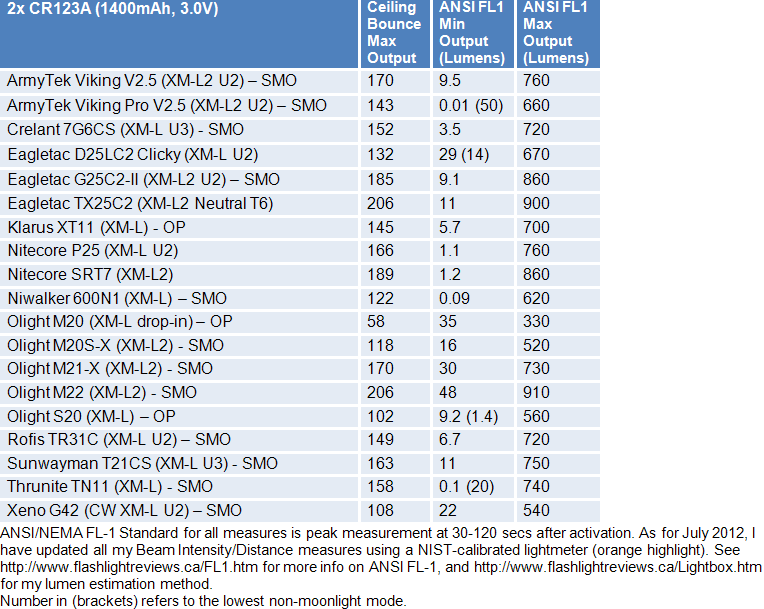

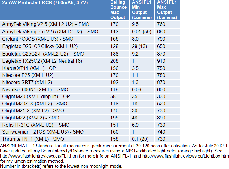

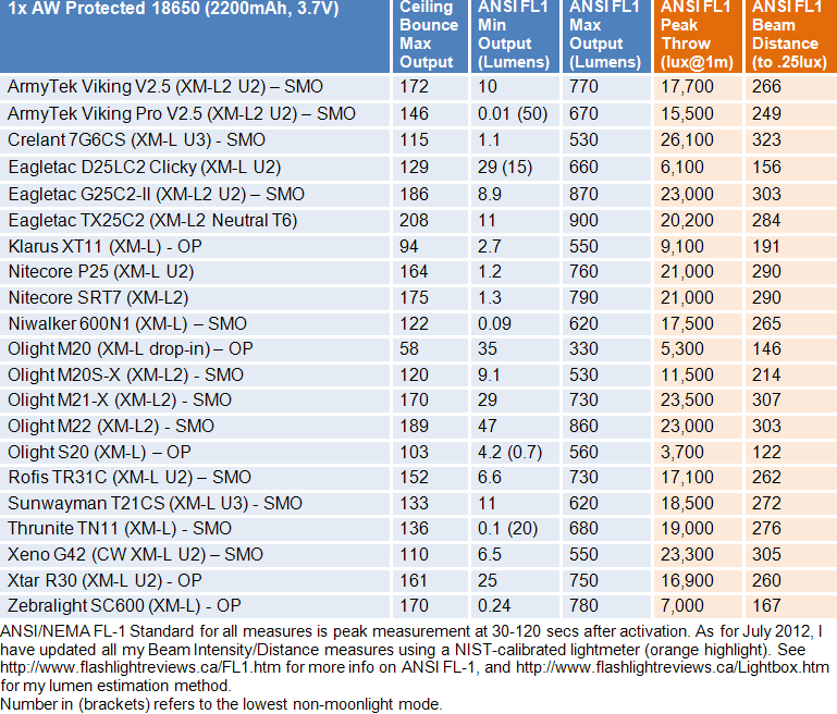

    For white-wall beamshots below, all lights are on Max output on an AW protected 18650 battery. Lights are about ~0.75 meter from a white wall (with the camera ~1.25 meters back from the wall). Automatic white balance on the camera, to minimize tint differences (but there may still be some variation).
    As you can see, overall output and throw is definitely the lowest on the M20S-X (and the spillbeam width is narrower). The M21-X is intermediate to the M20S-X and M22, also as expected. Scroll down to see detailed measurement results.
    There is a very clear range of max outputs and throw across the M-series line. The original M20 XM-L was relatively low-output (and throw) for this class, even at the time of launch. The M20S-X, M21-X and M22-X span the max output and throw ranges for the current 1x18650, 2xCR123A/RCR class. Basically, you get what you would expect in max output and throw as you go up in size.
    How do my lumen estimates compare across the various levels?
    As you can see, my results are fairly consistent across the board with Olight's ANSI FL-1 lumens. I had a similar experience with the M22.

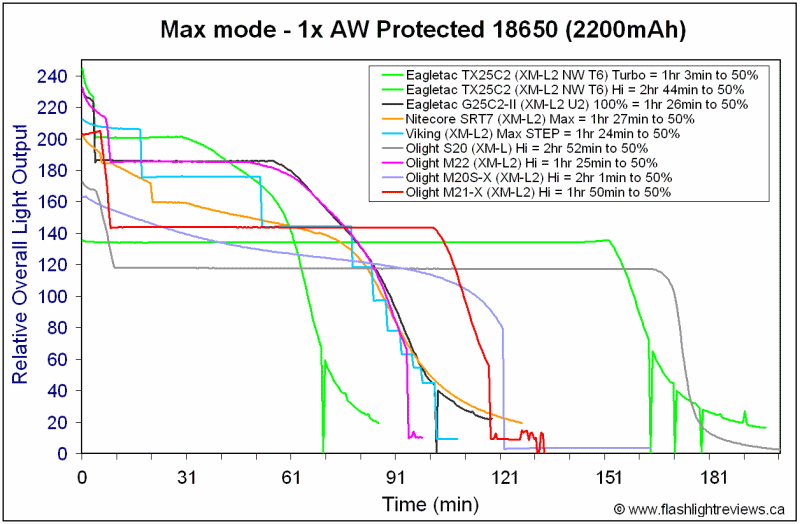

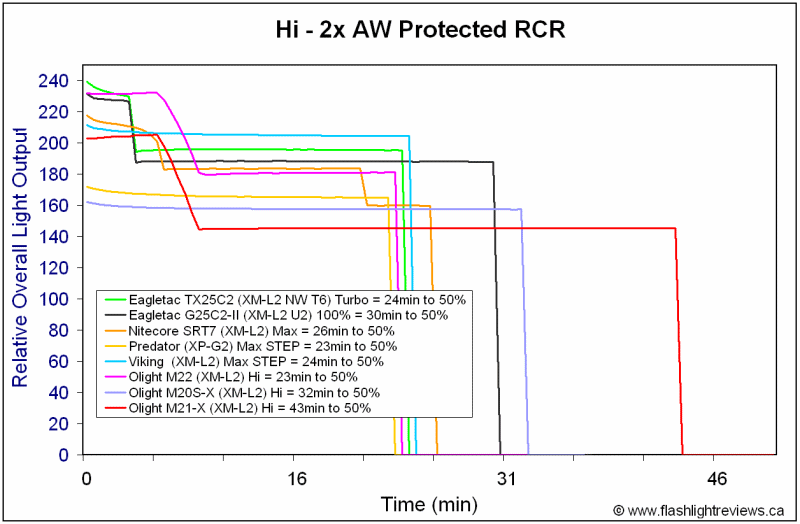

    Output/Runtime Graphs:
    Note: Unless otherwise stated, all my 18650 runtimes below are based on AW 2200mAh Protected 18650 cells.
    For the M20S-X, the first observation is that it doesn't have a timed step-down feature on Max, as the M21-X and M22 do. This is understandable, given that it is not driven as hard on Max. The second observation is that the M20S-X is only semi-regulated on 1x18650 (i.e., it looks a lot like direct-drive, at all levels). There also seems to be some loss of relative efficiency on all levels due to the PWM, but it is still quite acceptable for the class (i.e., not as high as the current-controlled M21-X or M22, but still very good).
    The M21-X looks like a slightly lower Max output version of the M22 (which is basically what it is).
    The M20S-X has visible PWM on all modes, but at an acceptable >1 kHz level.
    There is standby drain on the M20S-X when the fully connected, but this is negligible in my testing (i.e., would take 5 years to drain a typical 18650). You can easily lock out the light and break this current by a quarter turn of the tailcap. There is also an electronic lock-out available as well.
    For the M20-X, loosen-tighten heat twists are required to change output modes.

    Hey, just having another browse :-) i was wondering if you could explain why in the tables the M21 has less output but more throw than the M22 ? i am figuring of course they are similar sizes and reflectors. seems strange ??
    thanks Mr SB

    HaHa after writting the above i had a knock knock at the door, hello Mr Postman and a new M20s L2 :-)
    it is worth mentioning to others that the newer blue switch is much more raised and easier to find than the older models (white switch) however at this moment it also requires more pressure to use.
    just a quick comparison to my M20s G2

    Default Re: Olight M20S-X and M21-X (XM-L2, 1x18650, 2xCR123A/RCR) Review: RUNTIMES, BEAMSHOT
    Quote Originally Posted by zs&tas View Post
    It is presumably just subtle focusing differences between my two samples. On average, I would expect the M22 to have marginally better throw than the M21 (due to the slightly higher output with similarly sized reflector). But the exact positioning of the reflector on any given sample can influence that up and down.

    My M21X L2 arrived, strong little light.
    Odd that it has different glass then my M22, it has no AR coating.
    With that said, there's an obvious tint thing going on with new AR glass on the M22. The beam is colored with the AR glass, and its obvious next to the warrior without AR glass.
    I like the untinted cool white of the older M21X over the newer AR glass M22.
    I'm surprised this went unnoticed or mentioned.

    Quote Originally Posted by WarRaven View Post
    Given tint differences with emitters, you would really need to play with swapping lens in front of the emitter of each light to know for sure. There was a time on S-series lights when the heavy AR tint introduced some green-tinting, but this was corrected on the later versions. Odd to hear of a lack of tint on a recent M21X.
    Yes sir, I'll try and get pictures later.
    I don't know if it's completely void of AR,
    though the pinkish hue is nearly absent entirely.
    On M22, it's visibly seen.
    This looks like lenses on S10Rs, etc, clear looking.
