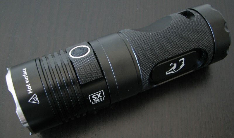

    The SX25L3 is a new 3x186500 class light from Eagletac that combines many of the features of the AA-based GX25A3/SX25A6 and Li-ion-based GX/SX/MX25L2.
    The light comes with a choice of a single XM-L2 emitter, or the new high-output MT-G2. In this review, I will be examining the MT-G2 version, and comparing it to a number of other lights that use this new emitter.
    • LED: CREE MT-G2 P0 Neutral White
    • Four brightness levels (Regular mode): ANSI FL-1 lumen: 2375-2006/1057/175/28
    • Runtime: 1.5/3.3/21/350 hours
    • Two brightness levels (Tactical mode): ANSI lumen: 2375-2006/243/Strobe I/Strobe II
    • Runtime: 1.5/19 hours
    • Center lux: 25,100 lux
    • Center spot angle: 10.3°
    • Spill light angle: 57.6°
    • Beam distance: 347 yards / 317 meters
    • Battery Type: 3x18650 3.7V li-ion, 6xCR123A 3.0V
    • Operating voltage: 5.4V -19V (note, do NOT use 6x 3.7V RCR)
    • Compatible 18650 battery diameter/length: Diameter: 18-18.8mm, Length: 67-68.5mm
    • Lens: Waterwhite glass lens w/ harden treatment, Anti-reflective (AR) coating on both side (96% transparency)
    • Reflector: Light orange peel aluminum reflector
    • Material: HAIII hard anodization aerospace aluminum
    • Waterproof: IPX-8 standard
    • Innovative slot load design, No battery tray or battery magazine needed
    • Seven hidden auxiliary outputs: Strobe/Strobe(Var)/Flash(Hi)/S.O.S.(Fast)/S.O.S./Becaon/Flash(Lo)
    • Dimensions: Head Dia. 1.85 inches (47 mm), Body Dia. 1.8 inches (45.5 mm), Length: 5.7 inches (144 mm)
    • Weight: 10.9 ounces (309 grams)
    • Base model: includes flashlight, Spare o-rings, User Manual, Mil-Spec Para-cord Lanyard w/ quick attachment clip, Flat tailcap
    • YRGB kit version: Includes all of the base model, and extra signal connection through the body tube for rear accessories add-on, Extra tailcap w/ switch and tail-standing ability, Flashlight head come with front-mount thread for bezel and filter attachment, Stainless steel bezel, Heavy Duty Nylon Holster w/ self-retention device and open-top design, ET47 diffuser filter, ET47 yellow filter, ET47 red filter, ET47 green filter, ET47 blue filter.
    • MSRP: ~$135 (base version), ~$175 (kit version)

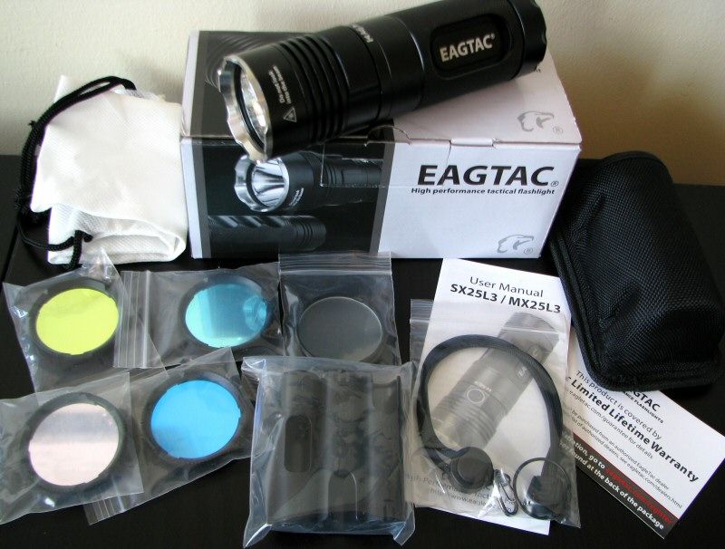

    The SX25L3 comes securely packaged in the new Eagletac cardboard box packaging. The lights come in a soft fabric pouch with a drawstring. Included accessories are extra o-rings, manual, warranty card and standard Eagletac wrist lanyard. A three-pack of anti-rattle holders for CR123As is included.
    My sample came as "kit version", which includes the YRGB accessory kit. Here, you get a belt holster in addition to a set of yellow, red, green and blue optical glass filters and diffuser cover (which replace the stainless steel bezel by screwing onto the head of the light). Note that my review sample was missing the extra tailcap with secondary switch, although this is part of the kit package. They will send one with the next batch of lights for review - in the meantime, please see my GX25A3 and SX25A6 reviews for examples of one.

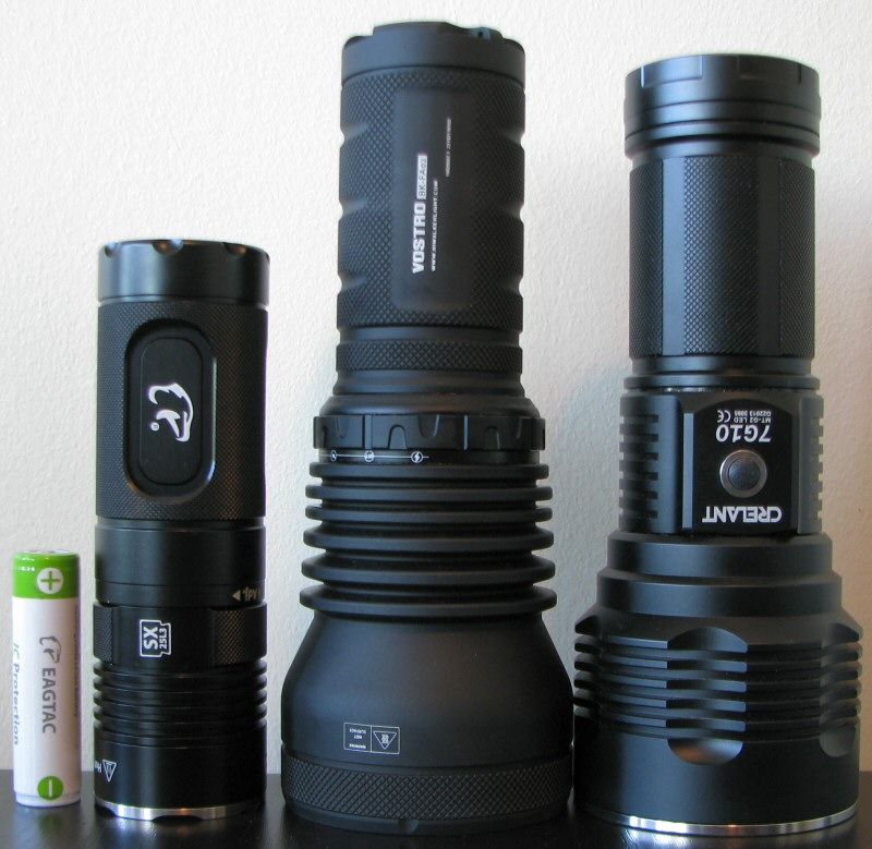

    From left to right: Eagletac Protected 18650 3400mAh, SX25L3; Niwalker BK-FA02; Crelant 7G10.

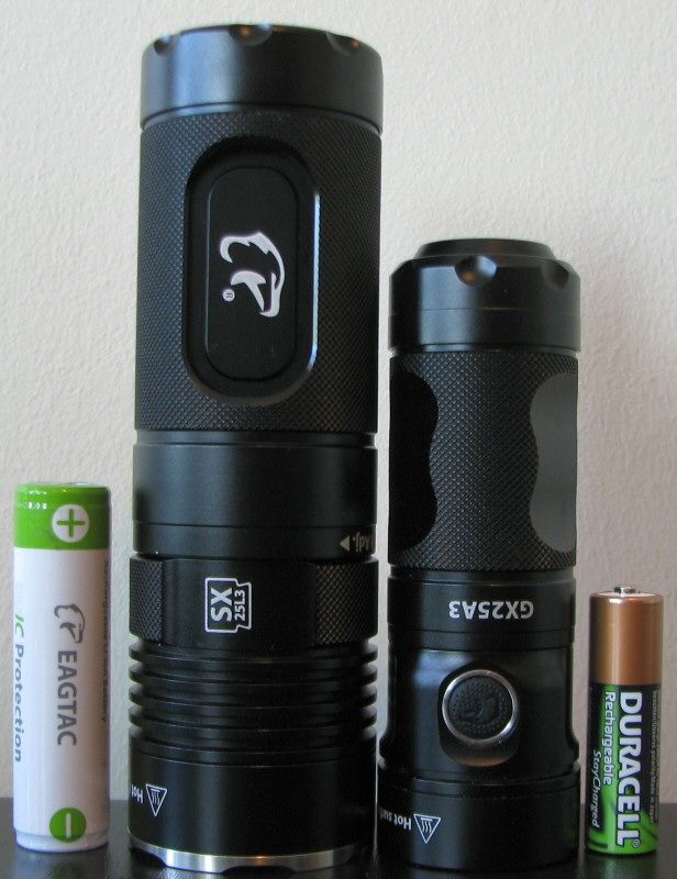

    From left to right: Eagletac Protected 18650 3400mAh, SX25L3, GX25A3; Duracell NiMH AA.
    Eagletac SX25L3 3x18650: Weight: 315.9g, Length: 150.2mm, Weight (bezel): 47.0mm
    Eagletac GX25A3 3xAA: Weight: 151.4g, Length: 109.2mm, Weight (bezel): 38.6mm
    Eagletac SX25A6 6xAA: Weight: 279.8g, Length: 183mm, Weight (bezel): 47.0mm
    Eagletac GX25L2: Weight: 198.3g (with battery pack: 290.1g), Length: 224mm, Width (bezel): 39.5mm
    Eagletac SX25L2: Weight: 279.4g (with battery pack: 470.3g), Length: 239mm, Width (bezel): 47.0mm
    Crelant 7G9: Weight: 482.2g (634g with 3x18650), Length: 188mm, Width (bezel): 64.0mm, Width (tailcap): 46.7mm
    Crelant 7G10: Weight 643.4g (827g with 4x18650), Length: 198mm, Width (bezel): 79.0mm
    Nitecore TM15: Weight: 450.6g (634g with 4x18650). Length 158mm, Width (bezel): 59.5mm
    Niwalker BK-FA01 (shipping): Weight: 687.6g (870g with 4x18650), Length: 209mm, Width (bezel): 80.0mm, Width (tailcap): 50.3mm
    Eagletac MX25L2 (standard head):Weight: 468.7g (with battery pack: 744.2g), Length: 266mm, Width (bezel): 62.0mm
    The SX25L3 is clearly a wider and heavier light than Eagletac's recent multi-AA offerings in this space (consistent with its 3x18650 design). That said, it is actually one of the most compact 3x18650 lights I've handled.

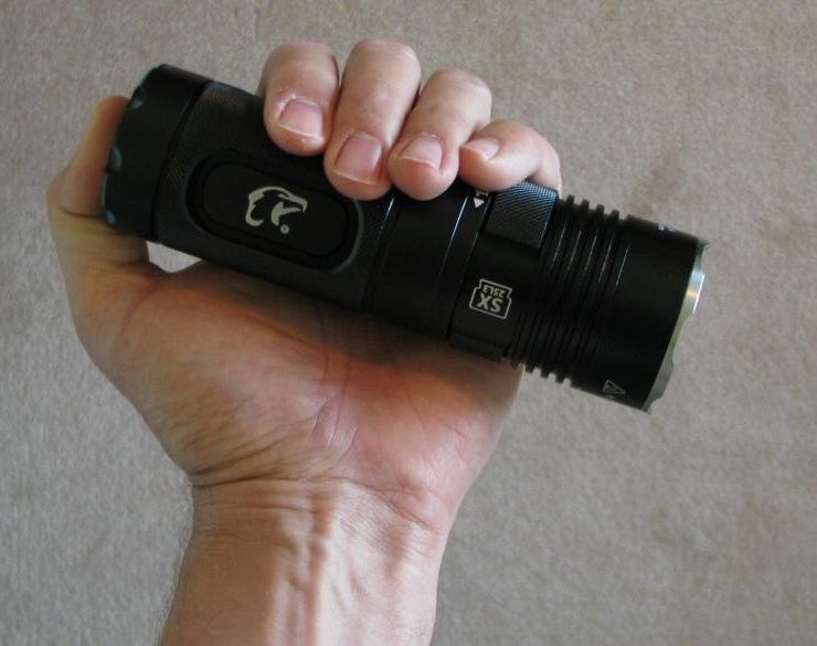

    Hand feel is good (for all size hands), thanks to the relatively compact build. Although a bit heavier than the AA models, the light is comfortable to hold and use. Grip is reasonably good, thanks to all the build elements. Knurling is somewhat mild, but is present over the entire battery tube/handle. As with the SX25A6, there are also finger well cut-outs on three sides of the battery tube.

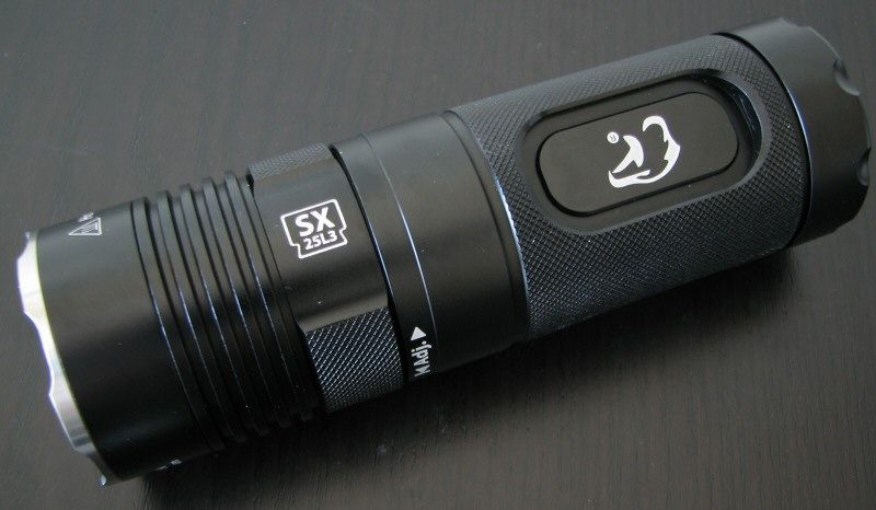

    Anodizing is glossy black, hard anodized (i.e., type III), but there were a couple of chips on my sample (note that my sample was an early review sample, so it may have already seen some handling). Labels are bright and clear (i.e., sharp white against the black background).

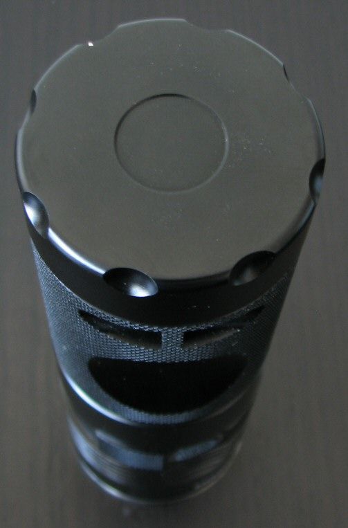

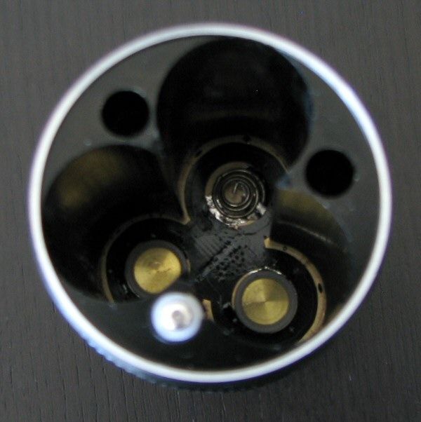

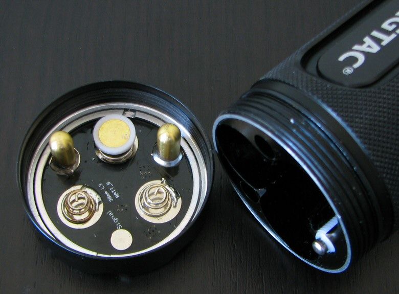

    Like the recent GX25A3/SX25A6, the SX25L2 doesn't use a battery carrier, but instead has cut-out wells for the cells. The cells are arranged in continuous series, with connection being made by contacts on a connector piece in the tailcap. This connector can spin freely, and locks in place to a couple of holes in the body that line up with rods in the tailcap.
    Screw threading on the tailcap is traditional triangular cut, and is anodized. This actually allows you to lock out the light, as there is a signal that carries through the tailcap (at least in the kit version tested here). On most other lights with this sort of battery arrangement, tension on the springs determines the contact, and hence no lock-out is usually possible. Thread feel is very smooth on my sample. Note that the kit version comes with an extra signal path for the secondary tailswitch to operate (i.e., I presume the extra metal tail connector pin is missing on the base model).

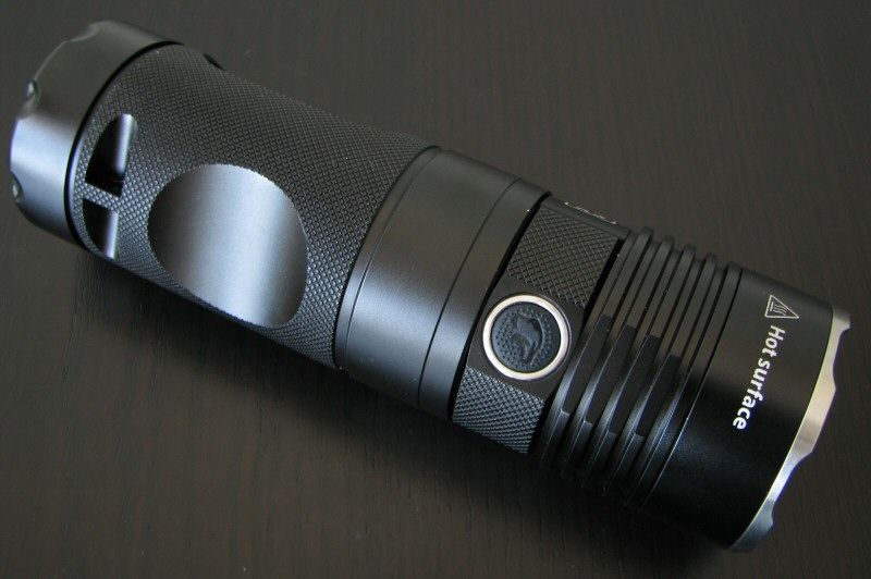

    As with other recent Eagletac lights that use a head switching mechanism, there are a series of spring-mounted pins in the head that are required to interpret the output state of the light. The thickness and quality of these pins look improved on the SX25L3, compared to earlier models I've seen (although all have worked fine in my testing to date).
    The SX25L3 can tailstand, and there is a wrist lanyard strap attachment point on the side. Note there is no real anti-roll feature, and the light can roll easily when on its side.
    Screw threads are square-cut (and thick) in the head region where mode switching occurs, as with the other recent Eagletac lights
    The electronic switch controls on-off when the tailcap is connected, with output mode selection and programming controlled by head twist. This is the same as the other recent GX/SX/MX/TX25xx-series lights, although the design of the contact points in the head can vary somewhat (scroll down for a UI discussion). Side-switch feel is good for an electronic switch – there is a reasonable traverse, and the action is firm. Grip is good with the texturized rubber button cover.

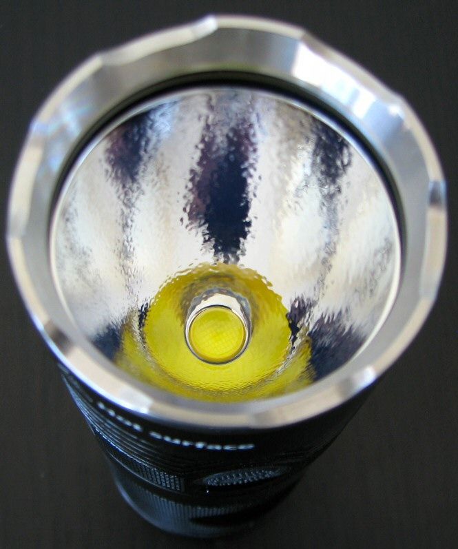

    The SX25L3 comes with either a XM-L2 emitter, or the high output MT-G2 shown above. The reflector (on my sample) is textured, and fairly deep. The large MT-G2 emitter seemed well centered.
    The MT-G2 is relatively new in the flashlight world (see the Cree MT-G2 spec sheet for more info). As you can probably tell, the MT-G2 is a remarkably large emitter, with a dome diameter of almost 8.9mm (vs. 5mm on the XM-L2). Of course, what really matters is the surface area of the die underneath, which is only 2x2mm on the XM-L2. I am not sure of the actual die dimensions on the MT-G2, but there appears to be a grid of 72 distinct segments on it.
    Note that the MT-G2 only comes in a variety of relatively neutral-warm tint bins (i.e., the coolest one available is 5000K). All the MT-G2 samples I've seen have certainly been in the typical "Neutral White" range, and this one is no exception.

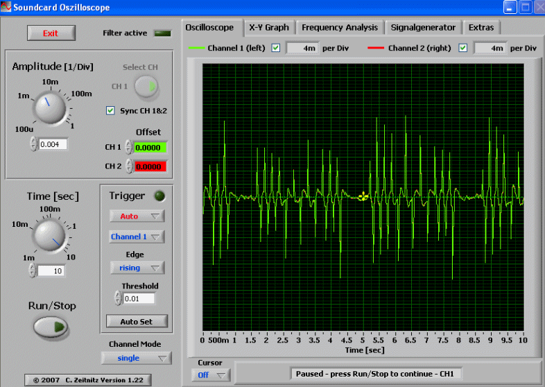

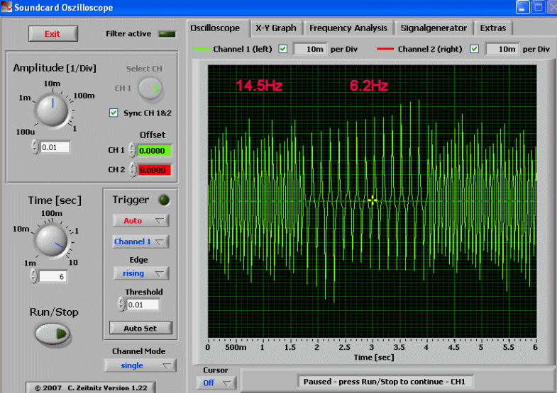

    PWM/Strobe
    There is no sign of PWM that I can see, at any output level – I believe the light is current-controlled.
    The SX25L3 is again identical to my GX25A3/SX25A6, TX25C2 and GX/SX25L2 series in terms of the auxiliary blinking modes.
    Strobe I:
    The main strobe is standard high frequency strobe, measured at 9.1 Hz on my SX25L3.
    Strobe II:
    The second strobe mode is an alternating or "oscillating" strobe, switching between 6.2Hz and 14.5Hz every 2 seconds.
    Hi-Flash:
    Hi-Flash is basically a full power slow strobe/beacon mode. Frequency was a reasonable ~1.6Hz. Note that the deflection spikes you see above are just the on and off signals of the pulse (i.e., it spends roughly half the time on, half the time off, with each pulse).
    SOS I:
    The "fast" SOS signals the full SOS sequence (dot-dot-dot, dash-dash-dash, dot-dot-dot) in just under 3 secs. Note again that the traces above refer to both the on- and off-signal for each pulse of light.
    SOS II:
    In contrast, the "slow" SOS takes just under 3 seconds just do the "S" (i.e. dot-dot-dot), and about 4 second to do the "O" (i.e., dash-dash-dash), with a good 3 seconds in-between each Morse code letter. Personally, this seems far more useful than the rather frenetic initial SOS mode.
    Beacon:
    Beacon is a slow full output flash (almost 2 secs long), re-occurring approximately every ~14 secs (i.e., a very slow beacon)

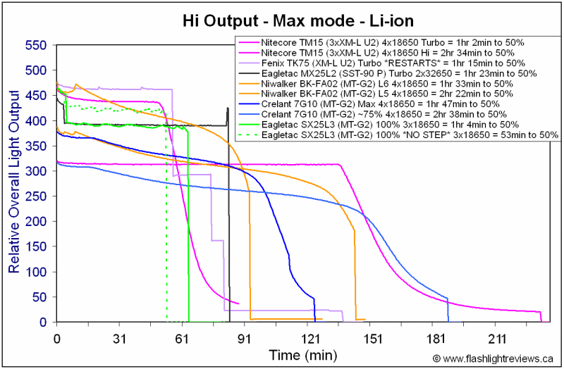

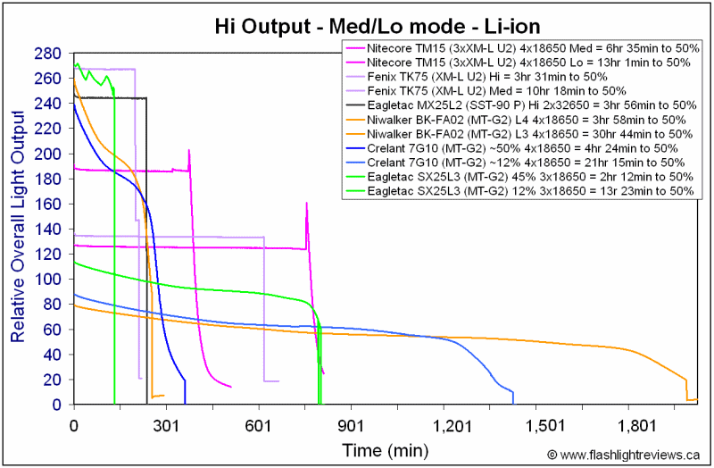

    Output/Runtime Graphs:
    Let's start by comparing some 18650 results:
    As you would expect, the higher capacity 3100mAh cells give longer runtime. Like the other Eagletac models, you can reduce the default ~25% step-down to just ~10% if you want (which will lead to reduced runtime).
    The regulation pattern is interesting, as both Turbo and the 45% Hi level show a mild oscillating pattern. Not to worry, this is completely unnoticeable by eye – the light will look completely flat regulated in use.
    Let's see how it compares to other lights:
    One interesting thing here is what happens at the lower 12% Med level – the S25A3 no longer shows a full regulation pattern, and the light looks more like direct-drive. This is again not an issue though – the timescale is so long above that the light will look completely flat regulated to the eye.
    The overall efficiency seems quite good at all levels – keep in mind, the SX25L3 is running on only 3x18650 cells, not 4x like most of the competition.

    I have this light. The only complain I have is that in the dark, it's hard to locate the on/off button. I solved that by sticking a small piece of luminous sticker on it. But only last 1/2 hour or so. I think the nitecore method of having the button lighted up is a great idea that eagle tac should adapt for those light with side buttons.
    Selfbuilt, btw, you should indicate that those who did not buy the kit won't be able to use the accessories on their basic set like mine.. Anyway, my basic set did not feel like a diffuser is useful but the end cap switch would be!
    Mar 2006
    BE
    418
    Default Re: Eagletac SX25L3 (MT-G2, 3x18650/6xCR123A) Review: RUNTIMES, VIDEO, BEAMSHOTS+
    Quote Originally Posted by MichaelAng View Post
    ..Selfbuilt, btw, you should indicate that those who did not buy the kit won't be able to use the accessories on their basic set like mine.. Anyway, my basic set did not feel like a diffuser is useful but the end cap switch would be!
    Ahem...there is a tad of (friendly) controversy about this very subject here:
    http://www.candlepowerforums.com/vb/...=1#post4248243
    (posts #219, #228- )
    I tend leaning towards Michael's warning: "kit-exclusive accessories - not swappable"; other opinions diverge, ever so slightly ...
    __philippe
    Oct 2008
    Honolulu, Hawaii
    634
    Hey MichaelAng, there is a flat spot on the heat fins that lines up with the on/off button that I use as a guide in the dark.
    I just feel for it with my thumb, and the button is directly below. hope this helps.

    selfbuilt, I don't have that silver knob on the top on the battery tube (with the tailcap off) clearly seen @ 4' 11" on Vid
    hmmmm?
    Also :: yep,a GID boot on the switch wouldn't hurt
