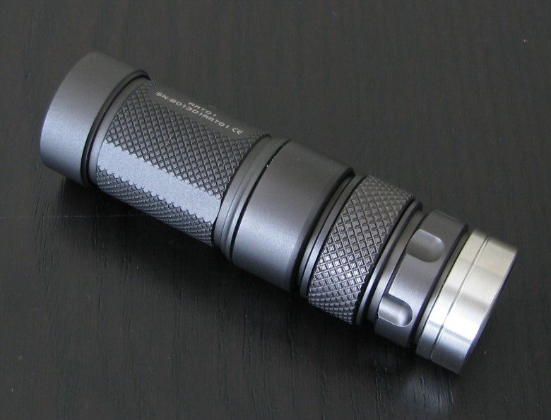

    Note that for the body pics and beamshots, I have used the original V11R that I was sent in 2012. The video, output/throw tables, and runtime graphs all show the new concurrent V11R shipping sample.
    RRT-01:
    V11R:

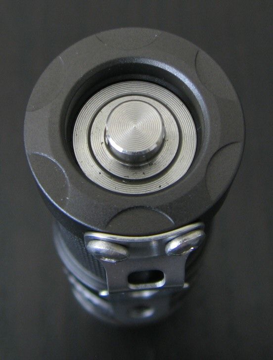

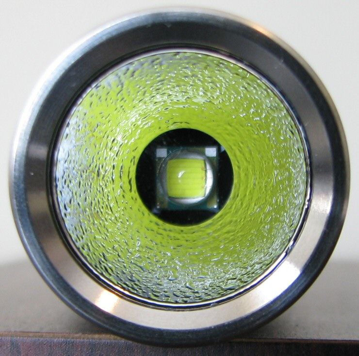

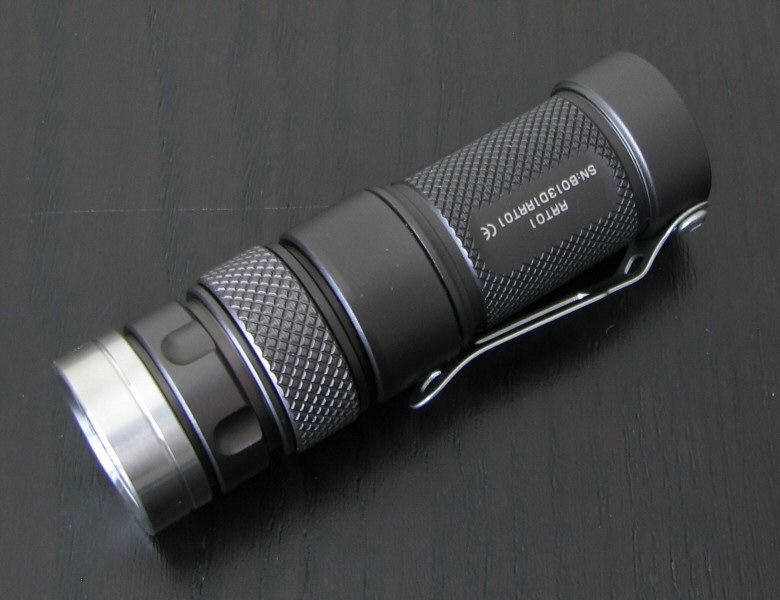

    I provide a detailed discussion of the build of lights (and their packaging) in the video overview below. Please check it out for more details.
    RRT-01:
    V11R:

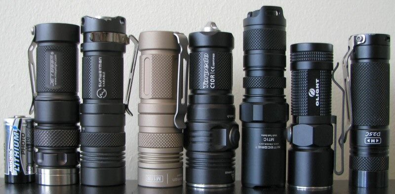

    From left to right: CR123A; JetBeam RRT-01; Sunwayman V11R, M11R, C10R; Nitecore MT1C; OIight S10; Eagletac D25C.
    JetBeam RRT-01: Weight 46.2g, Length: 80.7mm, Width (bezel): 23.0mm
    JetBeam PC10: Weight: 50.5g, Length: 93.6mm, Width (bezel): 22.6mm
    Sunwayman V11R: Weight 50.5g, Length: 84.3mm, Width (bezel): 23.1mm
    Sunwayman V11R with AA extender: Weight 59.70g, Length: 100.5mm, Width (bezel): 23.1mm
    Sunwayman M11R: Weight 45.8g, Length: 76.4mm, Width (bezel): 23.1mm
    RRT-01:
    V11R:

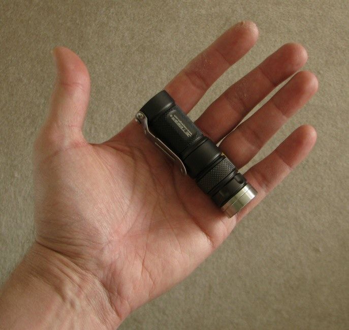

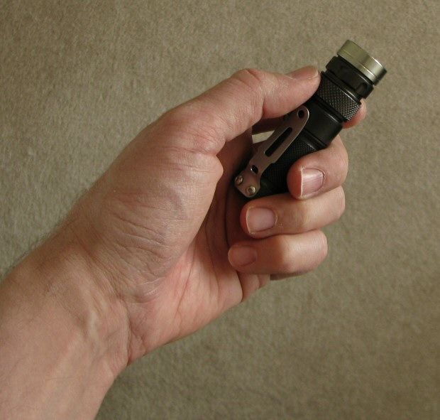

    Again, please see my video below for a detailed comparison of the build quality and user interfaces.
    To put it simply, both lights have a quality build, and both use a magnetic control ring to adjust output. However, the V11R also comes with a tail forward clicky switch (with choice between rubber or titanium boot cover), whereas the RRT-01 only has the control ring. And the feel of the control rings are quite different – again, see the video for a full discussion and depiction.

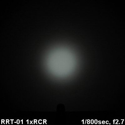

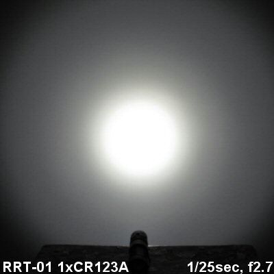

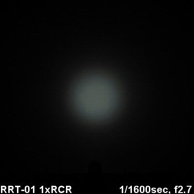

    And now, what you have all been waiting for. All lights are on the indicated battery, and are about ~0.75 meter from a white wall (with the camera ~1.25 meters back from the wall). Automatic white balance on the camera, to minimize tint differences.
    Note the V11R beamshots are based on my initial review sample. The more recent shipping sample is slightly brighter on CR123A, as shown in the runtimes later in this review.
    1xCR123A Comparison:
    1xRCR (AW Protected 750mAh) Li-ion Comparison:
    Note that in all these tables, the V11R refers to the recent shipping sample.

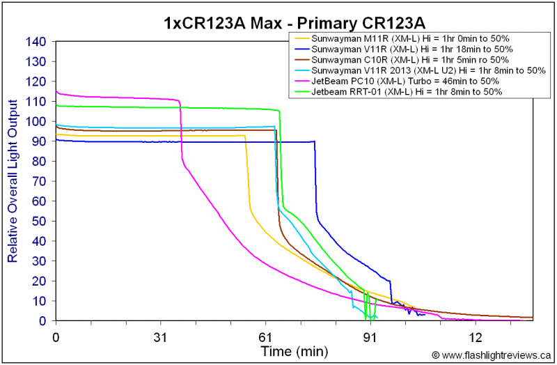

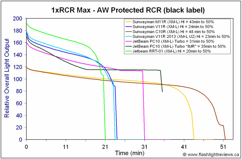

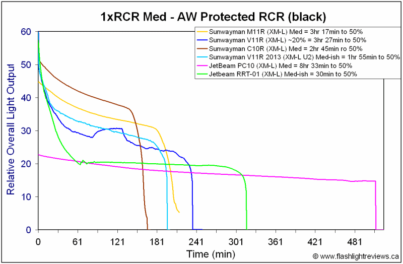

    Output/Runtime Graphs:
    For the runtimes, the original review V11R (from 2012) is simply listed as "V11R". The new shipping sample is described as "V11R 2013".
    The RRT-01 is driven slightly harder on max (on both CR123A and RCR), but otherwise performance seems pretty comparable. The two lights both have a similar regulation pattern, and overall output/runtime efficiency seems to be about the same.
    This "mini-review" isn't meant to be a detailed exploration of either the JetBeam RRT-01 or Sunwayman V11R. It is really just a quick comparison summary of the performance of two recent shipping samples of each light. You can check out my full review of the V11R for more info on that light.
    In general terms, actual output/runtime performance is quite similar - although the RRT-01 is driven slightly harder on max, and can go to much lower "moonlight" levels. And both lights use a "visually-linear" ramp of output. Again, check out my V11R review for a discussion of what that means.
    But I strongly recommend you check out the rather lengthy video comparison in this review. I spent more time than usual directly comparing and contrasting the build and user interfaces of these two lights in that video. In particular, the feel and performance of the control rings are quite different.
    Personally, I think both are excellent lights – it really comes down to your build preferences. Hopefully the detailed comments in the video will help you with that.

    I have massive hands and single CR123 celled lights are a bit too small to operate comfortably. The second reason is I wanted a clicky switch.
    Yes, I concur. I have long fingers, and find it challenging to operate most 1xCR123A lights (my standard EDC is 1xAA). The tailswitch is also a bonus for me, as I worry about accidental activations on any EDC light.

    Quote Originally Posted by Trevilux View Post
    Great review-comparison selfbuilt, Thanks.
    I have a RRT01, my only rcr123a/16340 are the Nitecore NL166 and EagleTac 16340. Do you think they are safe?, Discharge Too much amperes for them?)
    Should be fine, but I would limit running on max on any standard ICR cell.

    Having owned the V11R, the clicky + ring makes one-handed operation almost impossible.
    Jul 2013
    Folsom, CA
    500
    Default Re: Jetbeam RRT-01 vs Sunwayman V11R (1xCR123A/RCR) Head-to-head Comparison Mini-Rev
    Quote Originally Posted by tallboybass View Post
    Interesting. I find it quite easy.
    I own: Sunwayman V10R XP-G R5, V10R Ti XP-G R5, V10R XM-L T6, RRT-01 XM-L T6 SMO, and RRT-01 XM-L2 T6 HOP.
    Because of the tail end clicky, the V10R's required a more aggressive higher above the waistline overhand grip with four fingers over the top.
    Furthermore, once the V10R is switched on, I could still use the V10R one handed, but I would have to flip the V10R 180 degrees to activate the magnetic control ring.
    Pity the V10R couldn't use a more ergonomic tail end switch with a combined tail end rotary like the HDS EDC Rotary flashlight - then we wouldn't have to constantly flip the V10R 180 degrees.
    In any case, for me - the overhand grip with four fingers over the top is too aggressive, and the reflector too deep, with a less practical narrow spill.
    The V10R's have all been gifted away.
    The RRT-01 XM-L2 T6 HOP is presently my favorite EDC with a nice lazy below the waist line underhand handshake grip, and a shallower reflector for a wide spill beam, and that overdriving using the IMR chemistry with 18350 capacity is great too...
