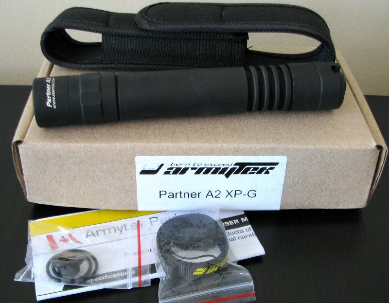

    Packaging is common for all versions - a typical carboard box, reminiscent of the Zebralight lights. Inside, the light comes with a basic but good quality holster with closing flap, wrist lanyard, spare o-rings and boot cover, and manual.
    From left to right: Rayovac CR123A; ArmyTel Partner C1 XP-G, A1 XP-G, A2 XP-G, Duracell NiMH AA.
    Detail comparisons for each model – relative to their respective class – will be provided later in this review.

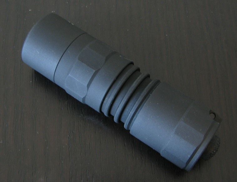

    Common Build Elements

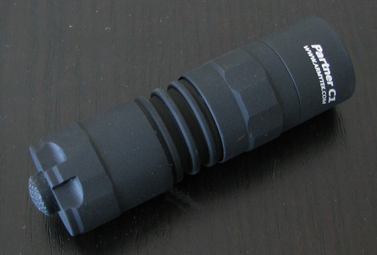

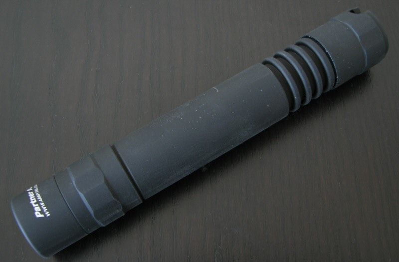

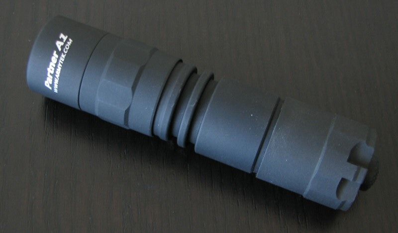

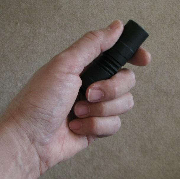

    As always, ArmyTek build quality is very high, and the lights have a very robust feel. Physically, the two classes of models are distinguished primarily by their emitters and optics, which I will describe in more detail below.
    The ArmyTek finish is fairly unique in my testing - the bodies of their lights have a very thick matte finish anodizing that feels almost molded (i.e., it is very "grippy"). According to ArmyTek, this anodization coating is much thicker than most lights. Although the lights lack knurling, grip is actually quite decent thanks to this unique finish. And there are some ridge detail elements to help further with grip.
    Note the grippier finish may show dirt, hand oil, etc, more easily than traditional glossy knurling. There are also no real anti-roll features (except for some flattened areas of the tailcap), so the lights can all roll easily. Lettering is very bright and clear, and very legible.

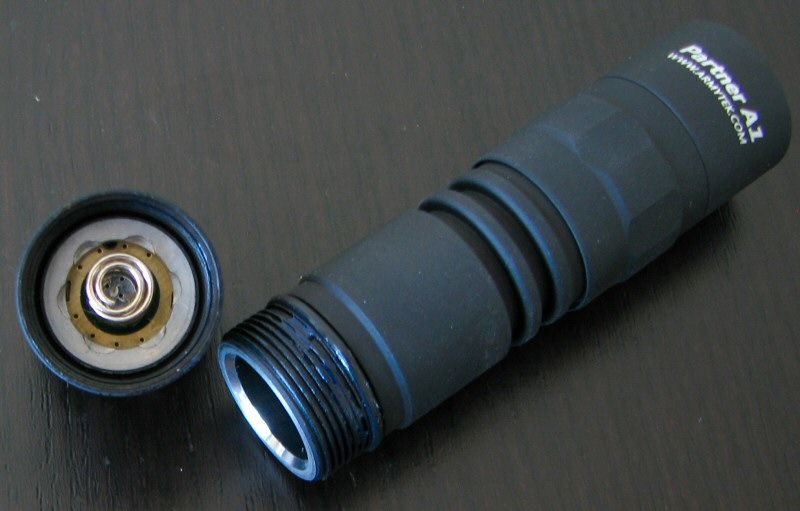

    Screw threads are standard triangular cut, but seem of good quality. Screw threads are anodized at the tail region of the battery tube and in the tailcap (for lock-out). Edges of the battery tube have all been chamfered (i.e., rounded off), which shows a nice attention to detail.

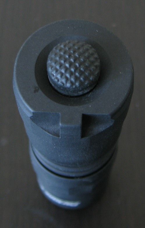

    The tailcap switch is a reverse clicky in all lights, with good feel. The spring is thicker and longer than typical on these sorts of lights, with a flattened end (so as not to scratch your batteries).
    There is a lanyard attachment point at the base of the tailcap. The lights cannot tailstand.
    There is a small raised contact point in the head, so high capacity flat-top batteries can be used.

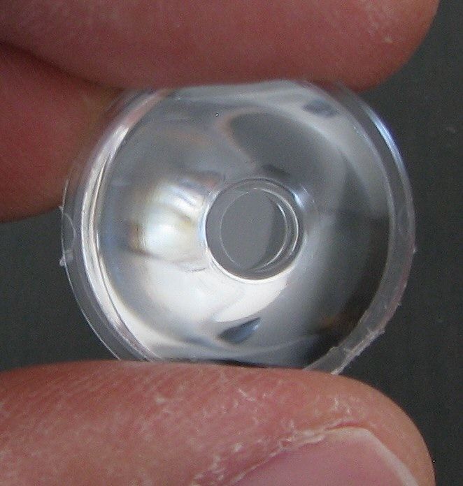

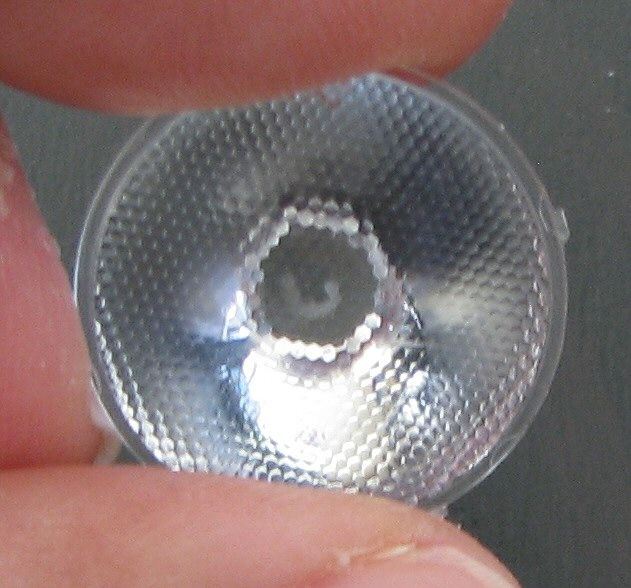

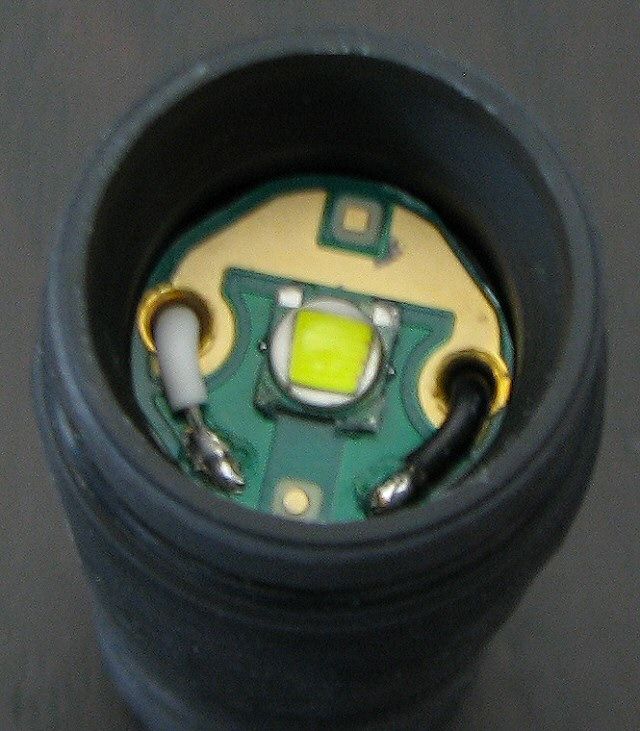

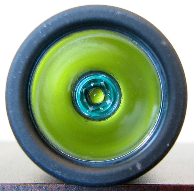

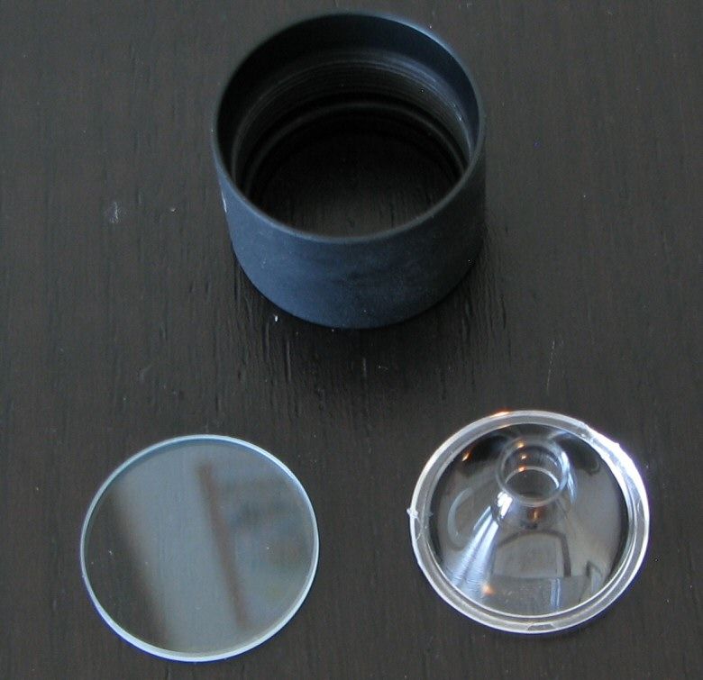

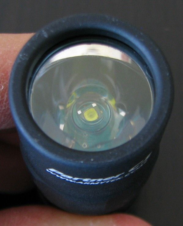

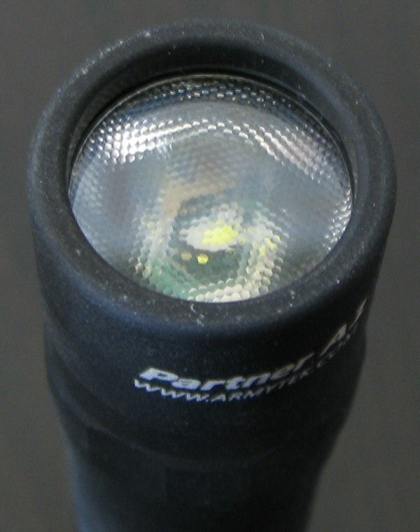

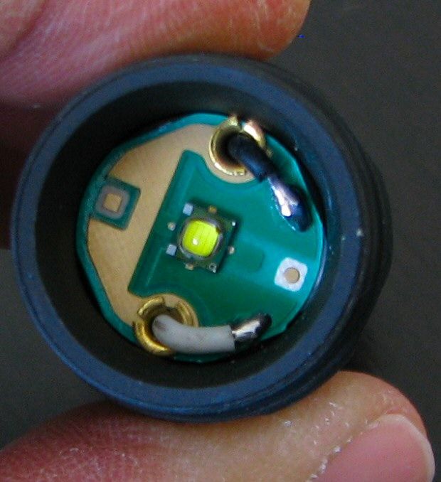

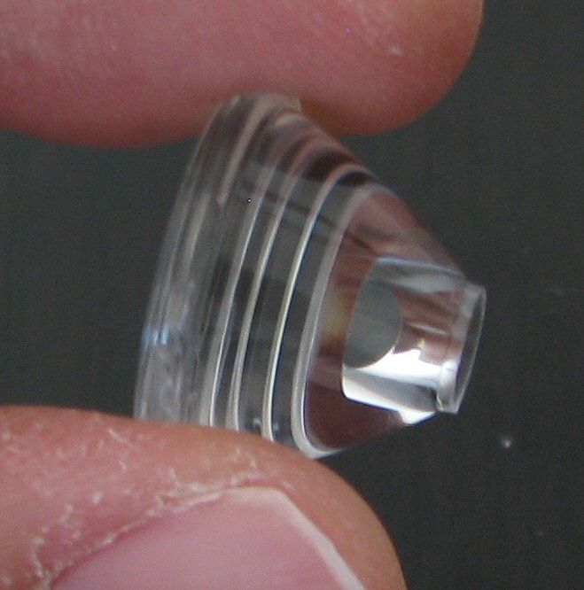

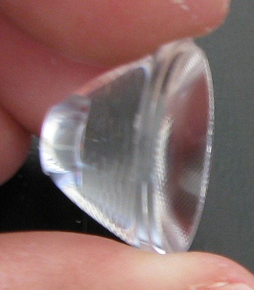

    As mentioned earlier, the lights are distinguished by their emitter and optic choice. Note that the lights do not use a reflector, but have a customized TIR optic that goes with each emitter type.
    XP-G emitter:
    XM-L emitter:
    In all cases, the head of the light has a flat aluminum bezel. Use of TIR optics means the spill will be reduced (compared to reflectored lights). Although hard to capture on camera, please see my detailed beamshots later in this review, for each model.

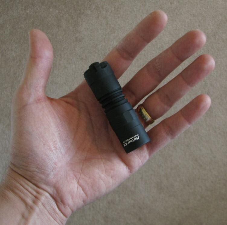

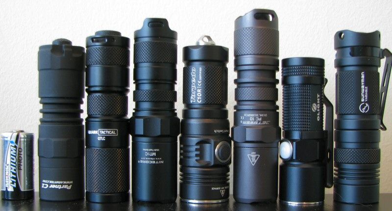

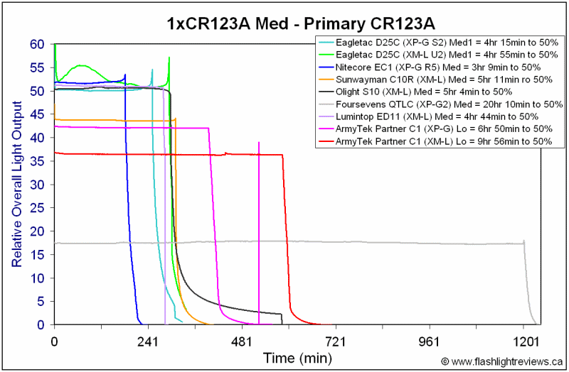

    Partner C1
    From left to right: Rayovac CR123A; ArmyTek Partner C1 XP-G; Foursevens QTLC; Nitecore MT1C; Sunwayman C10Rl JetBeam PC10; Olight S10; Sunwayman V11R.

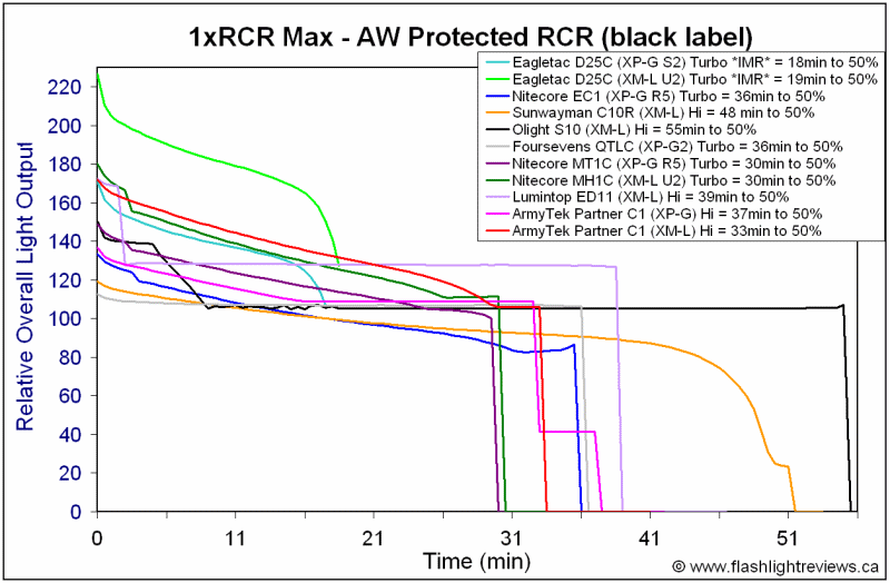

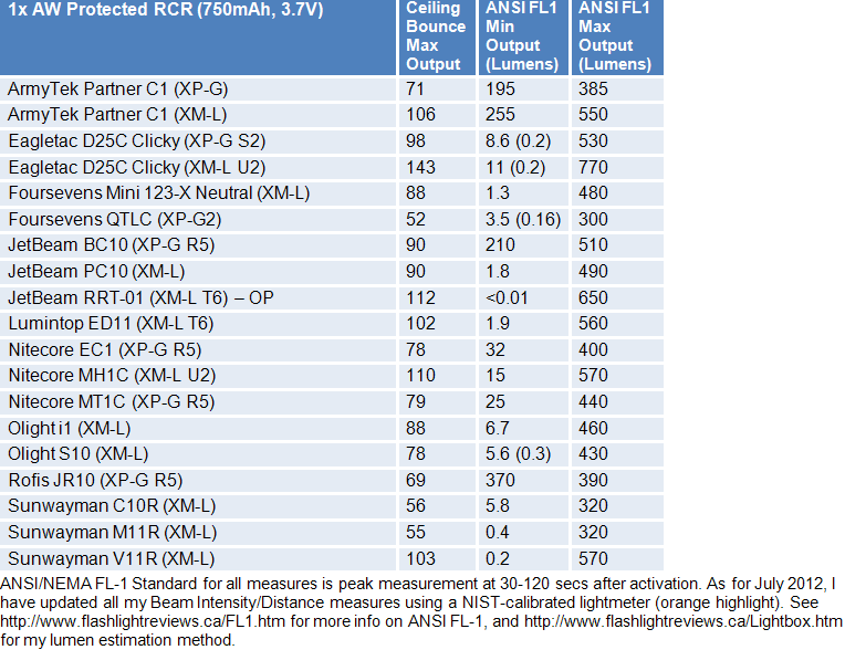

    1xCR123A/RCR:
    ArmyTek C1 XP-G: Weight: 42.6g, Length: 79.8mm , With (bezel): 23.1mm
    ArmyTek C1 XM-L: Weight: 43.0g, Length: 80.2mm , With (bezel): 23.1mm
    Lumintop ED11: Weight: 44.1g, Length: 83.7, Width (bezel): 21.8mm
    Foursevens QTLC: Weight 36.4g, Length 84.1mm, Width (bezel) 22.1mm
    Olight S10: Weight 41.1g, Length: 70.6mm, Width (bezel): 23.0mm
    Sunwayman C10R: Weight: 57.3g, Length: 76.2mm (no lanyard plug), 82.3mm (with plug), Width (bezel): 25.6mm, Width (head at widest part): 28.6mm
    Eagletac D25C Clicky: Weight: 30g, Length: 76.0mm, Width (bezel): 20.0mm
    Jetbeam PC10: Weight: 50.5g, Length: 93.6mm, Width (bezel): 22.6mm

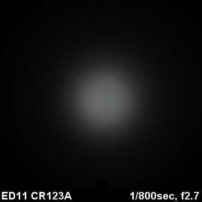

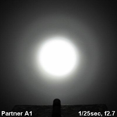

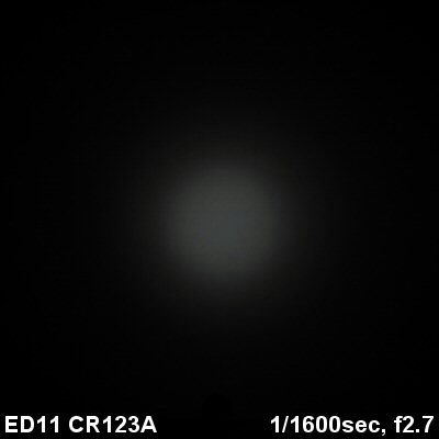

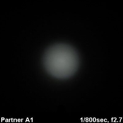

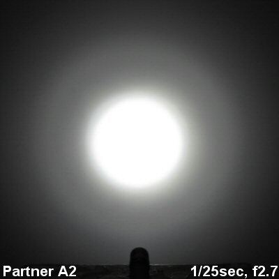

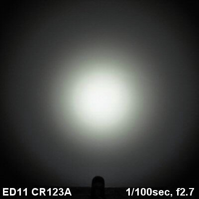

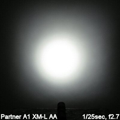

    Note: the XP-G Partner versions are not labeled with the emitter in the beamshots below. But to help you differentiate, all the XM-L versions are specifically identified.
    1xCR123A
    1xRCR

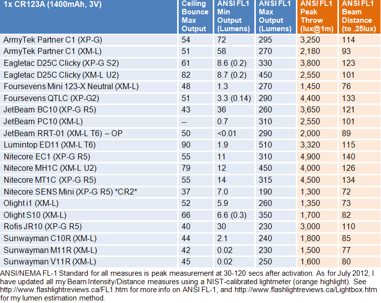

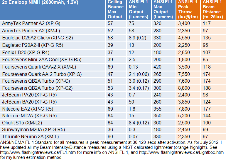

    Summary Tables

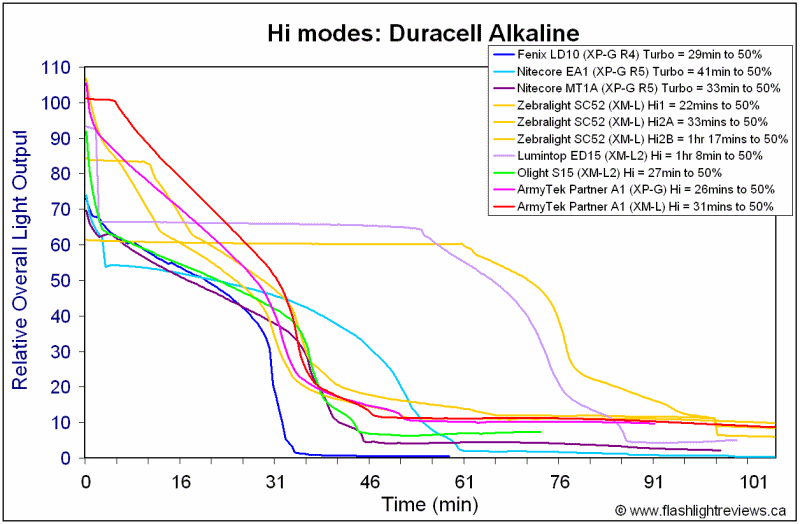

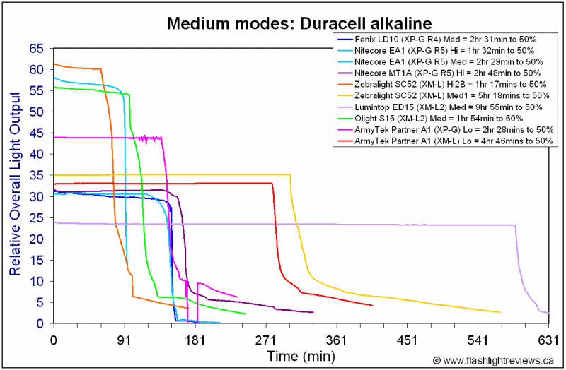

    Runtimes

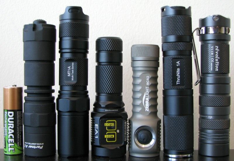

    Partner A1
    From left to right: Duracell NiMH AA; ArmyTek Partner A1 XP-G; Nitecore MT1A, EA1; Zebralight SC52; Thrunite Neutron 1A; Sunwayman V11R+AA extender.
    1xAA:
    ArmyTek A1 XP-G: Weight: 57.3g, Length: 96.8mm , With (bezel): 23.1mm
    ArmyTek A1 XM-L: Weight: 56.5g, Length: 97.2mm , With (bezel): 23.1mm
    Olight S15 1xAA: Weight: 46.4g, Length: 87.0mm, Width (bezel): 23.1mm
    Nitecore MT1A: Weight: 54.6g, Length: 104.6mm, Width (bezel): 22.7mm
    Nitecore SENS AA: Weight: 26.1g, Length: 82.7mm, Width (bezel): 19.8mm
    Lumintop ED15: Weight: 59.7g, Length: 100.2, Width (bezel): 21.9mm
    Zebralight SC52: Weight 39.5g, Length 79.0mm, Width (bezel): 22.6mm, Width (max) 25.4mm
    Rofis ER12: Wright: 35.5g, Length: 96.2mm, Width (bezel): 18.6mm
    Xeno E03:: Weight: 48.1g, Length 96.7mm, Width (bezel): 21.5mm

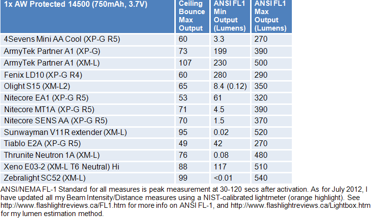

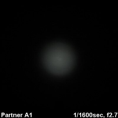

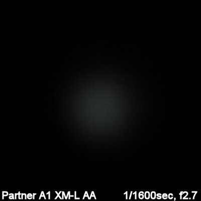

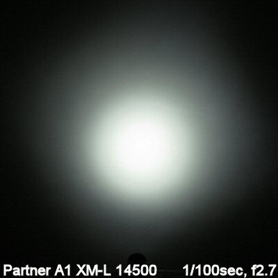

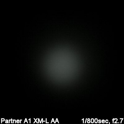

    1xAA Sanyo Eneloop NiMH

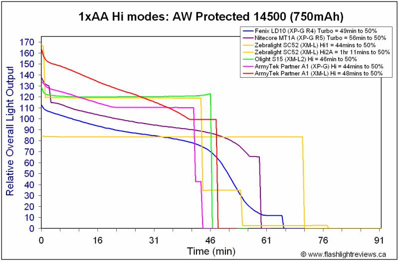

    1x14500 (AW Protected 14500) Li-ion
    Summary Tables
    Runtimes

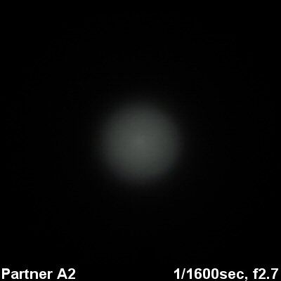

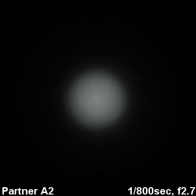

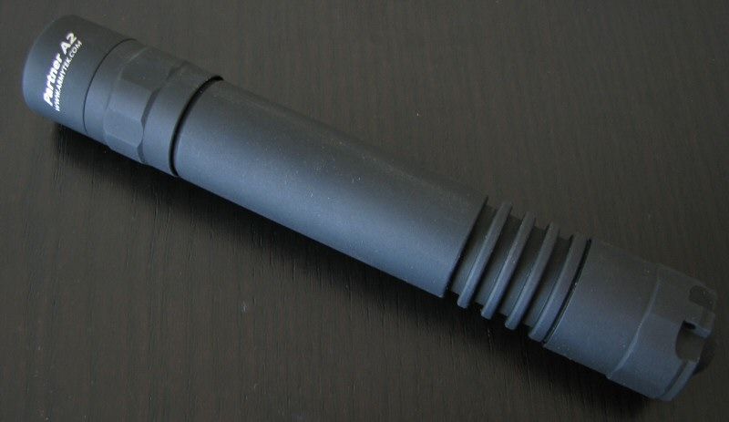

    Partner A2

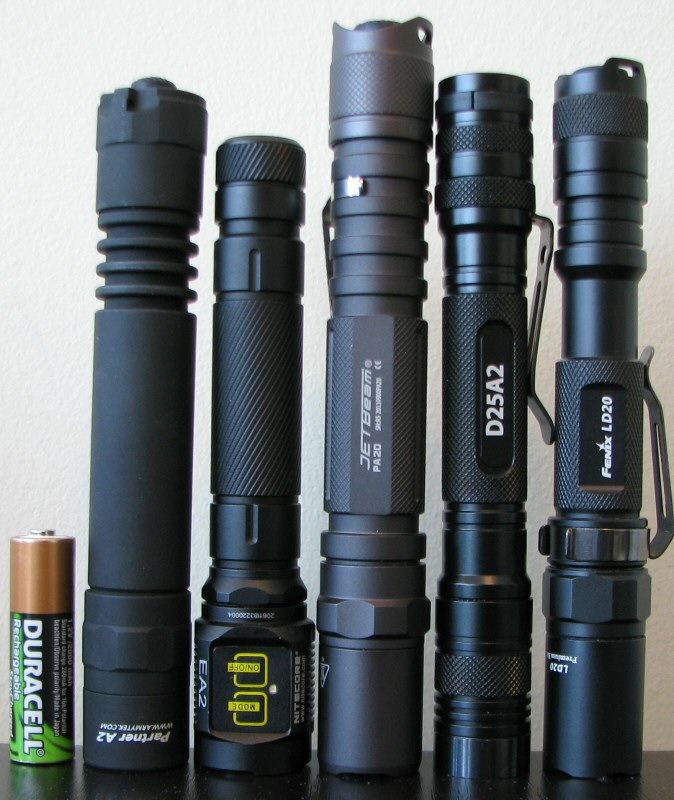

    From left to right: Duracell NiMH AA; ArmyTek Partner A2 XP-G; Nitecore EA2; JetBeam PC20; Eagletac D24A2; Fenix LD20-R4.
    2xAA:
    ArmyTek A2 XP-G: Weight: 83.4g, Length: 96.8mm , With (bezel): 23.2mm
    ArmyTek A2 XM-L: Weight: 84.2g, Length: 97.2mm , With (bezel): 23.1mm
    Olight S15 2xAA: Weight: 59.2g, Length: 137.9mm, Width (bezel): 23.1mm
    Nitecore MT1: Weight: 66.9g, Length: 154.3mm, Width (bezel):22.7mm
    Nitecore EA2: Weight: 68.9g, Length: 134.4, Width (bezel): 26.1mm
    Eagletac D25A2: Weight: 54.8g, Length 148.5mm, Width (bezel): 21.0mm
    4Sevens QAA-2 X (Tactical tailcap): Weight: 60.1g, Length: 149.1mm, Width (bezel) 22.0mm
    Jetbeam BA20: Weight: 70.2g, Length: 156.4mm, Width (bezel) 23.2mm

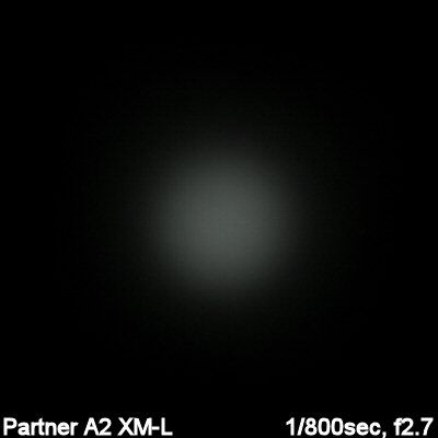

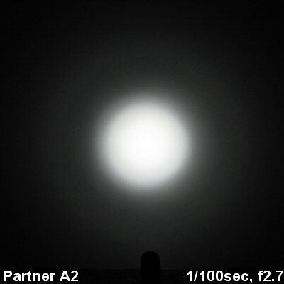

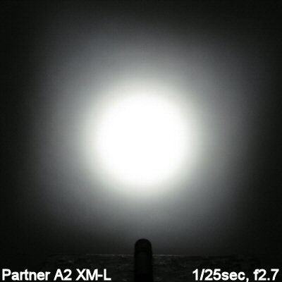

    2xAA Sanyo Eneloop NiMH
    Summary Tables
    Runtimes
    The extended retention of the output level state is unusual (i.e., it remembers what the last level used was for up to 7 mins, and will always advance to the next level during this time). This prolonged time is unusual, and I would prefer it if they behaved like most lights (where it is only a few seconds). (see Update at the end of this review)

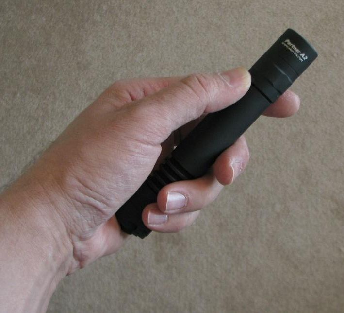

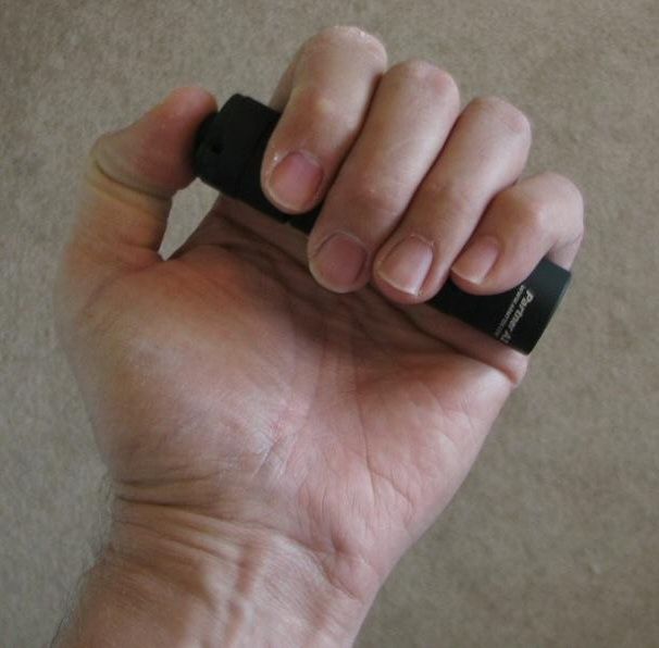

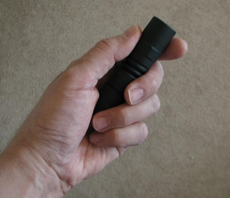

    There are very limited anti-roll features on the light, and no pocket clip is included. (see Update at the end of this review)
    Lights lack a true Lo mode (i.e., on standard batteries they are more of a Med/Hi, and on Li-ion batteries more of a Hi/Turbo). (see Update at the end of this review)
    Lights use TIR optics, customized to each emitter (i.e., center-beam throw for the XP-G, more diffuse for the XM-L). All optics tend to induce beam artifacts – most notably hotspot artifacts and spillbeam rings on throwers (like the XP-Gs), and "square" beams on floodier lights (like the XM-Ls).

    Circuit performance is also top-of-the-line, for their respective emitters and battery classes. No surprises here – both output modes of all models showed excellent regulation and output/runtime efficiency, across all batteries and over both emitters. It took a while for me to complete all the testing for this review (there is a lot of data up there!), and I am impressed to see such consistently good performance.
    User interface is perhaps the one sore spot for me – I am really not clear why the mode-switching state memory is 7 mins long. Typically, you either want a light to remember its mode indefinitely (and come back to it), or only allow a couple of seconds for mode switching purposes. Given that these are only two-stage lights, it's not a big deal – but it is frustrating to not always be certain which mode will show up upon activation. And personally, I would prefer a head tight/loose mode selection mechanism (with forward clicky for activation), but I know some people prefer to work with only the tailcap switch.
    The other point that could use a little refinement for me is the level spacing. Right now, the lights all typically offer what I would consider "Med/Hi" levels on standard cells (i.e., no real Lo mode). And on Li-ion, they are basically "Hi/Turbo" (i.e., even brighter, with little visual differentiation between the levels). Again, you are never going to please everyone with just two stages, but I would like to see the "Lo" mode drop further in output (especially on the XP-G versions).
    Beam patterns are also distinctive for the lines, with the TIR optics instead of reflectors. The XP-G optic is about what I would have expected (i.e., focused for throw, with minimal spill) - throw fans will be happy with this design. The XM-L optic is quite different, with a wider and squarer output beam. Both are well suited to their intended purposes, but differ from you might be used to (if you have dealt predominantly with reflectored lights). Please also keep in mind that the use of optics here may slightly affect the testing results, in terms of the relative output measures (i.e., the lightbox and ceiling bounce numbers may not be exactly comparable to reflectored lights). This is due to differing beam profiles of reflector and optics, which may not be interpreted entirely consistently in my simple setup.

    Thanks for another great review!! What are your thoughts on the performance of XP-G emitter, 1xAA using Eneloops? I'm surprised to see higher output (and consequently, lower runtimes) when compared to XM-L.
    6,936
    Default Re: ArmyTek Partner A1, A2, C1 Series (XP-G and XM-L, AA and CR123A) Review: RUNTIMES
    Quote Originally Posted by sspc View Post
    Yes, the XP-G version seems to be driven harder on max than the XM-L (hence the much lower runtime). Don't know why. Note that it is hard to get accurate output comparison numbers, given the very different beam profiles (i.e., the lightbox and ceiling bounce measures may not be entirely consistent).

    It seems like they accidentally put the wrong driver in their XM-L lights. From pictures it looks like with a different driver (or with a RCR123A) the beam pattern on the XM-L is supposed to be the same type and Lux as the XP-G with a larger hot spot.
    Odd since Armytek has a history of getting good drivers in their lights and running them quite high.

    340
    1AA eneloop is 300 lumens
    1Cr123 is 295 lumens
    2AA eneloop is 320 Lumens
    This does not make sense to me as 1 eneloop is brigher than a CR123 version of the light? Is this right?
    Feb 2013
    Michigan, USA
    3,631
    Quote Originally Posted by iocheretyanny View Post
    Not only is the AA brighter than the CR123 version, if that is correct it will be the new king of AA lights. I have never before seen a light that can beat the Zebralight SC52 at 280 lumens on a single AA. If that number is correct, the SC52 no longer holds the title for brightest AA light!
    Just did some more reading of Selfbuilt's charts. Looks like the Armytek loses most modes - low mode is almost 200 lumens with a 14500! Not cool. The SC52 maintains all modes regardless of NiMH or 14500, and only high mode changes, until the stepdown, after which modes are identical. Still, 300 lumens from a single AA is impressive.
    6,936
    Quote Originally Posted by thedoc007 View Post
    Not only is the AA brighter than the CR123 version, if that is correct it will be the new king of AA lights. I have never before seen a light that can beat the Zebralight SC52 at 280 lumens on a single AA. If that number is correct, the SC52 no longer holds the title for brightest AA light!.
    It doesn't beat the SC52 - in my testing, my two samples are equivalent in output. It might be helpful if people check out the runtime graph:
    As you can see, the A1 XP-G suffers from considerably lower runtime than the SC52 XM-L, for the same initial output (as you would expect, for the emitter difference). The A1 XP-G is in essence over-driven, compared to all the other XP-G lights in my collection.
    In terms of comparing it to 1xCR123A C1 XP-G, initial output is again comparable. And again, the end result is much lower runtime on the A1. If you look at the C1 output/runtime graphs, you'll see that it takes about ~80 mins to reach the ANSI FL-1 standard of time to 10% output on CR123A (compared to ~35mins on the A1 XP-G on eneloop).
    These results are all completely consistent - the A1 XP-G is unusually heavily driven on max, resulting in unusually low runtimes.
    Feb 2013
    Michigan, USA
    3,631
    While I appreciate all the extra info, I was basing my statement off your chart. ANSI FL1 Max Output, on Eneloop. 300 for the A1, 290 for the SC52. Last time I checked, 300 was more than 290. Yes, I understand runtime is shorter. And yes, I understand that no one can tell the difference between 290 lumens and 300 lumens anyway, especially since they have different beam profiles. With all that said, though, The A1 does appear to have a higher maximum brightness on an Eneloop, under ideal conditions, than the SC52. This is all I wanted to note. I wanted to make that point only because I have seen the SC52 mentioned several times (here on CPF and elsewhere) as the brightest single stock AA light in existence. If nothing else, now there will have to be an asterisk by that claim. (Unless I am just missing something, in which case feel free to correct me.)
    Selfbuilt, I hope you take this is it was intended, only to explain my rationale. I am always amazed at the quality of your reviews, and the time you spend giving us a standardized and reliable source for comparisons.
    I just realized that my "king of AA lights" phrase was asking for touble. I should have clearly defined what I meant, may have avoided this debate entirely. I was assuming everyone would know what I was referring to, but after re-reading my post, that was not a reasonable assumption. With the additional clarification, hopefully we are now on the same page.

    6,936
    No worries. I can understand why 290 would seem different from 300 (when in fact they aren't really, for the reasons you outlined - plus natural sampling and testing variation). I always struggle with what's a reasonable level of specificity in the measures, which is why I always encourage folks to take them with a grain a salt.
