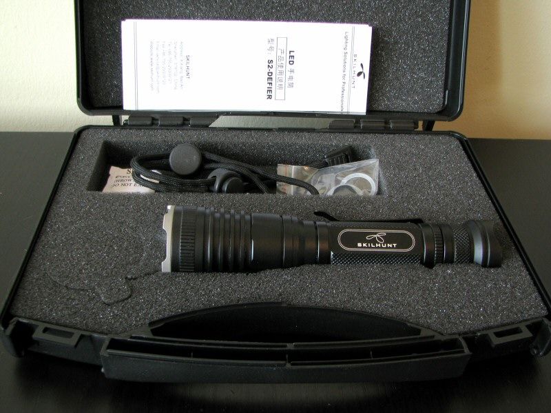

    The S2 comes in a presentation-style plastic carrying case, similar to the ones from other makers. Included with the light are spare O-rings, extra tailcap button cover, good quality lanyard, and manual.
    From left to right: Eagletac Protected 18650 2400mAh; Skilhunt Defier S2, Defier X1, K10; Olight M21-X; ArmyTek Viking Pro; Eagletac G25C2 Mark II.

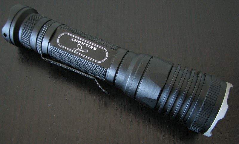

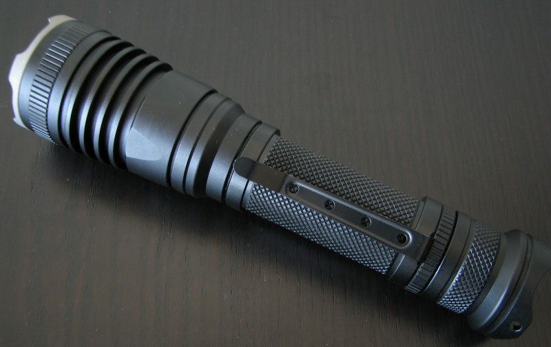

    The appearance of the S2 has changed somewhat from the earlier Skilhunt models (i.e., a little less "flair" in the head now). But the overall build and design is actually pretty consistent with the earlier Defiers (and with other lights of this class).
    Anodizing is a matte finish, hard anodized (i.e., type III). Body labels are bright white and sharp against the black background. The S2 has knurling on the body and a band on the tailcap – but it is not very aggressive. The head has concentric ring fins - likely to help with heat dissipation, but also serve to enhance grip. With the pocket clip installed, I would definitely consider grip to be above average for the class. Note that the clip can be removed, and there is a screw-on ring cover for the clip attachment point.
    Screw threading is standard triangular cut, but quite thick and of good quality. Threads are anodized at the tailcap to allow for lock-out.

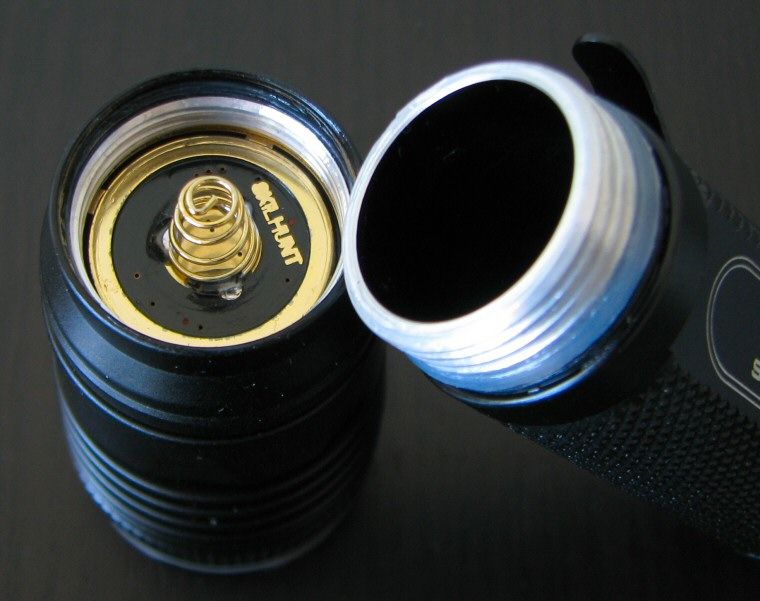

    There is a spring mounted on the positive contact board in the head, so flat-top cells can be used In the light.

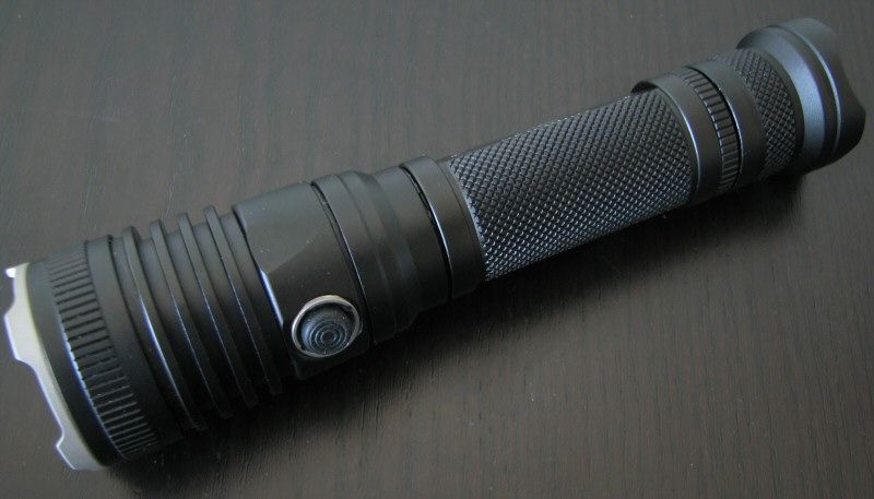

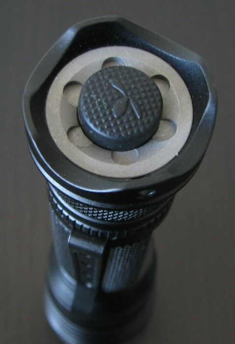

    Like the earlier Defiers, there is an extending region around the tailcap switch, scalloped to facilitate finger/thumb access to the switch. Tail switch is a forward clicky, with traditional feel (used for on/off control). The light can tailstand stably.
    There is a secondary switch in the head, used for mode switching. This is an electronic swtich, with typical feel for that class. The black boot cover projects a fair amount, making it relatively easy to find by touch.

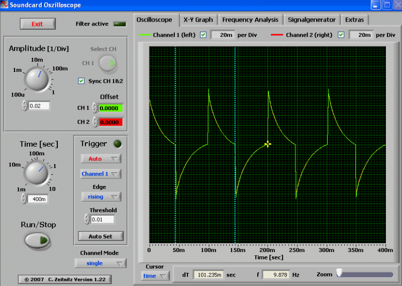

    PWM/Strobe
    One of the main issues with the early Skilhunt lights was the very visible low-frequency pulse width modulation (PWM) on the lower output modes. I am happy to report that I can detect no sign of PWM on the new S2 – neither by eye, nor on my sound card oscilloscope.
    There is some weak 900 Hz noise on Lo/Med/Hi detectable on my oscilloscope, but it is not visible to the eye:
    Again, this is not PWM, and I can see no visible sign of it (even when shining on fan). All intensity levels seem completely stable and flicker-free.
    The strobe is a fairly typical fast "tactical" strobe, of 9.9Hz frequency.
    SOS mode is also fairly typical.

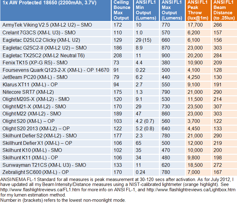

    Beam pattern and overall output are very similar to the Olight M22 and Eagletac G25C2-II XM-L2.
    The S2 is slightly more highly driven on 2xCR123A/RCR compared to 1x18650, but this is common for many lights in this class. Overall output and peak throw of the Defiser S2 are very similar to my other recent heavily-driven XM-L2 lights (e.g., Olight M22, Eagletac G25C2-II, TX25L2, etc.), especially on 2x battery sources.
    My peak intensity throw and beam distance measures match the reported ANSI FL-1 specs.

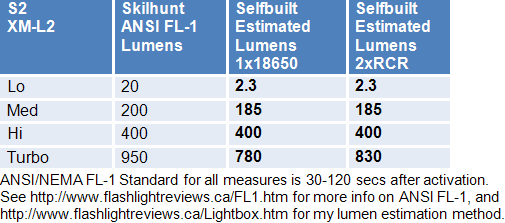

    Overall, my lumen estimates are pretty close to Skilhunt's (although my Lo mode seems lower than expected).
    As always, it bears repeating that my estimated lumen scale is just that - an estimate, based on a consistent calibration of my lightbox. But even though the absolute value correlation is unknown, the relative comparisons still hold. All I can really say is that one light is higher or lower than another, by a certain relative percentage. So please don't get hung up on the absolute values of the estimates, or on small relative percent changes.

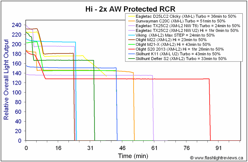

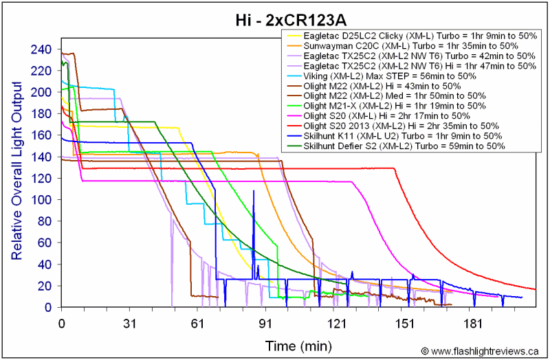

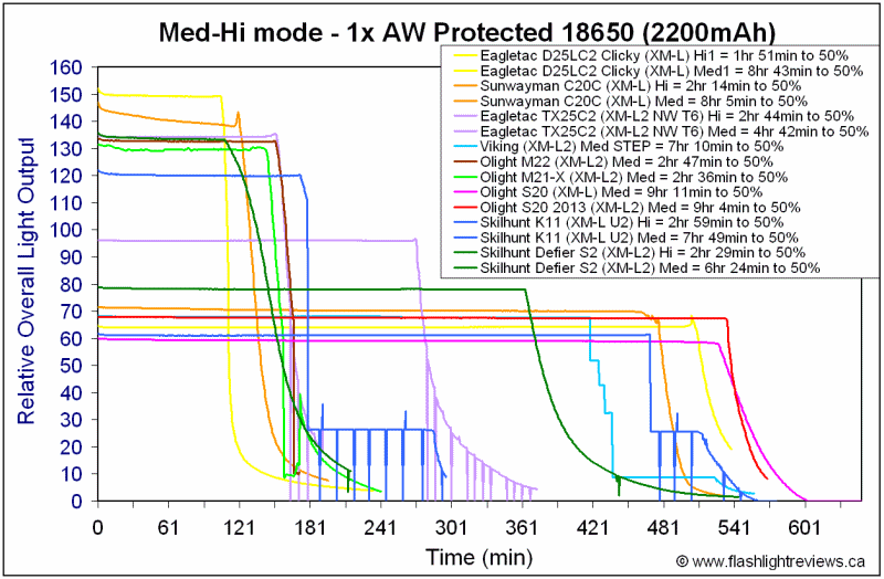

    Output/Runtime Graphs:
    Like many high-output lights, the S2 has a defined step-down on Turbo (after 3 mins of continuous runtime in this case). On 1x18650, the light maintains regulation for as long as it can after this step-down, and then drops into direct-drive as the battery nears exhaustion (i.e., a fairly typical pattern). The light is fully flat-regulated on 1x18650 on the lower levels (and on all levels on 2x battery sources).
    On all batteries, overall efficiency is very good - at all output levels tested - consistent with a current-controlled light.
    And again, you can see that Skilhunt's runtime specs seem pretty for 18650. Note that ANSI FL-1 standard is time to 10% output, and most manufacturers use higher capacity cells than mine above. I am confident that 3100mAh or 3400mAh 18650 would meet the official runtime specs.

    Great review - one quick question.
    The manufacturer's data says low is 20 lumens. Your chart says 2.3. Which is correct?
    As to the UI- I like this kind of UI as it woudl allow one handed operation (sort of) which is important to me.

    Quote Originally Posted by tubed View Post
    Aye, there's the rub.
    My measurement is "correct" for my sample, in terms of how it performs relative to all the other lights in my collection. See my flashlightreviews.ca FAQ and Method pages more information on the testing methods and calibration standards.
    The question is whether my sample is typical or not. There can often be more variation at the low-end of output among samples. Or it could be that all the lights are lower than spec. I can't say on the basis on just one sample.

    Default Re: Skilhunt Defier S2 (XM-L2, 1x18650 2xCR123A/RCR) Review: BEAMS, RUNTIMES, VIDEO+
    thanks
    Unfortunately, the difference between 20 and 2.3 lumens is pretty important for me.
    In your video it certainly looks more like 2 than 20.
    I guess we won't know until a few folks buy them and report back.

    Just went to the Skilhunt website.
    They list 5 lumens as the low on this light
    6,936
    Hmm, yes, I see it says that now in the ANSI FL-1 chart. But on the same slide, right next to that in the spec table, it still says "20 lms / 150 hours". We'll see if they update that table too.

    I also did not understand very clearly the meaning of the 900 Hz noise. What does it mean practically? One doesn't see it, but does this also mean that the quality of the circuit is inferior to that of the competition's lights? I would appreciate if you clarify that for me.
    It means nothing. The circuit noise is something that my oscilloscope detects, so I report on it. But it has no practical implications - you cannot see it. I don't think it's appropriate to infer any quality indicator to the fact that it is there - many circuits show some detectable noise in my setup.
    The reason I don't just ignore circuit noise in my reviews is that that it's not uncommon for others to detect these sorts of reoccurring signals in their testing (using simpler non-oscilloscope means). Commonly here, you will see people jump to the conclusion that any form of signal means a given light uses pulse-width modulation (PWM). But my oscilloscope clearly differentiates non-visible noise from visible PWM, so I feel it's important to draw attention to this (i.e., it puts the signal results other may obtain into proper context).

    Selfbuilt, thanks for these clarifications! I will check the head and the threading myself before buying the torch although from what you say I cannot suspect any potential issue. Clearly, the light is an improvement over the previous models: it has the double anti-recoil spring of the X0, reverse polarity protection, matte finish, intuitive interface. Ideal tactical light. If some detail doesn't disappoint me, I will definitely get it. Thanks again!
    I just unscrewed the head of mine S2.
    Anyway - it's very nice made model, very useful and convenient :-)
    6,936
    Quote Originally Posted by Andrey_Nikolov View Post
    Yes, just confirmed on mine - the part just below bezel unscrews as well, giving you access to the reflector. I'll edit my previous comment.
