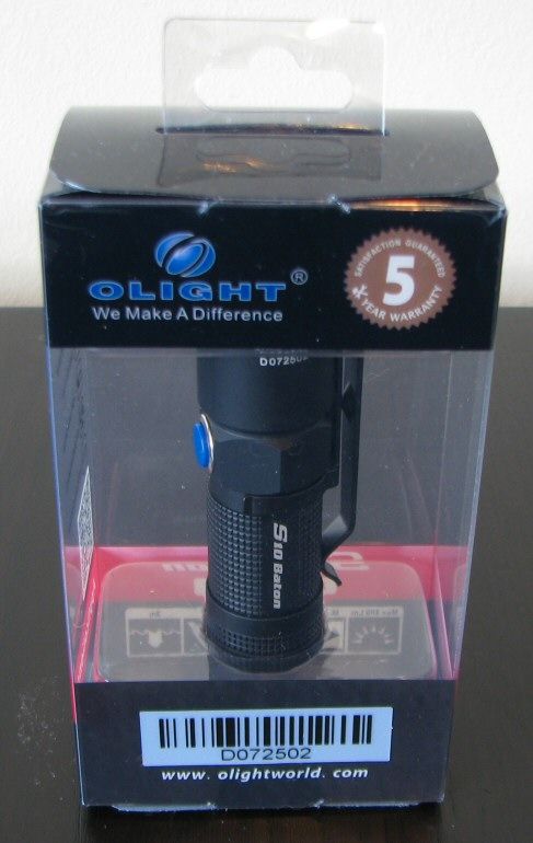

    The packaging has been updated, and the new 2013 editions all look the same (i.e., similar to my recent S15 review). Inside the clear plastic container are the light, extra o-rings, a simple wrist lanyard, replacement for the tailcap magnet, and manual. There is also an overview of specs on the bottom and back of the packaging.

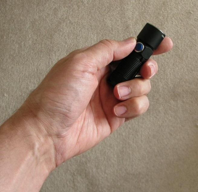

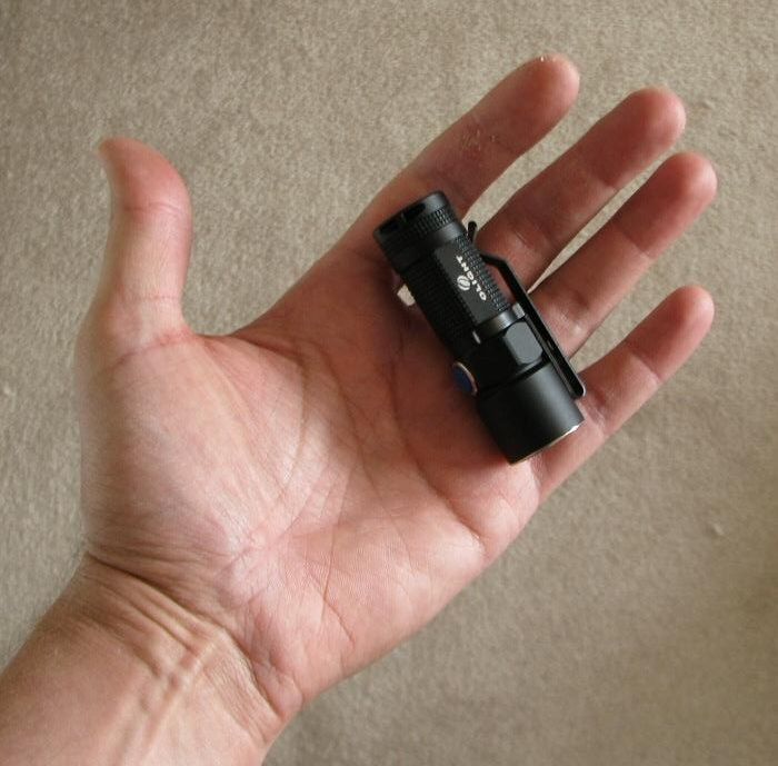

    Overall dimensions are very similar to the original S10, and other compact lights in this class.

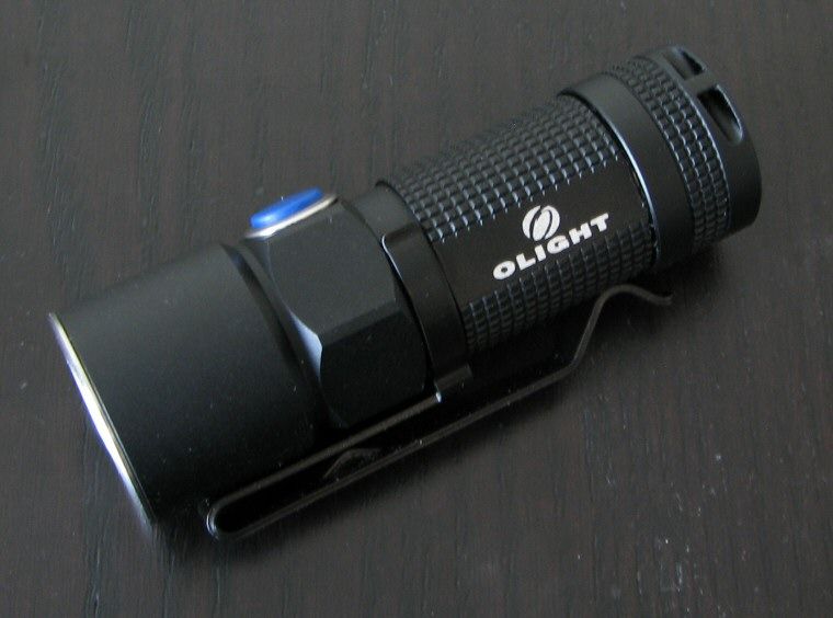

    Physically, the new 2013 editions of the S10 and S20 look generally similar to the old ones. These lights are all quite petite for their respective classes. Lights come with black anodizing (matte finish) and bright white labels. Although still without typical knurling, the raised checkered patterns on the body help with grip. With the pocket clip attached, I'd say grip is reasonably good.

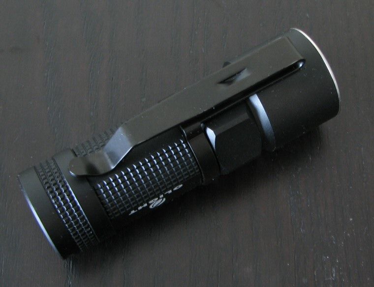

    The pocket clip is comparable to the earlier models, no real change for the later-model S10a. It seems to hold onto the light fairly securely. I personally like it, as you can clip it on you in either orientation (i.e., bezel-up or bezel-down carry), although it might be rough on clothing given how tightly it fits.

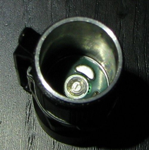

    The original S20 had a spring in the head, but the original S10 had a flat contact with reverse-polarity detectors beside it. The new S10 for 2013 has a small spring (but oddly the reverse-polarity detectors are still there). But this spring presumably also helps with maintaining battery contact stability in jarring environments.
    Like the other Batons, the S10 2013 uses the same square-cut screw threads as before (anodized for tail lock-out, like the earlier S10/20).

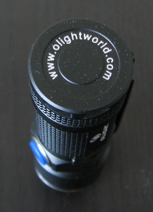

    Light can tailstand, and there is a split-ring/lanyard attachment hole on the side of the tail cap as before. The tailcap in fact seems identical to the original S10, with the same removable strong magnet (i.e., firm enough for the light to stand horizontally off any vertical metal surface). I previously prepared a video of the S10, showing you how to swap out the magnet in the tailcap:
    Note that they seem to have improved the design, as I no longer notice any rattle on the tailcap (as I did on the original S10/S20 with the magnet installed).

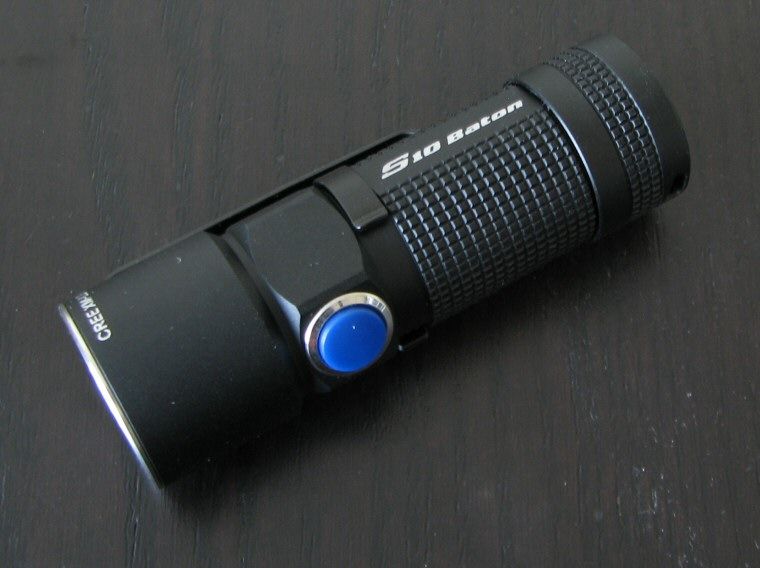

    As before, the light uses an electronic switch, located near the head. However, the user interface has been updated from the earlier S10 (see below). And the button design has changed – no longer a soft silicone cover, the new cover is a much harder blue plastic. Note that there was never a low voltage warning sensor on this model (i.e., there was no LED under the switch), so this change is really more cosmetic than anything else.
    As before, the light has a flat stainless steel bezel ring with a red o-ring, and a lightly textured reflector. One difference – the lens anti-glare coating is not as pronounced now. This is actually good news, as I (and others) had found that the anti-glare on the original S10/S20 lens was contributing to the relatively greenish tint. Tint is therefore improved slightly on the new S10 2013.

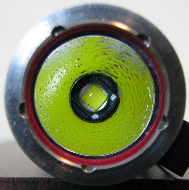

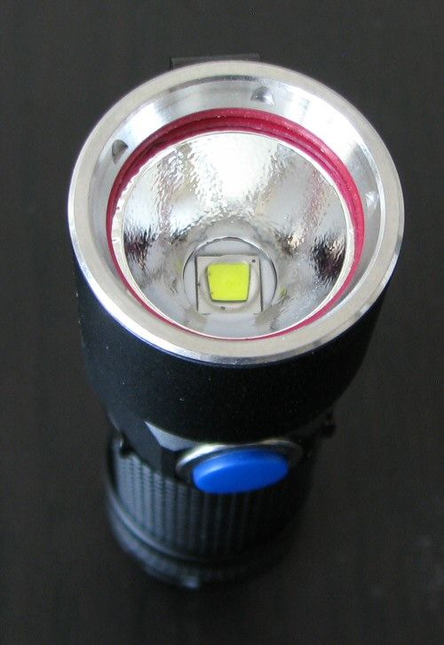

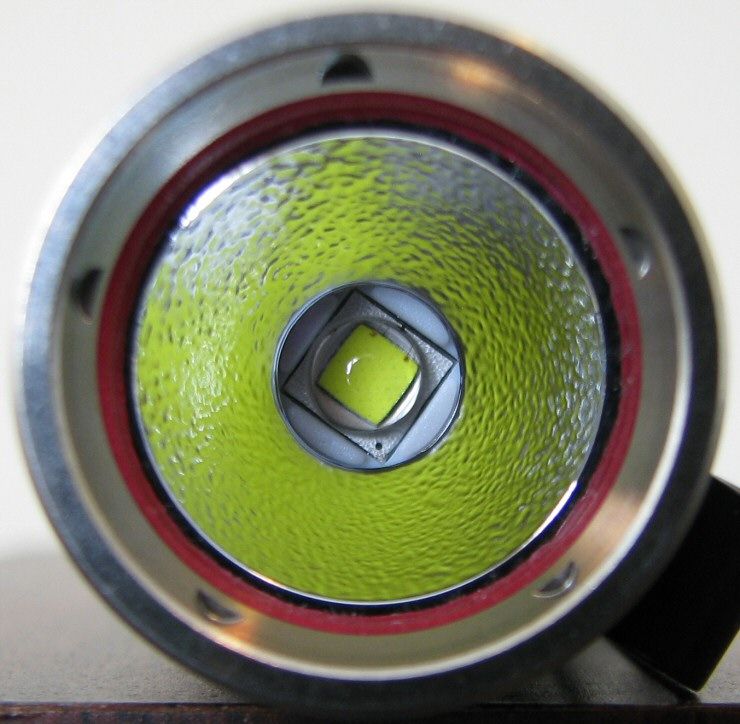

    The main build difference is that S10 has been updated with a XM-L2 Cool White emitter now. The plastic surround has been changed from black to white, but the emitter remains well centered. The reflector remains relatively smooth finish, like the older S10/S20 lights.
    BTW, here is what the old S10 XM-L looked like.
    S10 XM-L
    Note the visible grid over the die, 3 bond wires, and green mask surround. These are all classic signs of the XM-L emitter that have been revised on XM-L2 (i.e., no grid, 2 bond wires, and silver mask on XM-L2).
    The S10 2013 interface has been updated from the previous S10, and is now the same as the recent S15.
    Like the other Baton lights, the S10 uses an electronic switch for on/off and mode control. As before, a quick press and release (i.e., click) turns the light on/ off.
    Mode switching is controlled by holding down the electronic switch. The light will cycle between Lo – Med – Hi, in repeating sequence. As before, simply release the switch to select your desired mode. The light has mode memory – if you turn it off/on, the light returns to your previous level.

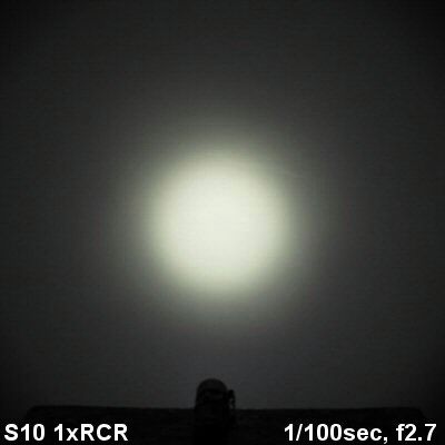

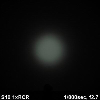

    Beam pattern remains very similar to the original S10, as you would expect (i.e., the Batons are all relatively "floody"). The main differences are a little more output on Hi (due to the XM-L2), and a slightly improved tint (which you can't tell above, due to the auto white balance).
    The reduced anti-glare coating of the lens on all the 2013 Baton models has reduced the green tint-shifting somewhat, on all my samples. Note that it is common to see warm (i.e., green-yellow) tint shifting at lower outputs on current-controlled lights like these. The original anti-glare coating was exacerbating this tendency, however (by shifting more purple light to the beam fringes and allowing more green light through the center hotpot).
    As you can start to see above, there isn't much of a difference between the new S10 2013 XM-L2 and original S10 – aside from a little more output and throw on Hi.
    Also as before, there also isn't a big difference in output levels between CR123A and RCR.

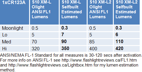

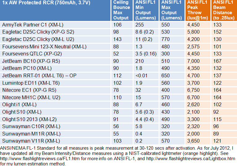

    To better illustrate the output differences between the old and new model, here is a detailed output comparison on 1xCR123A.
    Overall, my lumen estimates are pretty close to Olight's specs.
    As always, it bears repeating that my estimated lumen scale is just that - an estimate, based on a consistent calibration of my lightbox. But even though the absolute value correlation is unknown, the relative comparisons still hold. All I can really say is that one light is higher or lower than another, by a certain relative percentage. So please don't get hung up on the absolute values of the estimates, or on small relative percent changes.

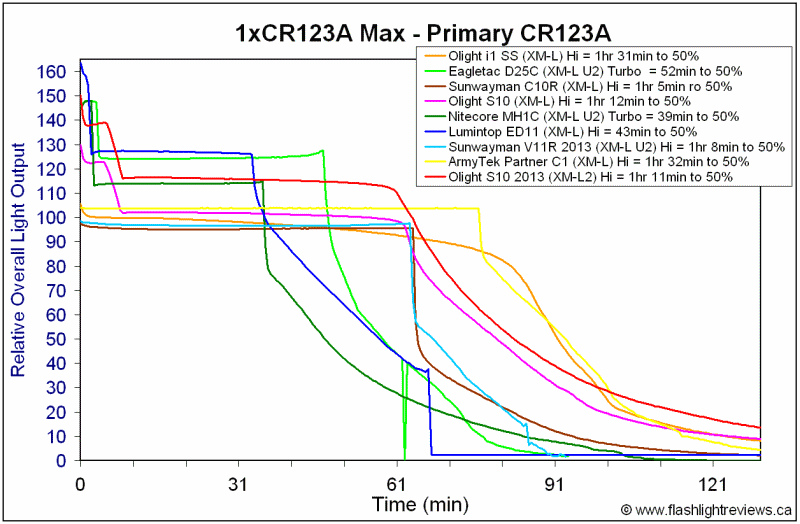

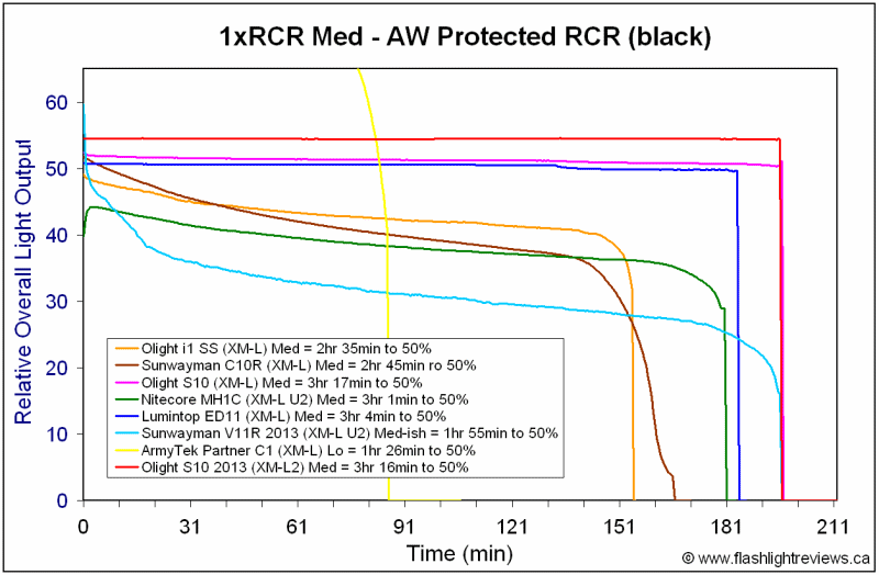

    Output/Runtime Graphs:
    Like many recent lights in this class, the S10 continues to have a defined step-down on Hi (after 4.5 mins of continuous runtime in this case). The difference on the Olight S10 series is that the step-down is gradual, taking about 4 mins to level off at the lower Hi level. This is unchanged from the original S10, and continues to mean that you are unlikely to notice the step-down on this series. Note that you can turn the light off-on to restore initial max output.
    The output/runtime curves for the new S10 do not look appreciably different, except for a small bump in output on Med and Hi (thanks to the higher output bin XM-L2 used, presumably). As before, on all batteries, overall efficiency is excellent at all output levels tested.

    Quote Originally Posted by zs&tas View Post
    great review ! ive become a big olight fan and use them more than others now. i have a bit of a strange question but im wondering what the total runtime on rcr in strobe would be ??
    Well, the strobe mode is a 50:50 on: off cycle. So, presuming output Is a full power strobe, that would mean about twice the runtime of max on RCR. But I don't have the light in front of me at the moment, so can't confirm the output level.
    Jan 2009
    UK
    1,075
    Default Re: Olight S10-L2 (S10 2013, XM-L2, 1xCR123A/RCR) Review: RUNTIMES, BEAMSHOTS, VIDEO+
    thanks SB. about 1hr40 then ish. would you off the top of your head know of a light that dosnt use 100% brightness on strobe ?
    6,936
    It is not something that I have ever set out to measure, but I have on occasion noticed a few strobes that don't seem to be full power. Can't think of a specific light off hand - if you do a search here, you may find some examples.
    Note also that most strobes are indeed 50:50 pulses, but some are not (especially among the really high frequency ones). The S10 is definitely 50:50.

    Quick question: S10 on full whack draws ~960mA according to a review I read. In contrast the Trustfire mini-02 with the same battery and emitter draws over 2A. Am I correct to assume this limiting in the Olight was done to balance brightness with runtime?
    6,936
    Quote Originally Posted by spark001uk View Post
    Yes.

    Does anyone know what bin the L2 used in this model is?? (From what data I can find I would guess about a T6 or U2?)
    6,936
    Olight doesn't usually disclose output bin info (in fact, they may not even purchase defined bins). If defined bins are sued, I would presume a T6 is most likely, but U2 is possible.
    Ok thanks for the info. Would you happen to have carried out any running current measurements on this light at all?
