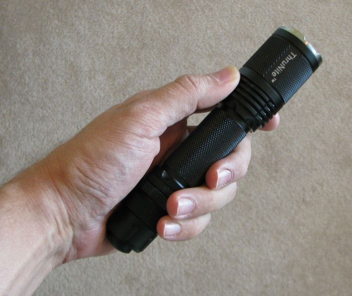

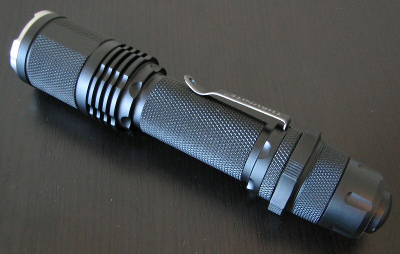

    The body of the light seems virtually unchanged from the previous Scorpion version in terms of overall build (i.e., just some label changes). But there are some significant changes to the tailcap, including all the weight difference in the light (see below).
    Black anodizing (type III = hard anodized) is in matte finish, similar to the other Thunite series. Lettering (which is even more minimal now) is bright and clear. Knurling is fairly aggressive, and there is a generous amount of it over the light and tailcap. Grip is good, especially with the removable clip and built-in tailcap aluminum grip ring.

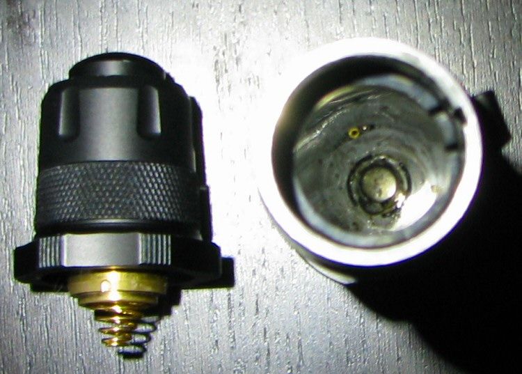

    Square-cut screw threads are anodized for tailcap lock-out, as before. Light cannot tailstand.
    There is no longer a spring on the positive contact plate in the head, but it is slightly raised (ensuring contact for flat-top cells). All my recent high capacity cells fit fine in the light
    Clip now has Thrunite written on it.

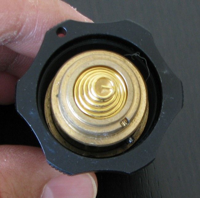

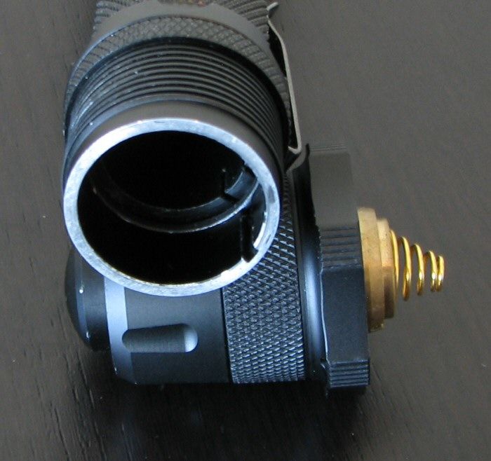

    Let's take a closer look at the tailcap …

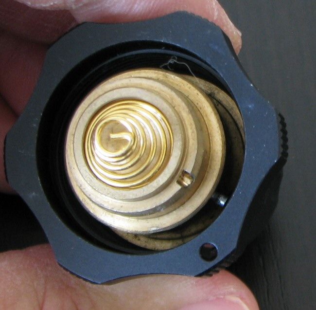

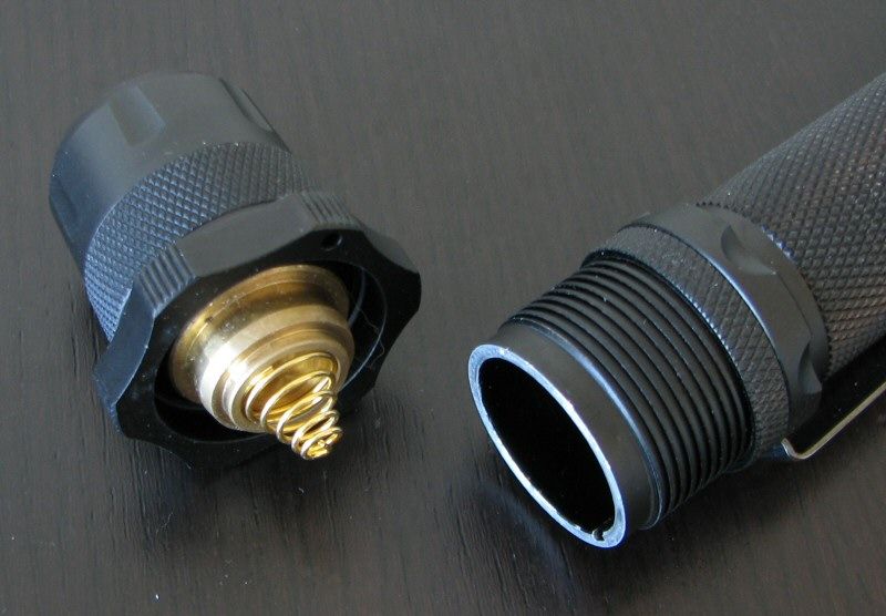

    Although superficially similar, Thrunite has switched to all-metal construction for the Lynx (i.e., gone is the polymer button and control ring). The internal construction seems to have changed as well, as the weight of the tailcap unit is much higher now (i.e., the original Scorpion tailcap weighed 31.0g, and the new Lynx weighs 83.0g – with no change to the rest of the light).
    As before, the control ring is directly connected to the substantial spring assembly unit inside the head, and the whole area spins freely when the tailcap is not attached. Clearly patterned on the Night-Ops Gladius originally, it has undergone some significant revisions in this latest Thrunite model.
    For more on how the control ring functions – and how the interface has been updated – please see my User Interface section below.

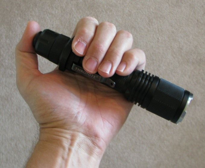

    As before, the light feels quite solid and durable overall – perhaps even moreso now with the all-metal tailcap.

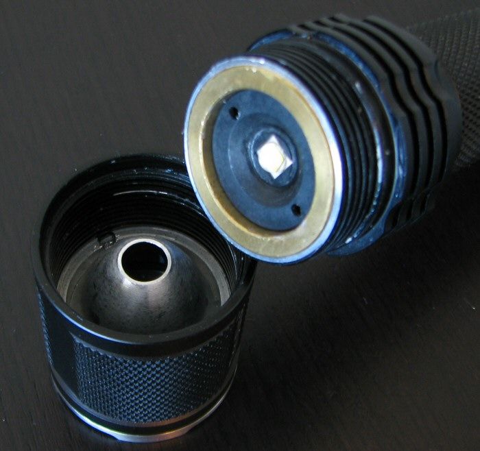

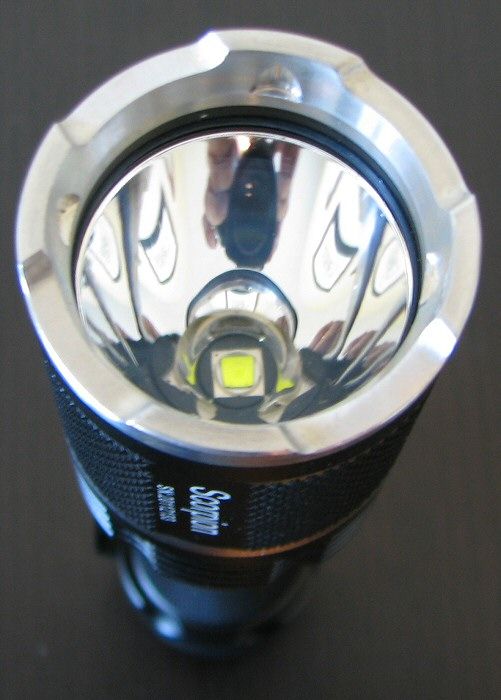

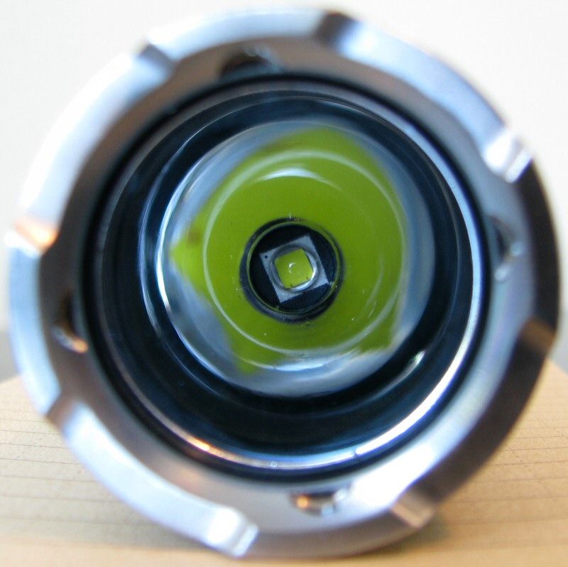

    Reflector is smooth, and reasonable for the size. Coupled with the XM-L2 cool white emitter (which was well centered on my sample), I would expect ok throw with reasonable spill (scroll down for beamshots).
    Note that was an optional Turbo head for the Scorpion, which offered more throw (i.e., larger and deeper reflector). From my original Scorpion V2 review:
    And on the new Lynx:
    As before, the Turbo head doesn’t look out of place on the light (in fact, they could probably have gotten away with an even larger one). There is no knurling or markings on the Turbo head sample I was sent, and I don't know what is currently available.

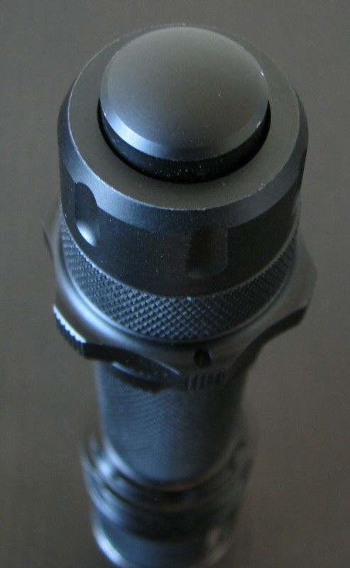

    As before, control of light is entirely through the tailcap. When fully assembled, you will feel four clear detents on the control ring for the four programmable output modes of the light. Ring feel is somewhat similar to before, despite the all-metal construction now. The metal button is used to control on/off and mode setting. Modes have changed from the earlier Scorpion light. The main difference is that each of the four mode positions is now fully programmable.
    To activate, press and release the switch to turn the light on (i.e., click) – in whichever mode the control ring is set to. Each mode has memory, and retains the last setting used. Press and release the switch again to turn off.
    Note that if you want to change modes by turning the ring, you need to click the switch again. In that sense, the light acts like reverse clicky, and can't change modes without a reset of the main switch. Note that you don't need to turn off/on – a simple single click of the switch resets the light to the new current mode, once you've turned the ring.
    To set the memorized level of any mode, press-and-hold the tailswitch from Off. The light will ramp through its output levels, including a continuously-variable ramp. As before, the ramp has a quick reverse function (i.e., it changes direction if you release the switch and re-press from Off). Ramping time is longer now (see graph below), and shows a different pattern.

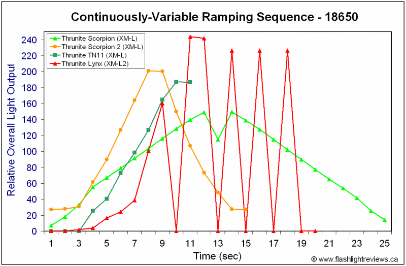

    To help you make sense of the above, it takes ~9 secs for the Lynx to ramp from the minimum output to max output. The light flashes twice at this level (which you'll see as the dip at time 10 secs above). You then get ~2 secs at this max level below the slow strobe starts (the next recording dip at time 13 secs). The slow strobe lasts for about ~2 secs, and then immediately switches to fast strobe for another ~2 secs. All told, after ~16 secs, the light restarts the ramp from the minimum level. Let go of the switch at any time to set the mode level.
    You'll note in the above ramping trace that the Lynx has a much lower minimum output than the Scorpion V2.
    Another change is that the switch ring lockout mechanism is gone now, replaced by an electronic lock-out. Previously, you could lock out the Scorpion by partially depressing the switch in the left-most mode of the ring, and turning the control ring further to the left (i.e. counter-clockwise). This was always a bit fussy though (i.e., you could accidental lock the light on sometimes). Then, as now, I prefer to physically lock out the light by simply unscrewing the head a quarter turn (i.e. by holding the base of the tailcap and turning). But Thrunite has also supplied an electronic lockout on the Lynx - press the switch three times rapidly. The light will remain off until you triple-click again.
    Note that control circuit in the tailcap works by detecting the presence of magnets in the light. As a result, a strong magnet waved near the tailcap can have the effect of changing modes (i.e., acts as if the ring is turned and the switch clicked). Apparently, the new electronic lock-out is resistant to magnetic activation (confirmed in my testing - I was unable to get it to come one when the triple-cllick lockout was engaged).

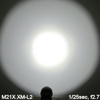

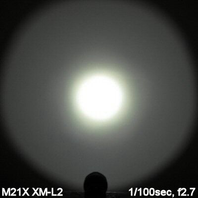

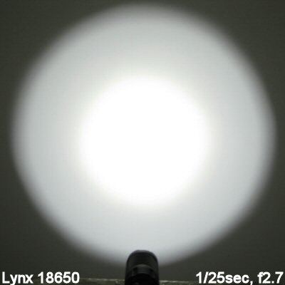

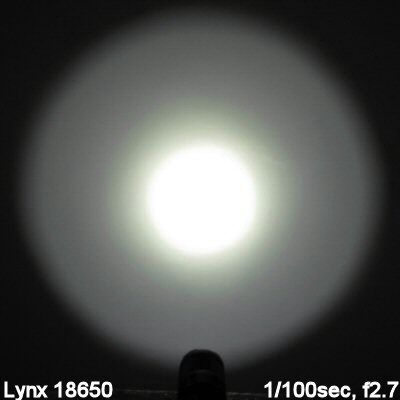

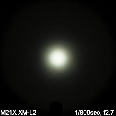

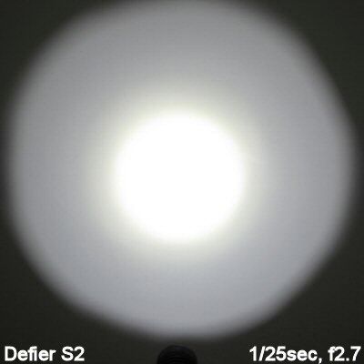

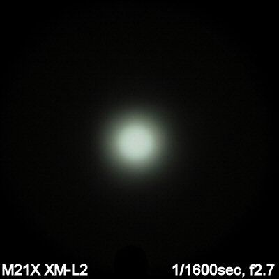

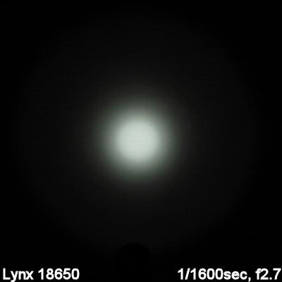

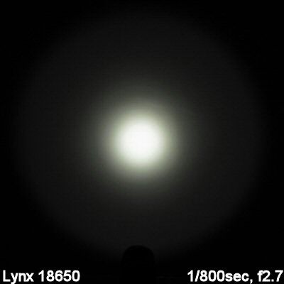

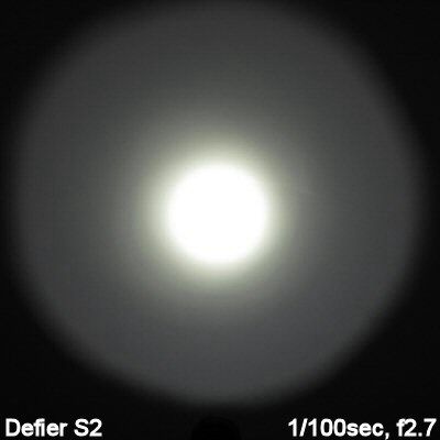

    Beam pattern is similar to other lights in this class and size. Output is definitely high though, compared to other lights.
    Note that the slightly larger Throw head from the previous Scorpion fits and works one Lynx, and increases the throw. Scroll down to my output tables below for more info.

    For outdoor beamshots, these are all done in the style of my earlier 100-yard round-up review. Please see that thread for a discussion of the topography (i.e. the road dips in the distance, to better show you the corona in the mid-ground). I think this batch of outdoor beamshots looks fairly good, due to all the Fall colors in the trees.
    Sorry, my positioning was a little off on the standard head Lynx shots, but this should still give you the general idea. As is clear above, the Lynx has greater overall output than the SRT-7. In terms of throw, the standard Lynx head is slightly more thowy than the SR7 (but that's really due to the greater overall output). The Turbo head option definitely gives the Lynx greater throw.
    Also, please ignore any tint differences above – they are mainly due to the automatic white balance setting on the camera.

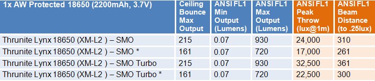

    As you will see above, and consistent with the beamshots, the Lynx is an extremely high output light (at least initially). In fact, it currently has the highest output of any 18650 light in my collection. FYI, I've included the throw measures with the Scorpion Turbo Head in place.
    As always, please note that my estimated lumen scale may not be accurate in this output range. The initial calibration of my lightbox was based on lower output lights (as described in the links above). As such, what you should focus on is the relative output differences between lights, not the absolute estimate. By any measure, my Lynx sample has the distinction of the highest max output on 1x18650 (at the moment). I find Thrunite's 1000 lumen estimate to be believable.
    That said, I did experience a number of cases where the light would not consistently run at the max level on some of my high-capacity 3100/3400mAh 18650 batteries. The reduced max output is indicated by the "*" in the table below.
    To be clear - there was NO issue in reaching the higher max output on any of my AW protected 2200mAh cells, any of my protected 2600 mAh cells (based on the Sanyo core), or my AW unprotected IMR 18650 cells. But my higher capacity 3100mAh and 3400mAh cells (all based on the Panasonic cores, and under the Xtar, 4GREER, Tactical Impulse and Eagletac brand labels) were inconsistent in this regard. Sometimes I could activate or ramp to the max level on these cells, other times it would limit me to ~200 lumens less. Oddly, the ramp would seem to proceed to the max level, but when you tried to select it, it jumped back down by ~200 lumens. It thus seems as if these cells could not consistently provide the power required.
    In playing around with the light further, I notice that the sub-max issue on these cells seemed to be when the batteries or light were cold (i.e., not recently in use). Hot-off-the-charger, or in a still-hot light that had been running recently, the 3100/3400mAh cells generally produced the higher max output as expected. But if the light and cells were allowed to cool to room temperature first, most of my 3100/3400mAh cells wouldn't reach the max level (even when fully charged). There thus seems to be some voltage/charge characteristic of the 3100/3400mAh cells that interacts with temperature in this particular light.
    I'll have to leave it to those with more experience/understanding of these cells to discuss further.
    Given the 2.7-6.0V circuit range, it's an interesting question whether or not 2xCR123A can be used in the light. Please see my runtime results below for a discussion.

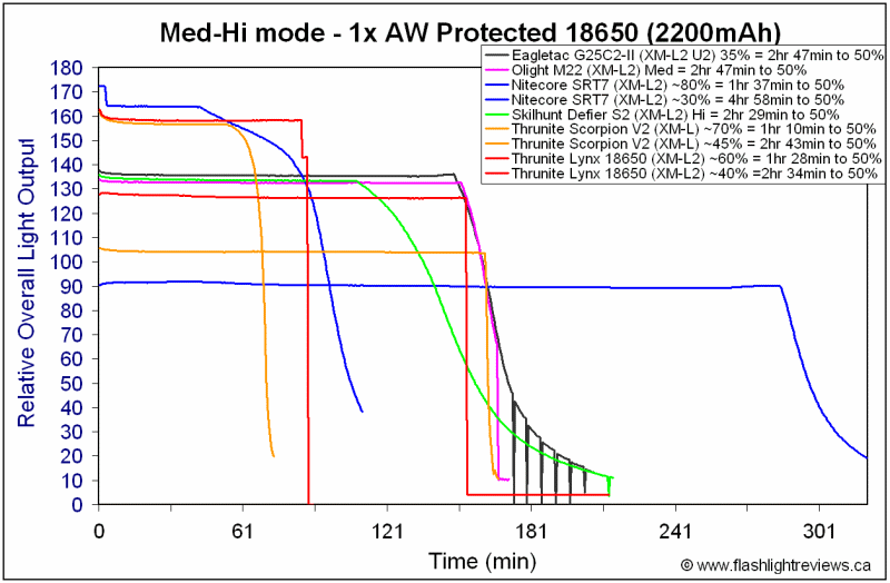

    Output/Runtime Graphs:
    To start, here is a comparison of standard ICR chemistry AW protected 2200mAh cells versus IMR chemistry unprotected AW (red label).
    As you can see, the IMR cell has lower capacity overall. In both cases though, there are three step downs that occur before the batteries are exhausted. The last of these drops you to an ultra-low level. This means that you can safely run unprotected cells in the light – this is a very clear signal that it's time to change the batteries.
    Let's see how it compares to other lights, on my standard AW protected 2200mAh test bed (note that I had no problem getting max output on these cells).
    Runtime is quite good, at all levels. On max, the Lynx is definitely higher output than any of my other lights (at least initially). Runtimes are slightly reduced because of this, but overall efficiency is still very good on max.
    At lower output levels, overall efficiency is excellent on the Lynx, consistent with my top-performing current-controlled XM-L2 lights.
    But of course, one of the differences here is that most lights in this comparison are multi-power (i.e., also support 2xCR123A/RCR). What about the Lynx? From the specs, 2xCR123A is not supported. But since the supported range is close, I thought I'd give it a try.
    To explain what you are seeing above, I needed to drain off ~1.5 mins of capacity on my CR123A cells before they would run in the Lynx. If you put fresh CR123A cells into the light, it just flickers/strobes initially. But if I ran off ~1.5 mins of capacity in another high-output light first, the cells would now work normally in the Lynx.
    As you can see, overall efficiency of these slightly depleted CR123A cells in the Lynx was quite good.
    I recommended to Thrunite that they see about widening the voltage range of the Lynx to fully support CR123A. In response, I am led to understand that they plan to release a separate multipower version of the Lynx. But the 18650-only version of the Lynx I reviewed here does not support 2xCR123A.
    Note however that I previously cautioned against running 2xCR123A on max for extended periods in the Scorpion V2. That light was so heavily driven that it could sometimes trigger the PTC protection circuits on CR123A, see my earlier thread here for a discussion.

    .So why did they remove the head spring and if it has color filters are they screw in or pop on? Thanks again.
    I don't know why they ditched the head spring, although the post still allows flat top cells. Tension in the light seems good with the new tailcap (I.e., even my shorter IMR cells worked fine). But of course, I don't treat recoil operation.
    I haven't seen the filters, so Thrunite would have to answer that question.
    Full list of all my reviews: flashlightreviews.ca. Latest hobby: whiskyanalysis.com. New: Selfbuilt's Spring 2018 Sale!

    By the way, I see it wasn't clear how I described the interface above - the switch is not a reverse clicky on the Lynx. It acts like a reverse clicky in the sense that you have to re-press it when switching modes, and there is no momentary on (at least as currently programmed - Thrunite is apparently working on that for the final release). The switch is not like a forward clicky, in that the Lynx only comes on once you press all the way. But you don't need to release for activation (i.e., constant-on happens with the full press). So it should be feasible for Thrunite to reprogram for momentary modes if they want.
    That's the thing with electronic switches - they are neither forward clickies nor reverse clickies. Better to say they can be programmed for constant-on or momentary-on with a full press - but you will always need a full press to activate (unless the switch has multiple depth points, like on some of the Nitecore lights).

    Here's an interesting question that just occurred to me:
    The switch is in the tail, as is the selector. Is the driver in the head? You mentioned that the Scorpion's Turbo head DOES fit just fine on the Lynx, is the tailcap/tailswitch similarly swappable? If so, are the modes the same as the original light (i.e. Scorpion modes for a Scorpion with Lynx tailswitch?).
    Max
    P.S. as for the final iteration, 3 user programmable modes + momentary would be great. Although I like the idea of an accessible firefly, for Tactical and LEO type usage, a constant High, a constant Low/Med, a Tactical strobe and a momentary High are the most important to have available. If I really need a firefly mode, I can reprogram the Low/Med for that specific usage for that limited time.
    4 user programmable modes + momentary would be perfect, but apparently, perfect is simply not allowed in the flashlight world.
    Default Re: Thrunite Lynx (1x18650, XM-L2) Review: RUNTIMES, BEAMSHOTS, VIDEO and more!
    Quote Originally Posted by bluemax_1 View Post
    The Turbohead option is just a reflector/bezel - it doesn't swap out the emitter or whatever circuit is in the head. So it has no effect on the functioning of the light.
    In terms of swapping the tailcaps between the lynx and Scorpion, I haven't tried that. It could work, or it could "misfire" on you - depends if they have changed anything significant in how the tailcap control circuit interfaces with the head. That's not something I have the ability to interrogate, and wouldn't want to experiment without the ok from Thrunite.
