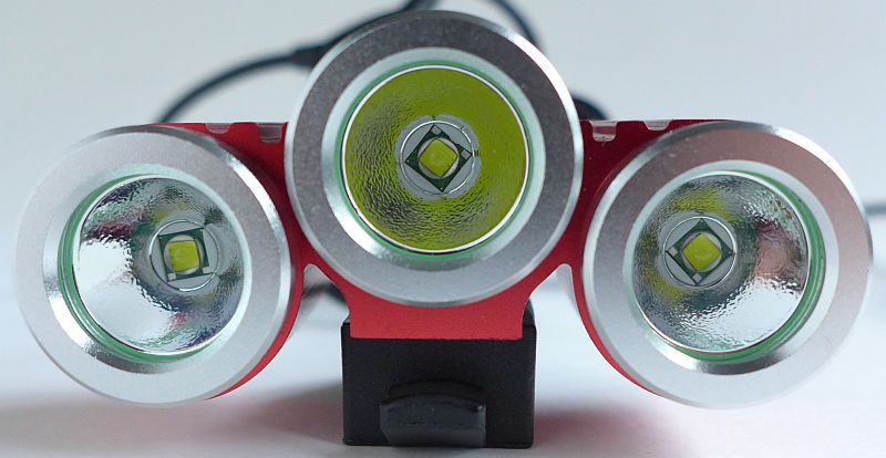

    The triple light head has three identical emitters each using a XM-L LED and textured reflector.
