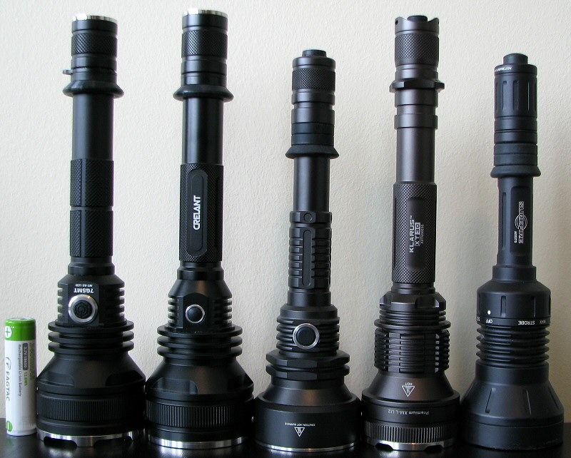

    My early release 7G5MT actually came in 7G5CS packaging (according to the labels on the box). You thus get the fairly standard (and basic) hard cardboard box with packing foam, with the light (with metal lanyard ring and rubber grip ring installed), extra o-rings, paracord-style wrist strap, and manual included. There was no holster on my review sample, but I believe some dealers do sell the light with a holster.
    From left to right: Eagletac Protected 18650 3400mAh; Crelant 7G5MT, 7G10; Niwalker Black Light Vostro BK-FA02; Eagletac SC25L3.
    From left to right: Eagletac Protected 18650 3400mAh; Crelant 7G5MT, 7G5CS; Sunwayman T40CS; Klarus XT-30; Surefire Invictus.
    Crelant 7G5MT: Weight: 354.1g, Length: 244mm, Width (bezel): 64.0mm
    Crelant 7G5CS: Weight: 334.5g, Length: 247mm Width (bezel): 64.0mm
    Crelant 7G10: Weight 643.4g (827g with 4x18650), Length: 198mm, Width (bezel): 79.0mm
    Eagletac SX25L3 3x18650: Weight: 315.9g, Length: 150.2mm, Weight (bezel): 47.0mm
    Klarus XT30: Weight: 283.1g, Length: 247mm, Width (bezel): 58.0mm
    Niwalker 750N1: Weight: 408.0g, Length: 269mm, Width (bezel): 58.6mm
    Sunwayman T40CS: Weight: 296.7g, Length 227, Width (bezel): 63.5mm
    Tiablo A60G: Weight: 297.8g, Length: 256mm, Width (bezel): 56.8mm
    Thrunite Catapult V3: Weight: 434.8g, Length: 254mm, Width (bezel) 58.0mm, Width (tailcap) 35.1mm.

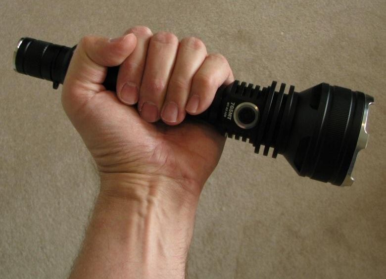

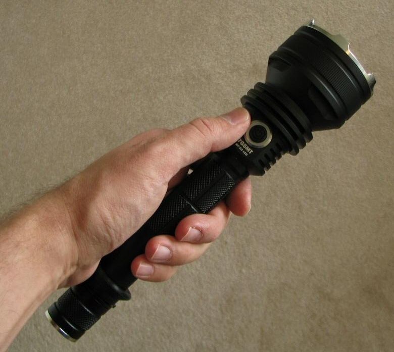

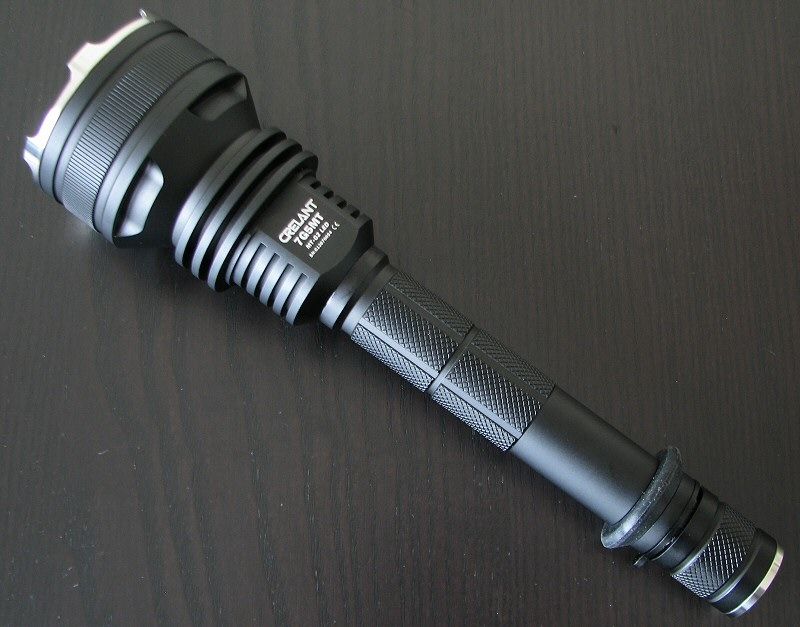

    The 7G5MT is fairly close in size to the 7G5CS, with a slightly large head base (and weight), but slightly lower overlal length.
    Overall build is generally in keeping with the Crelant 7G5CS, with a few updates. Anodizing remains a matte black, and seems to be of good quality. There are no obvious chips or damage on my sample (but I have seen some on my other Crelant lights). Labels are bright white and clear, well centered, and include a serial number.
    As on previously lights, knurling is rather weak (i.e. smooth), but the additional ridges and other build elements help with grip. Overall, I would rate the grip as fairly good. There is a removable rubber grip ring and metal lanyard ring installed near the tailcap.
    Light has a crenelated stainless steel bezel ring now. The light can tailstand.

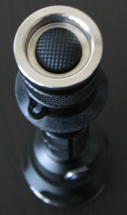

    What's interesting about the tailcap is that it uses a press-switch now. This allows for both momentary activation (i.e., press and hold) and locked on (i.e., screwed tight) – see my User Interface discussion below for more info. This differs from the earlier 7G5CS, which used a traditional clicky switch. If I were to hazard a guess as to what precipitated this change, I would think that traditional clicky switches don't not hold up too well to the high current demands of the MT-G2.

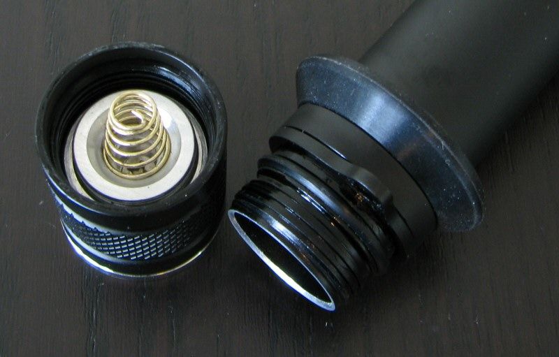

    As with the 7G5CS and 7G10, the 7G5MT uses a side electronic switch in the head to control output modes. However, the button is larger now, with a more textured cover. I find this new design easier to access by touch. Scroll down for a discussion of the user interface.

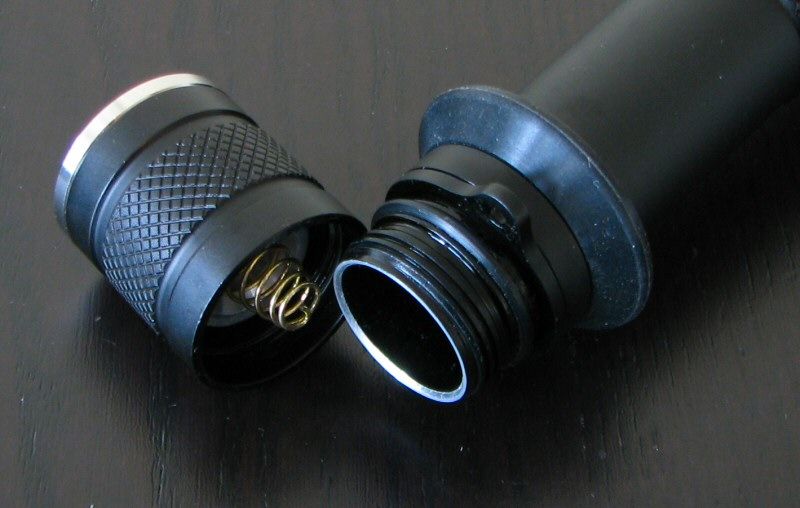

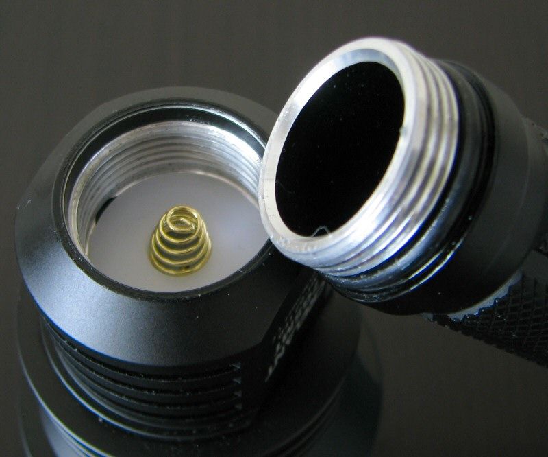

    Screw threads are square cut now (i.e., trapezoidal), but share the same threading diameter as before. This means that in theory you could still swap tailcaps, but I don't recommend you try this (i.e., see my comments above about physical clicky switches and high current draws). Threads remain anodized at the tailcap for lock-out (as was present on the 7G5CS but not the 7G10).
    As an aside, the switch to square-cut threads throughout the light means that the aspheric/collimator head from the 7G5-V2 and 7G5CS won't screw on to the 7G5MT.
    There is a spring in the head, so flat-top cells will work fine in the light. All of my high-capacity 3100mAh/3400mAh cells fit comfortably in the light. I did find some issue with my shorter 2200mAh cells not always making a consistent contact (i.e., could break contact if you shook the light vigorously).

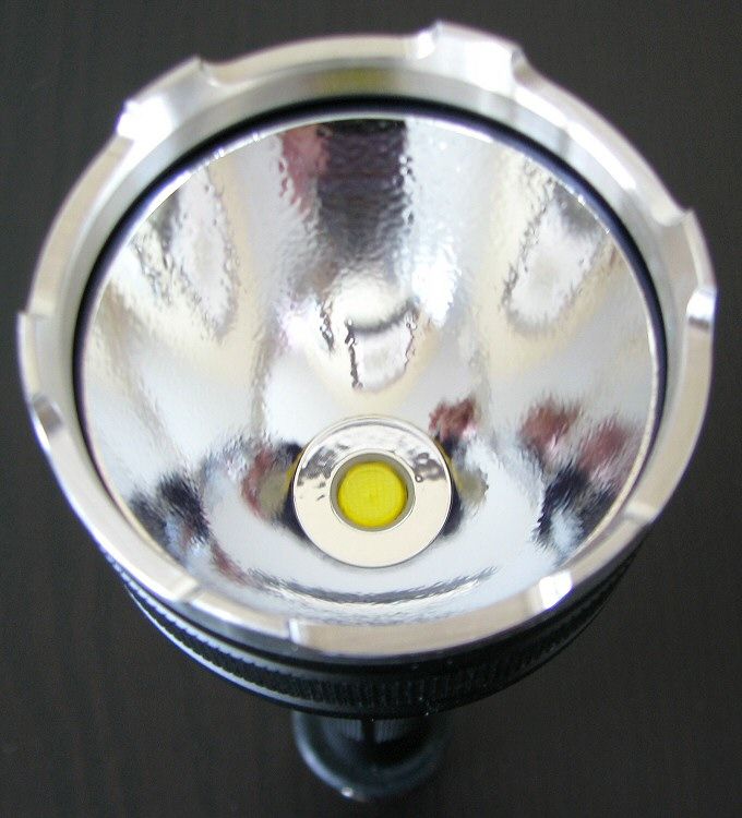

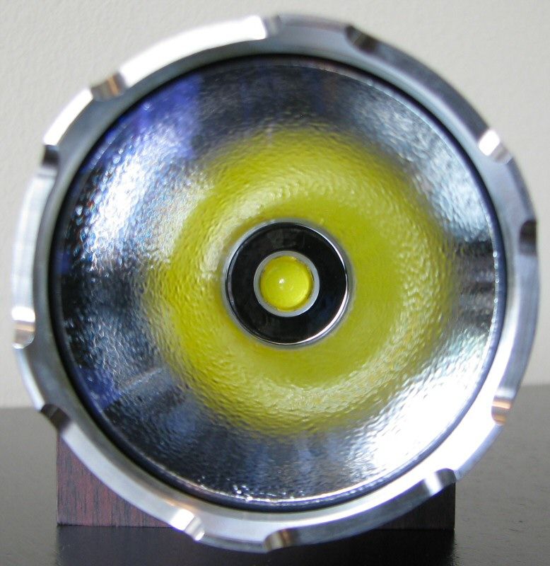

    The reflector is a good size, textured to smooth out the beam - I'd describe it as a Medium Orange Peel (MOP) finish. Because of the large die size with the MT-G2, expect much lower throw relative to overall output (compared to the 7G5CS). Of course, overall output should be higher on the 7G5MT compared to the 7G5CS.
    Note that I found some debris inside the head of the light on my sample. These looked like small aluminum shavings produced during milling of the reflector, and were free-floating inside the head. Opening the light at the bezel/lens and a shot of compressed air took care of them.
    BTW, if you aren't familiar with the MT-G2, this series was designed by Cree for high-output directional lighting applications (i.e., as a replacement for classic halogen bulbs in accent lighting, track lights, etc.). Please see the Cree MT-G2 spec sheet for more info.
    As you can tell above, the MT-G2 is a remarkably large emitter, with a dome diameter of almost 8.9mm (vs. 5mm on a XM-L2, for example). Of course, what really matters is the surface area of the die underneath, which is only 2x2mm on the XM-L2. I am not sure of the actual die dimensions on the MT-G2, but as you might be able to tell from the blow-up pic above, there appears to be a grid of 72 distinct segments.
    Another distinctive feature is that the MT-G2 only comes in relatively neutral-warm tint bins. Crelant claims 4500K in some of the promotional material I've seen for the 7G5MT, which is believable for my sample. Scroll down for beamshots.

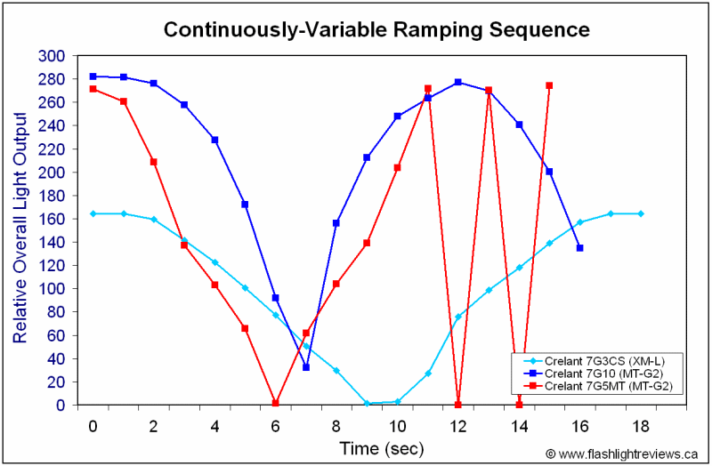

    In either Hi or Lo, pressing and holding the side switch begins a continuously-variable ramp in output. Initially, the light ramps down from Max to Min, and then reverses back to Max, in a repeating loop. The light retains the memory of the user-set level, until you break the current by fully removing the head.
    Here's how the ramp looks, compared to other recent Crelant lights:
    The ramp on the 7G5MTis faster than the other 7GxCS-series lights I've tested. The light ramps down over ~5 secs. It holds the lowest level for less than a second, and then ramps back up in the same ~5 sec timeframe. The light flashes 3 times when the max level is reached, and then starts ramping back down after a brief pause. Overall duration (Max to Min and back to Max) is ~11secs. Note that the 7G5MT goes down to a lower low than the earlier 7G10 (see output comparison tables later in this review for more info).
    As mentioned above, there is mode memory for the set level from the continuously variable ramp – as long as you don't break the current by unscrewing the head from the body. So, when cycling through levels, the light will continue to come back to your temporarily memorized set level at each point. Note that the default Lo mode is not the minimum brightness of the light – you can temporarily set it a bit lower if you like.

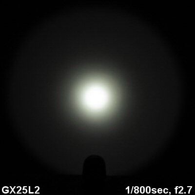

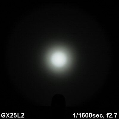

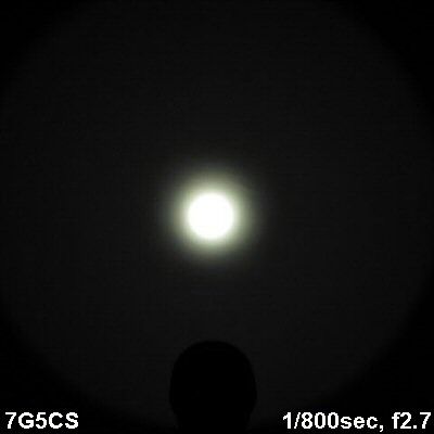

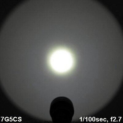

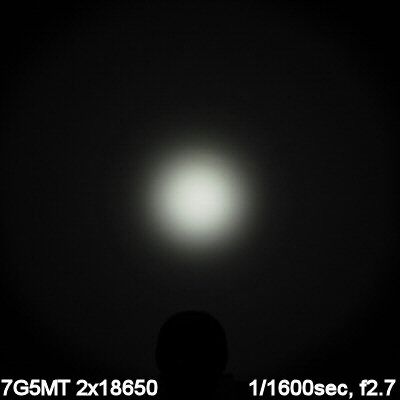

    Ok, let's start by seeing how the 7G5MT compares to other lights that use the MT-G2 emitter:
    Again, automatic color balance is used in all these beam shots, to minimize the visual effect of tint differences. In real life, all the lights above are a fairly typical Neutral White. See my video overview if you want a better idea what a Neutral white looks like.
    The 7G5MT is remarkably similar to the 7G10 in overall beam pattern – although of course the larger 7G10 has greater throw and output overall. Both lights have a wider spillbeam than typical in this class.

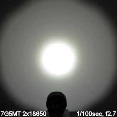

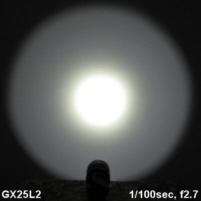

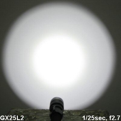

    And what about the classic 2x18650 class?
    Spill is about comparable to the 7G5CS , but of course throw is greatly lower on the large-die 7G5MT. This is exactly what I would have expected.
    Scroll down to my output/throw summary table to see how all these lights measure up exactly.

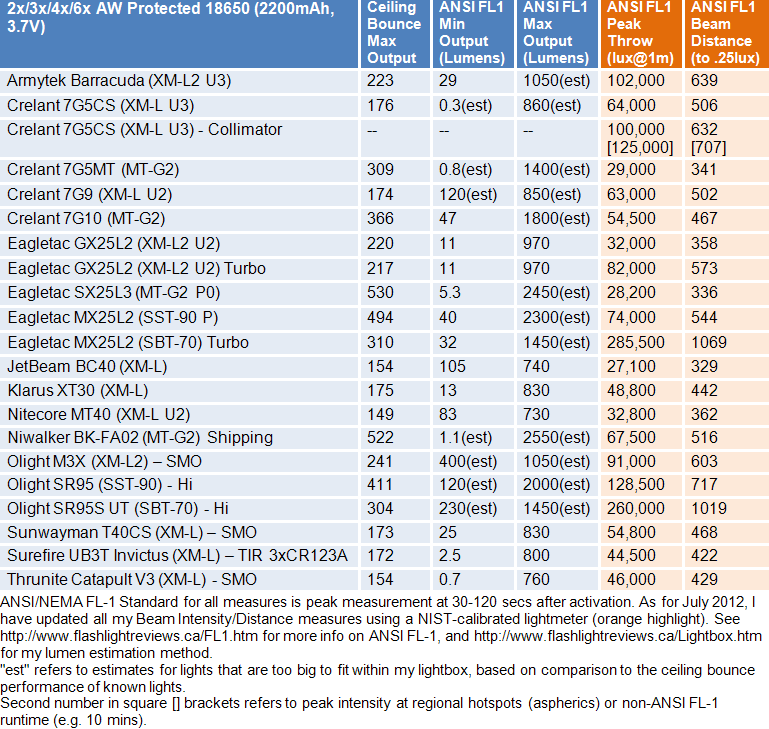

    In term of overall output, you can see that the 7G5MT is intermediate to the 7G5CS and 7G10 – although closer to the 7G10 in practice. But it is the lowest output MT-G2 light I've tested so far (as you would expect, give the 2x18650 battery source).
    As an aside, you'll note that my output estimate is lower than Crelant's specs. However, the 7G5MT is marginally brighter on 4xCR123A than 2x18650 (i.e., I'd estimate ~1550 ANSI FL-1 lumens on 4xCR123A). Scroll down to my runtimes to see how the light compares on these sources.
    In terms of the throw, the 7G5MT doesn't throw as far as the 7G10 (which is understandable, given the higher output and larger/deeper reflector of the 7G10). It does throw pretty comparably to the Eagletac SX25L3 (which has greater output, but a smaller reflector).
    Oddly, the reported beam distance specs from Crelant are surprisingly low – my results are consistent with what you would expect for a reflector this size, driven to these levels. Crelant seems to have some difficulty in determining appropriate throw specs (e.g., the 7G10 had over-stated throw measures).
    As an aside, ANSI FL-1 Beam Distance is often misunderstood – it is not meant to be an "effective range", but one that conforms to an arbitrary brightness level (in this case, distance to 0.25 lux, which is not very bright at all). This is obviously not that meaningful in absolute terms - but it does give you an objective way to compare relative beam distances between lights.

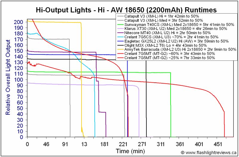

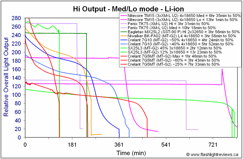

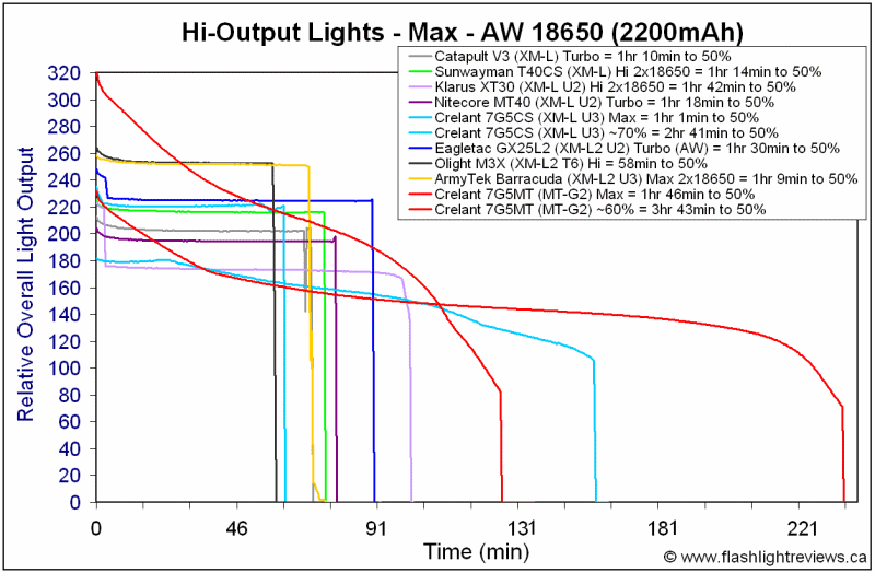

    Output/Runtime Graphs:

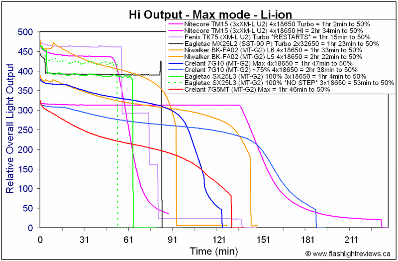

    Let's start by comparing the 7G5MT to the other high-output/MT-G2 lights:
    Obviously, the 7G5MT is not as bright on max as the other lights in this class. Similarly, runtime is not as long, due to only 2x18650 in use here (compared to 3x or 4x18650 on the competing lights). However, overall efficiency seems quite reasonable for the class, when taking into account the lower number of cells.
    Like the other MT-G2 lights though, you see the same "direct-drive-like" pattern, where the internal resistance of the cells controls the output drop-off over time. This is likely due to the higher power requirements of the MT-G2 (recall that is was designed for higher voltage lighting applications).
    Let's see how the 7G5MT compares to other lights in the 2x18650 class.
    It's a different story when you compare to XM-L/XM-L2-based lights in this 2x18650 class – the MT-G2 shines as a real efficiency leader. In terms of efficiency, a direct-drive pattern always has an advantage. But it does seem like the MT-G2 offers some measurable runtime benefits (at least at the relatively high drive currents tested here).
    Keep in mind of course that the 7G5MT does not throw as far as most of the competing 2x18650 lights shown in this comparison.

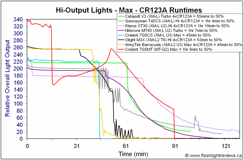

    What about 4xCR123A, which the 7G5MT also supports?
    One initial observation – the 7G5MT is brighter on Max on 4xCR123A relative to 2x18650. I would estimate ANSI FL-1 lumens of ~1550 on 4xCR123A, compared to ~1400 on 2x18650.
    Another thing I observed was PTC-engagement on my CR123A cells (i.e., that unusual dip and recovery in output during the runtime). This is something I've seen before on a number of heavily-driven 1x/2x18650 lights when run on primary CR123A (e.g., the SST-50-based Thrunite Catapult V2 and Olight M31, not shown above).
    PTC-engagement is highly variable, and depends on the thermal set limits for the specific PTC circuit in your CR123A brand (e.g., USA brands tend to trip earlier than China brands). If you are curious as to what a PTC is and how it works, I provide a detailed explanation in the runtimes section of my Olight M3X review.
    Given its appearance here, I recommend you limit you use of Max mode on 4xCR123A in this light to no more than 5-10 mins at a time.
    The light uses a press-switch instead of a clicky switch for initial activation. That's not a problem, but you should be aware of the different interface compared to other Crelant models.

    But the major change is the use of a tailcap press switch instead of a clicky switch. As mentioned earlier in the review, I suspect this may have something to do with the high power requirements of the MT-G2 emitter (i.e., physical clicky switches don't always hold up well to high currents).

    That said, collimators really only work well with small sources of light. Given the large MT-G2 die, you probably wouldn't be able to focus it too well with the previous collimator, even if it fit (i.e., would just lose a lot of spill, without enhancing throw that much).
    EDIT: Just heard back from the dealer - apparently Crelant indicated that you would need a much larger collimator to focus the MT-G2 die, about twice as large (which wouldn't be feasible).
    6,936
    Default Re: Crelant 7G5MT (MT-G2, 2x18650/4xCR123A) Review: RUNTIMES, VIDEO, BEAMSHOTS+
    FYI, in case anyone was wondering how the 7G5MT compares to the Niwalker BK-FA02:
    As you can see, the BK-FA02 has more output than the competing Crelant lights, but with a narrower overall spillbeam.
    Thanks for the great review, I've been curious about this one. Great beamshots, interesting to see the variety of beam patterns, I like the Eagletac SX25L3 flood beam.
    Joel
