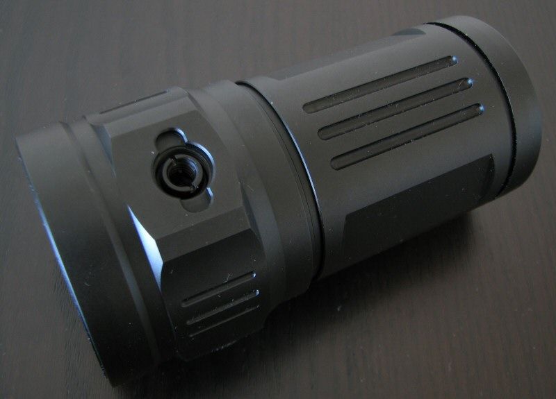

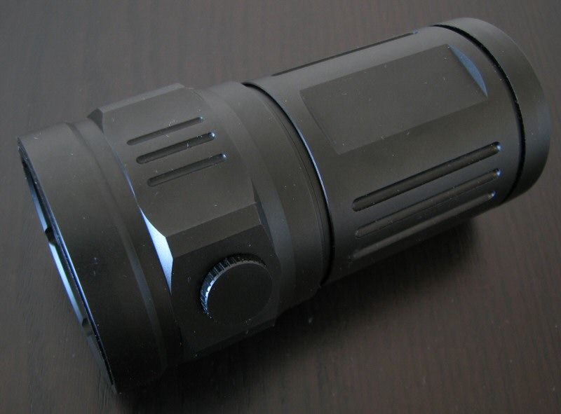

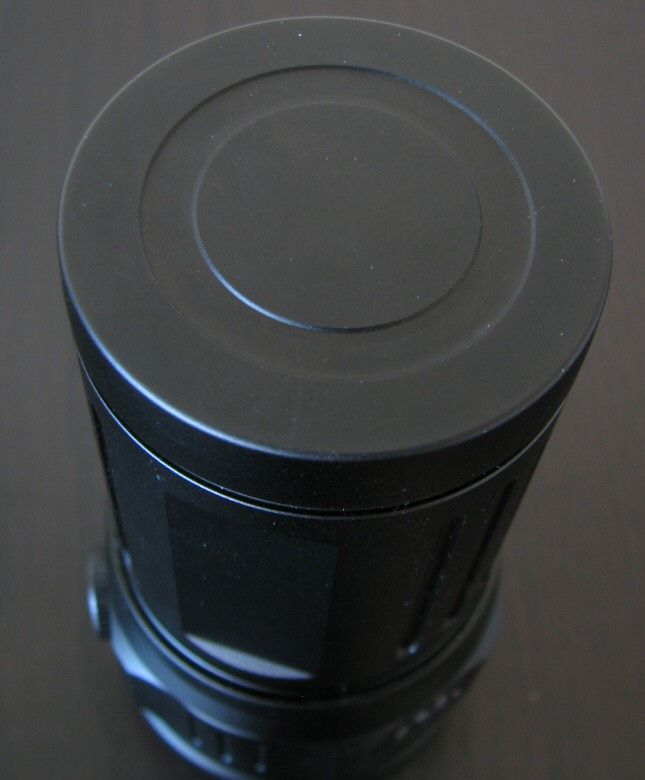

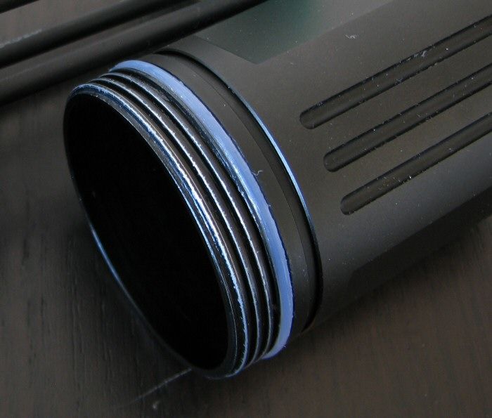

    Exterior styling is fairly minimal at present. There is no real knurling to speak of, but there are sufficient grip elements to help with grip. I would still think the light could be a bit slippery when wet. Anodizing is a black matte finish (presume to be HA). There was no labeling on my sample.

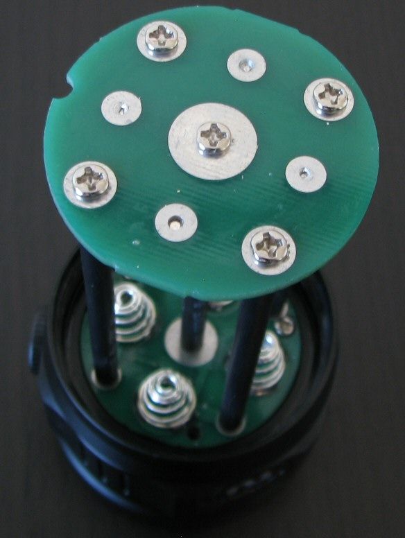

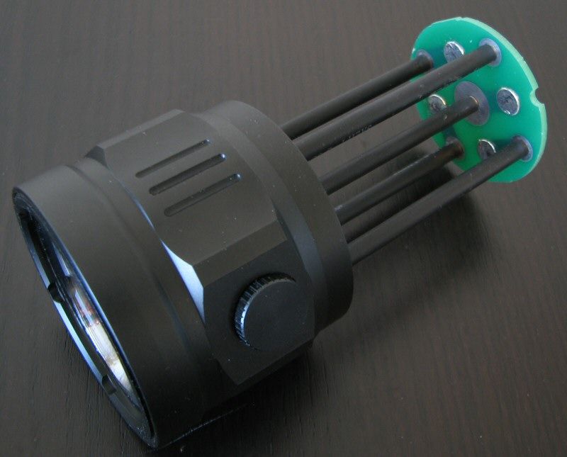

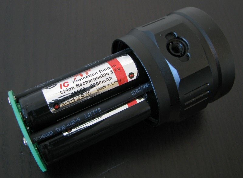

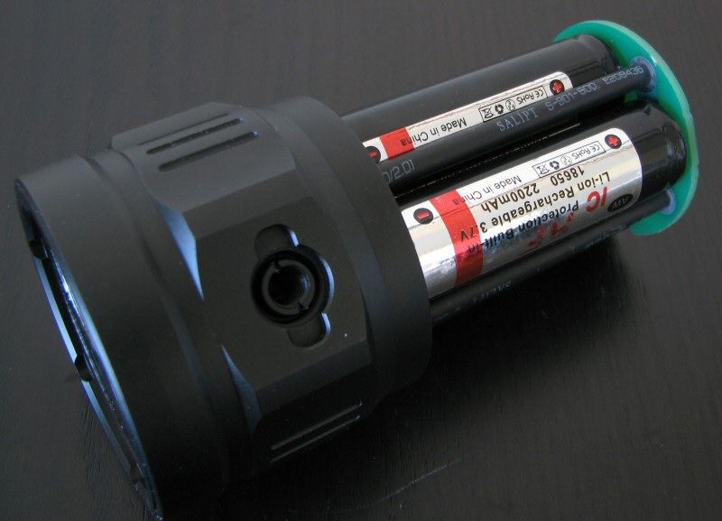

    Thanks to the integrated battery carrier, there isn't much wasted space. That said, I do find the carrier to be a bit of tight fit for length – longer cells may require some force to get in. You would also want to be careful not to damage the exposed contact board. But again, final shipping design could be different.
    As an aside, despite the appearance, the four 18650 cells are actually in series, not parallel (i.e., 4s1p). This means that a standby drain (due to the electronic switch) only comes into effect once the fourth cell is inserted into the carrier. But since the carrier is integrated into the head, there is no physical option to lock out the light.
    Note that as a result of the current design, the body's aluminum handle is actually a bit superfluous - you can run the light without it. It does have square-cut thread on my pre-release sample, but the anodizing was worn on the threads. Of course, that doesn't matter, since there is no current passing through the body). There was no lanyard attachment point either. Again, I observed the same thing with the Niwalker BKFA-series lights (these things came later, on the final shipping version).

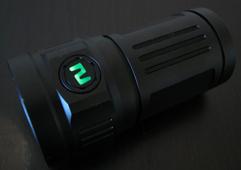

    Currently, there is an electronic switch in the head, with a "N" logo on it. Switch feel is about typical for an electronic switch. The N lights up green when in use. There seems to be a built-in circuit over-discharge protection feature on my sample, as the light shut-off and the N switched to red as the cells were nearing exhaustion. Scroll down for the user interface and performance results.
    There is also a tripod mount on the head, as well as small knob that didn't have any obvious function on my sample (all equi-distance with the electronic switch). I suspect this knob was used in assembly of the light. Again, pre-release engineering prototypes can be very different from final shipping versions – I wouldn't get too concerned about these sorts of items.

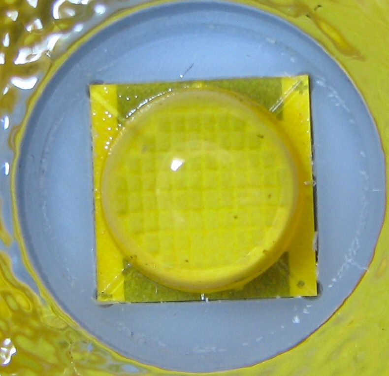

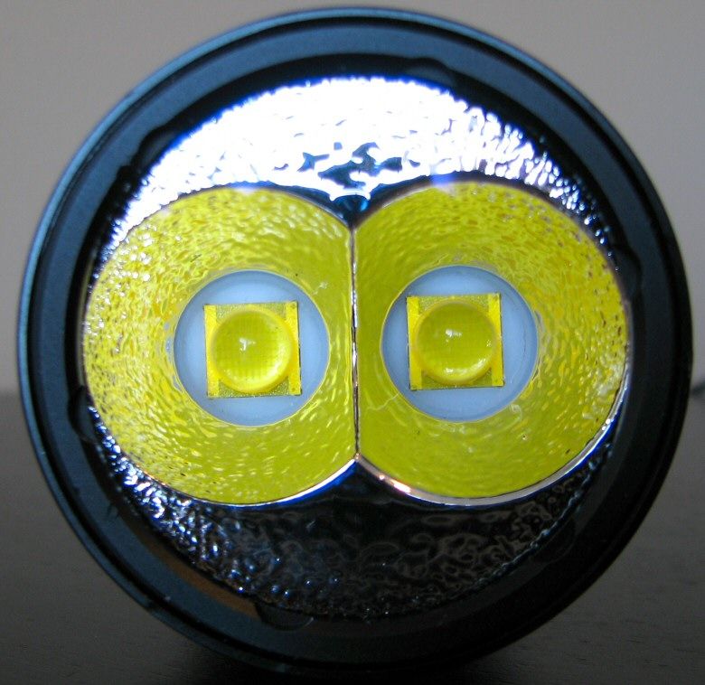

    The head is really distinctive here – with two MG-G2 emitters in relatively shallow reflector wells (heavily textured). As you would expect, this is very much a floody light. Scroll down for a beam pattern.
    See my earlier Niwalker BK-FA02 and Eagletac SX25L3 reviews for a discussion of the MT-G2 emitter more generally.

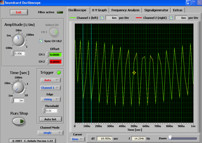

    There is no sign of PWM that I can see, at any output level – I believe the light is current-controlled.
    I did detect high frequency noise with my oscilloscope on some modes (Lo, Med and Hi), but not others (Moonlight, Turbo)
    Hi/Med Noise:
    Lo Noise:
    The frequency was a consistent 14 kHz on Lo/Med/Hi, and it was absolutely not visible to the eye in actual use. The light is flicker-free in all modes.

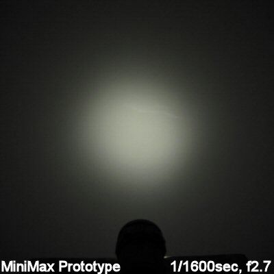

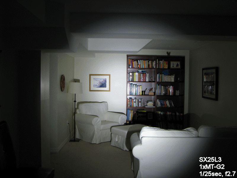

    And now, what you have all been waiting for. All lights are on their standard battery, or AW protected 18650 2200mAh for the multi-18650 lights. Lights are about ~0.75 meter from a white wall (with the camera ~1.25 meters back from the wall).
    Automatic white balance is used on most of my wall beamshots (to minimize tint differences), but in this case I went with a Daylight WB on my Canon for the MiniMax.
    Note: No matter what white balance I used, these comparisons will never be entirely accurate for tint. In real life, I find my MT-G2 lights all to be relatively neutral white.

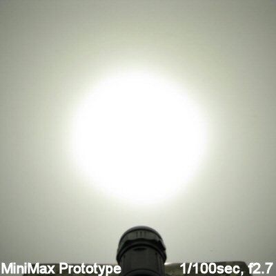

    On Turbo, the MiniMax has an unbelievable amount of output. Hard to directly compare, but my ceiling bounce results tell me that it actually slightly exceeds my Olight X6 (which is rated at 5000 lumens).

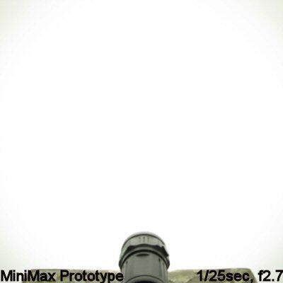

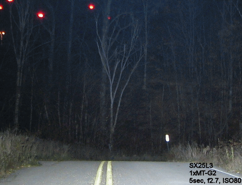

    For outdoor beamshots, these are all done in the style of my earlier 100-yard round-up review. Please see that thread for a discussion of the topography (i.e. the road dips in the distance, to better show you the corona in the mid-ground).
    Given that this location was picked to illustrate relative throw (which the MiniMax is not designed for), it doesn't really capture the overall brightness of this light.
    But you can get a few hints of its relative brightness if you examine the far right end of the zoomed-out shots above (i.e., the tree line in the distance on the right). Depending on your monitor calibration, you may be able to faintly make the trees there (which are more than 100 yards away). You'll note how much hard it is to see these on the comparator SX25L3 or X6.

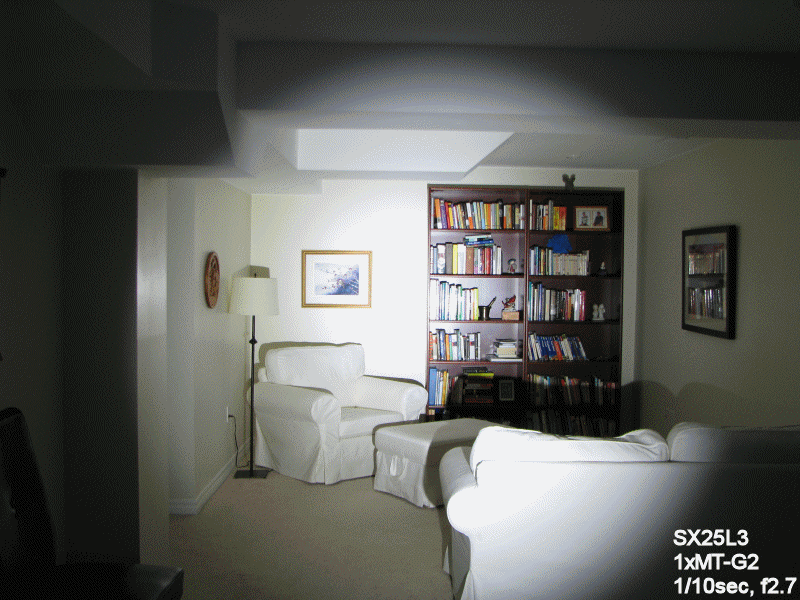

    To try and show this better, I've resorted to my interior basement shots. These will at least allow you to compare the throw and spill of the three lights. For your reference, the back of the couch is about 8 feet away (~2.4m) from the opening of the light, and the far wall is about 19 feet away (~6m). I am also showing a series of exposures, to allow you to better compare hotspot and spill.
    Subjectively, the MiniMax really does seem to be putting out at least as much light overall as the X6 – just with a completely different beam pattern (i.e., wide flood). As you can see in these indoor shots, the MiniMax has a much wider beam overall.
    In that sense, I know people always found it hard to believe how well the X6 throws, but I think the combined beamshots above really tell a compelling story. The MiniMax is really a true flood light - it actually reminds me a lot of diffuser-equipped light.
    Since my high-output lights don't fit in my lightbox, I am really relying on my ceiling bounce measures here. But the results match my subject experience – the MiniMax manages to squeeze out a few more lumens than my 5000-lumen rated Olight X6 (which was my previous output champ).
    Throw is definitely pretty minimal, given the overall output of the MiniMax. As always, the MT-G2 produces a very smooth beam profile.

    -Make sure the LEDs are perfectly centered. On the production sample one of them is not. Yes it's a small small deviation, but if I pay $200+ for a flashlight I expect it to be perfect, and you can bet it's going back if it's not.

    @Teej - The problem is it's ALL flood. Not even 20kcd on the highest setting. With a flood beam pattern, you'll be lucky to see well 20-30 meters ahead with it on high. Walking my dog, I like to light up the ground very clearly, but to be able to just raise the light and see a fair distance.
    This light will make the SX25L3 look like a thrower.

    I think you have it exactly backwards. Niwalker is well aware they are building a flood light. Hiking with a thrower is quite obnoxious, as the small hot spot bounces around with your body movement. Additionally, most of our visual information comes from our peripheral vision. Our sense of balance at night is aided by the peripheral awareness a flood light offers. Flood lights better serve most practical applications for lighting.
    Default Re: Niwalker MiniMax Nova MM15 (2xMT-G2, 4x18650) Prototype Review: RUNTIMES, BEAMSHO
    Quote Originally Posted by InfinitusEquitas View Post
    From the owner of GoingGear, who has used this pre release version; "If you like floody lights, this guy is about as floody as lights get. Awful distance, but amazing area lighting for about 100 yards. I really like it." I think, InfinitusEquitas, you have clearly underestimated the lighting distance in an attempt to bolster your position.
    Flashaholic* InfinitusEquitas's Avatar
    May 2011
    20 Minutes From NYC
    1,653
    Quote Originally Posted by maxrep12 View Post
    The bit you're missing, is the light only offers that range on the highest setting, for 3.5 minutes.
    Turn it down to the 900 lumen or lower setting, that you're likely to use on, for the sake of runtime, not killing your batteries, and heat, and you're cutting that range significantly.
    Don't get me wrong, I like floody lights. I love headlamps that have a wide beam angle for close up work, but they have no range, and neither will this light.

    The giant lumen out put is from giant honking LEDs...which also put out a lot of heat.
    A larger LED has a larger point of emission, and, therefore, less throw for a given reflector size, etc. That means the lower output, smaller LEDs can more easily out throw the larger higher out put LEDs.
    If they do it with less heat, great...and for those that want more throw, that's potentially a better overall solution.
    If you WANT a wide floody and powerful beam, the MTG2 is a good way to go, if the resultant range/heat management limitations work for you too.
    If you are ok with less flood to optimize range, you can take a smaller amount of light, and concentrate it into that smaller pattern, and get just as bright in the smaller area, but also project that beam farther.
    I have an aspherical (Zoomie) MTG2 light that runs on two IMR 16340....which is my way of hedging the bet. That way, I get the ~ 3k lumen mule-like flood if zoomed out, and, zoomed in, a giant Eggo Waffle I can project onto more distant targets. I can also zoom to a TIR-like beam spot for intermediate targets.

    No one is disputing the benefits of flood. No one expects this flashlight to be a thrower.
    The problem is it's probably a 90+ degree flood light, with a humongous hotspot. Making it very dim at lower settings.
    Look at those wonderful gifs Selfbuilt put up. On the maximum 5200 lumen mode which lasts 3.5 minutes, at even 100 yards, the light is already losing ground badly. Cut that back to 2000 lumens, or 900, and you won't see much of anything past 50 yards.
    At the same time, if your goal is to light up something 50 yards away, you can do it with literally a 5th the power or less, to the same effect, without blinding yourself, and do so with still very floody lights. Look at the SX25L3... it's a flood light, but it has just a bit more reach to it. With half the power.
    Ever wonder why the "personal lighting equipment" companies don't just sell large lightbars, with bare emitters? Why they bother with even having a dome on LED's? It's do DIRECT the light. That's all I'm suggesting... slightly improved throw so the light is more than just a mere novelty for blinding yourself.
