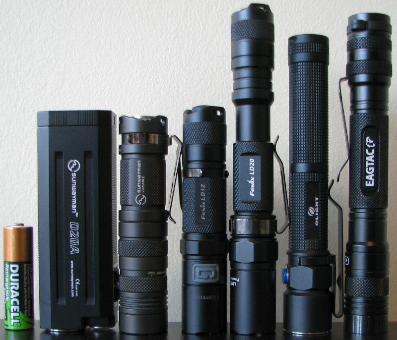

    From left to right: Duracell NiMH AA; Sunwayman D20A, V11R + AA extender; Fenix LD12, LD20; Olight S15; Eagletac D25A2.
    Sunwayman D20A: Weight 118.4g, Length: 102.6mm, Width (head) 20.9mm, Height (head) 35.1mm
    Olight S15 2xAA: Weight: 59.2g, Length: 137.9mm, Width (bezel): 23.1mm
    Nitecore MT2A: Weight: 66.9g, Length: 154.3mm, Width (bezel):22.7mm
    Nitecore EA2: Weight: 68.9g, Length: 134.4, Width (bezel): 26.1mm
    Eagletac D25A2: Weight: 54.8g, Length 148.5mm, Width (bezel): 21.0mm
    4Sevens QAA-2 X (Tactical tailcap): Weight: 60.1g, Length: 149.1mm, Width (bezel) 22.0mm
    Jetbeam BA20: Weight: 70.2g, Length: 156.4mm, Width (bezel) 23.2mm
    As you can see, the D20A is not any taller than a typical 1xAA light.

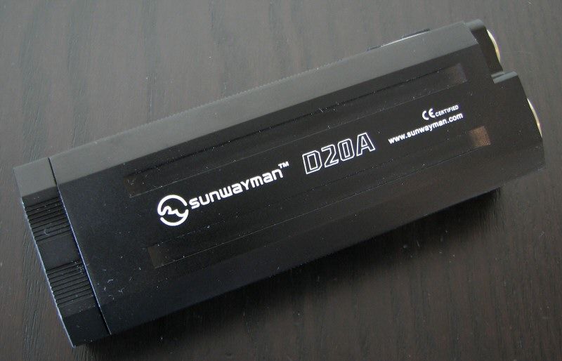

    The appearance of the D20A is pretty distinctive – it reminds me of my old Duracell Durabeam 2xAA from the mid-80s. Ah, memories.
    The side-by-side arrangement makes this light quite compact, although battery changing is little more complicated. You'll note the main white emitter on the upper part of the front, and the red LED (under a red dome) just below it.

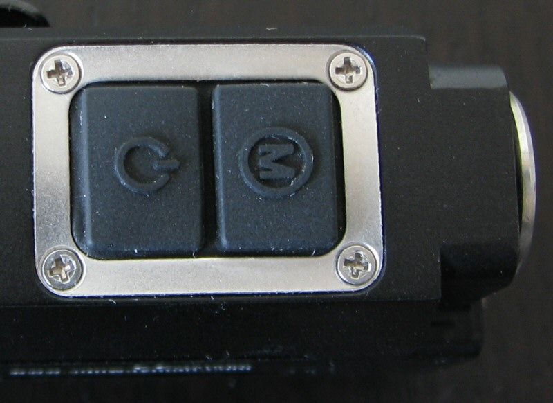

    There also dual electronic switches, located side-by-side near the head. The lower on/off one is slightly less raised than the mode-changing one above it.
    The switches have about typical feel for electronic switches, which means accidental activation is a possibility. I would think these would be hard to find by touch with gloves on. Scroll down for a discussion of the UI.

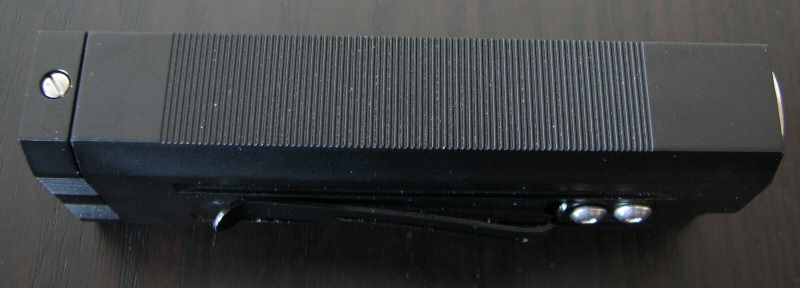

    As with several other recent Sunwayman lights, the light comes in black anodizing, type III (hard anodized), in a matte finish. Personally, I miss the dark gray natural finish anodizing of old. As always, all labels are bright white against the dark background.
    There is no real knurling to speak of on the D20A, but there are a number of fine gradations all along the body and tail. The effect is somewhat similar to the recent Fenix lights that use a similar design. The pocket clip is very firmly attached, and holds on stiffly to the light. Note that some of the edges are a bit sharp (i.e., around the tailcap and the main body cut-outs).

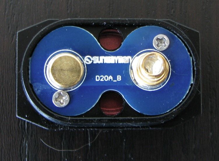

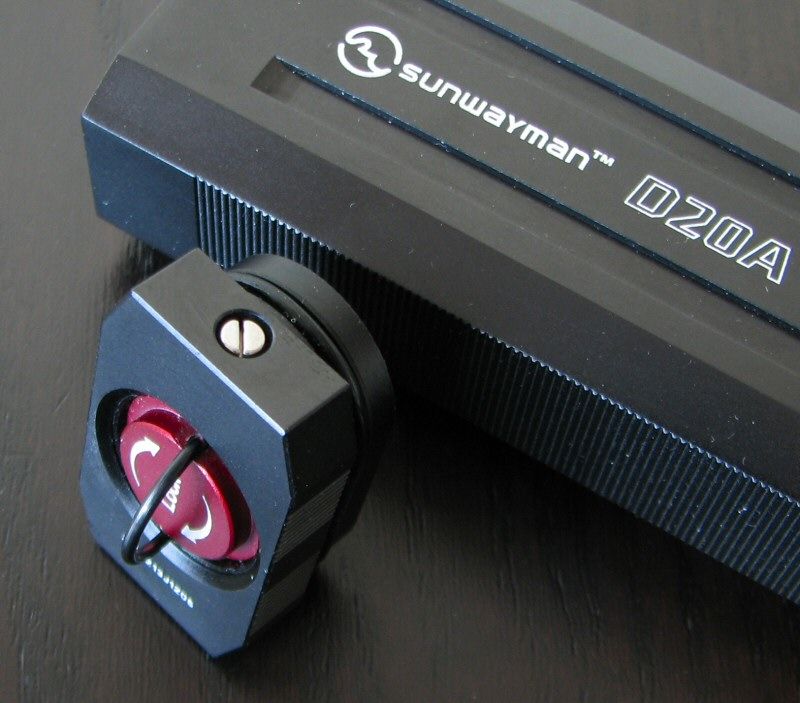

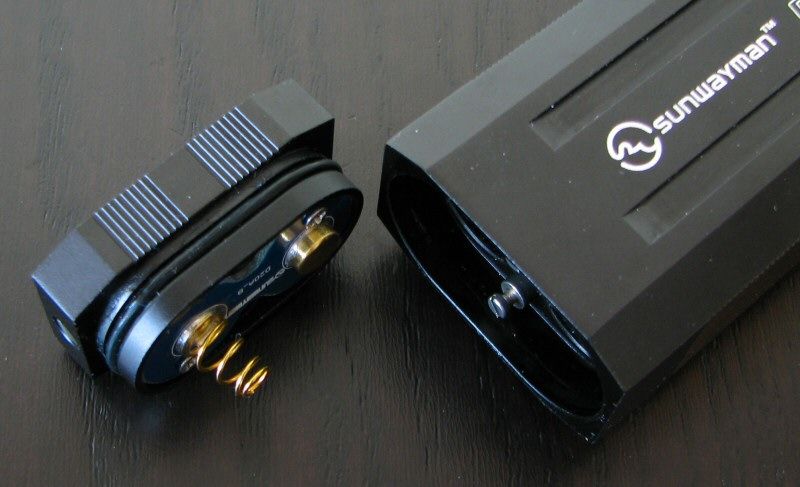

    The light opens at the tailcap.
    Design here is unusual, as you have to turn the lock piece a quarter turn to unlock/re-lock the tailcap in place. There is a small half-moon handle on the lock that flips loose when the light is held pointing up. Tension is significant, and it takes a little practice to be able to do this smoothly. This makes battery changes a bit of a pain – certainly not something that you will want to do with gloves on, or in the dark.
    Pay attention to the correct orientation of cells.

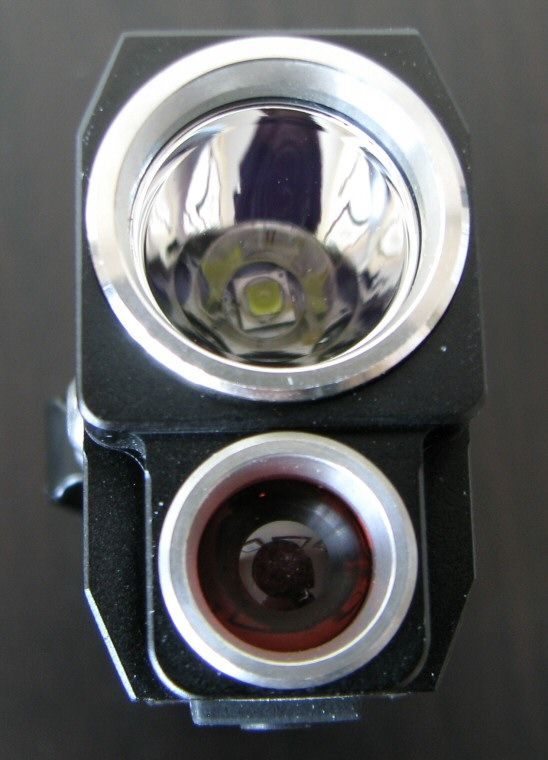

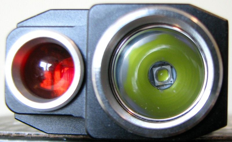

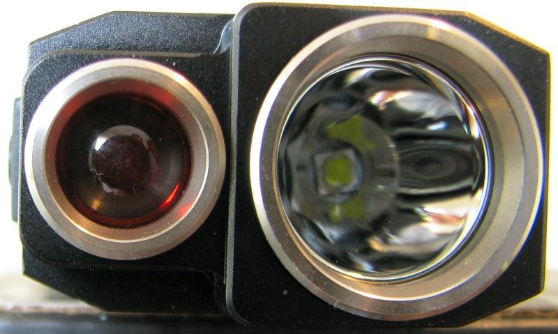

    There is a stainless steel bezel for the main white emitter.
    The main reflector is smooth. XM-G2 cool white emitter was well centered on my sample.

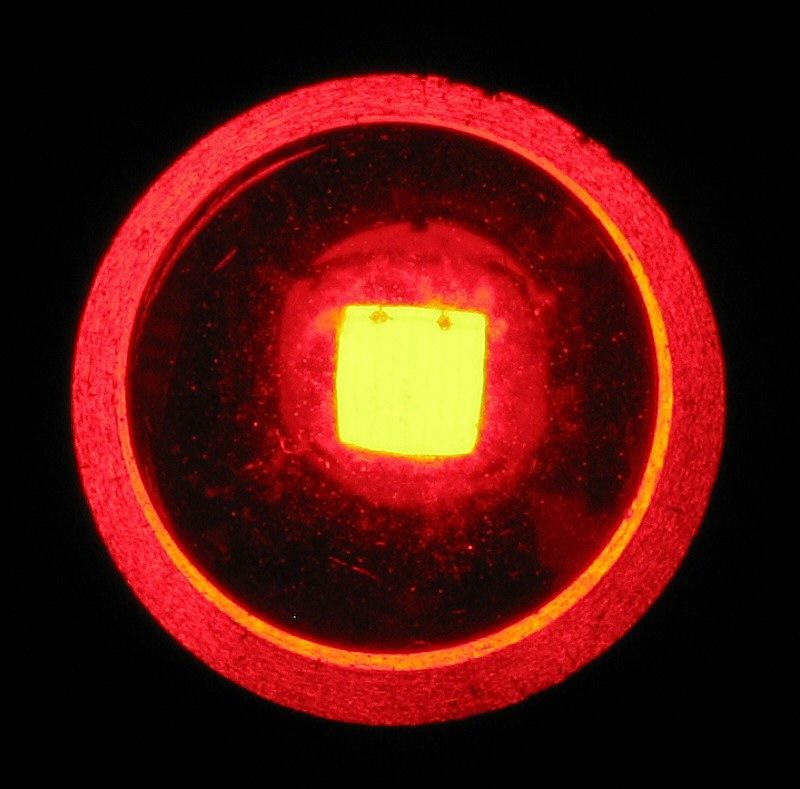

    Sunwayman confirms that there is an actual red XP-E LED under there (hard to tell with the red dome). In the absence of a reflector, the convex optic helps to focus light into a defined beam (scroll down for beamshots).

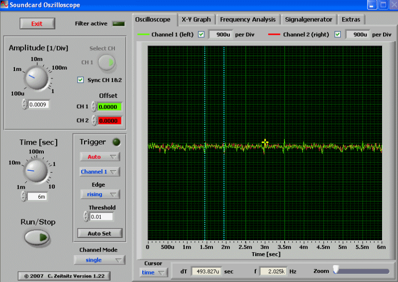

    PWM/Strobe
    As with most of my Sunwayman lights, I don't see any signs of pulse width modulation (PWM) on the lower output modes. There is some measurable circuit noise on my D20A, in some modes – although it is not visible to the eye:
    White Turbo/Hi Noise:
    I only see very faint circuit noise on the Turbo white mode, around 2 kHz or so. This noise is in no way visible to the eye in use.

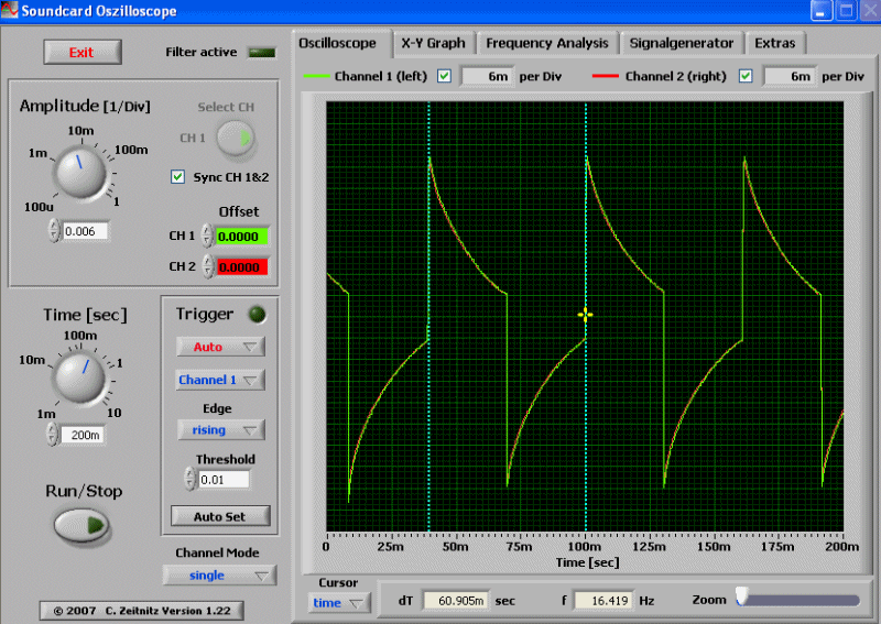

    White Strobe:
    The main strobe is a high frequency ~16 Hz strobe. Very disorienting.

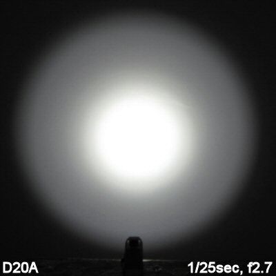

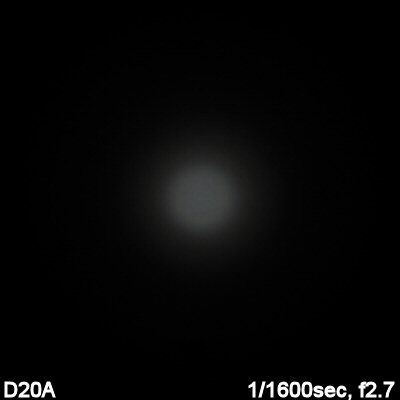

    For white-wall beamshots below, all lights are on Max output on 2x Sany Eneloop NiMH (2000mAh) batteries. Lights are about ~0.75 meter from a white wall (with the camera ~1.25 meters back from the wall). Automatic white balance on the camera, to minimize tint differences.

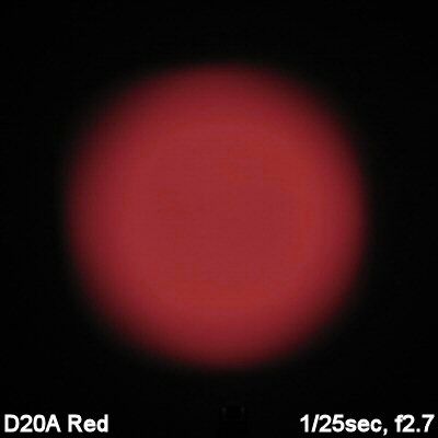

    The D20A has a reasonable beam pattern. It is not as throwy as most of the XP-G/XP-G2-based 2xAA lights, due to the smaller reflector.

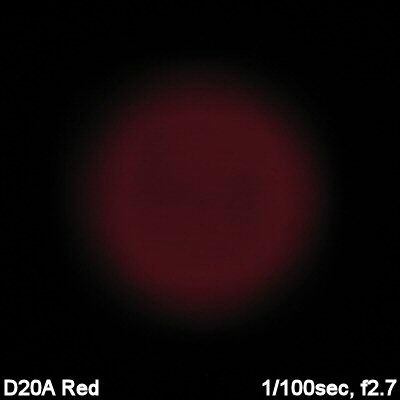

    The red beam is interesting – there is no real hotspot to speak of, just a fairly even smooth beam with a sharp spillbeam edge. The red convex dome seems to help maintain a clear demarcation of the spill.

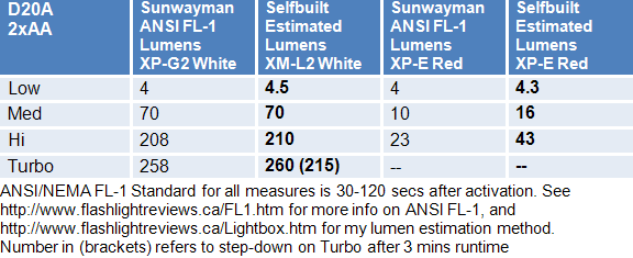

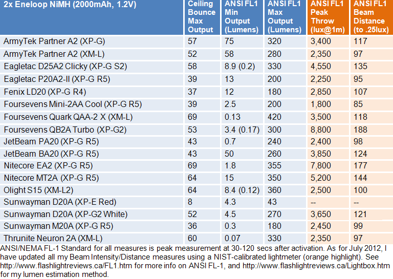

    As you could tell from the beamshots, max output is generally in keeping with the lower range of recent 2xAA lights (i.e., similar to some of the earlier XP-G lights in this class). But it is still a good amount of output. As previously mentioned, peak throw is somewhat reduced from other XP-G/XP-G2 lights, due to the smaller reflector.
    My peak intensity throw and beam distance measures are very consistent with Sunwayman ANSI FL-1 specs. Let's see how the lumens estimates do across all levels.
    Again, my lumen estimates are very close to Sunwayman's output specs, at least on white. My lightbox seems to read the red modes as a little higher.

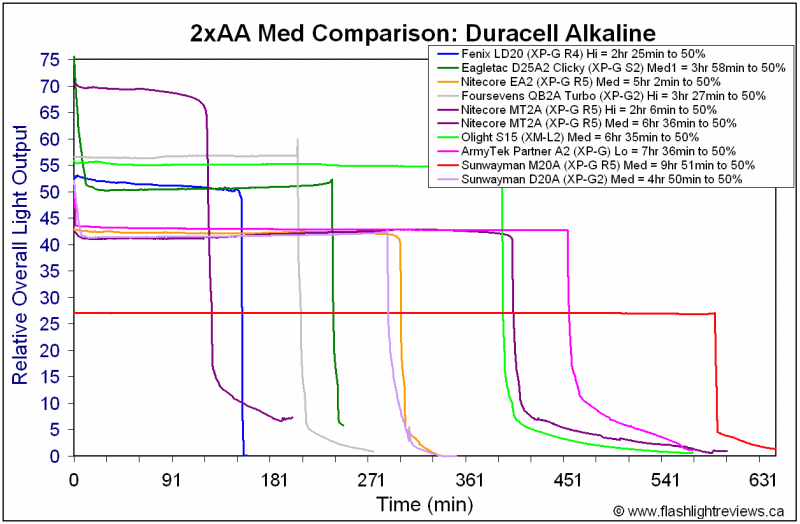

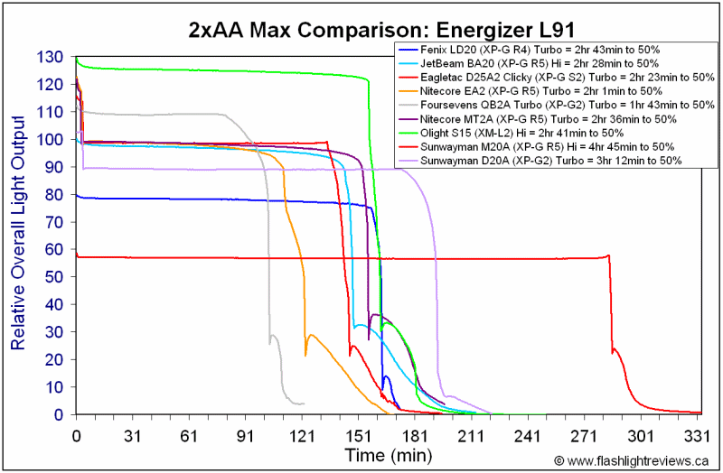

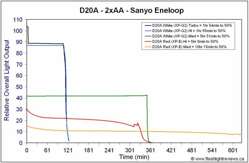

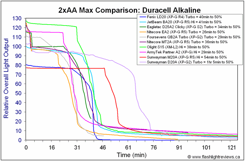

    Output/Runtime Graphs:

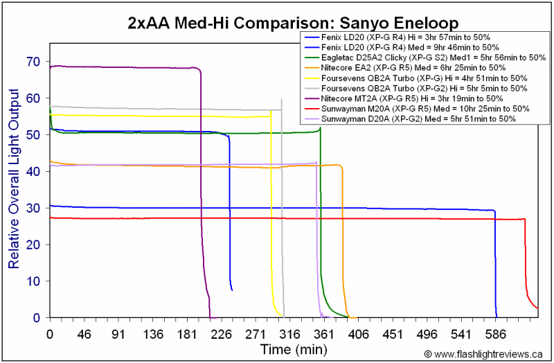

    Let's start with a comparison of the Med-Turbo modes, on both emitters:
    As you can see, on Turbo (white LED) the light steps down after ~3.5 mins to the defined Hi mode. Overall runtime is thus fairly similar between Turbo and Hi.
    The red LED has lower overall output and runtime, in keeping with the lower output XP-E emitter (and additional red dome, which likely further cuts output). It also shows a less tightly-regulated pattern.

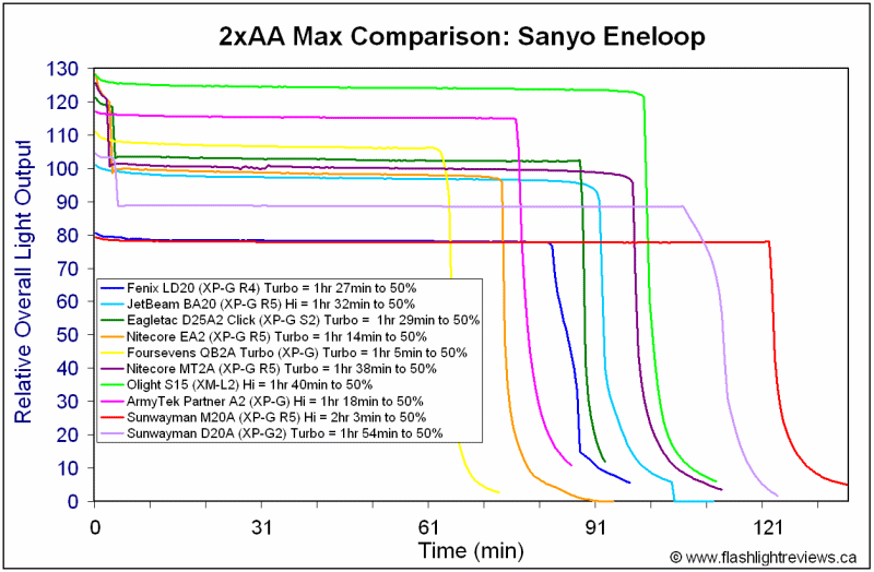

    Let's see how it compares to the competition:
    Performance on Hi is quite reasonable for the class, on all levels tested. The real stand-out is the alkaline runtime, where the D20A manages to squeeze out an impressive amount of runtime on Hi.
    In contrast, the Med mode is about typical (or toward the lower end) of the XP-G/XP-G2 class, on the batteries tested.
    The tailcap has a fair amount of pressure to seat properly, and the lock mechanism has a very thin handle. It is definitely a two-handed job, and would not be feasible with gloves on.

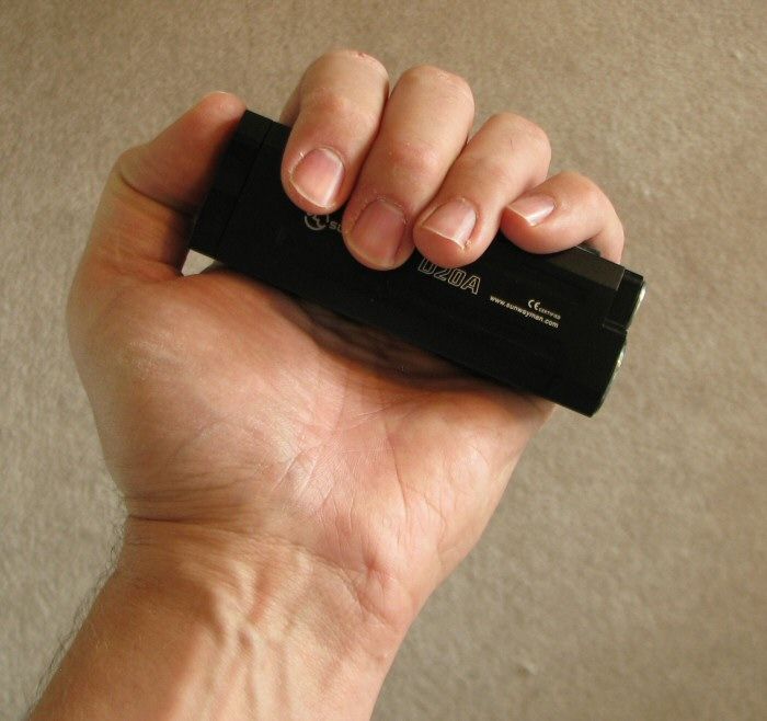

    Overall, I find ergonomics and hand feel to be fairly good (despite a few sharp edges). It is certainly very compact for a 2xAA light (thanks to side-by-side battery arrangement), making it easy to slip into a jacket pocket or bag. The included pocket clip is pretty stiff, and should hold securely. However, battery changes can be a bit fussy with the locking tailcap (and certainly could not easily be done in the dark, or with gloves on).

    nice review. How wide is red beam? Surely there must be some loss of light with the red lens?
    Alkaline battery runtime is very impressive even though the graph is not absolutely flat. I wonder if you'll get a similar graph with another set of batteries?
    6,936
    Default Re: Sunwayman D20A (XP-G White, XP-E Red, 2 2xAA) Review: RUNTIMES, BEAMS, VIDEO+
    Quote Originally Posted by Mr Floppy View Post
    It is narrow. I haven't taken measures at a distance, but you can a relative feel from the white wall beamshots (all done at the same distance), and from the video.
    Yes, it is an impressive finding. I may try to do a second runtime with another batch of alkalines... although in my experience, there typically isn't that much variation in runtime on the same sample, run on batteries from the same lot.
