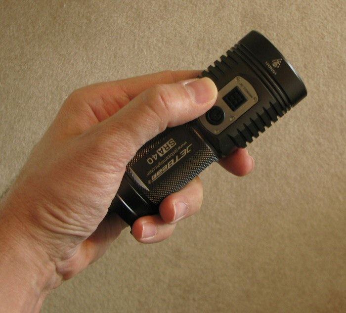

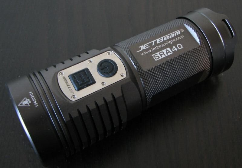

    The SRA40 is a more substantial light than other recent offerings in the 4xAA space. The in-light charging feature is likely to account for some of the extra length, but you will also note the reflector is wider and deeper than other recent lights.

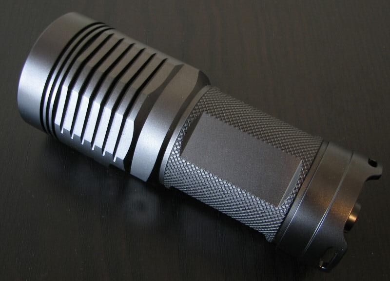

    The overall build of the SRA40 is top-notch – it is a very solid feeling light. Hand feel is good, and there are a reasonable number of grip elements along the body. Knurling could be more aggressive, though.
    Anodizing is a dark gray neutral finish, very attractive in my view. Anodizing was flawless on my sample, and appears to be quite thick – they have done a nice job here. Labels are clear against the gray background.
    Screw threading is standard triangular cut, but seems of good quality. Threads are anodized, but it will take quite a few turns to physically lock out the tailcap (due to the tension that is carried by the battery springs). Physical lock out is still feasible though, and there are still enough threads to prevent the tailcap from falling off at that point.

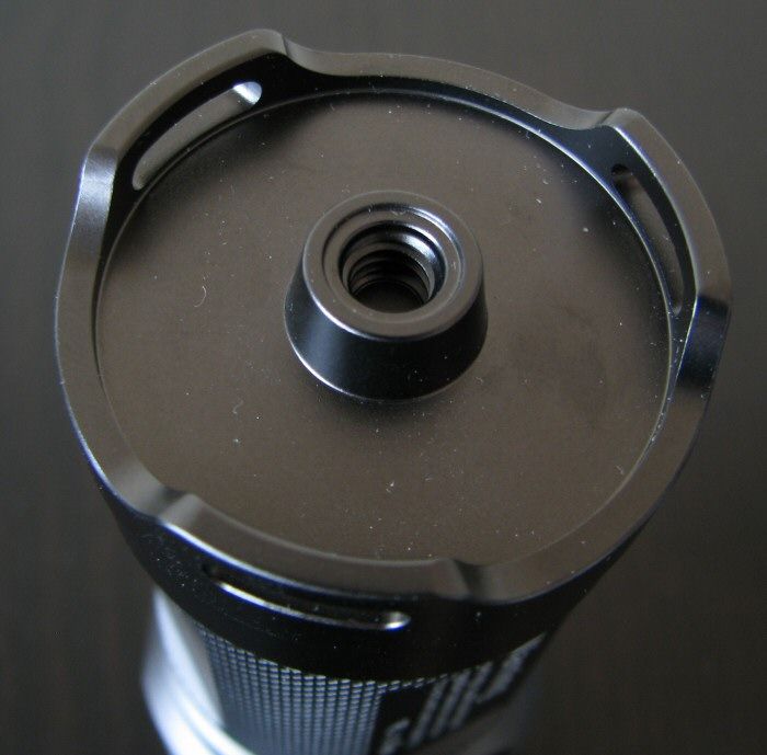

    The SRA40 can tailstand easily, thanks to the raise cut-outs. These make suitable lanyard attachment points as well. There is a standard tripod screw attachment in the base as well.

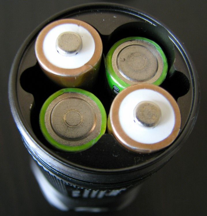

    Battery handle is quite compact, but easily houses 4xAA (alkaline, NiMH or L91). The battery compartments are molded right into the aluminum. Despite how the handle looks, the batteries don't seem to be all in series – the light instead appears to be 2s2p (i.e., two parallel channels of two cells in series). I noticed this when doing current draws, as I was able to activate the light by using just two cells in ajoining well pairs. Note however that the light will not run on just two cells with the tailcap in place. Presumably, the tailcap contact board design requires both pairs of contacts to be closed (i.e., fully connected).

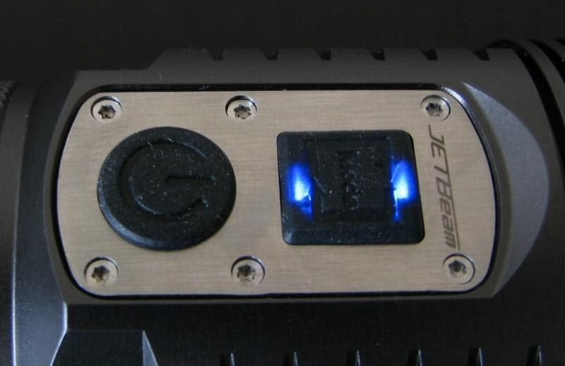

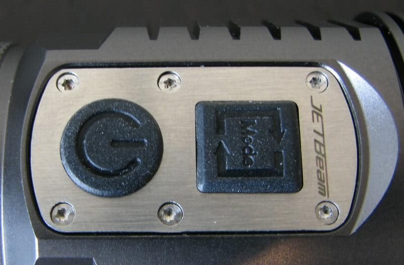

    There is a dual-switch interface in the head to control the light. These are both electronic switches, with standard feel for this class. There are two small blue LED indicators beneath the mode changing button (used as a battery power indicator and charging indicator). See User Interface below for more information.

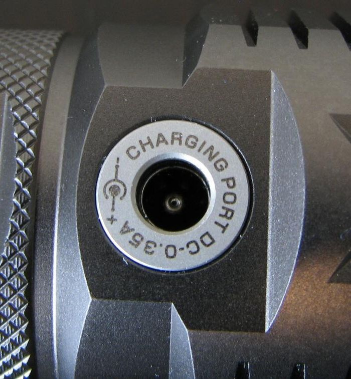

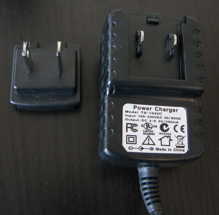

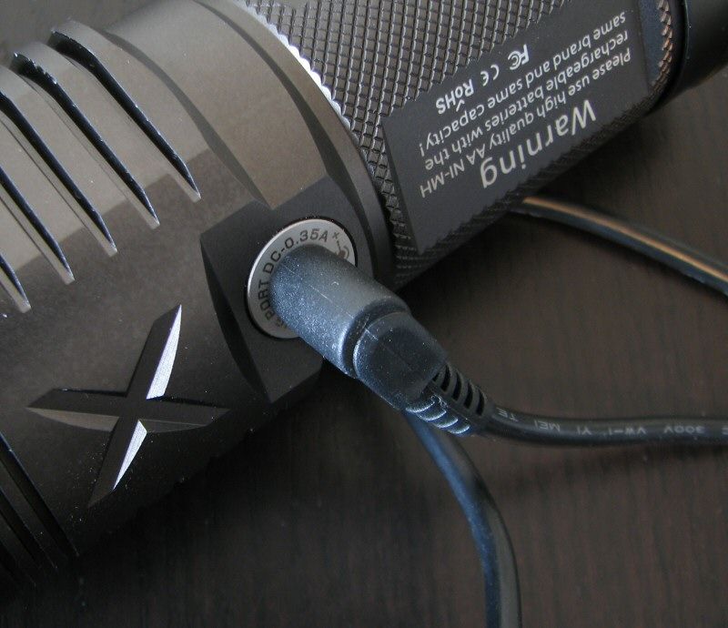

    The SRA40 comes with a dedicated AC charger (with appropriate connector for the world region you order it for). The charger indicates a 350mA charging current, which given the 2s2p arrangement, would suggest over 11 hours to fully charge a depleted set 2000mAh NiMH batteries.
    In my testing, it takes somewhere between 10 and 11 hours for the two indicators to stop alternating (i.e., the sign than charging is complete). My Maha MH-C9000 indicates the batteries are fully charged at this point. However, on a subsequent run, I stopped the charger after ~8.5 hours, and the batteries were already nearly fully charged according to my Maha.

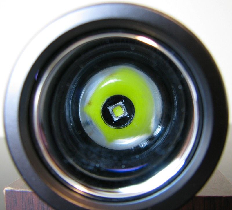

    The SRA40 reflector is smooth, and fairly large and deep (i.e., slightly larger than my other recent 4xAA lights). This should translate into very good throw for the size. The XM-L2 emitter was well centered on my sample
    Main on/off operation is controlled by the lower Power switch – press and release (i.e., click) to turn the light on at the previously memorized constant output level. Turn the light off by clicking the Power switch again.
    While on, click the upper Mode switch repeatedly to cycle between the three main output levels in the following repeating sequence: Hi > Med > Lo. I personally would have preferred the other way round. The light remembers your last choice and returns you to it after pressing the power switch off/on (after after a battery change).
    Press and hold the Power switch to activate in tactical Strobe. This works if the light is on or off.
    Press and hold the Mode switch to activate SOS. This only works if the light is on. If the light is off, pressing the Mode switch give you a battery charge readout (two blue LEDs means fully charged, one LED means <=50% charged, and a flashing indicator means the cells are discharged). The same readout occurs when you first activate the light in any mode.
    I don't see any indication of an electronic lock-out mode in the JetBeam documentation.

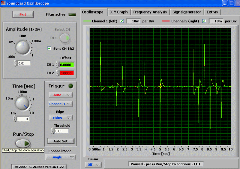

    PWM/Strobe
    There is no sign of PWM that I can see, at any output level – I believe the light is current-controlled.
    Strobe:
    The main strobe is standard fast strobe, measured at 12 Hz on my SRA40.

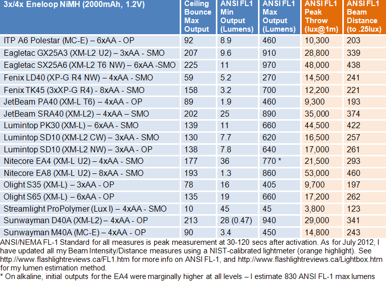

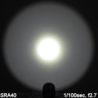

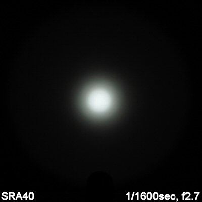

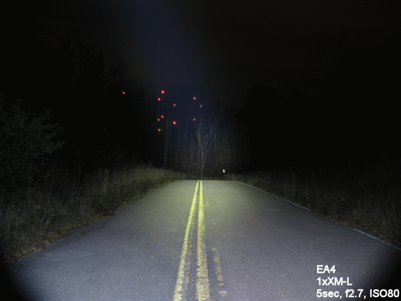

    And now the white-wall beamshots. All lights are on Sanyo Eneloop NiMH, at the maximum supported number for the given models (3x or 4x). Lights are about ~0.75 meter from a white wall (with the camera ~1.25 meters back from the wall). Automatic white balance on the camera, to minimize tint differences (i.e., my SX25A6 sample is a neutral white tint, but you won't be able to tell that below).
    The overall beam pattern is very similar to the Sunwayman D40A or Nitecore EA4 – except the SRA40 has a more focused hotspot (for greater throw). This is consistent with the larger reflector.
    For outdoor beamshots, these are all done in the style of my earlier 100-yard round-up review. Please see that thread for a discussion of the topography (i.e. the road dips in the distance, to better show you the corona in the mid-ground).
    You can see the difference between in throw these lights – the SRA40 is the definite throw king in the 4xAA class at the moment. Scroll down to summary table for more details and direct measures.
    As you can see, the SRA40 has excellent throw for this class – the highest I've seen for a 4xAA light so far. Max overall output is fairly similar to other recent 3x/4xAA lights.

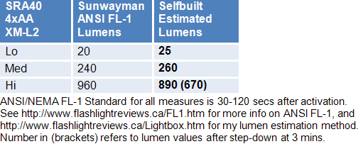

    My output and throw measures seem very consistent with JetBeam specs, on max.

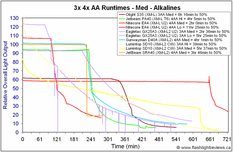

    And again for Lo and Med. Note that the initial step-down feature (after 3 mins) takes you to a lower Hi level. See runtimes below for more info.

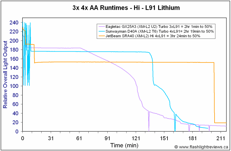

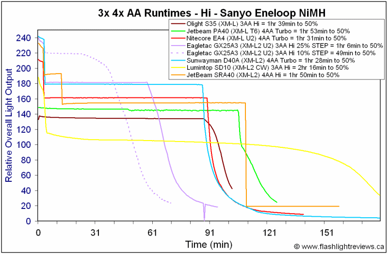

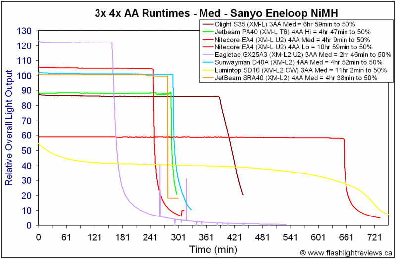

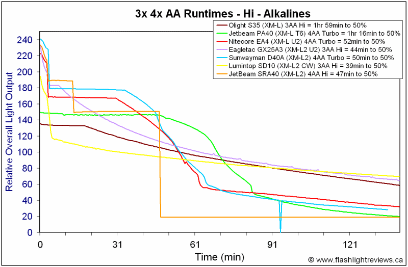

    Output/Runtime Graphs:
    The SRA40 actually shows a double-step-down on Hi. The first timed step-down occurs at 3 minutes, as indicated in the manual. But the light steps down again about 9 and a half minutes later. Final output after 12.5 mins is about ~480 estimated lumens on my scale. In any case, you can restore initial max output by cycling through levels with the Mode button, or by turning the light off/on.
    As you can tell from above, JetBeam is using a good current-controlled circuit in the light. The SRA40's performance on Hi is excellent, and the Med mode is virtually identical to the Sunwayman D40A.
    On both Med and Hi, the light has a defined step-down to the Lo level, as the batteries near exhaustion. In my testing, there was still a lot of runtime left at this Lo level.

    The built-in charger is not the most rapid at ~11 hours for a full charge, but I suppose it is a convenient option for those who want it (odd not have a USB option, though). However, as always, I recommend you individually charge your batteries regularly, to ensure each one is functioning well and is well-balanced to the others (i.e., repeatedly charging some cells in series is not a good idea).

    i'm curious about the charging algorithm... is it a delta-v termination?
    since it's 2s2p then the 350ma current charges 4000mah. kinda low for reliable delta-v
    then it doesn't have moonlight. no lockout. doesn't seem like a very good flashlight
    Agreed, I was surprised to see low current (especially considering the apparent 2s2p). Honestly have no idea what algorithm they are using. Also surprised to see they didn't just go for a USB-based option, instead of a dedicated transformer, given the relatively low current.

    Re battery config: I don't think it can be 2s2p. From a view that would mean jetbeam have made a boost driver to run at high current (2 to 3 amps) from 2.4V input. Not easy, in fact I would say impossible.
    6,936
    Default Re: JetBeam SRA40 (XM-L2, 4xAA, In-Light Charger) Review: RUNTIMES, BEAMSHOTS, VIDEO+
    Quote Originally Posted by Essexman View Post
    I would tend to agree - but I can bypass the tailcap and activate the light on just two cells. Note that I did not try to measure the output while doing this, so it may be that all levels are greatly reduced. And you do need all four cells to activate with the tailcap ... but I'm at a loss as to how to explain the light activating and changing modes on just two cells.

    Awesome review as always! I was on the edge about this light because I have the ET GX25a3 & Nitecore Ea4. But after seeing the throw on the jetbeam i will get one. I really like the looks too!
    is a Usb cable available fir the light or will it be available?
    6,936
    Quote Originally Posted by AngryDaddyBird View Post
    I don't know, you would have to check with JetBeam. I am actually a little surprised they didn't opt for a USB cable (with AC adapter), as that seems to be the more common route for most other makers.
    a fair question. However USB 2.0 delivers 5.0 +/- 0.25v. hence the lowest USB output voltage might be 4.75v. USB 3.0 voltage output minimum can be still lower. To charge a stack of 4x NiMH cells with an end voltage of ~1.4v/cell leaves no room for the circuitry overhead. Most silicon junctions operate at about 0.6 to 0.7 volts. Hence there is insufficient overhead voltage to control cell charging w/o a boost circuit - and that means more internal electronics and space.
    Alternatively Shottky junctions can operate down to ~0.2v, but they are expensive.
    My copy of the JetBeam charger outputs 6.49volts - sufficient for internal charging circuitry w/o a boost circuit.
    IOW, Jetbeam favored a simpler design with the charger outside the light.
    Edit: based on my assortment of lights with internal charging, whether LiCO or NiMH cells, all of them are relatively slow compared with an external charger, presumably because of internal heat dissipation difficulties. Furthermore none of them provide the inherent cross-check of individual-channel charging. I generally do not use internal charging for any light.

    when i shake my SRA40 i can hear the power port rattling on the bottom, like the tiny contacts inside the power port, anybody else can hear this?

    Power port doesnt rattle on mine. Dont use it anyways as the charging system on the light doesnt charge the batteries all the way for some reason so I just use my MAHA charger. Seriously if youre hearing your power port rattle around contact Jetbeam about it
    By rattle on the bottom, do you mean the tailcap? This happens on mine too, but isn't very prominent when the tailcap is fully screwed down (with cells in place). It seems to be due to how the contact board in the tailcap is attached - there is more play than typical for this class, causing some rattle (minor on my sample).
    My pleasure!
    no the round power port for the power plug. I guess this power plug has little contacts in it and you can hear them moving a litte on my SRA40. But the pwoer port works well, so it must be normal.
    maybe because you never used the power port? just plug it in a few times and then shake the light hard near your ear
    Ah, I see. Certainly no rattle there on my sample, and I did do several rounds of testing using the charging port.

    my SRA40 does not rattle
