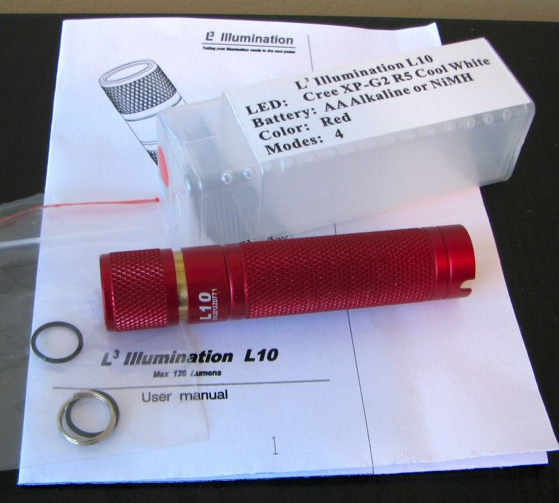

    Packaging is pretty basic - a slightly opaque plastic "tube", which contains the light, extra o-rings and a small keychain ring. Printed on the outside of the container are the light specifics (including emitter type, color and mode number). I am not sure if the manual routinely comes with the lights – if not, you can download the PDF instruction manual from the dealer website (although the specs seem out of date in the manual – you are best to rely on the website for those).

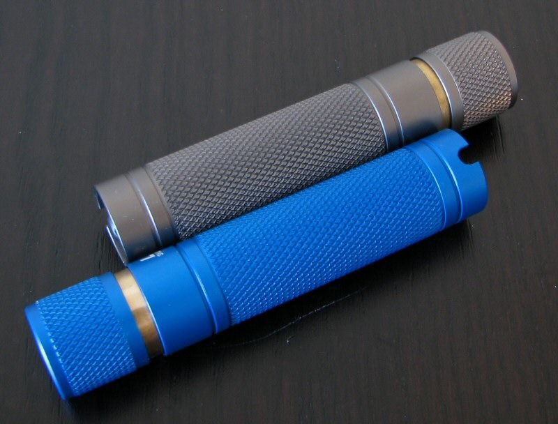

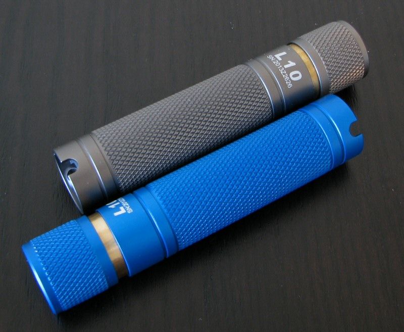

    As you can see, the L10 is quite compact for a 1xAA light. This is consistent with its twisty interface.
    The L10 series lights remind me of similar slim-lined offerings over the years from Nitecore, Foursevens, Thrunite, Lumintop and Olight/ITP. Overall construction is pretty basic, but serviceable for a keychain-style pocket light. Basically, you can think of these sorts of lights as the 1xAA equivalent of the common 1xAAA twisty lights from the above makers.
    The L10 does have more knurling than most lights in this slim-lined class. While not overly aggressive (i.e., it won't shred clothing), it does help with grip. The various anodizing colors provide a range of options. The anodizing quality seems quite good on all colors, with no chips on any of my samples. Manufacturer claims hard anodized (aka, type III), which is better than most colored lights (which are only of type II strength). The one exception here is the white version, which is spray-painted over the grey-anodized form. This contributes to a more glossy finish and feel for the white version, and is more likely to chip than the other anodized colors.
    Screw threads are standard triangular cut, fairly fine (like most lights in this class). You can expect some play, but I found the fit to be reasonably good on my samples.

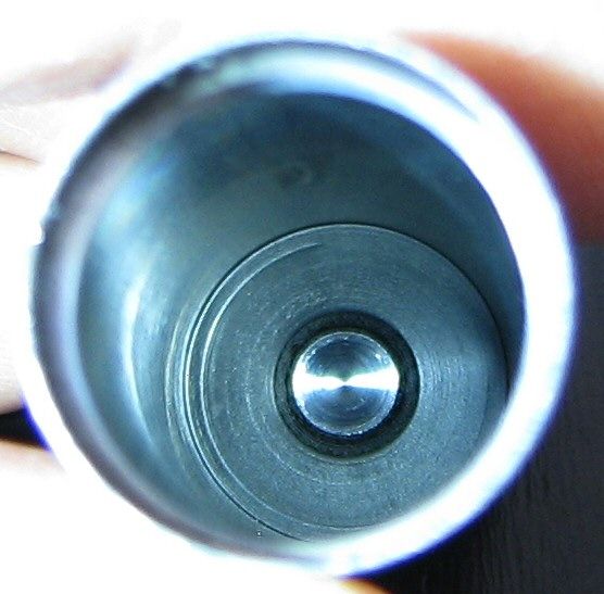

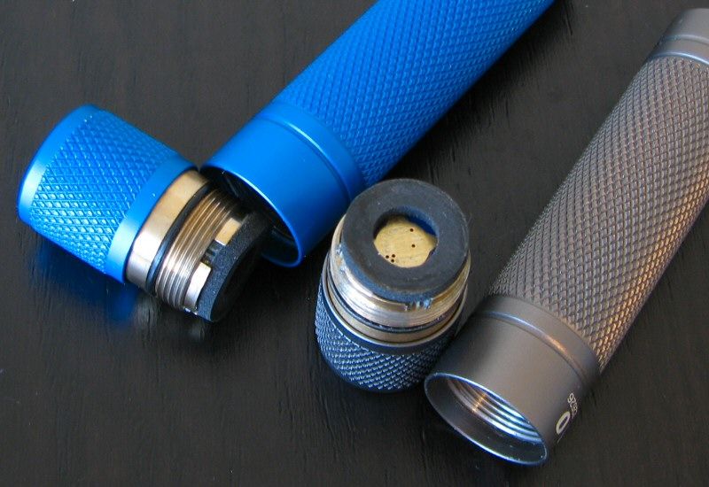

    As you can see, the head of the L10 has a brass pill/base, like a number of lights in this slim-lined class (presumably for heat-sinking purposes). The battery contact surface in the head is flat, and includes a foam cushion surrounding the center disc. A cushion is common on these sorts of lights to reduce battery rattle, and to provide some extra padding. Note there is no spring in the tail region (only a small raised metal post). These types of lights thus all run the risk of crushing your cells if you over-tighten repeatedly.

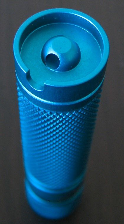

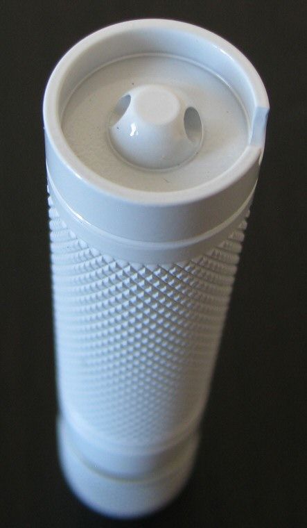

    There is a lanyard/spilt-ring attachment point at the base of the tailcap, with a cut-out for the keychain split-ring. As such, the lights can all tailstand stably.

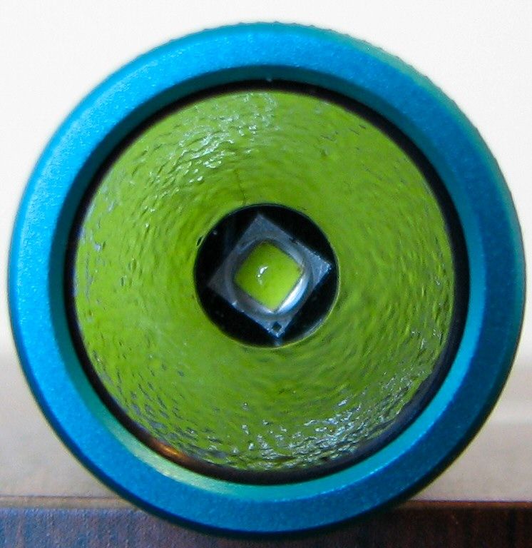

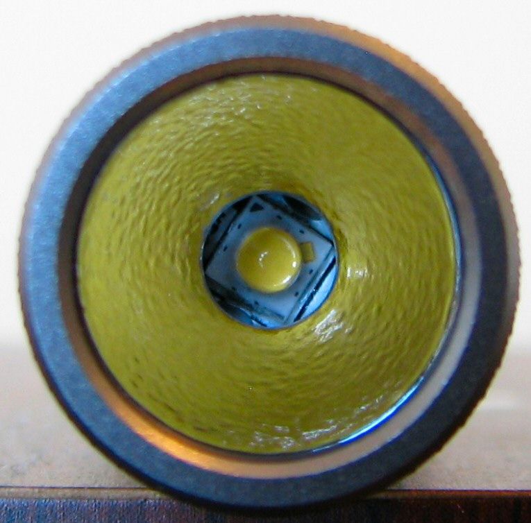

    As mentioned earlier, the lights are distinguished by their emitter choice:
    Nichia 219
    XP-G2 R5
    Centering was consistently good on my samples – there was only one in the whole group that was slightly off visibly, but not enough to affect the beam pattern. Both emitter versions seem to come with the same reflector – a relatively shallow one, with an orange peel (OP) coating to smooth out the beam.

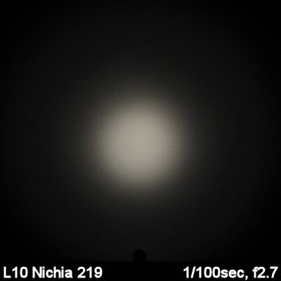

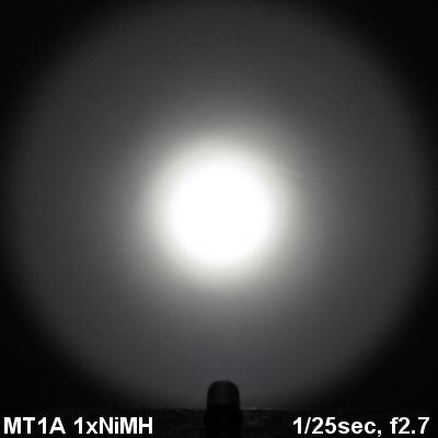

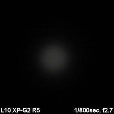

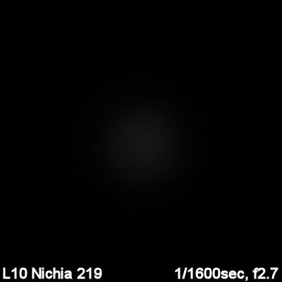

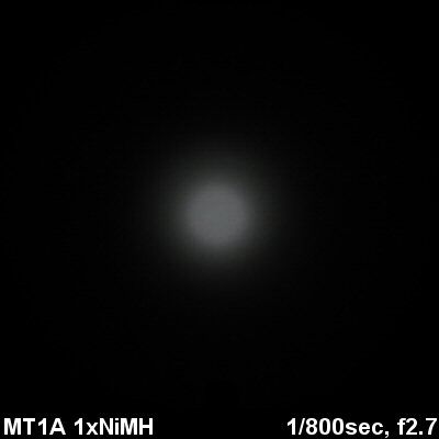

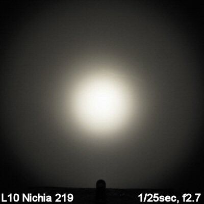

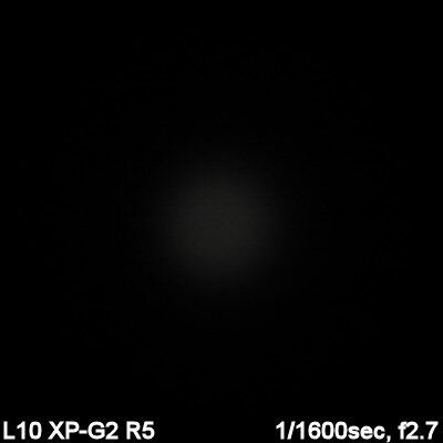

    For white-wall beamshots below, all lights are on Max output on a Sanyo Eneloop NiMH (2000mAh). Lights are about ~0.75 meter from a white wall (with the camera ~1.25 meters back from the wall).
    Automatic white balance on the camera, to minimize tint differences – except for the Nichia 219, which is using a Daylight white balance on my Canon camera.
    If you neglect beam tint (which is hard to capture on a camera, due to the narrow range of white balancing options), the overall beam pattern is not hugely different. I find the XP-G2 versions to be slightly more "throwy", with a more sharply defined hotspot and slightly greater throw.
    But it is definitely the beam tint differences that you are likely to notice between these emitters. The 4500K on the Nichia is very pleasing (to my eye) neutral white. The higher color rendition index (CRI) should also help display colors more consistently.

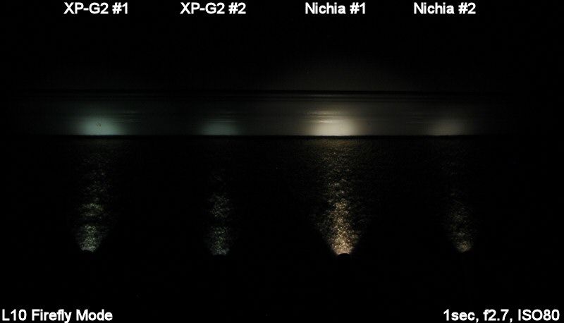

    One question that comes up in a lot of my reviews is the consistency of <1 lumen Moonlight/Firefly modes. I have long argued that these are highly variable between samples of the same model (unlike >1 lumen levels, which are very consistent between samples). We have here an opportunity to start to test these differences, as all four of my 4-level models are rated as 0.09 lumens. How do they look? (Daylight white balance below)
    Clearly, there is a HUGE variability in the Firefly output levels among these samples – as I believe there are on all lights with <1 lumen modes. As for the actual measured outputs (and sample variation measures), scroll down to my detailed testing.

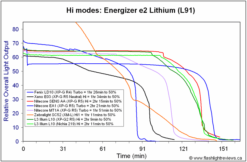

    The best place to start to answer that question is to look at some output/runtime data. Below is a graph of the 8 lights (colored-grouped by emitter) on Hi, on Sanyo Eneloop:
    The first thing you are likely to notice is that the XP-G2 versions (blue lines) all show higher output on max than the Nichia 219 versions (orange lines). The differences aren't huge, but it is suggestively consistent. The second thing to note is that the runtimes to 10% (ANSI FL-1 standard) don't seem appreciably different (although there is one Nichia that seems to be a bit of an outlier).
    It's always important to actually look at the data in this way, before rushing to do statistical comparisons. It's common in this hobby for people to want to reduce flashlights to just a couple of numbers (e.g., initial output and runtime). But it is often not valid to do that, due to all the differences in regulation and runtime patterns between different lights (see my website's methodology page for a good example of why you need to always look at the runtime data first). But in this case, the consistently tight regulation pattern on NiMH for all my L10 samples suggests we can proceed with some probabilistic statistical analyses.

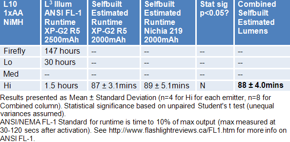

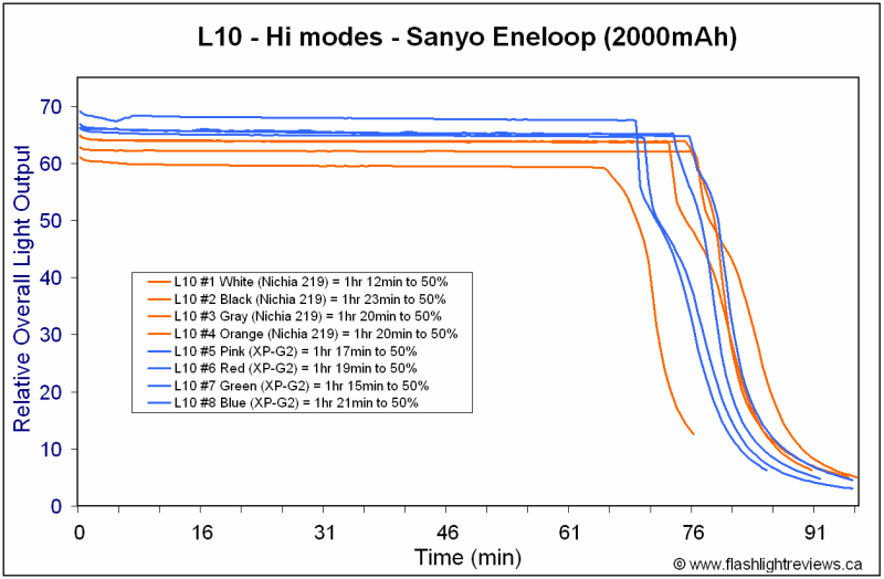

    So much for output then. How about runtime? For this, I've only done ANSI FL-1 standard testing (i.e., time to 10%) on the Hi mode on Sanyo Eneloop:
    Again, you can see the stats back up what you could see in the output/runtime graph (leaving all the data in). That is, there is no significant different in runtime on Hi between these two emitter classes. I would recommend you stick with the combined column measure above.
    It is nice to see that both the lumen and runtime specs provided by L3 Illumination seem to match very well with my testing. It's also nice to see that there is relatively little variation between samples – these sorts of standard deviations (at these n levels) are quite good.

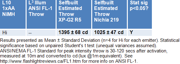

    Given the much larger difference in beam profile between these emitters, how does the throw compare?
    Ding-ding-ding, we have a winner! There is remarkably little variation in peak intensity throw WITHIN each emitter group – but a noticeable difference BETWEEN emitter groups. In common statistical parlance, the actual p value here would typically be described as "highly statistically significant" (i.e., well below p < 0.01).
    So, while there is a small increase in max output with the XP-G2 version (<10%), there is a much more noticeable increase in peak intensity throw (>35%). But before you get too carried away, keep in mind that a better way to meaningfully compare throw is by beam distance to a common intensity (not raw intensity at a common distance). By the common ANSI FL-1 beam distance measure, the XP-G2s are only a little >15% further throwing than the Nichia 219s (recall: light decays with distance by an inverse square law).

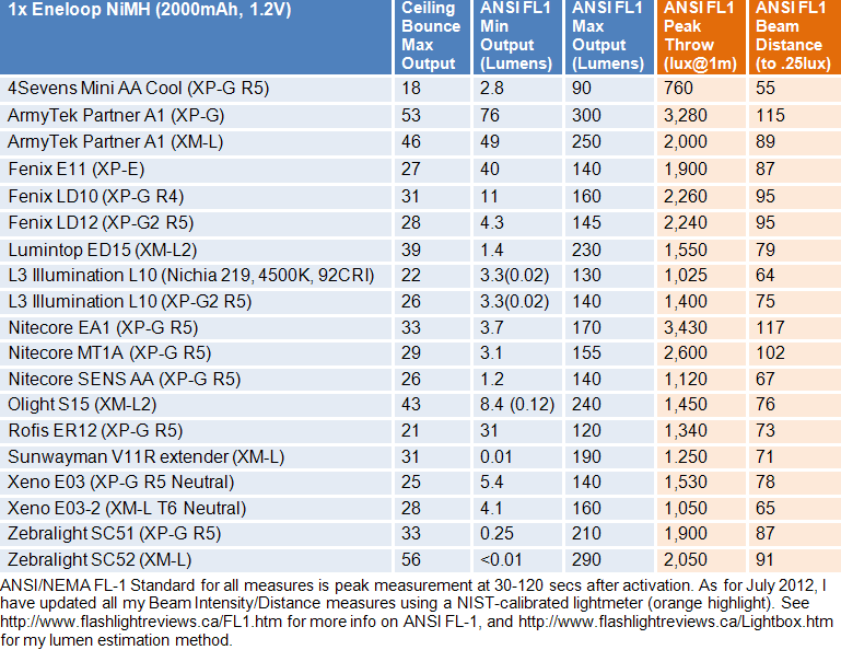

    Now let's roll all that up into my usual simple summary table for NiMH, broken down by emitter group for the L10 (given the statistically significant differences on Hi). Since there is no statistical reason to separate the lights by emitter on Firefly/Lo, I've left those fields common.
    You'll note above that ceiling bounce numbers (which I provide as an additional output measure) suggest a greater output difference between the emitter types on Hi. I suspect this is due to the more throwy beam on the XP-G2 model (i.e., throwy beams tend to get higher ceiling bounce numbers, likely due to direct reflectance off the ceiling back to the sensor). As always, I recommend you go with the much better calibrated lightbox numbers.

    However, I am concerned about the durability of the foam cushion around the head / battery contact area - especially since I carry it and use it a lot. What are you thoughts on this?
    This is a common concern on lights that use a foam cushion. But there is an easy fix if one falls off or gets too squished over time: Dr. Sholl's corn pads.
    Believe it or not, the classic round ones are a good size to prevent AA rattle. They are bit wider than the L10 stock pad diameter, but could be easily trimmed slightly if needed. A quick internet search tells me these seem to be more oval-shapped now, so some trimming will definitely be required for those.

    The white paint does chip a bit but with the gray ano underneath I think it will have a nice "patina" after a couple of years hard use

    Just wanted to get back to the question of sub-lumen variability. Here's a quick shot of four Quark LV XMLs on 0.3 lms (2 CW, 2 NW) and three 2012 D25A NW XMLs on 0.5 lms (I meter them to be ~0.25 lms). The furthest right is dimmest, but it has an unusual "PWM" issue (or some sort of high frequency strobe/pulse/flickering) on moonlight mode - gave this one to the Mrs. with ML mode programmed off.

    The white ones are painted, not anodized!

    Quote Originally Posted by reppans View Post
    Thanks, good comparison. Of course, the L10 Firefly level is lower than my various Quark or Eagletac D25x-series lights, so the effect could still be due to the ultra-lo level here (as opposed to being solely manufacturer-specific).
    Yes, that was pointed out in the review and the video.

    I did some lumen calculations for my 219 based off your LD10 R4 review, wasn't too far off but not close. I think this is the new set of figures I'll use to calibrate my new set up should I even bother. It seems that most new lights eventually make it to your hands, and shows the recognition from the industry as to high quality and value of your reviews.
    The run time on high is interesting. I calculated high based on the current draw and I should only get around an hour. Of course, what I realise now is that it is coulud be the resistance in my probes as the multi meter is in series and I take the reading with batteries fresh off the charger. In any case, I get 1.9A on eneloops but around 1.5A on anything else. To get 1 hour 23 minutes, it pretty much has draw to 1.5A, yet I can't see any sort of initial peak on your runtime graph? Could it be some sort of ramp up on eneloops or just my eneloops (gen 1)? It seems to hover around 1.8/1.9 for the first 30 seconds roughly (holding probe and compressing the foam is hard). I notice that with a depleted alkaline that it some times takes a couple of seconds for high to switch on.
    In any case, to get the output out of the 219 on high, it'll need to put 500mA to 600mA to the LED (going by memory as I can't find the spec sheet) so safe to say the efficiency is good?
    Quote Originally Posted by doctordun View Post
    Selfbuilt, would you have an estimate of runtime of the Nichia 219 medium 30 lumen level with and eneloop 2000?
    Short of running a test, is there a formula for something like this.
    Thanks.
    I'm getting 250mA from the battery tail cap measure, so it is pretty much as the runtime in the alkaline graph. Around 8 hours. Of course, nothing beats an actual runtime graph :wink:
    Yes, agreed but I thought it was important to establish some consistency among the "brighter" sub-lumen mode manufacturers since the following general statements indicates high variability among most sub-lumen lights.
    ....One question that comes up in a lot of my reviews is the consistency of <1 lumen Moonlight/Firefly modes. I have long argued that these are highly variable between samples of the same model (unlike >1 lumen levels, which are very consistent between samples)....
    ....Clearly, there is a HUGE variability in the Firefly output levels among these samples – as I believe there are on all lights with <1 lumen modes...
    But to the point on ultra-lows and manufacturer consistency, here are the Thrunite T10s (probably the L10s closest competitor) which I have on hand and they're rated the same 0.09lm/147hr as the L10, although I meter the T10s as accurate. (BTW, I promise I am not cherry picking - the QAAX, D25A, and T10 are the only models I have 3 or more copies of and I am displaying all of them.)
    I know I have repeatedly raised the sub-lumen variability question with you, but I just don't see it, and I've had over 2 dozen (across 4 models) pass through my hands, but perhaps it's because I do not repeat purchase lights with <0.09 lm lows. What really confounds me and started these questions are the late model Zebralight lights (ie 52 series). They're supposed to have among the brightest 0.34 lumen moonlight modes, but mine meters (see pix above) at ~ 1/5th of the equivalent QAAX spec (although it probably explains how ZL claims 3x the runtime of the QAAX and D25AX). I believe you metered both the QAA2X and SC52 0.3 mode as having the same output?
    Sorry to belabor the point, but I use "bright" sub-lumen modes more than any other and just find that manufacturer spec exaggeration, or huge sample variability, in the 300%+ "off" range to be..... disappointing. No offense to the L10, I love my 3-mode N219 - gorgeous beam, super efficient, superb value, and with SB's "corn pad" idea, good for long-term use.

    I have 5 Cree XP-G2 and 3 Nichia 219. All four-mode.
    I have noticed a definite trend:
    *The LED's on all Crees are off-center, but the beam is acceptable.
    *The LED's on all Nichias are centered quite nicely.
    I could see dirt on the emitter lenses of some of them with the naked eye. Under a microscope I discovered it's unmelted solder paste and is also smeared elsewhere around the base of the emitters. There are also small "curly fry" shavings of metal and white plastic adhered to the lens.
    One of my samples had the front glass o-ring sticking up on the air on arrival. I could not tuck it in, so I had to pay to ship it back and wait for a replacement.
    A variety of output flux on the lower two levels within each group. I expect this may be partly due to the Vf of the emitter, partly due to variations in the driver.
