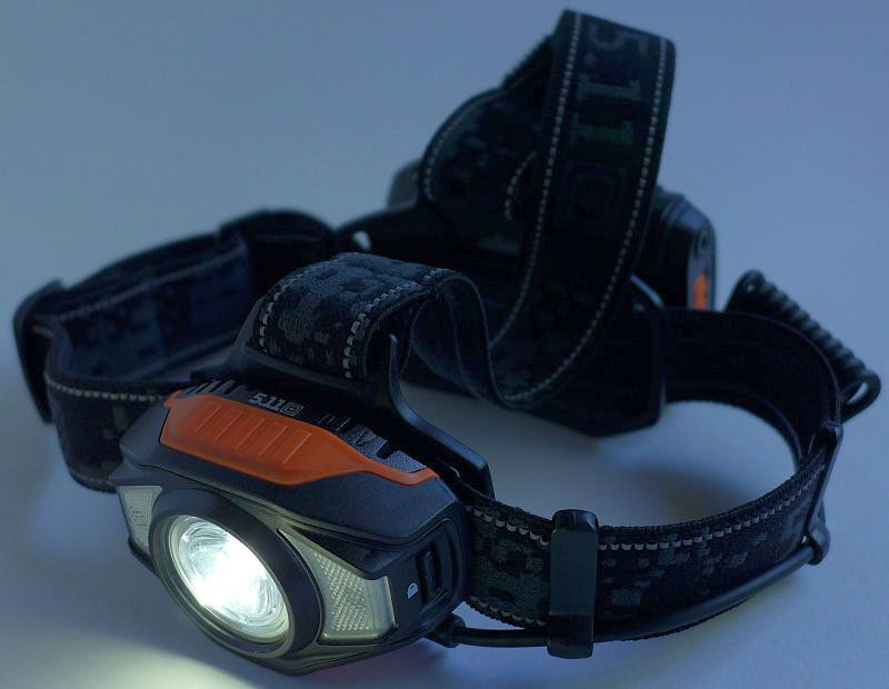

    Part of the new S + R series (Search and Rescue), the H6 and H3 headlamps bring a hands-free option to the 5.11 lighting line up.
    Initial Impressions:
    Perhaps the most distinctive feature of the 5.11 Tactical Search and Rescue H6 and H3 headlamps is the design of the removable and interchangeable battery packs. This coupled with the independently flood and spot outputs, straight out of the box the H6 and H3 look very attractive.

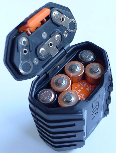

    Opening the battery door and removing the plastic insulator, shows the AAs and contacts in the door.

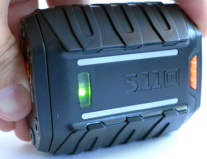

    Pressing the battery test button lights up either a green, amber or red led to indicate the remaining power.

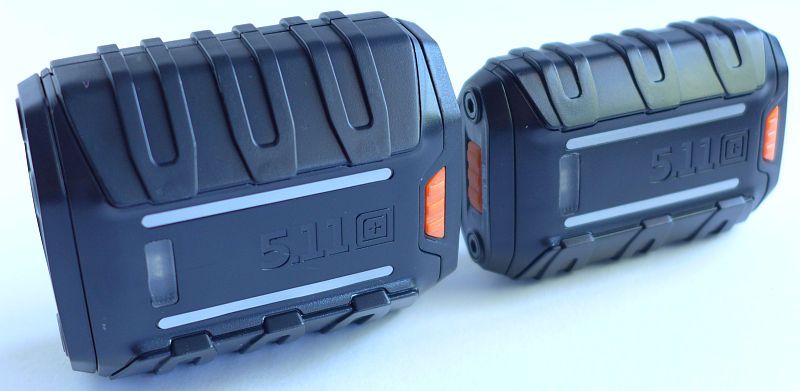

    Although we have not yet looked at the H3 in detail, here are the H3 and H6 battery packs next to each other to compare size.
    Although different overall sizes, the H3 and H3 have the same attachment for fitting to the headband.

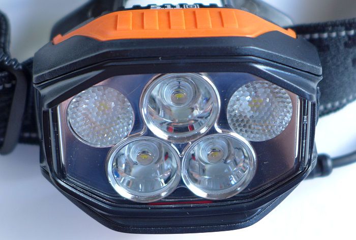

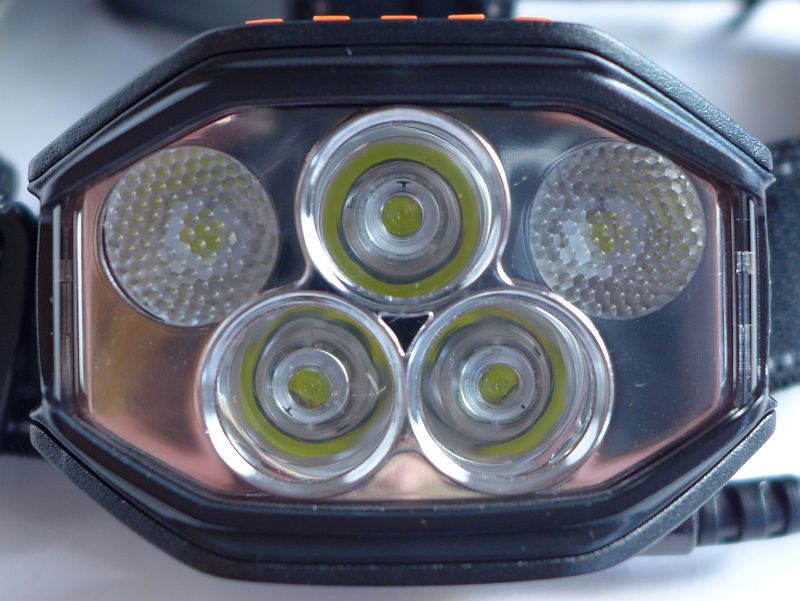

    Looking straight at the front of the light unit, you can see the three spot LEDs with TIR optics, and two flood LEDs with hexagonal diffusers.
    The upper switch controls the spot output.
    With the lower switch controlling the flood.

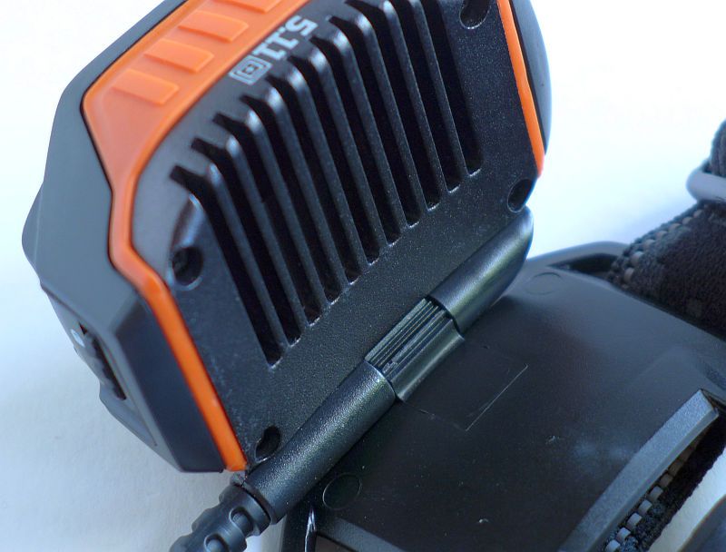

    The head has 90 degrees of angle adjustment. Also visible are the metal heat-sink fins, on the back of the light head.

    Like the H6, the H3 has 90 degrees of angle adjustment. Also visible are the metal heat-sink fins, on the back of the light head.

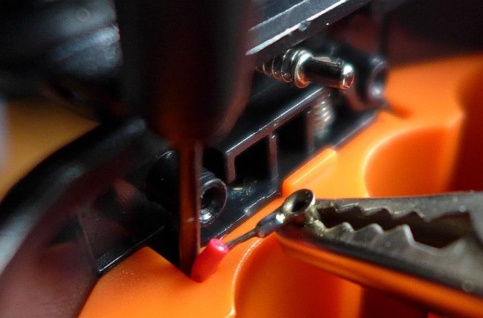

    Unfortunately I did experience a couple of issues with these lights, the first of which was the H6's battery pack which was working intermittently for a while and then stopped working. This was due to the soldering of one of the sprung connectors failing.
    This photo shows the wire that came loose.
    However not wanting to wait for the replacement that 5.11 would have sent, I fixed it myself. After which the H6 worked perfectly.

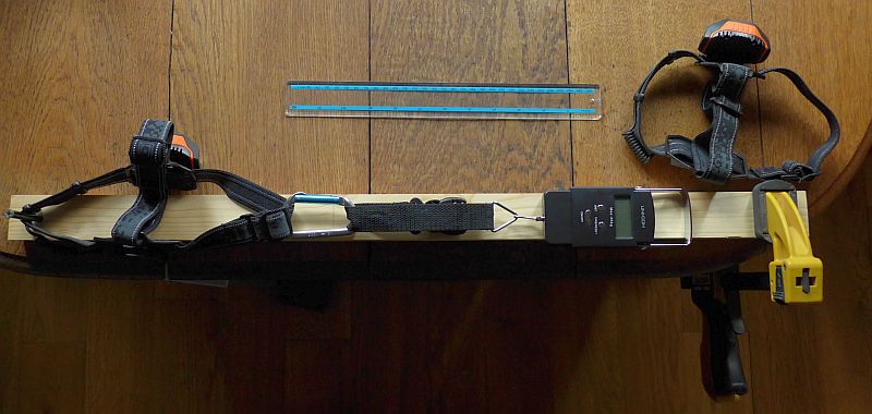

    The other concern I had (which may well be a positive aspect for others) was the tightness of the headband. So much so I put together a test rig to quantify this.
    My hat size is Large (58cm), and prefer a comfortable fit, so in most cases I have headlight bands at their almost loosest adjustment.
    Having measured my head's circumference I used the rig to stretch each headband to this length (or half as the band is doubled up) and 'weigh' the band. All headbands were as they are when I normally wear them, but the H3 and H6 were set to their loosest adjustment.
    The other headlights on test averaged around 730g of headband grip, the H3 had 1400g and the H6 1240g – significantly more. Enough to make wearing these uncomfortable for me after a few minutes. When I have worn them for longer I have ended up with a numb forehead.
    While doing these tests, I gave the H6 and H3 headbands a good stretching, enough to fit them onto a hard hat (which they did without feeling over stretched). Immediately after this they each weighed 1170g of grip, so better, but this did recover after a few minutes.
    Another indication is that with their bands adjusted for a comfortable fit, they were all around 27cm in 'relaxed' length. The H3 and H6 at their loosest adjustment were 25cm long when relaxed.
    For some, this extra tight fit might be a benefit, and for Search and Rescue personnel, knowing it will stay put might be what they are looking for. The band had no trouble going over a hard hat, and had a very strong grip. On their own though, for everyday use I'd prefer it if the band could be made longer to allow for better comfort.
